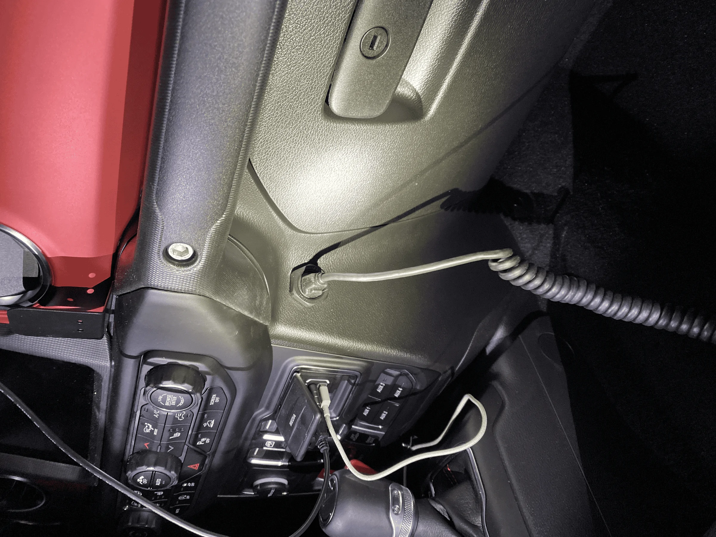

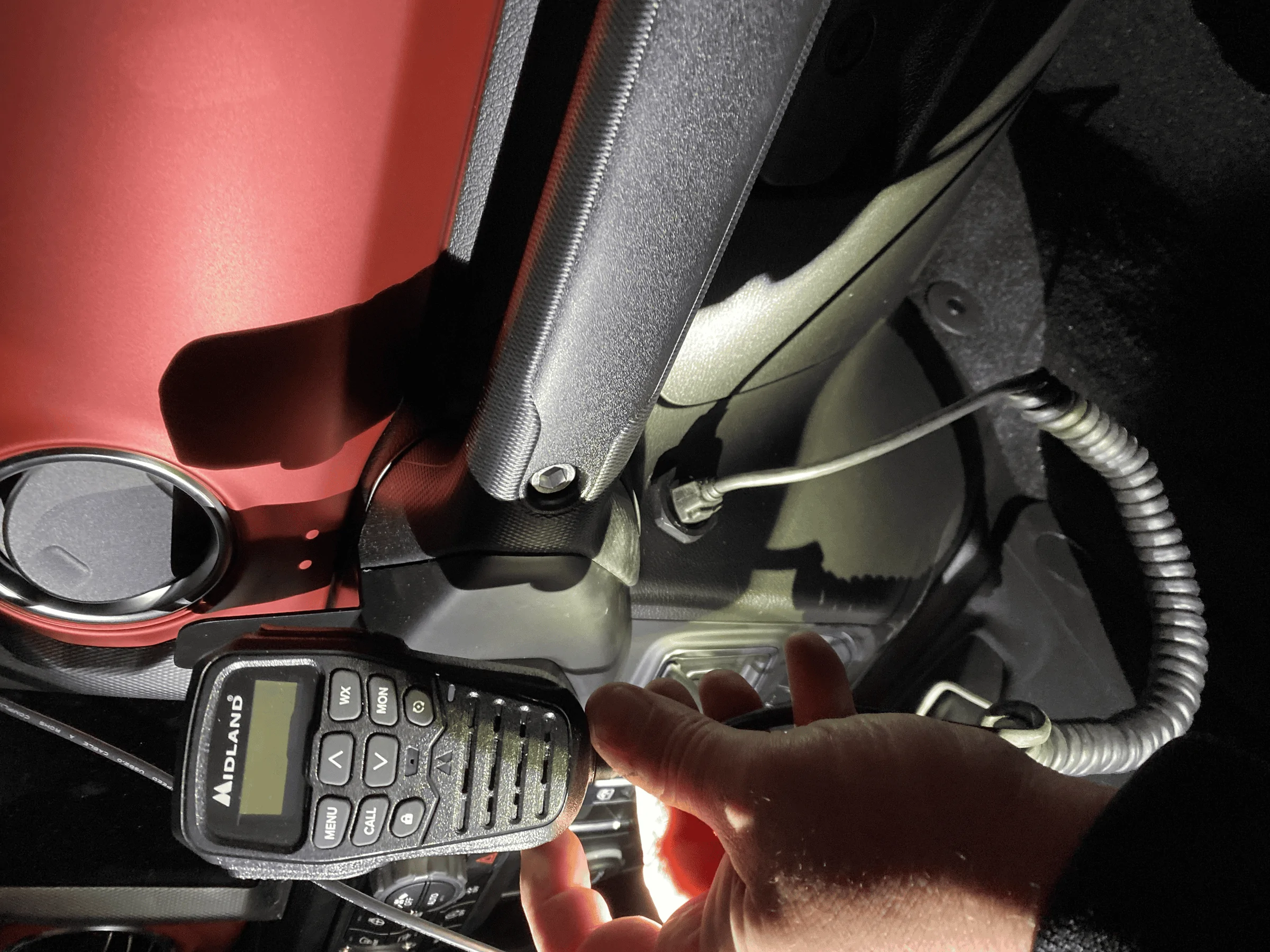

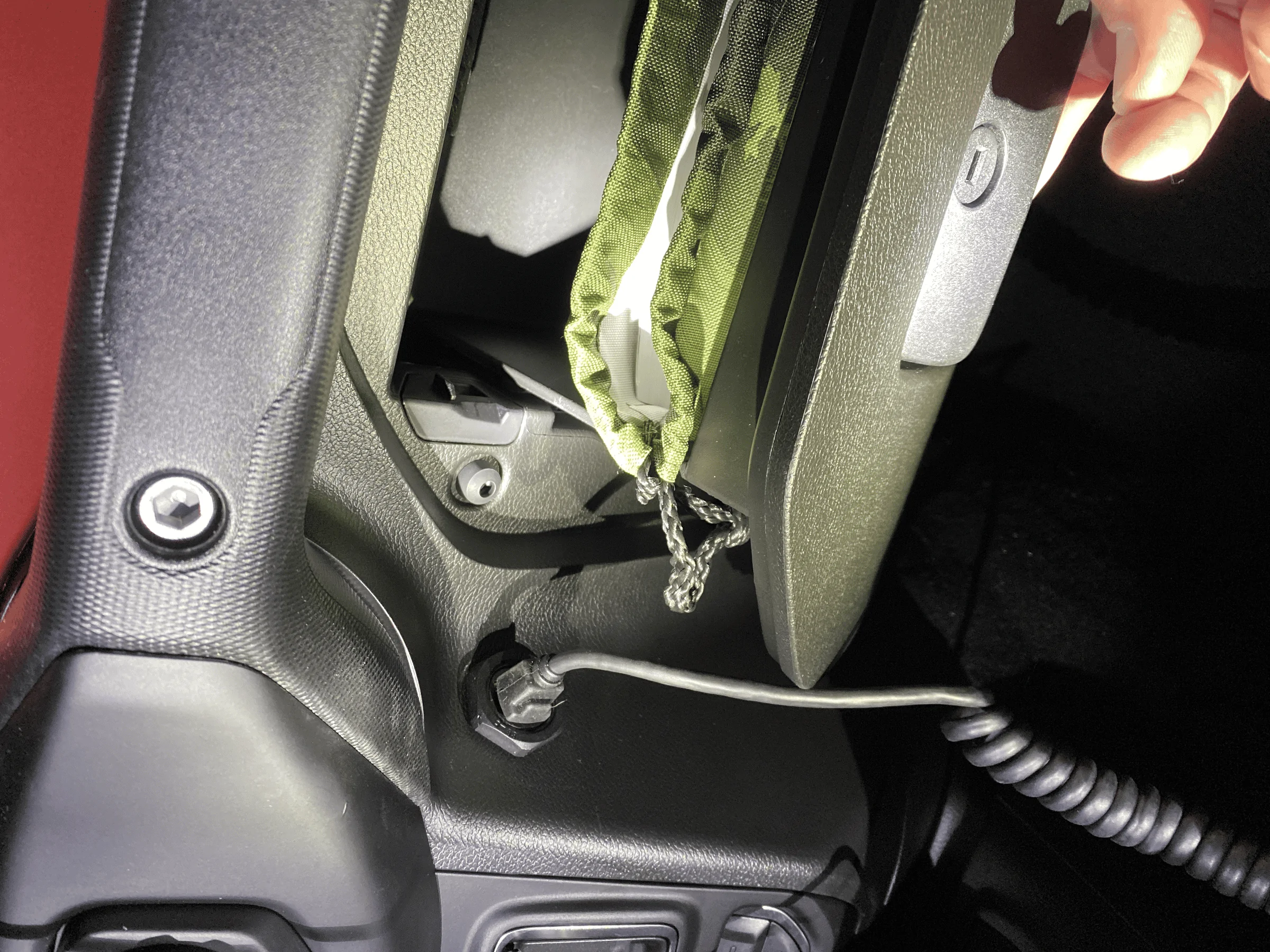

I mounted antenna and radio today.
the radio is under passenger seat on a little bracket I made, we will see if it stays there.
I located the mic connection port near glove box and it appears to be an OK location.
The mic holder is right above it.
when the mic is detached and stored in the glovebox it is hard to tell that there is a mic port.
Nice Job with Mic, would like to know how the radio under passenger seat is working out? ( Pics if you have them)
Im in the market for a radio now and want to avoid cluttering my front dashboard so your idea is fantastic.
I used the jeep last weekend and had a chance the test out the GMRS in a group setting, and I had no issues at all with the midland. I used the IGN on power supply wire that is in the aux switch wiring bundle under dash on passenger side For power. No interference or ground loop issues, etc. radio under seat seems good and I see no reason to relocate it. I’ll try and grab you photos. The little Ethernet cable I used as a bulkhead fitting is here https://www.amazon.com/dp/B08P88DKXH?psc=1&ref=ppx_yo2_dt_b_product_details
Thanks for the link, I’ll check out the photos once you post them, and yeah most reviews are pointing to Midland GMRS radio for myself as well.

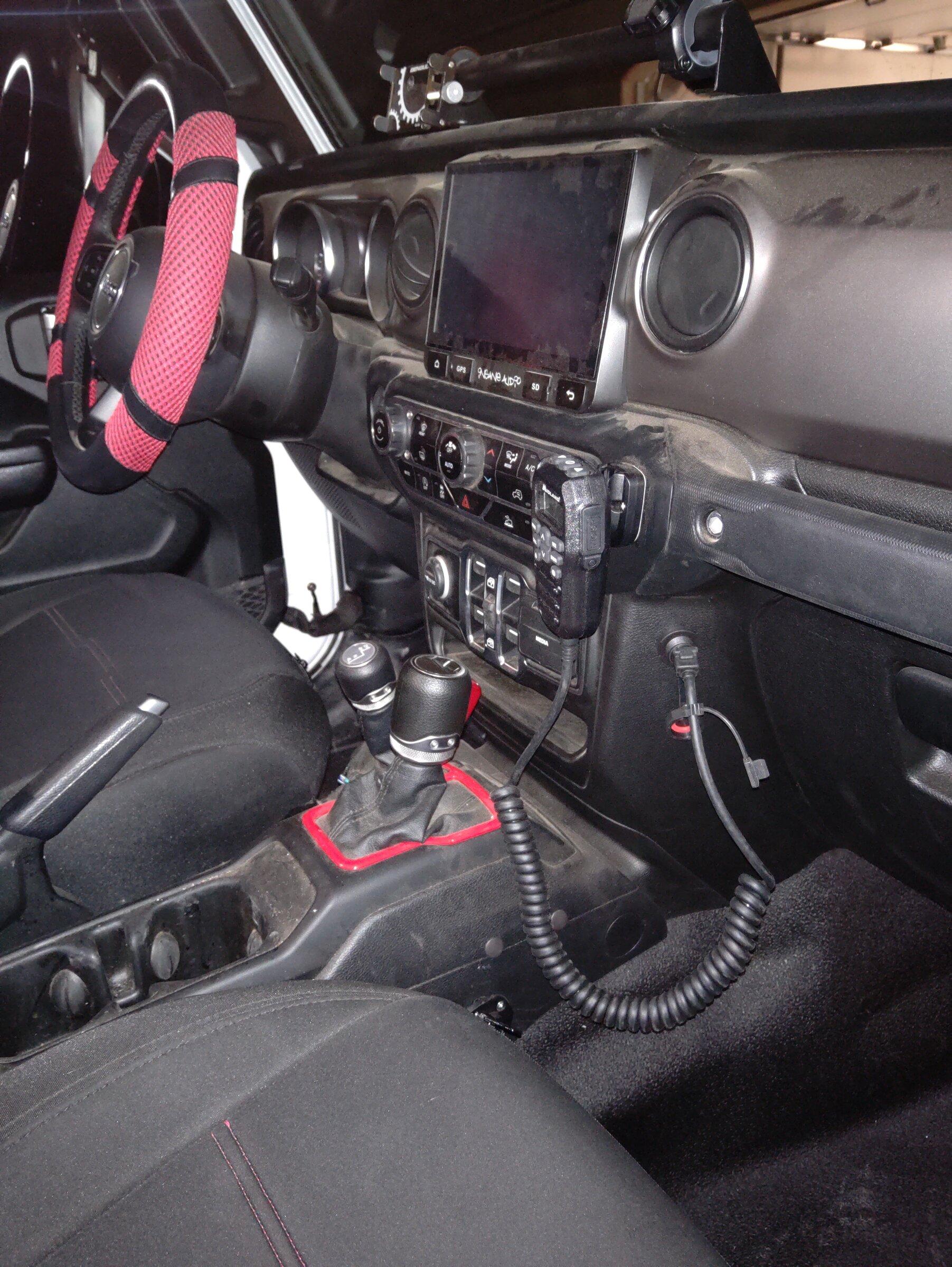

I did this last night, and I love it. I removed the mount from the center console and tucked the unit into the dash, did the panel mount CAT6 with a 1.5ft cable, worked out great.
