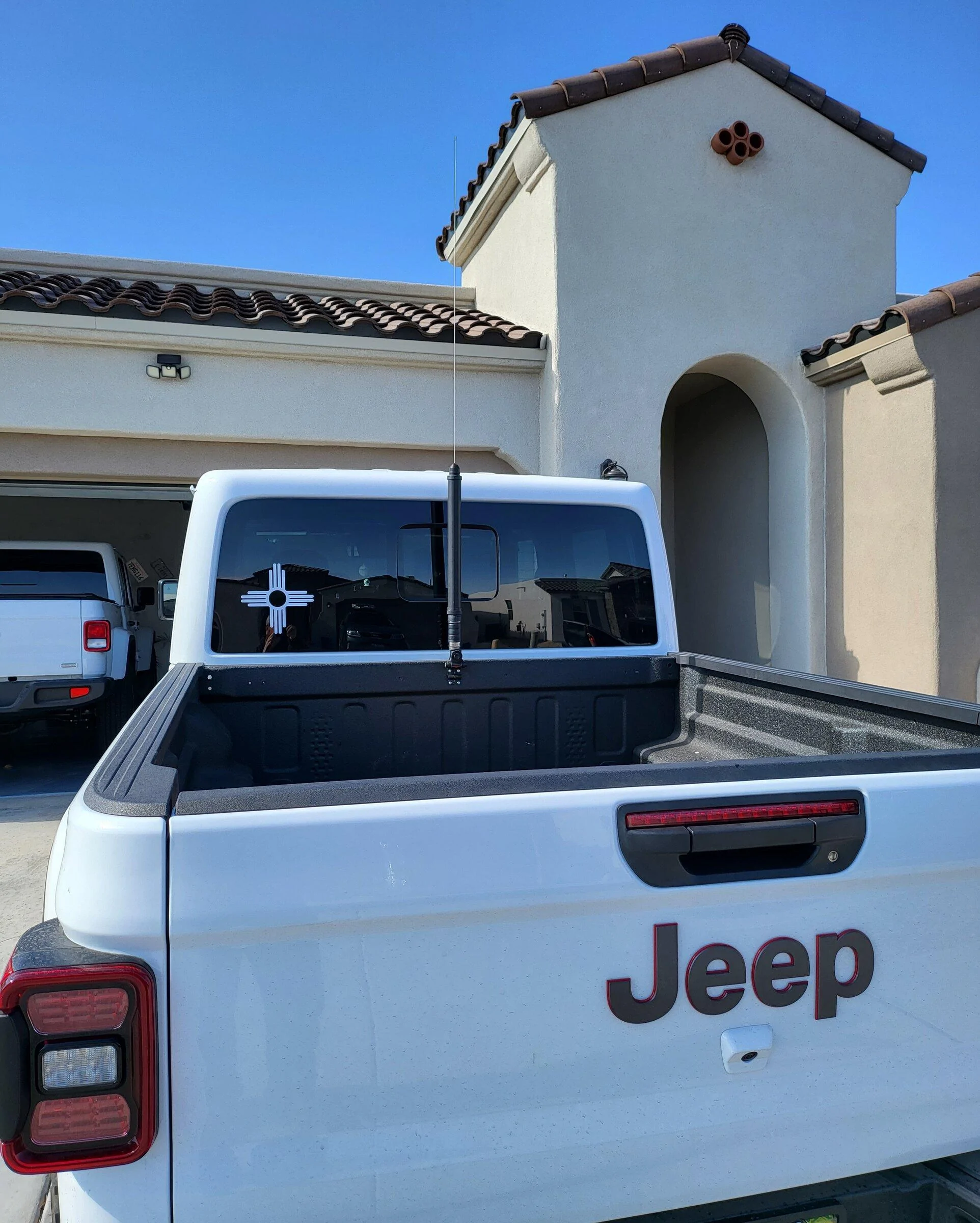

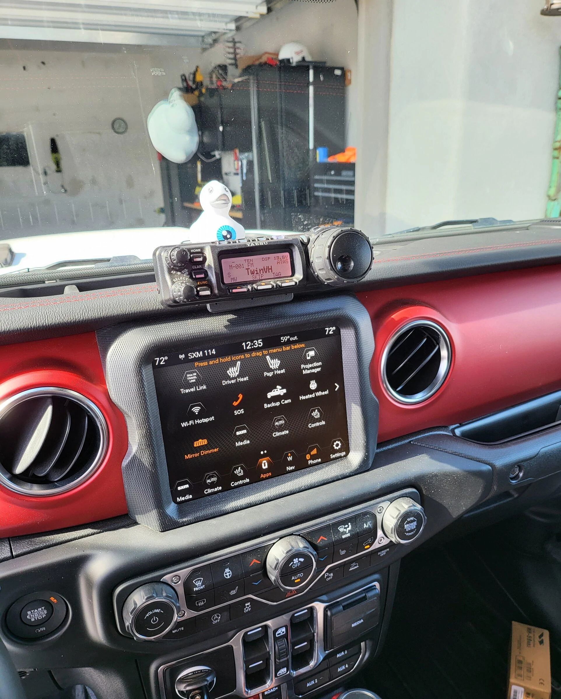

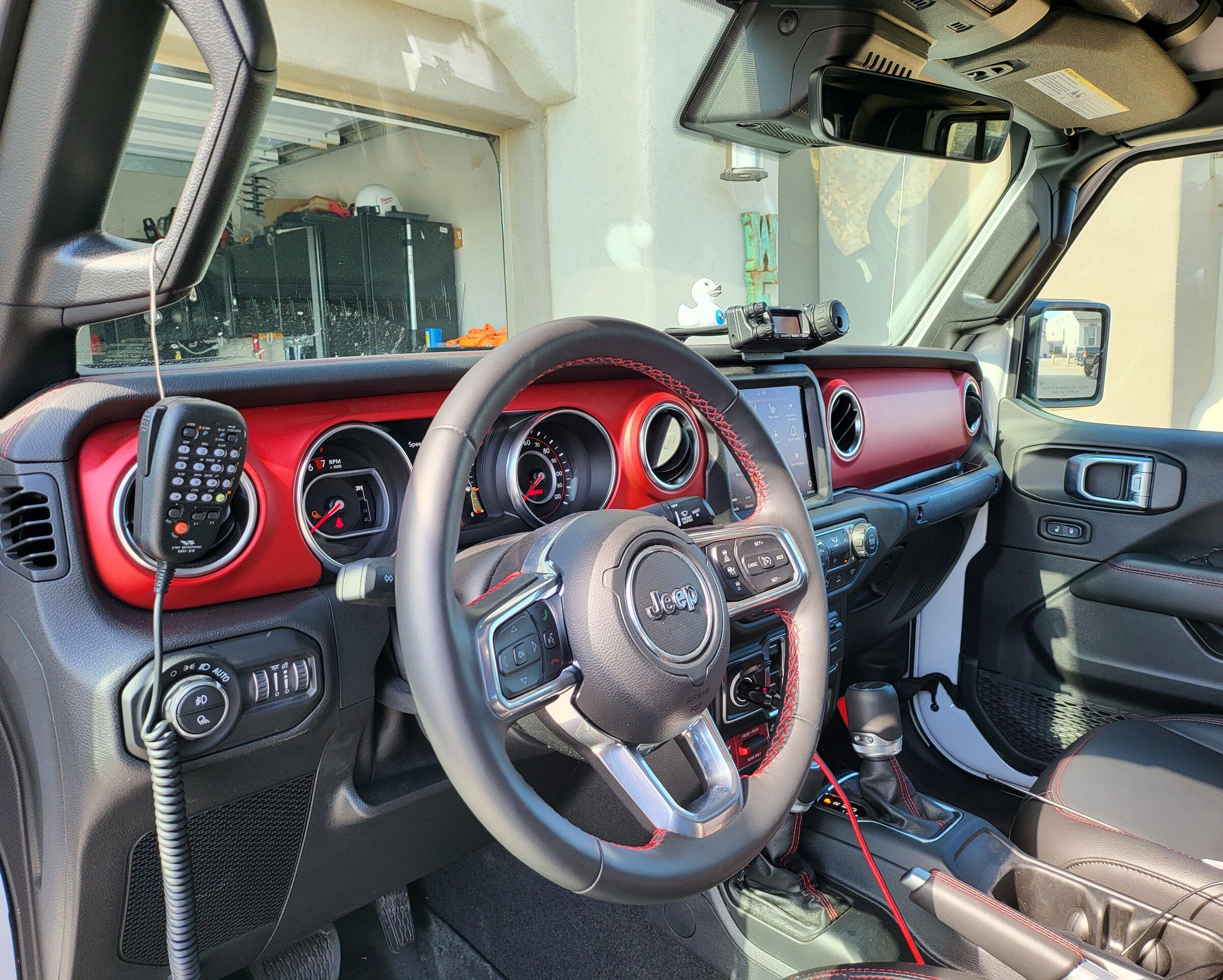

I don't think I will go the GMRS route for radio comms. I have instead installed my FT-857 in the vehicle and decided to go all out with an ATAS 120 antenna. I do have a modded Baofeng (handy talkie HT) radio to cover the GMRS/FRS stuff for those folks, but the 857 covers most or my comms needs.
