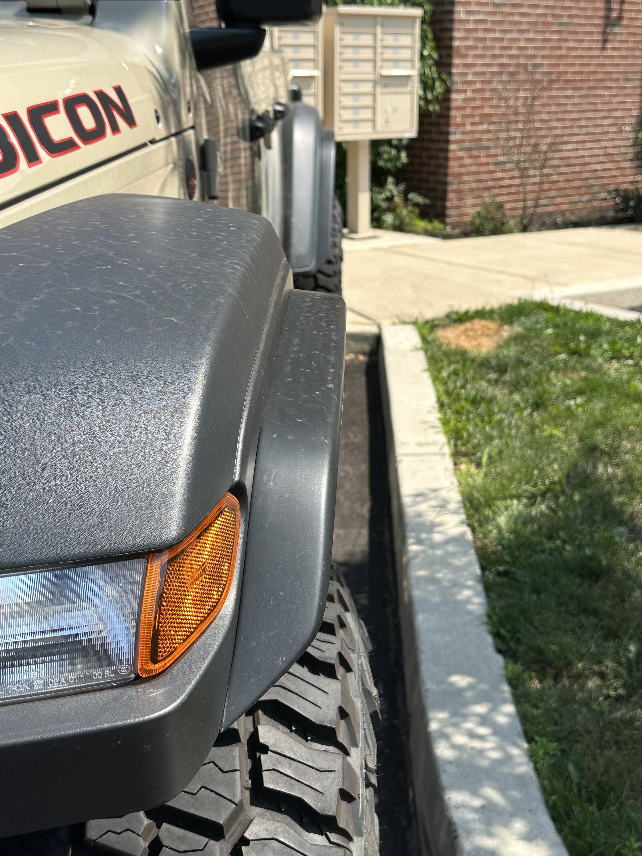

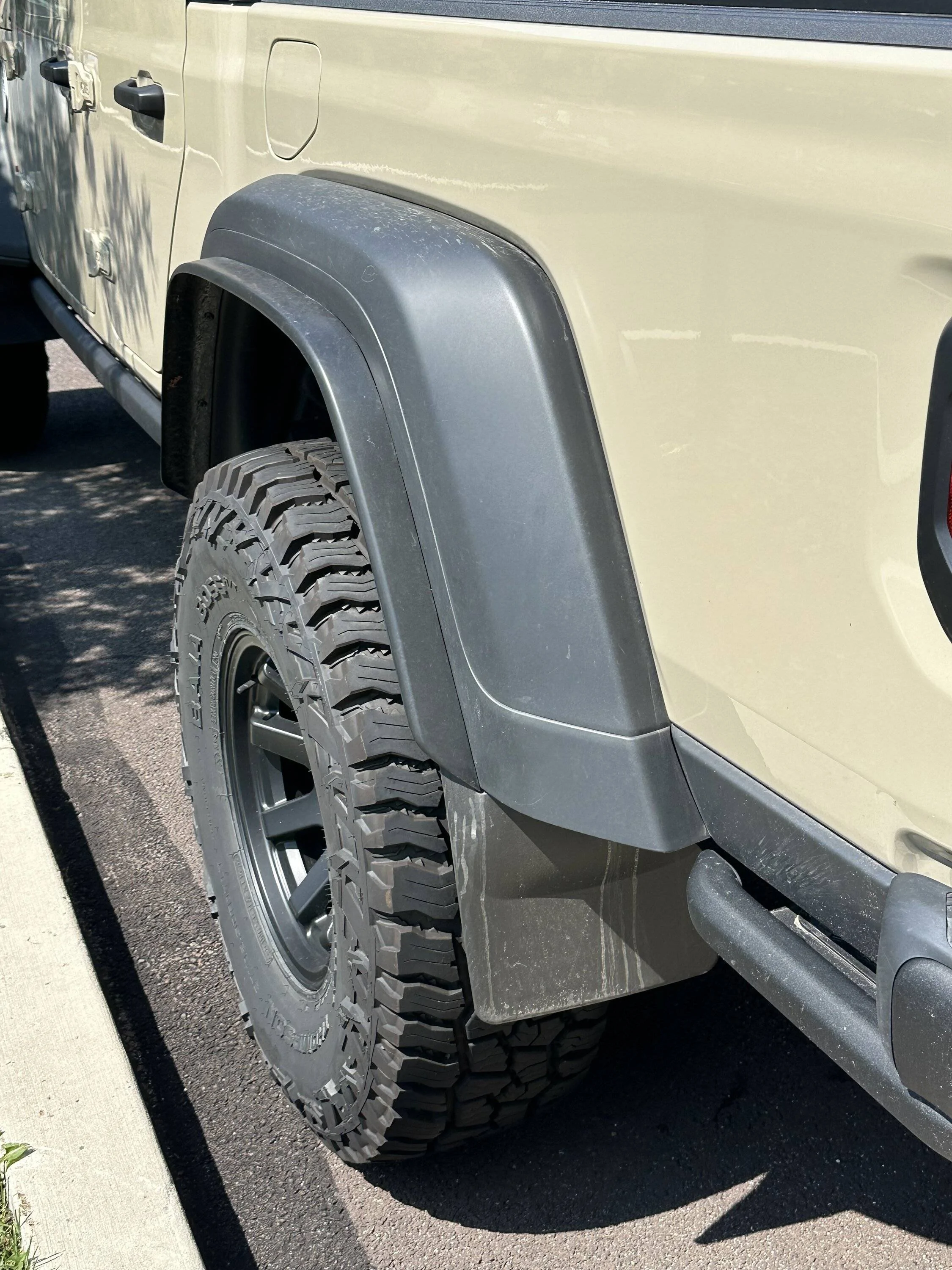

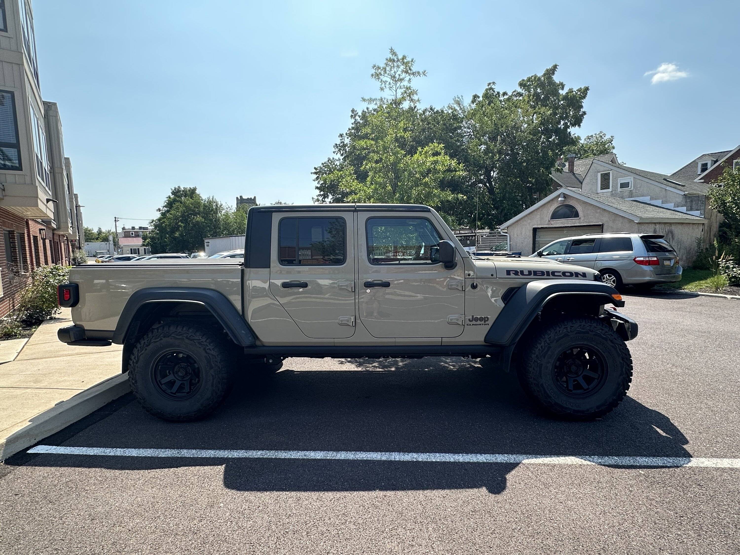

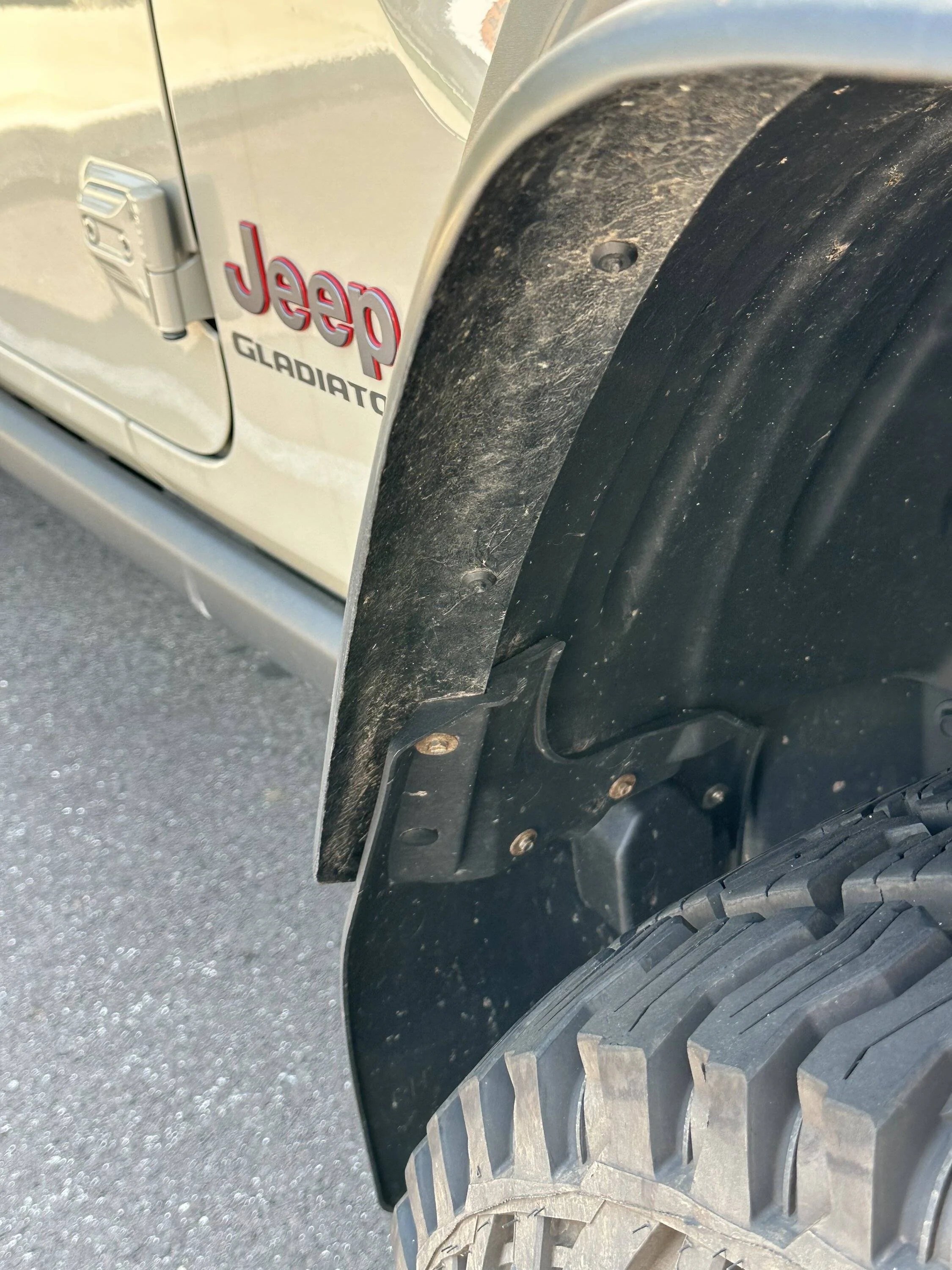

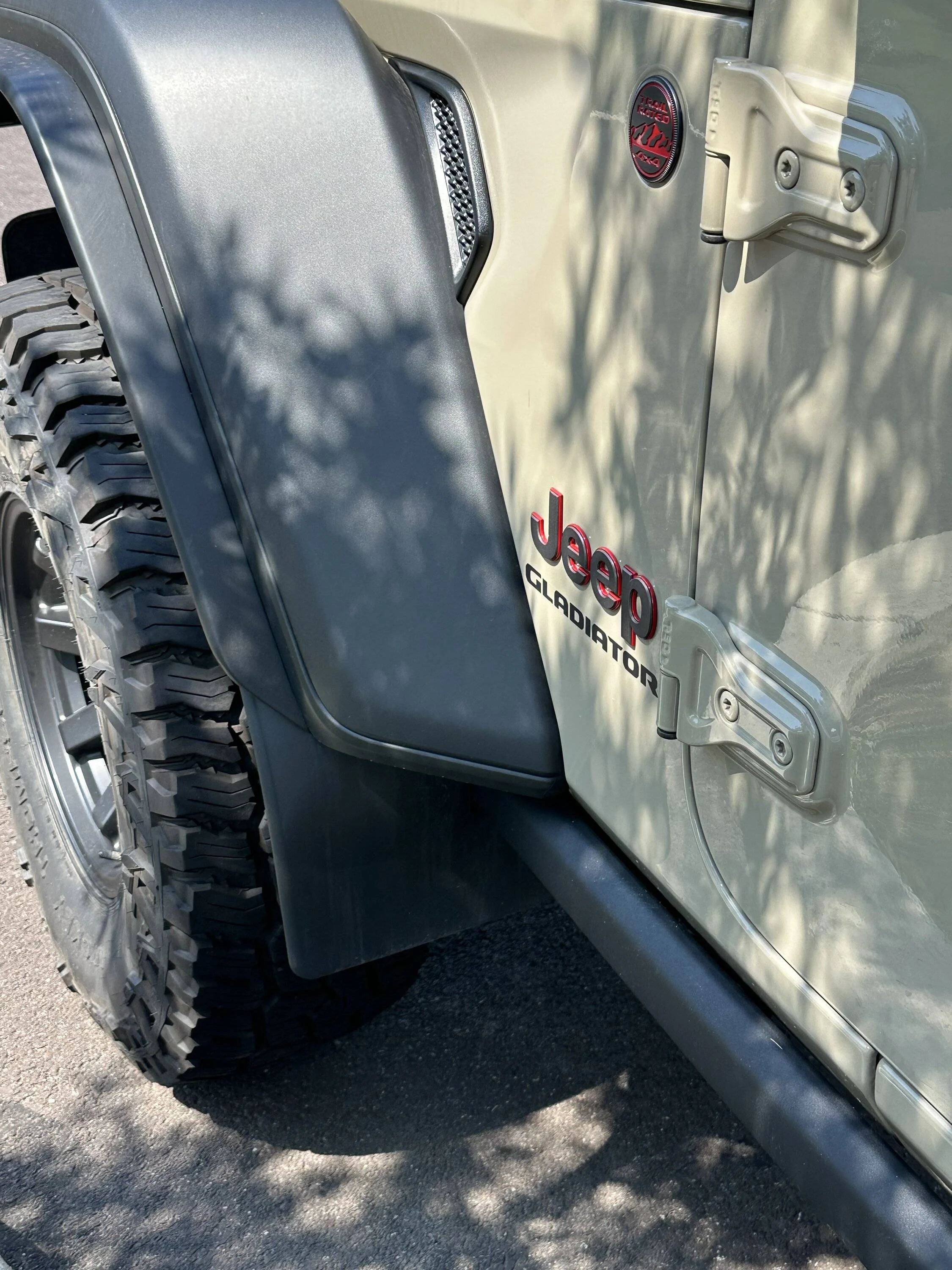

With a little bit of force-fit and judicious use of the fender flare rivets, you can fit the weathertech mudflaps over the DBOR flares - or at least I was able to do this on my JT Rubicon. Here are some pictures.....
Jeep Gladiator Couple questions about flare extensions / 35s / mudflaps IMG_0031
Jeep Gladiator Couple questions about flare extensions / 35s / mudflaps IMG_0032
Jeep Gladiator Couple questions about flare extensions / 35s / mudflaps IMG_0033
Jeep Gladiator Couple questions about flare extensions / 35s / mudflaps IMG_0034
Jeep Gladiator Couple questions about flare extensions / 35s / mudflaps IMG_0035

Awesome, thanks! That's what I was looking for. They actually look pretty good like that too. I did order the Recon flares, but it looks like they'd fit the same as the DBOR ones, or actually maybe a bit better.
