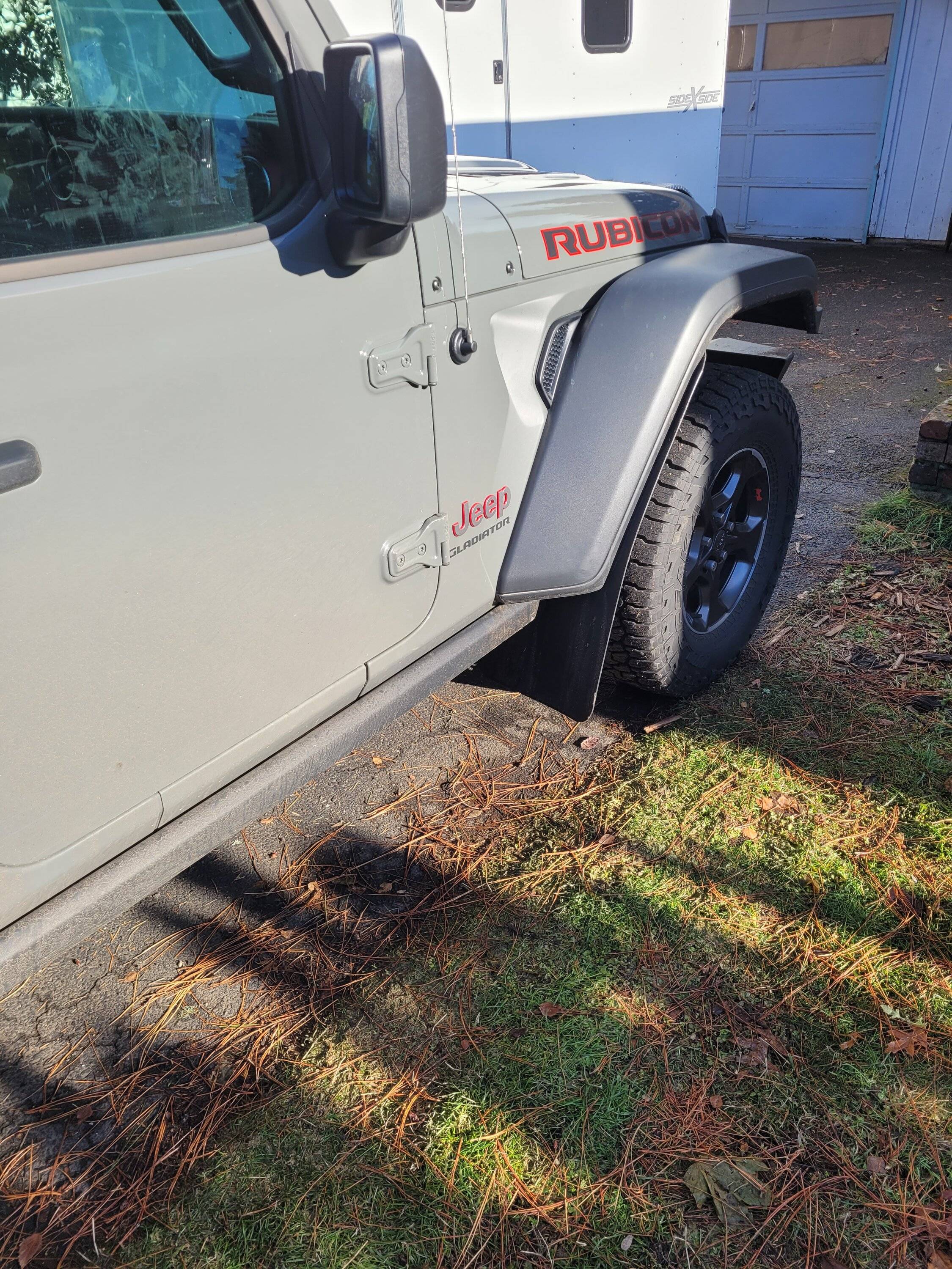

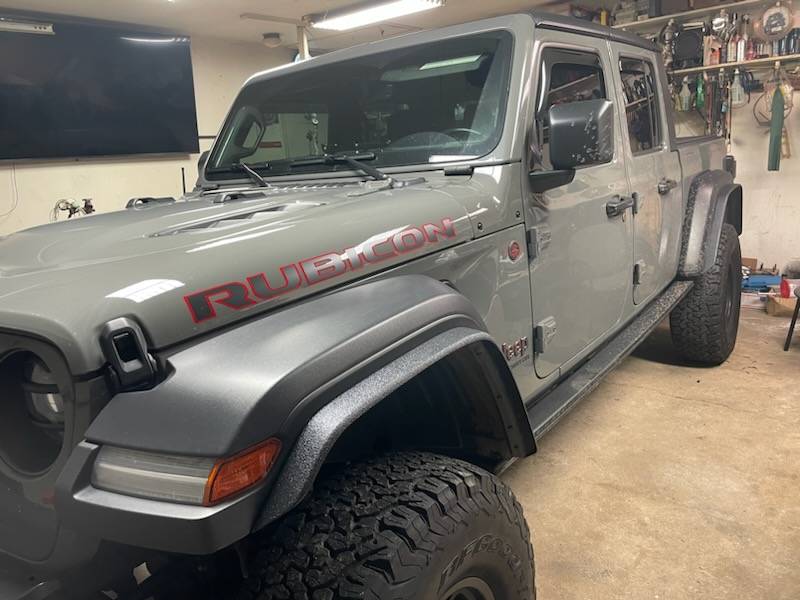

I added Husky Long John Mud Flaps to the front of mine. I'll get another set and add to the rear before long.
Husky Liners Universal Mud Flaps | Long John Flare Flaps 15" Wide - 36" Length - Black | 17049 https://a.co/d/ezHb6jy
Jeep Gladiator Anyone running these Flare Extensions? USA supplier? 20230101_115027
I installed them so they stick out 1 inch, but could easily mount them out further. They only cover the back half of the flare, not sure if that would help you.

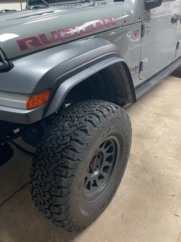

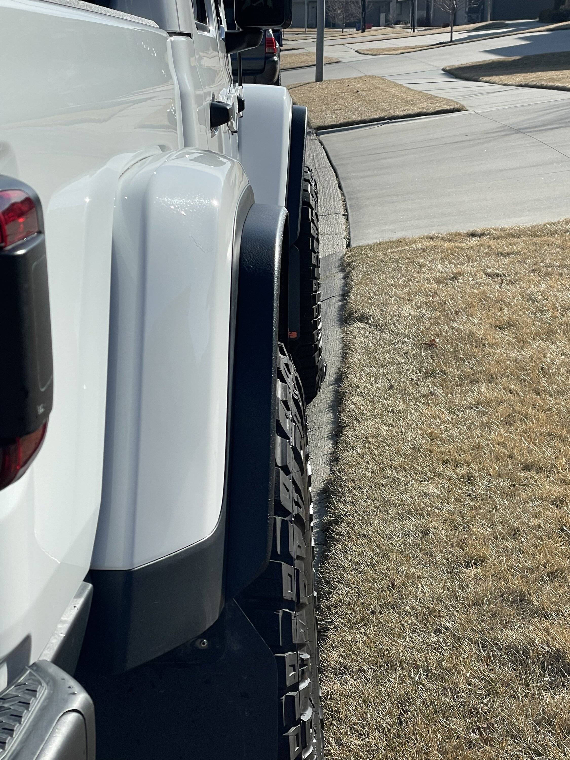

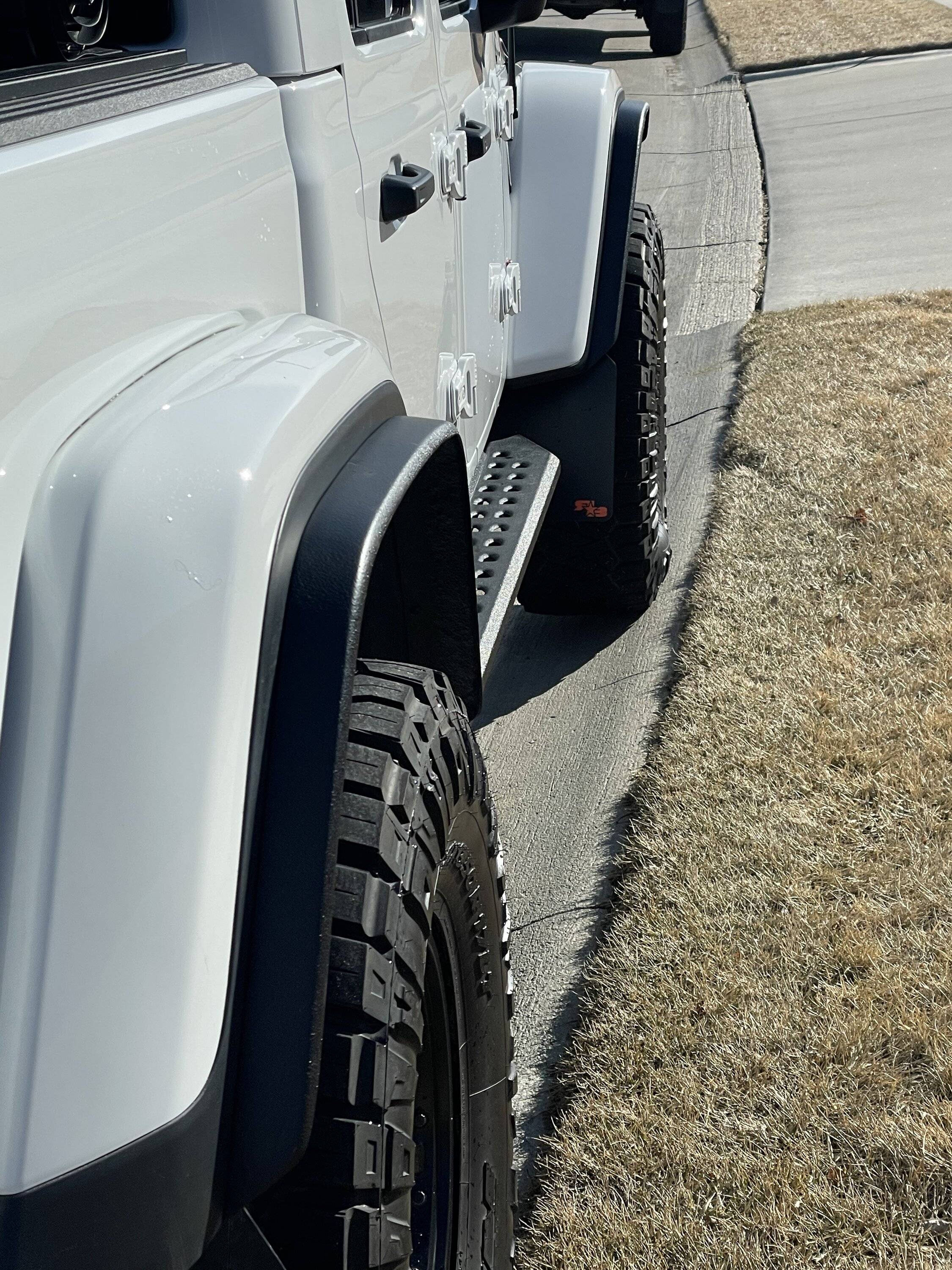

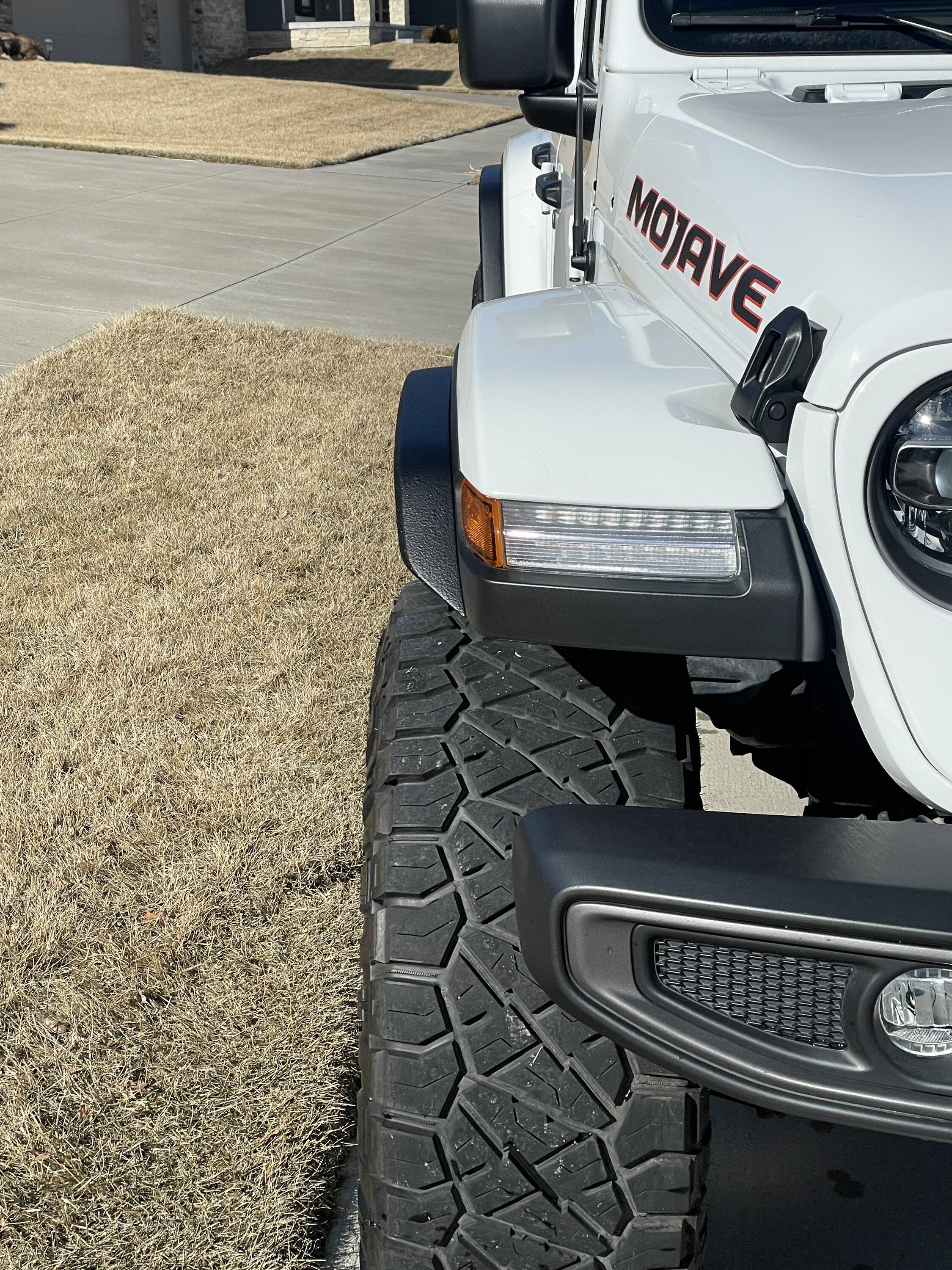

I ordered the DBOR Mojave/Rubicon flares two weeks ago and installed them this week per the instructions on their video. Sanded them with 120 grit blocks and rattle canned them with black sound deadner I ordered off of Amazon. I also ordered a plastic rivet tool and used that for the install. I think it took me a total of 2 hours to install them following an hour of sanding and painting, not including drying time.
Overall, I’m really happy with the product. They are very stout and the plastic rivets hold them tight to the fenders. I hit the car wash quite a bit and I was worried that they wouldn’t hold up against the brushes, but those plastic rivets are surprisingly stout.
The original owner of my Jeep had installed 37” Ridge Grapplers but had also chosen the 13.50” wide versions, which combined with my Icon Rebound Pro’s 4.5” BS and -6mm offset, resulted in a ton of tire poke. I run the Rock Blockz XL mud flaps but they weren’t enough to keep the tires from flinging water, mud, slush all over the sides of the truck.
The DBOR flare extensions have 100% eliminated all my tire poke problems. They line up perfectly with the edges of my tires and prohibit 99.9% of any water or debris from leaving the fenders. Overall I’m 100% satisfied with them. I had been eyeing them for some time but couldn’t justify spending the money when they were $550 plus $200 shipping. As soon as they went on sale I was more OK with spending $550 and giving it a shot. All the extension holes lined up perfectly with the factory rivet holes and as previously stated, they are high quality for sure. Initially I was not keen on having to paint them myself, but the bright side is that I can easily touch them up whenever if needed. If you are considering them. My recommendation would be to find a few others wanting them and do a group buy to save on shipping. I hope this helps, see photos for reference.
Jeep Gladiator Anyone running these Flare Extensions? USA supplier? 2736C06C-5DA6-498A-9A72-8092632C8313
Jeep Gladiator Anyone running these Flare Extensions? USA supplier? 81C29E82-D6F4-4F17-ABA7-18DCD87487D0
Jeep Gladiator Anyone running these Flare Extensions? USA supplier? A98E1AE5-8B32-45A9-9B0B-149AB8D531CD
Jeep Gladiator Anyone running these Flare Extensions? USA supplier? E8C0DBED-37E2-4D61-9829-3A68F922B029
Jeep Gladiator Anyone running these Flare Extensions? USA supplier? 40078678-F888-451A-AA43-E25D8E0B5024

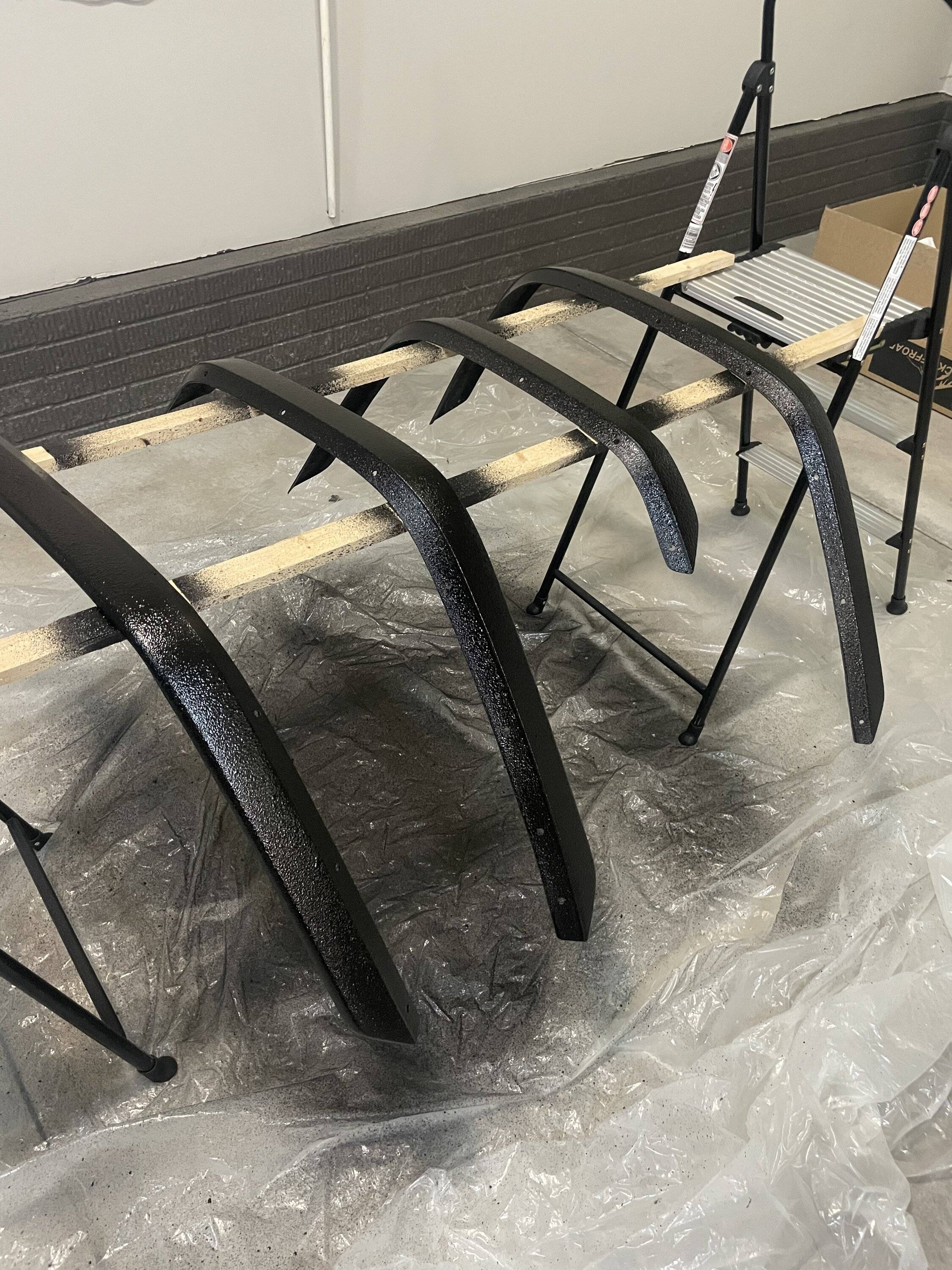

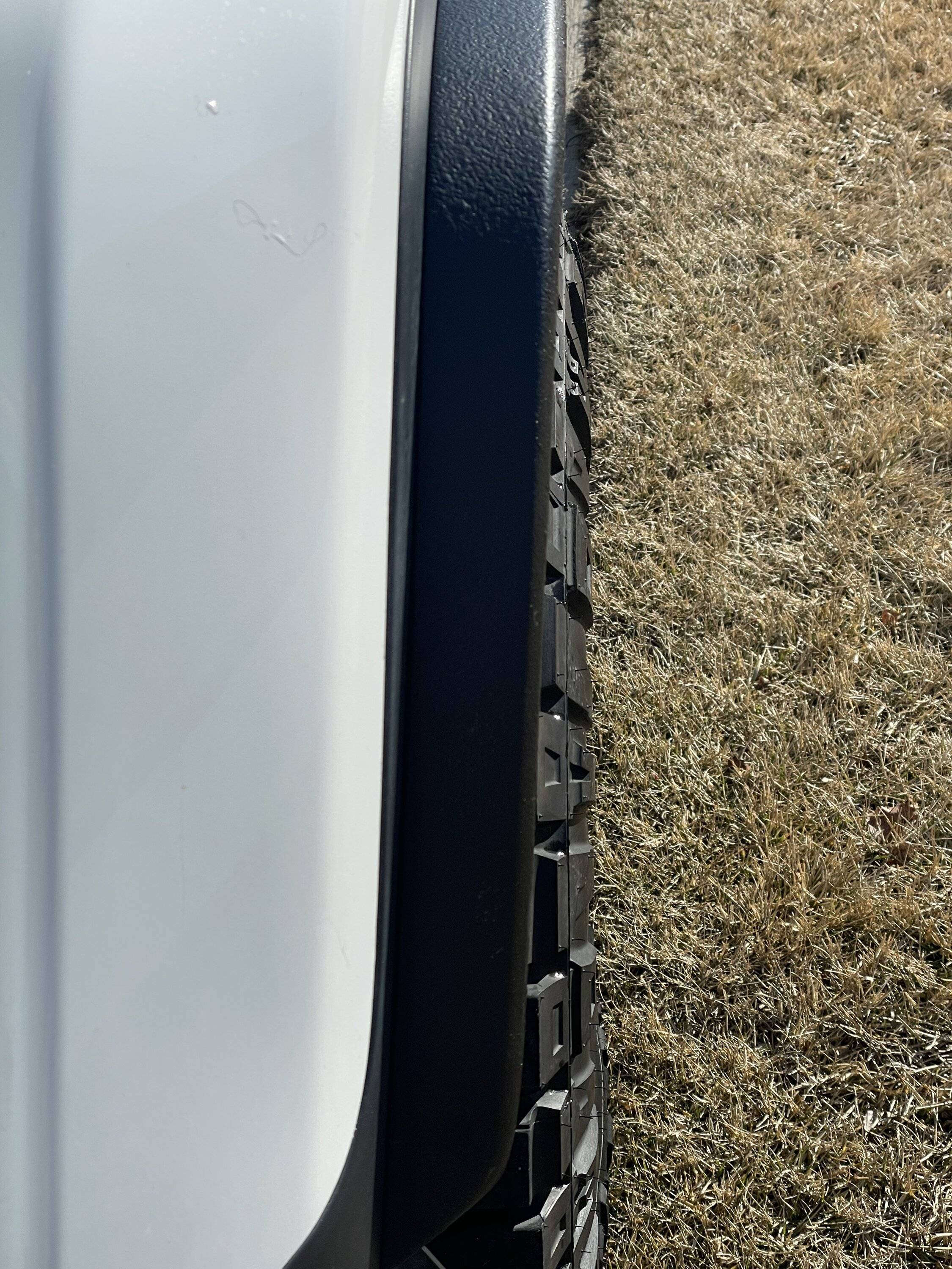

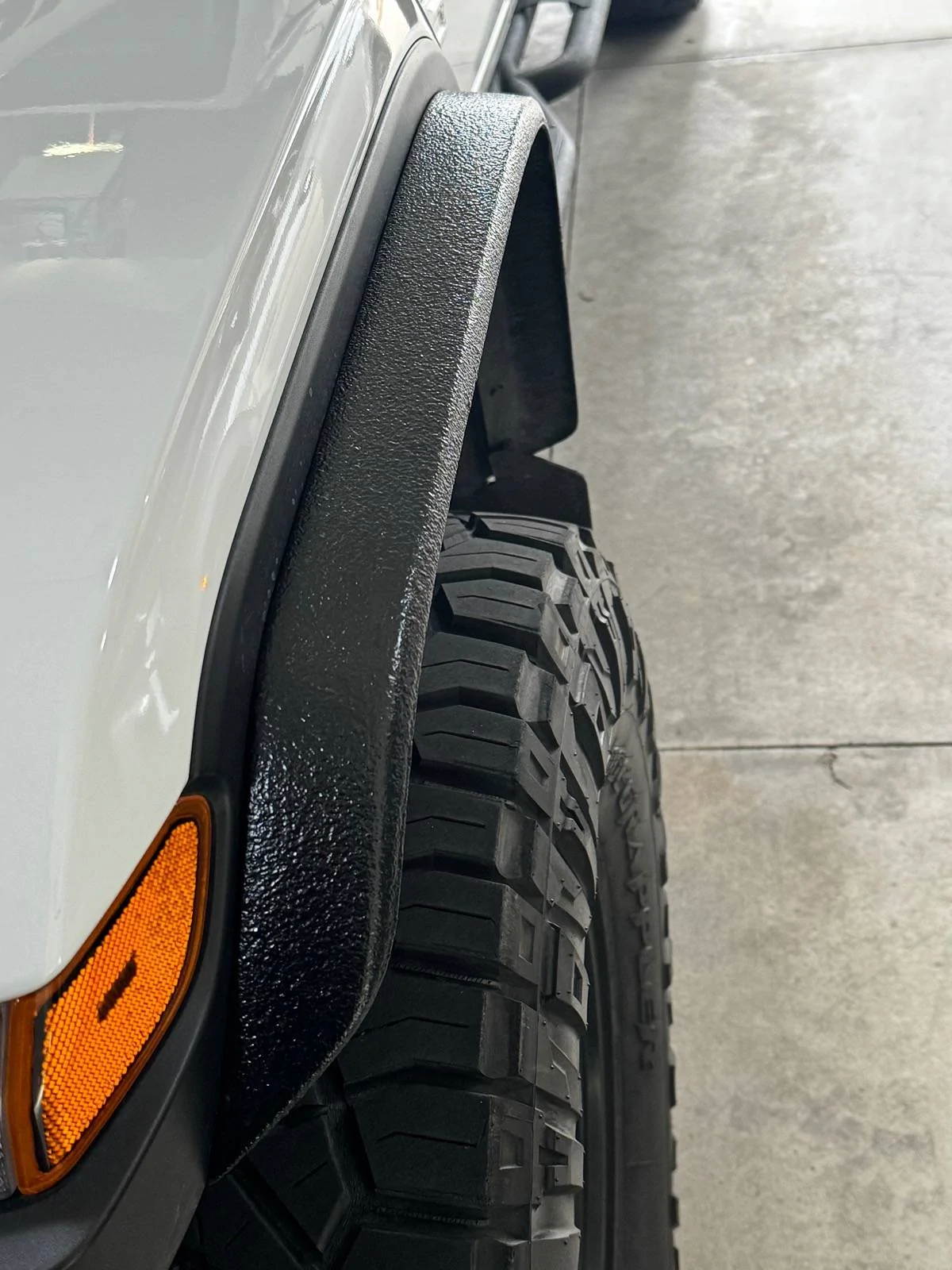

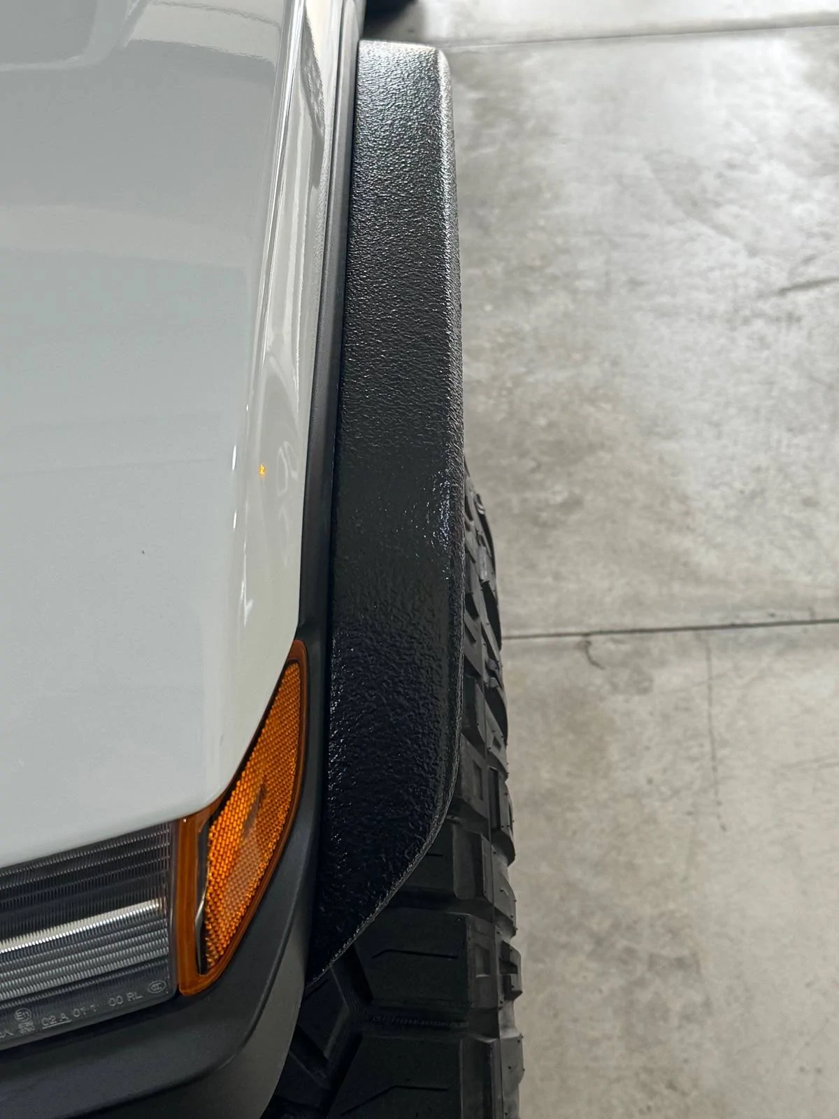

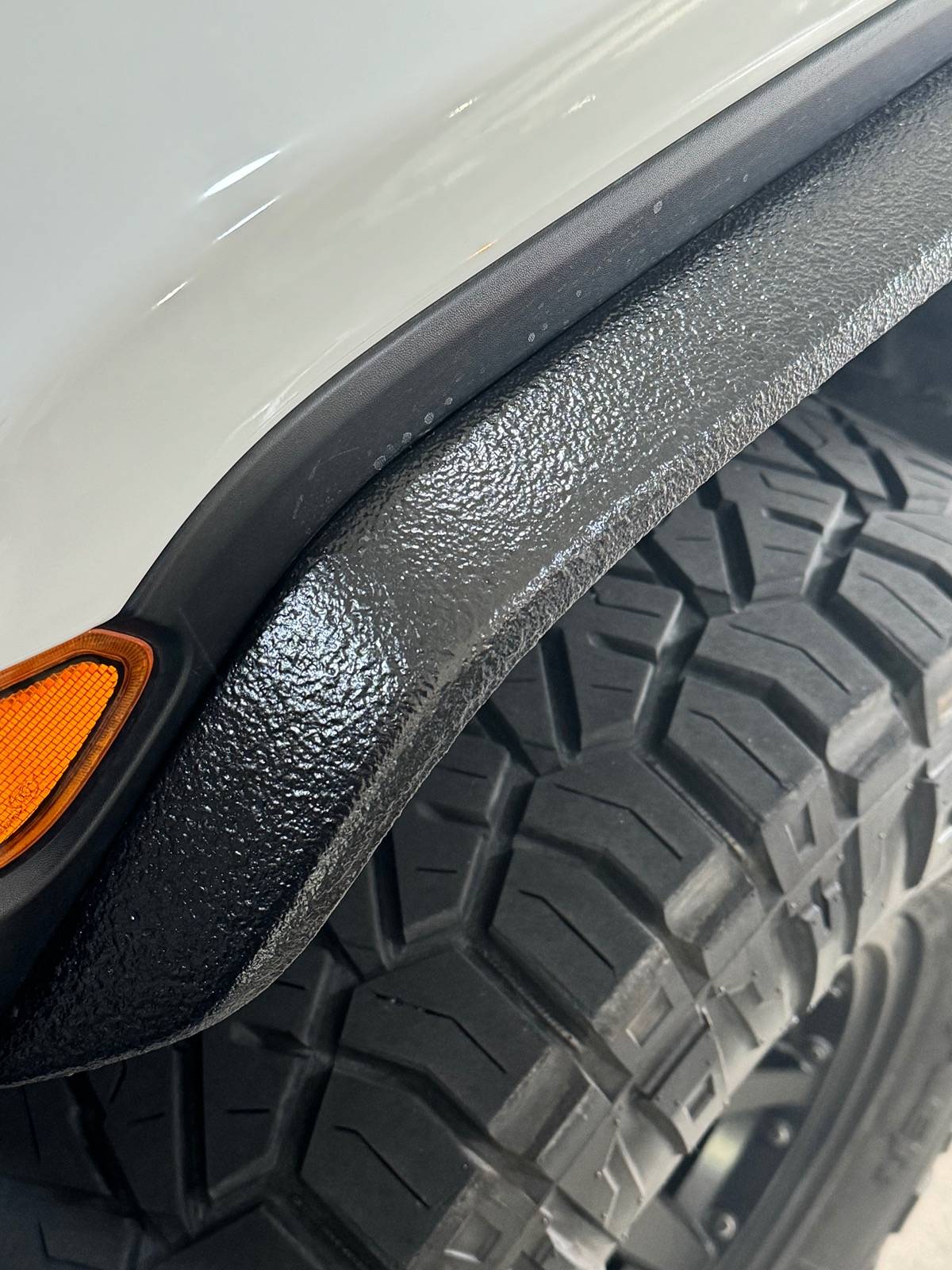

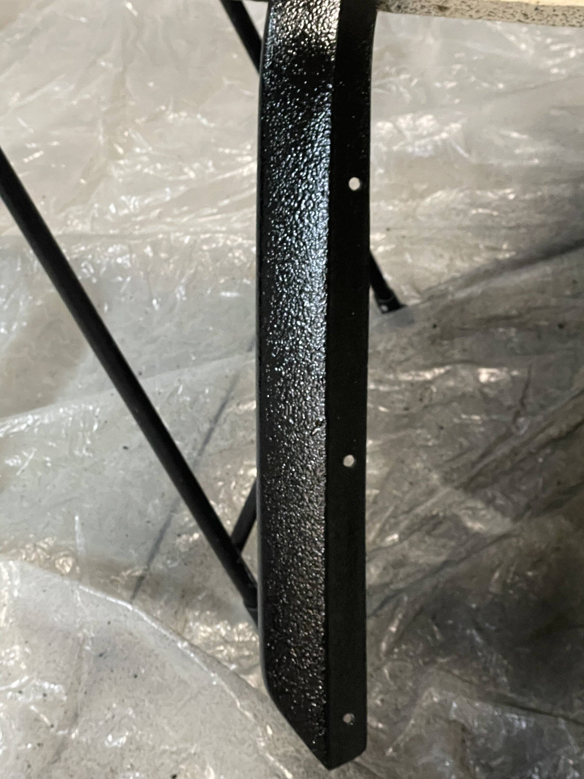

Added a few photos of the finished product with Krylon Fusion. The sound deadner has a bit more of a textured finish than the factory plastic, but it doesn’t really bother me. I suppose if you want a smoother finish, skip the sound deadner and just use the Krylon. The only nice thing about sound deadner is that I’ve taken quite a few flying rock impacts and it camouflaged the damage nicely.
Jeep Gladiator Anyone running these Flare Extensions? USA supplier? IMG_5332
Jeep Gladiator Anyone running these Flare Extensions? USA supplier? IMG_5333
Jeep Gladiator Anyone running these Flare Extensions? USA supplier? IMG_5331
