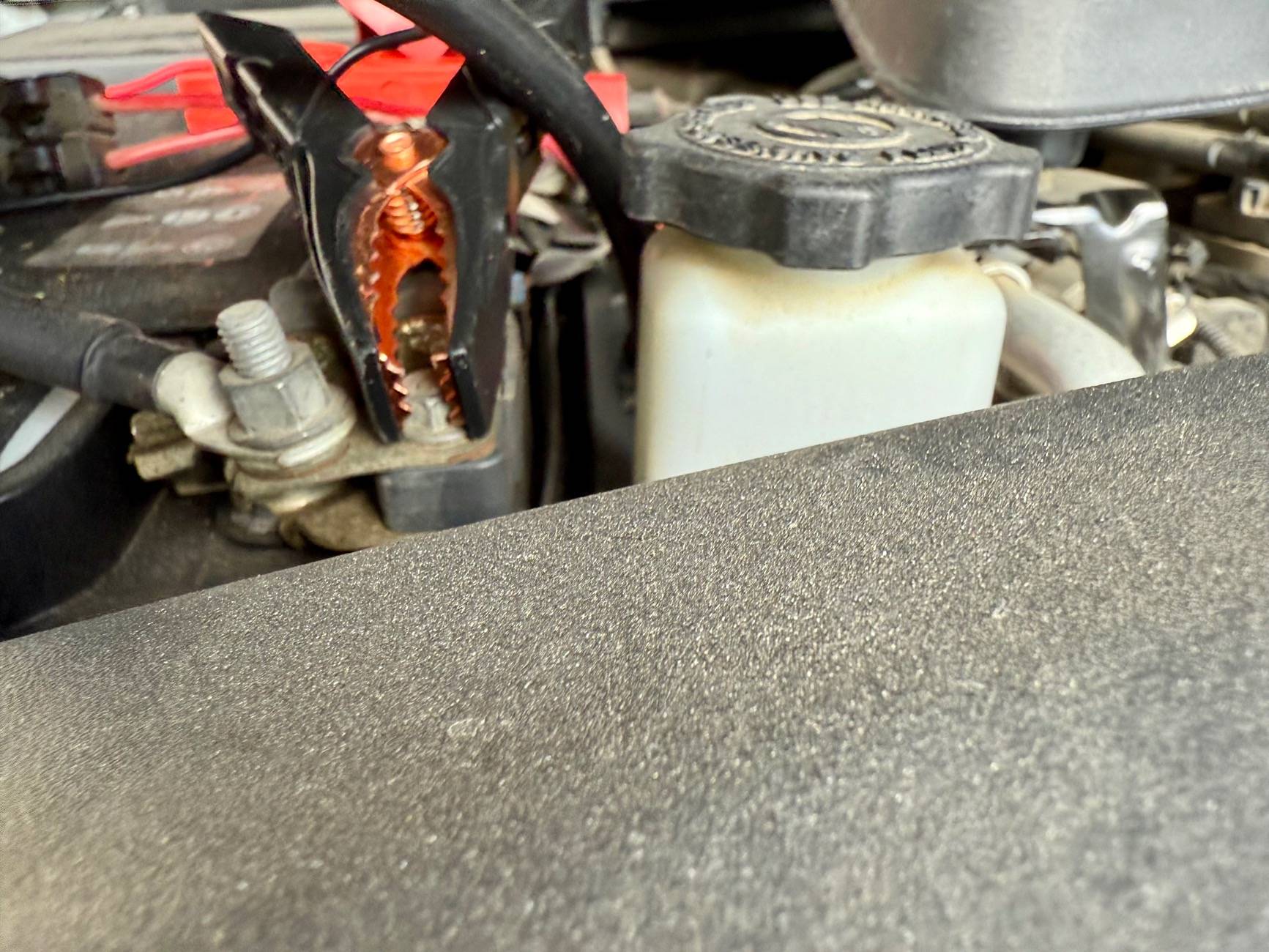

Good news! I found a socket nearby my parking spot and asked permission to use it overnight on occasion.
Is this the correct nut to attach negative to from the NOCO 10 to charge both batteries in parallel? The one right above the IBS. This is a 2020.
Hey @Mr._Bill or @ShadowsPapa - you two were great help on my replacement thread. I was hoping you could look at this picture and see if I'm using the correct negative bolt/stud to maintain the batteries while fully connected in place. Thanks!
Yes, that's a good spot for the negative connection.
