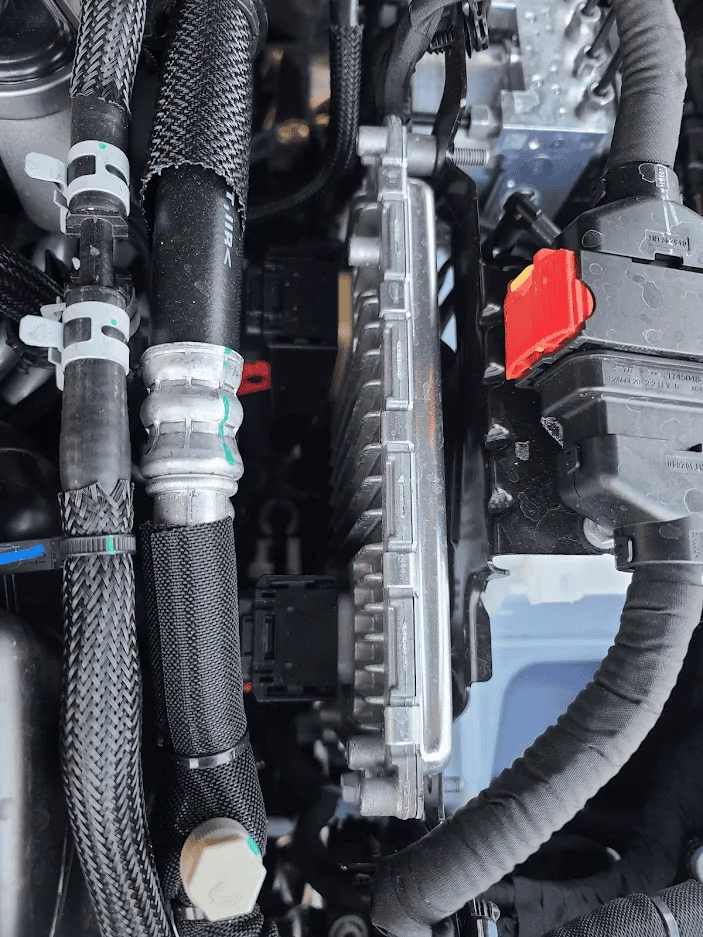

I did see a note about the GPEC2 vs the GPEC5... on my build sheet it says I have a GPEC 2A. Is that the difference, or was there something else about MY22 I missed?

Well, it looks like either FCA changed their spec for MY22, or maybe have/had a parts shortage of the GPEC5's because I think I got a GPEC-2A (which matches my build sheet). Hooray!
Jeep Gladiator DAVECS1 TUNES Now Officially offering Supercharger Tune Support!!! 1643492974048
But... Now I still need $8k ;)
Go Fund Me, anyone? 🤔
