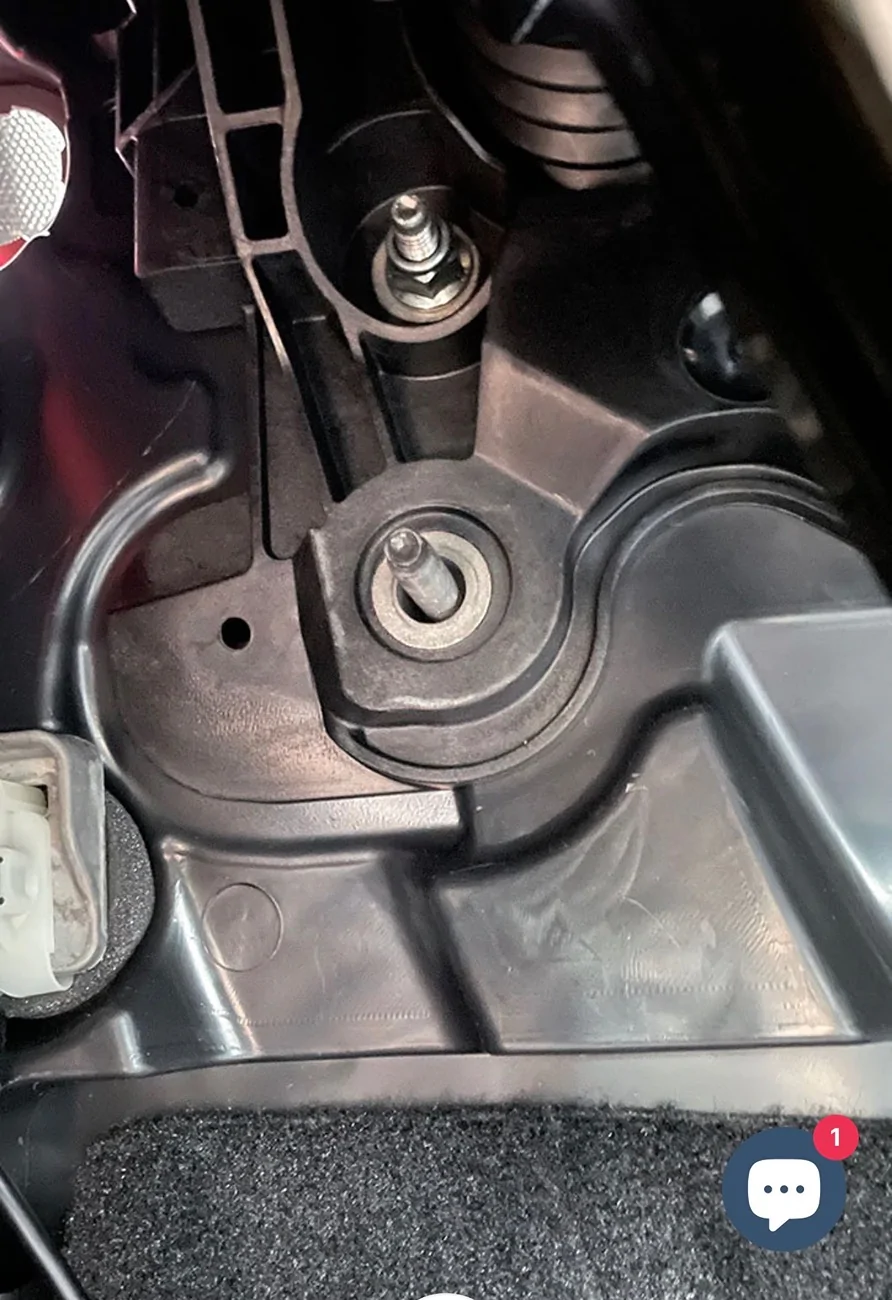

Checked out your 813 pedal and that’s just insensitive of them showing that bolt with the nut so clearly and cleanly off it . . . . .
I had some email discussions with Jeremy on this. IIRC he has a JT Launch Edition. Could be that the bolt was a lot easier to remove. When I told him of my problem he was stumped. I hit that nut with a breaker bar and impact wrench and it didn't budge.
Aside from off road activity dead pedals are a right of passage. By the way, when you go shopping for sockets follow Col. Troutman's advice and get a "good supply of 10 MM sockets". ;)

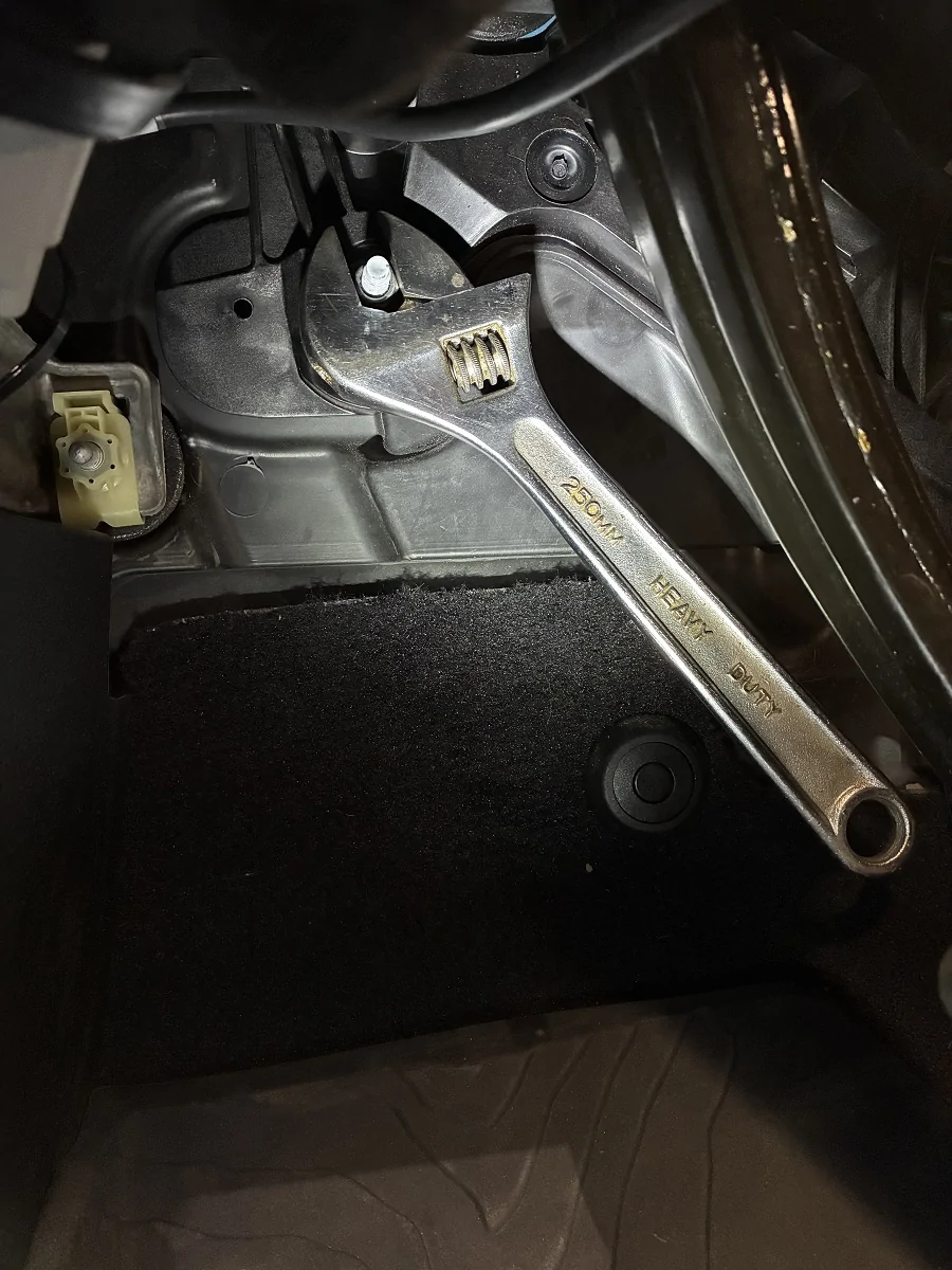

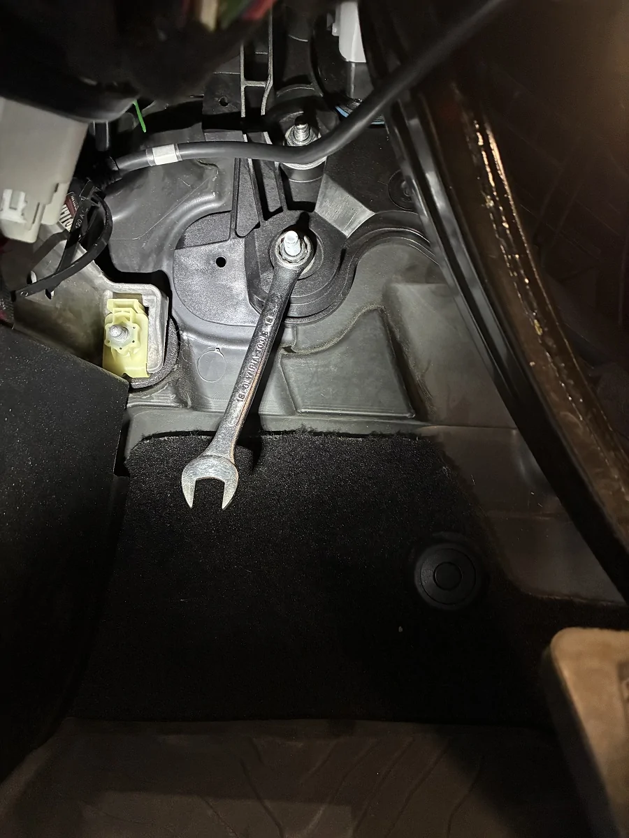

Thank you. I tried an open end wrench and a crescent without luck. The plastic surround is deeper than it looks in the picture. I’ll get a set of deep well sockets, as I’m sure I’ll get use out them down the road too.
Jeep Gladiator Dead Pedal Installation Help IMG_0085
Jeep Gladiator Dead Pedal Installation Help IMG_0087
Pretty sure I could get a 12" plumber's wrench to work as well if I tried. ;)😁
My nut is deeper set down below the top line of the plastic surround. So you cannot get a wrench around it. The plastic effectively makes a separate raised collar around the nut.
Your nut looks like it’s above the plastic, so that’s a heck of a lot easier to get to! Wish mine were like that.
