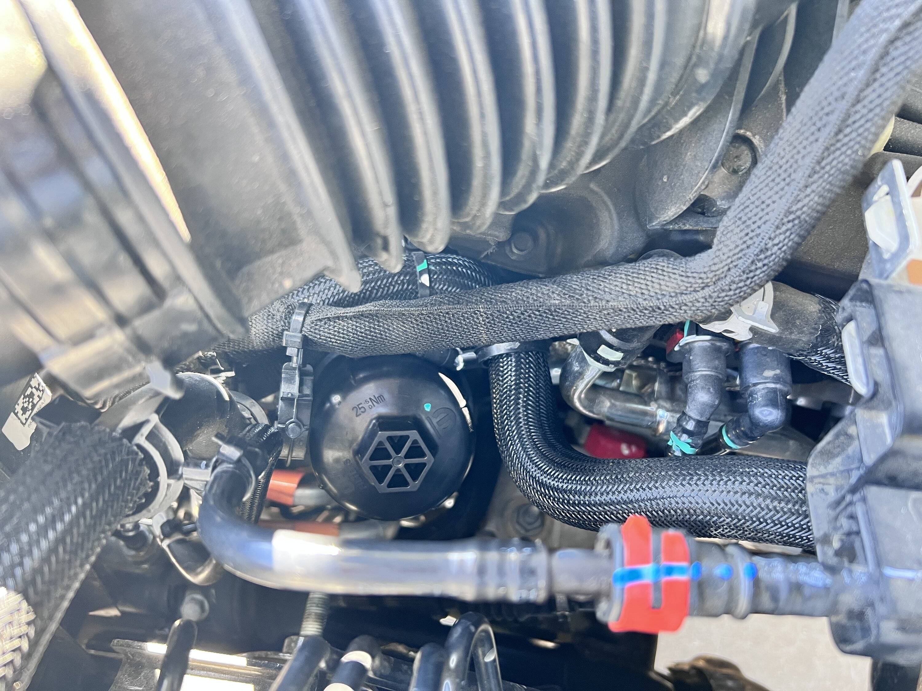

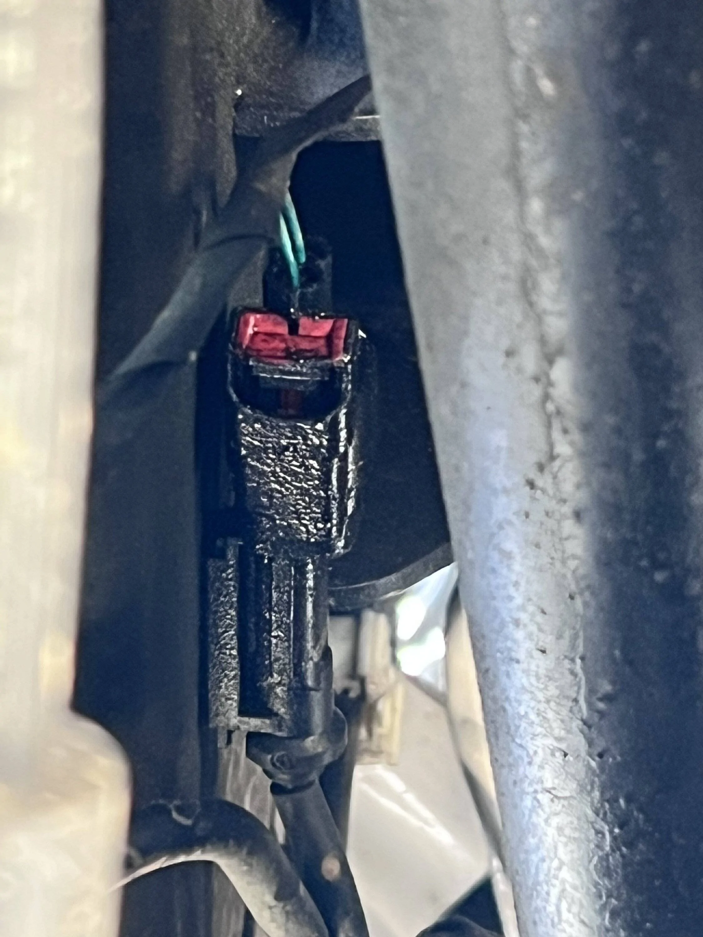

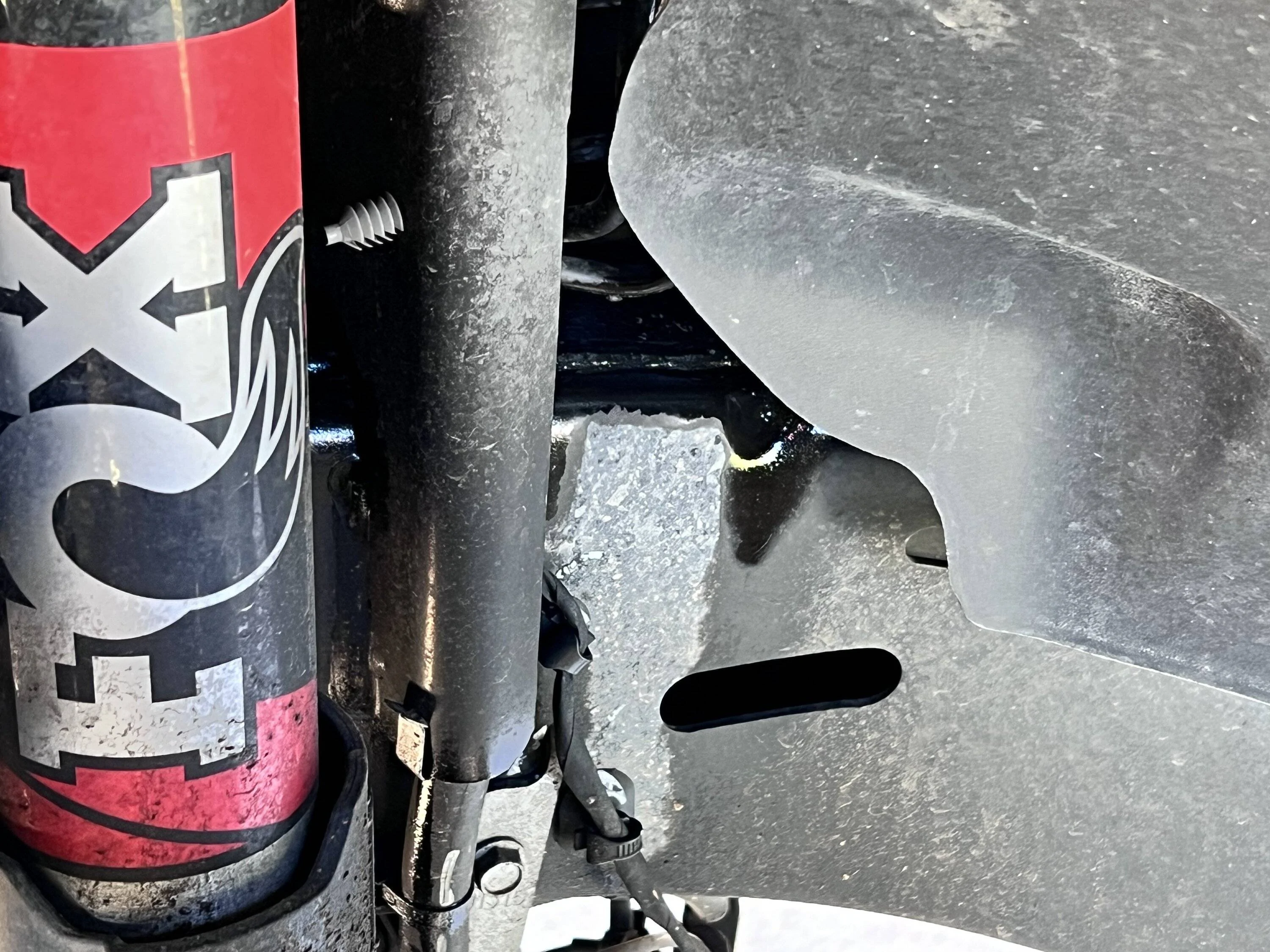

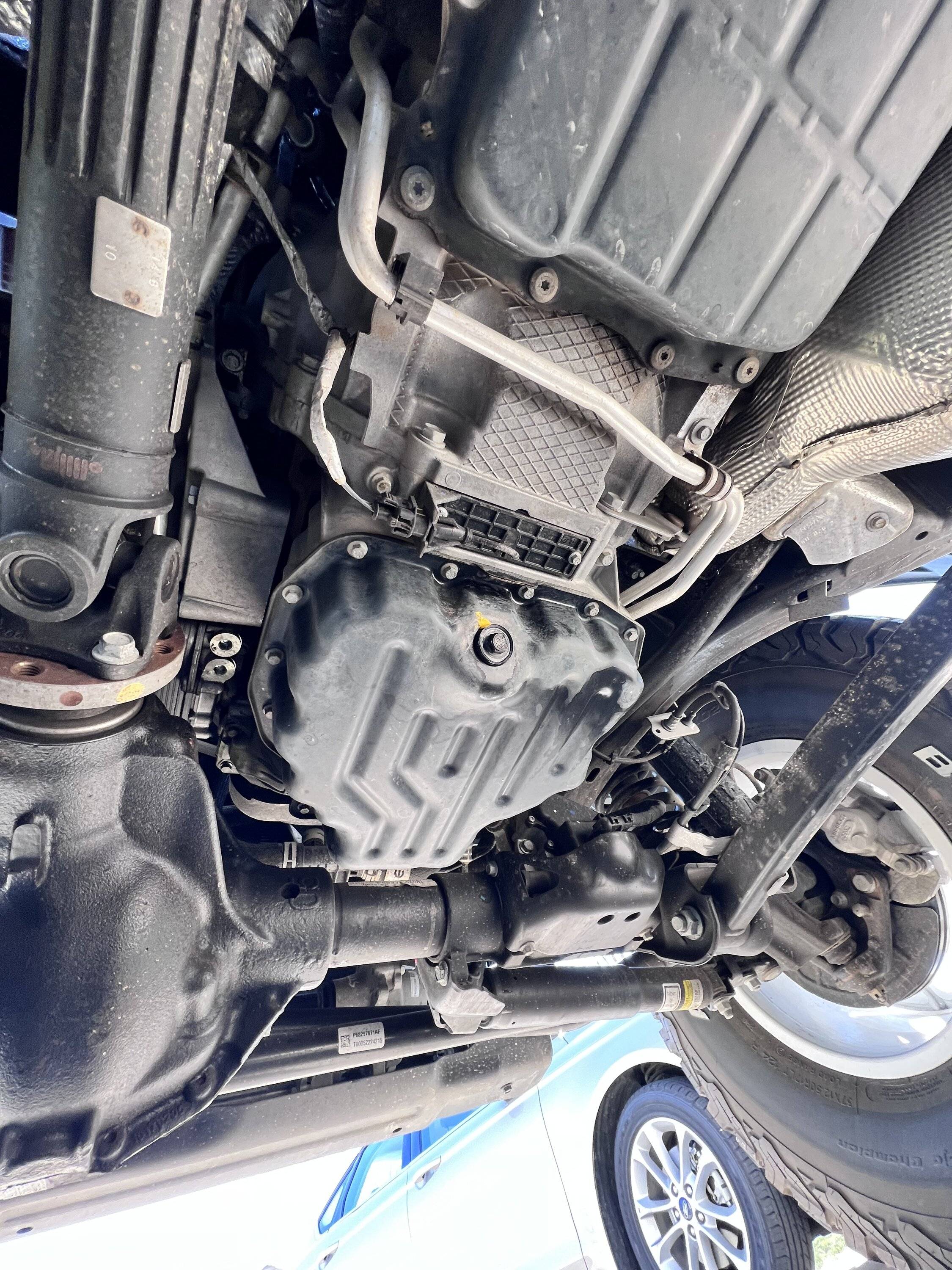

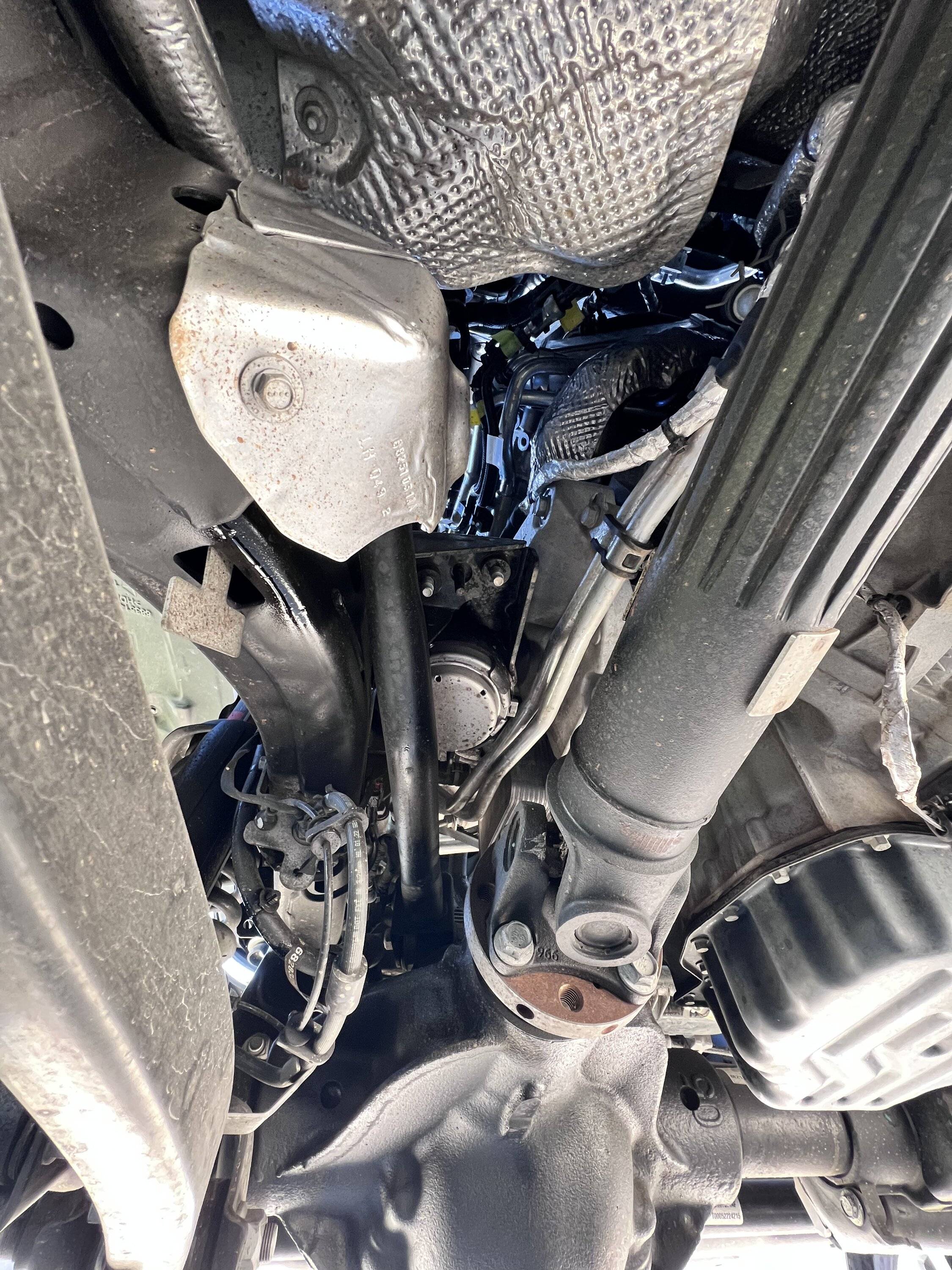

After some daytime investigation it appears the oil filter housing may be where the issue is. Outside of the Plug and pan are dry. Thanks for pointing that out. I have a bad injury to my left arm and the cold weather last night prevented me from getting a good look from below.
I am feeling a bit better. I have had a few others describe “no oil” as well and it appears I wouldn’t have made it 100 miles if there

History of the oil filter blowing off?? First Ive heard of it...thats not good, wtf
It's a mix. They don't explode but some have had cracked plastic housings causing the oil to leak out of the filter plastic itself, others have had the seal go bad. Hot oil pressure is much lower from cold so they get home, truck sits over night. Cold start and pukes oil. Happened on my buddies JL. They blamed the filter but it made a mess of that side. One ecodiesel owner had his block replaced because it kept leaking at the cooler. Warped mounting surface to the cooler supposedly. If you search both forums for ecodiesel oil leak or ecodiesel oil housing they show up.
Recap:
1. Oil filter seal
2. Cracked oil filter housing or plastic cap
3. Oil cooler seal
4. timing chain cover seal
Those are what I recall the top problem children are, in no particular order from reading these 2 forums.

I don't see a lot of oil. If you lost everything while driving I'd expect it to be everywhere.
tship22
Tony
Aug 21, 2018
St. Louis
No jeep yet...
i agree. Not much oil. I was parked after just filling up from fuel and running in the gas station when it happened so it hasn’t been moved besides being towed.
I shut it off immediately after restarting it at the gas station when I saw the bright red oil pressure light. let it reset. Started it again a few minutes later and the same thing happened. Tow truck driver started it 2 hours later when he arrived and it had 76psi or so but started dropping pretty quickly as I guess it was warming back up. We shut it off again and towed it home.
My best guess is the housing is possibly cracked and it lost pressure when I started it back up the first time. Then it cooled off again for enough pressure to build on start up when the tow truck driver arrived.
Oddly enough I had a broken oil cooler on my 14 JKU with the 3.6. Both seem to be plastic housings…
Will update Monday when I can talk to the dealer.
thanks again for all the help.
