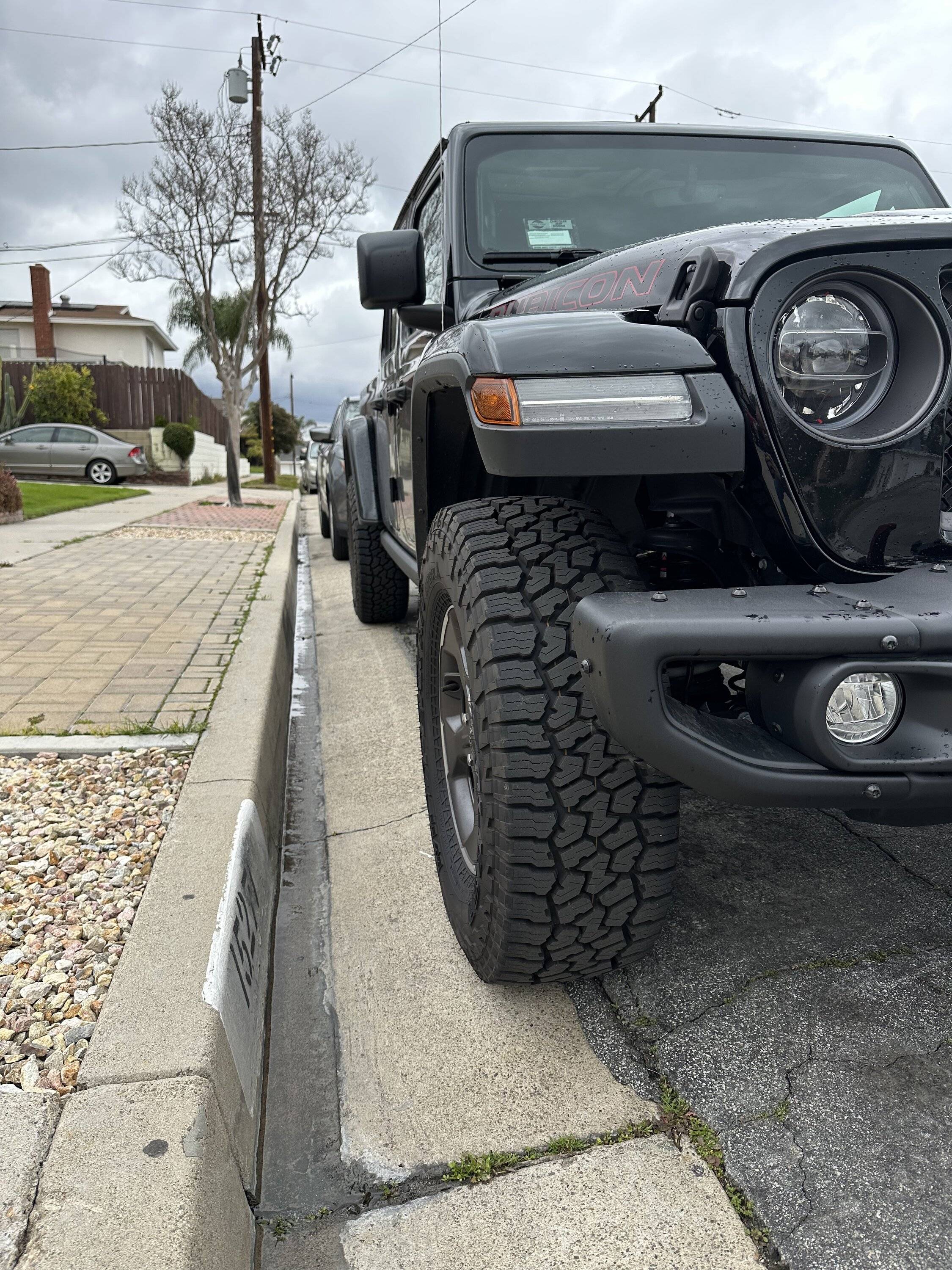

If it's rubbing it should be leaving marks. Almost kicking myself for this, but how about two more pictures?
1. Side view of the entire truck
2. Where it's rubbing
I'll be up all night over this if it doesn't get answered. ?

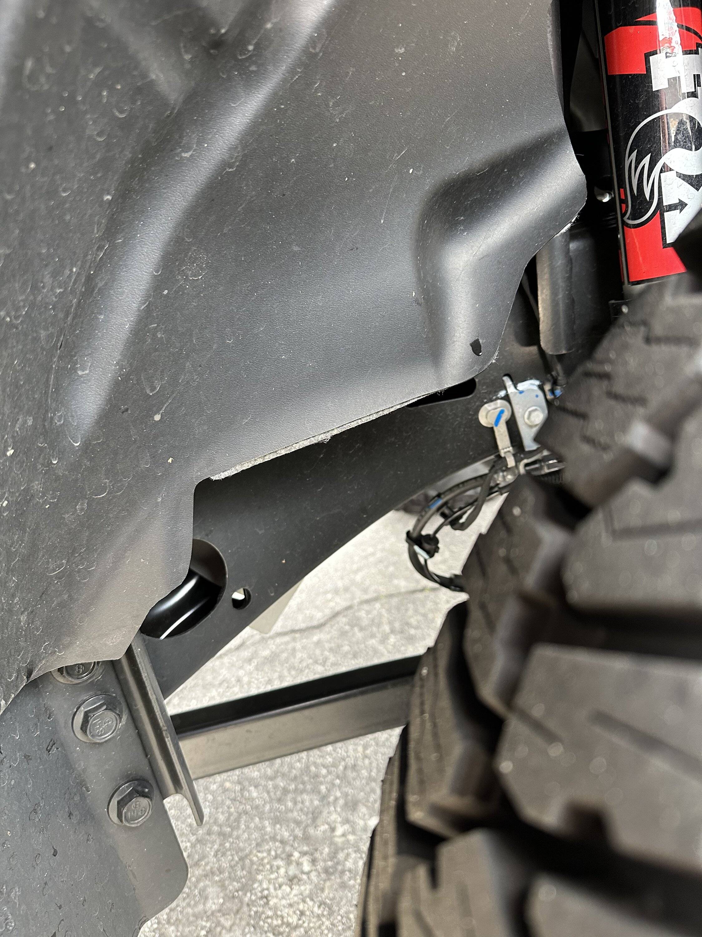

Jeep Gladiator Dealer service (or lack of) vent 2480649C-4186-4296-A703-A3322F52FDE4
Jeep Gladiator Dealer service (or lack of) vent DFBBE0D3-83B4-4647-8BF8-0F6A7B7062CE

So if it is a stock, new Rubicon you purchased, I would check the sticker on the inside of the door. That yellow and white sticker will show the stock tire size. Take it back to the same dealer, have them hop in for a ride along to demonstrate the issue you are having. It is very easy for a dealer to say, “not our problem,” unless you force them to fix it and do the work. You can also turn at full lock and crawl up under the vehicle to see what is touching. I’m sure it’s a fender liner or something relatively minor. On the off chance there was an incorrect part installed, it should be a dealer problem.

It could be something so simple as your steering limit stops weren't setup correctly.
Do both sides rub or just the passenger side?
Both sides rub at full lock or encountering bumps while turning
I agree, and that’s what I was trying to do the first time, but was turned away. It definitely could be something minor, and in fact, appears this way. I was just being Uber careful having only 200 miles on it at the time to let the professionals check for anything sinister. They just discounted me full send and sent me packing for having aftermarket tires. Lol. Whatever. I appreciate everyone’s comments. I’ll trim the small piece of liner and that should fix it. If it doesn’t I’ll be heading to another dealer to have it checked for more.

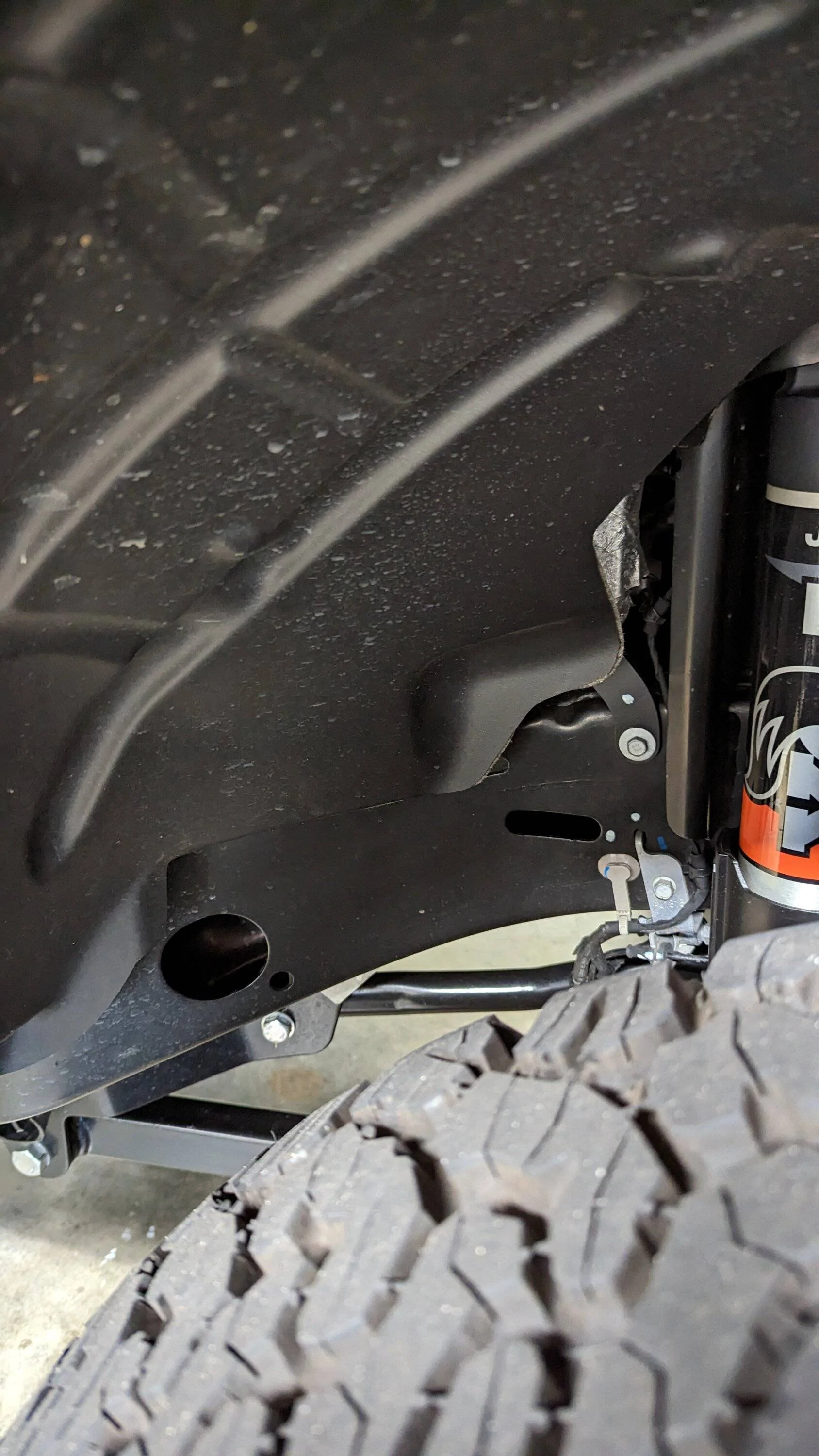

Hard to tell from pictures exactly, but comparing the picture and lunen's example, indeed just looks like the liner is slightly bent, push that bad boy in with a slight bend, and should be good. Honestly that's what I would do as a Tech. There was a TSB on Ram's where that was the exact fix for the same issue.
I wouldn't trim anything. That dealer is a disaster.
