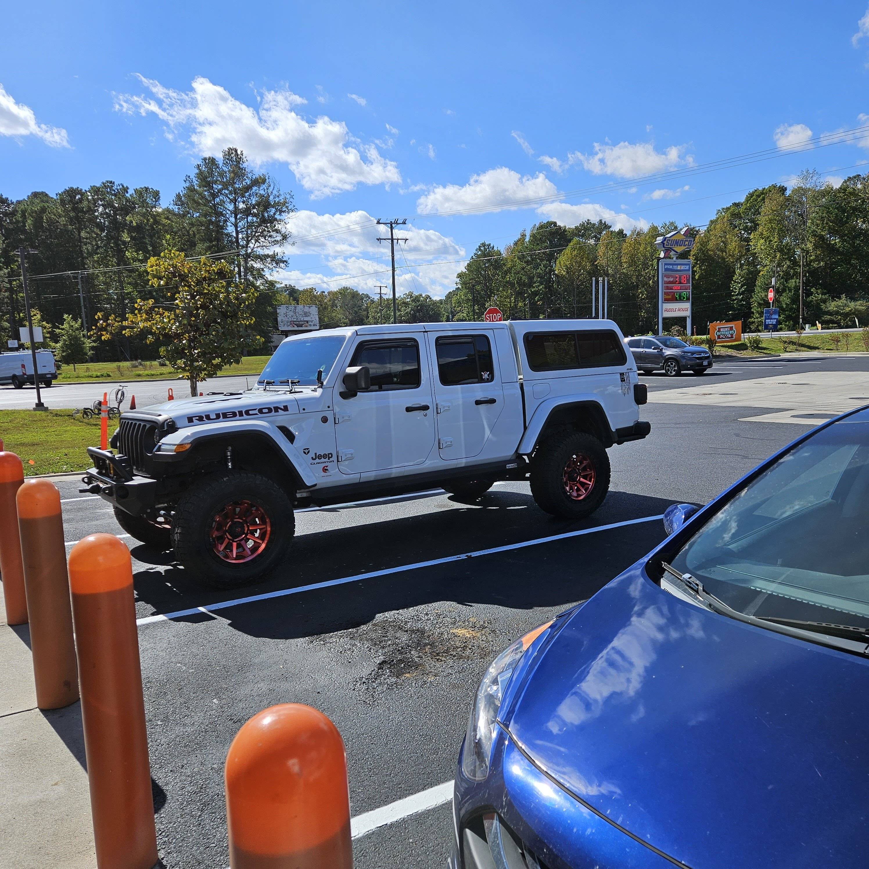

My dealer just mine under warranty ...32k miles? Tech was able to do everything from the top side. No need take bumper and tires off and have Quadratec stubby and Quadratec winch with 20 inch rims and 35 inch tires (which i hate btw...anyone wanna trade for factory Rubicons?) ?? Sounds like load of bs.
