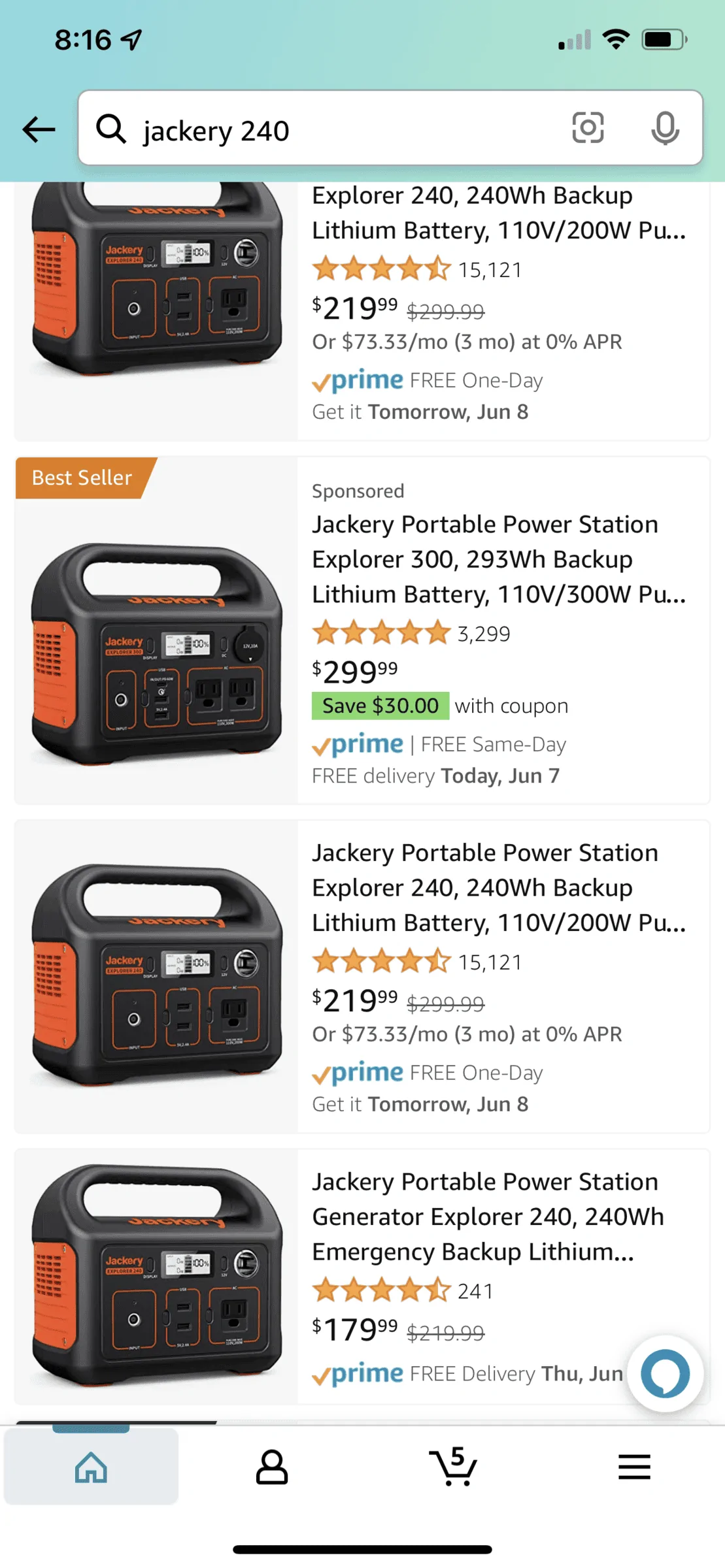

Considering Amazon has it for as low as $179, it doesn’t seem as that good of a deal.
A 240 is not a 290. Different Wh and different max wattage
How right you are. Good eye. I was going off of the photo of the unit. There’s now a 300, which tells me the 290 may be on the short list of becoming discontinued.

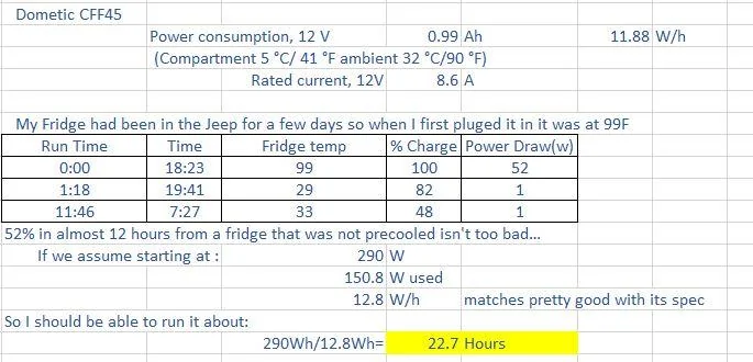

Is is perfectly capable of running my fridge for a couple of days but I used it buy connecting the 120VAC charger to the port in the console (switches off with the ignition) and then running my fridge into the Jackory 12v port. Kept the fridge running overnight and recharged while running down the road.
It will not power everything, just depends on what your needs are, works for everything I need and like I said, I can series two if I need more amp hours.
Not to get to side tracked, but not a fan of amazon so I try every other source before give him his cut :)
The main point of the post is that you don't have to spend $1k to get into these, just do your homework on what you actually need. For $250 (or less) they can be very handy.
