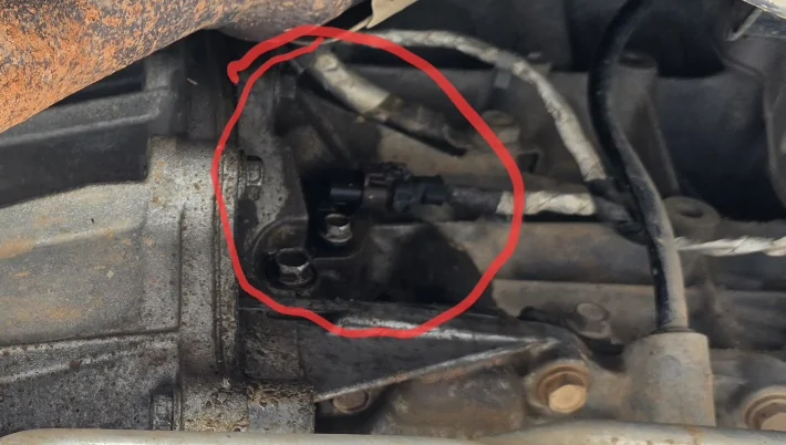

Passenger side rear of motor right in front of the transmission . Easy to see . Let me get a pic.
Edit for pic:
Yes I have some old oil on there from the bad PCV valve I changed don't pay it any mind keep forgetting to wipe it off.
Thanks. I don’t judge. Mine is filthy.

OP I still think you should try crank sensor .
