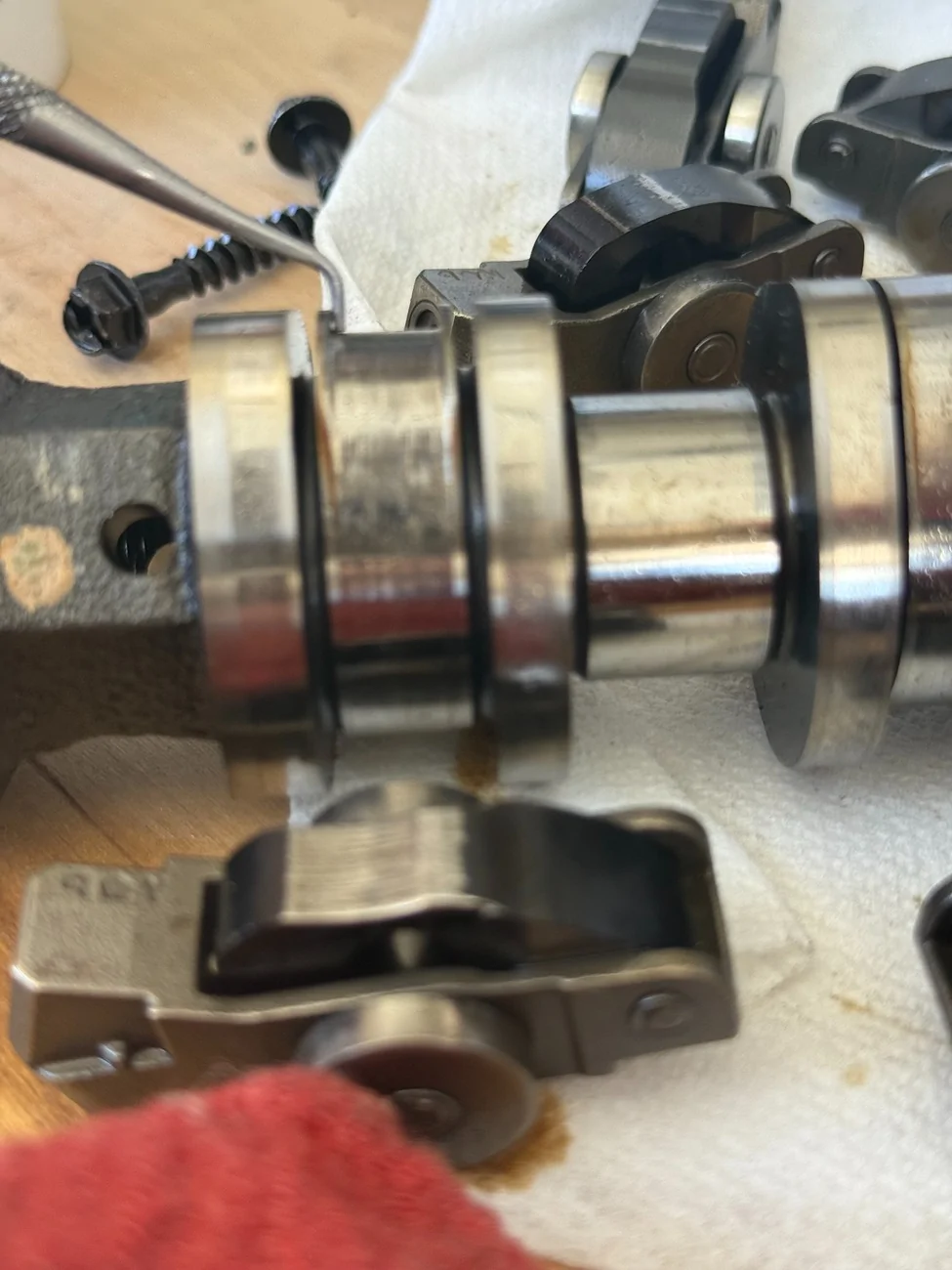

Here's a lovely potato phone shot of my future "It's a Jeep thing, you wouldn't understand" plaque.
Jeep Gladiator Deciding to give up on Jeep IMG_3109

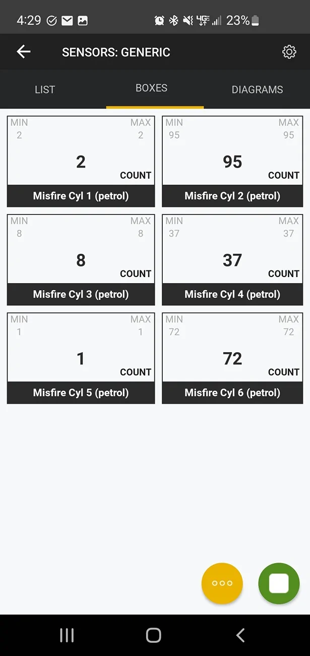

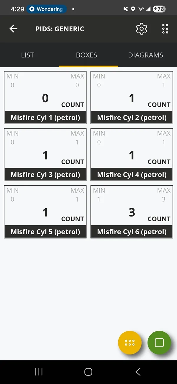

My drive home today. 4.7 miles and since I was data logging I gave it a good rip to 5,500 RPM though normally this drive is below 3,000-3,500 easily. I also spent a few minutes sitting in the drive through at the pharmacy.
Jeep Gladiator Deciding to give up on Jeep randomdaynoissu

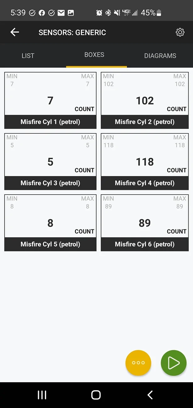

The next two data logs are from when my truck does the CDIFF misfire. These are from 2023. I stopped data logging the data after I had enough to say 'Yep, this is likely the issue', so it's been a while.
It still does it to this day, but since I have narrowed it down to likely firmware issues and I can even tell you when it will happen - I honestly haven't cared enough to leave it at the dealership.
These are over a period of 30 seconds I'd guess, based on memory. That's about as long as the episode lasts before going away. It's an obvious rough misfire where if I come to a stop I can feel the truck shaking.
Jeep Gladiator Deciding to give up on Jeep Screenshot_20230719-162905_OBD JScan
Jeep Gladiator Deciding to give up on Jeep Screenshot_20230720-173941_OBD JScan
