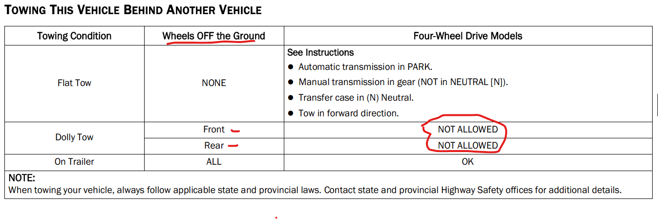

Wow, don't they know these are to be trucked, not towed? 4 wheels on the ground or 4 off the ground, but not 2 and 2.
Never lift just one end and tow it.
On a trailer or fully on a truck is the best.
Flat tow is fine IF you follow their instructions and tow in a forward direction, not backwards.
But either front wheels on the ground OR rear wheels on the ground with the other end up - no.
