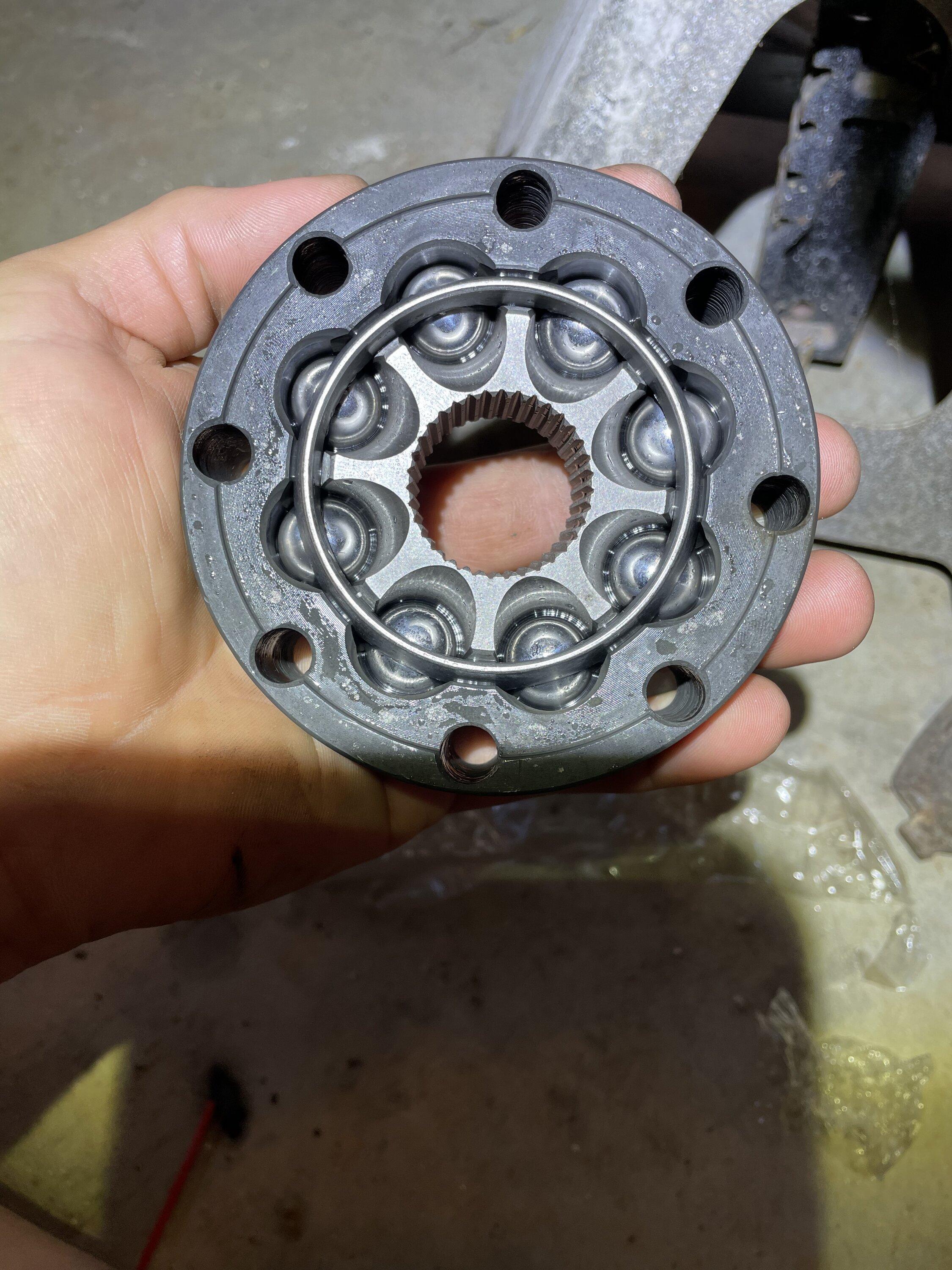

the replacement cv didn’t look like that. i think it was heat from loosing its grease. but i honestly have no idea. you could be absolutely right. here is the replacement. the replacement was a fairly cheap amazon part ($60-70)but worked fine for over a year before i sold it.

The blueing you are seeing is from the heat treatment / hardening of the part during manufacturing.
Exactly. You see that on the axles I use as well, and on the ends of push rods and other parts that are heat treated.

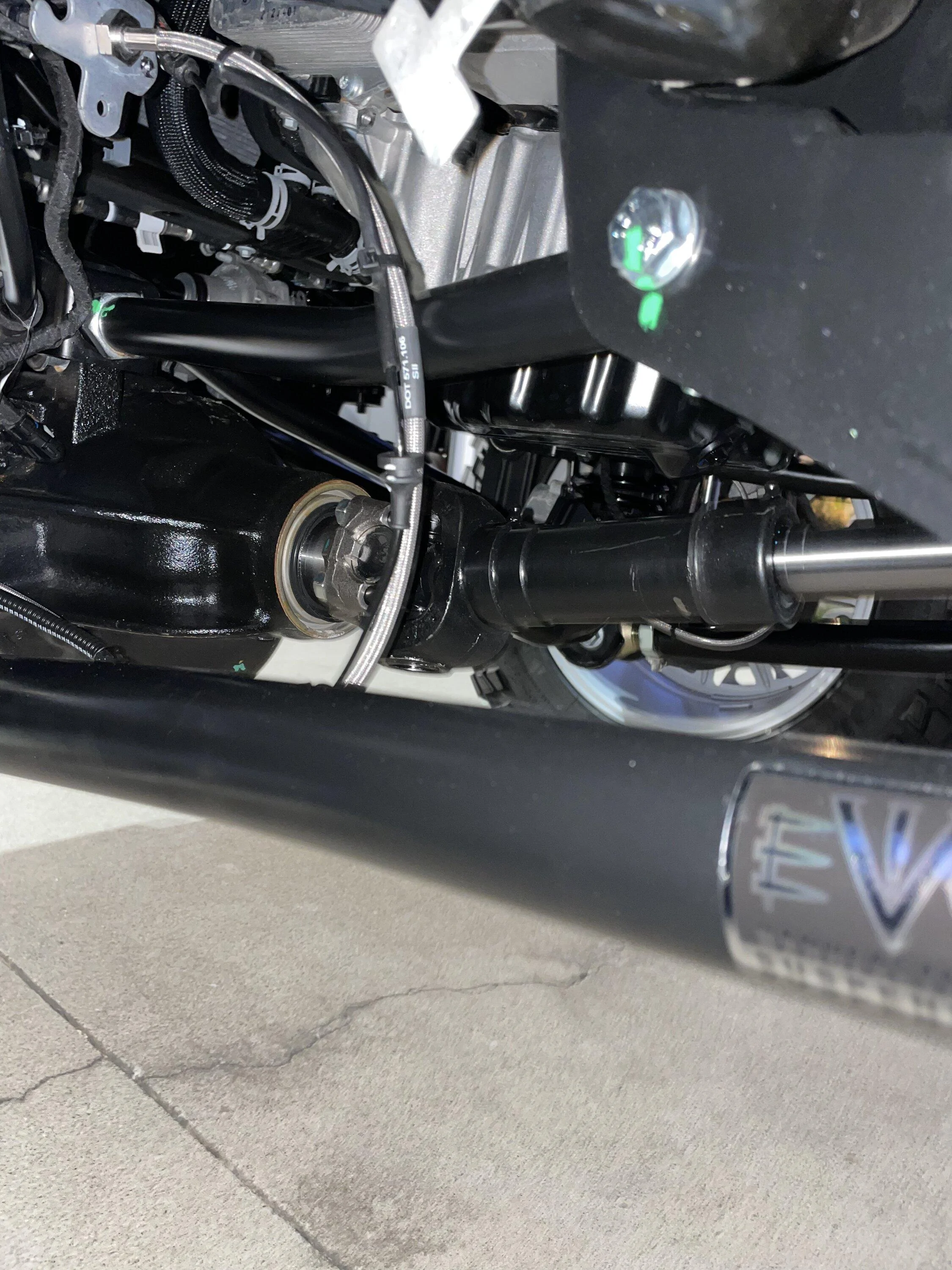

Well yet another major problem. I heard something clinking around under the gladiator and this is what I find. 11477 miles twice off road on real trails. I definitely had plans to replace it, I guess now’s the time. The fronts been done from the beginning due to the 4” EVO lift kit. The arch was to far out so I replaced it with Reel drivelines out in Pomona. I’ve used them before never had any issues.

So what is the fix here? I run a 3.5" with BFG 37's. Should I adjust the rear control arms so that the pinion is looking straight at the DS? Carrier bearing spacer? Aftermarket DS?

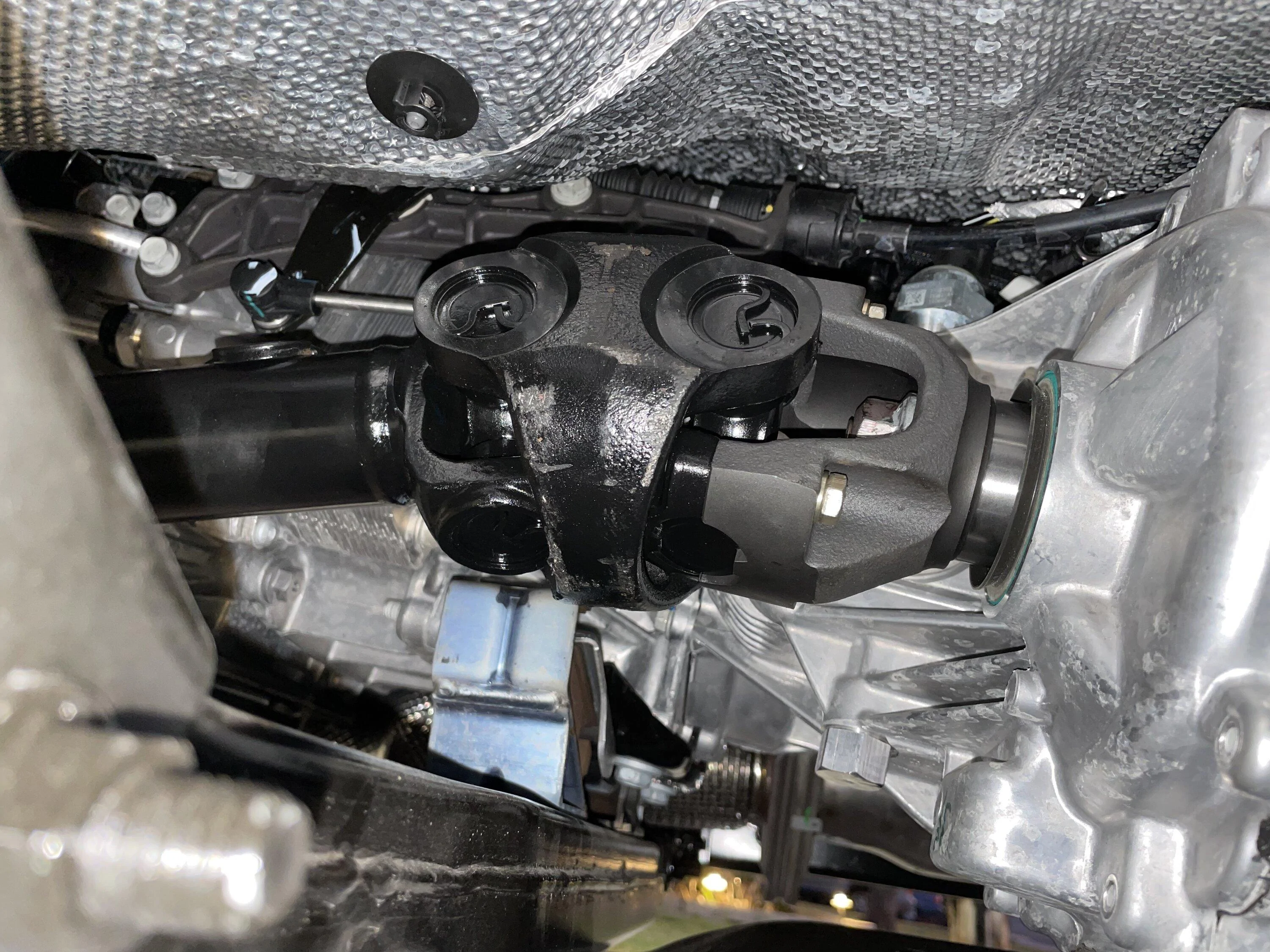

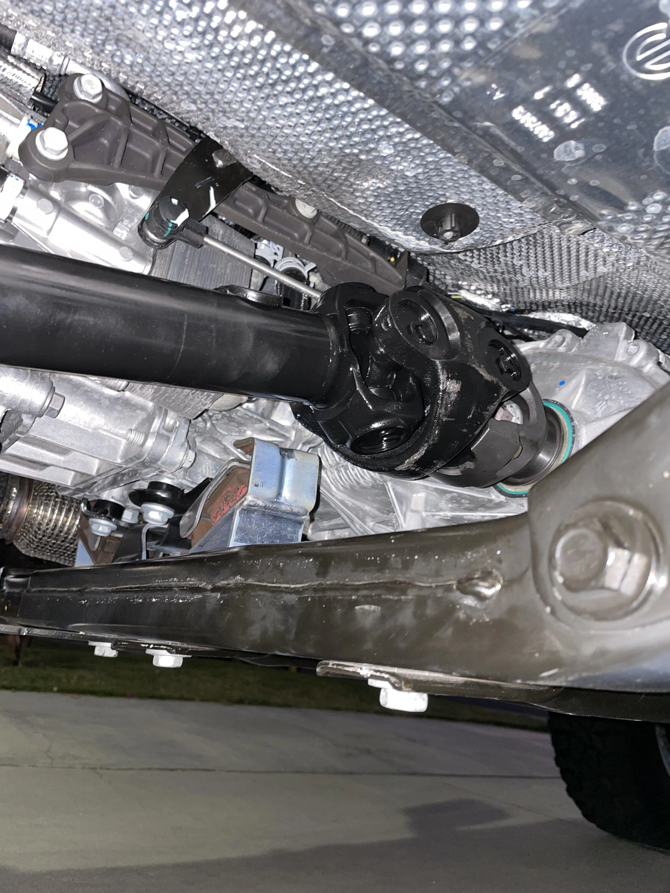

Well as for my plan, a Reel custom built 1350 heavy duty two piece drive shaft. I’ve owned two prior to my gladiator and never had this sort of issue before. I had this one installed a few months back on the front differential. There was no way the stock one would have even worked with the amount of lift I added.
