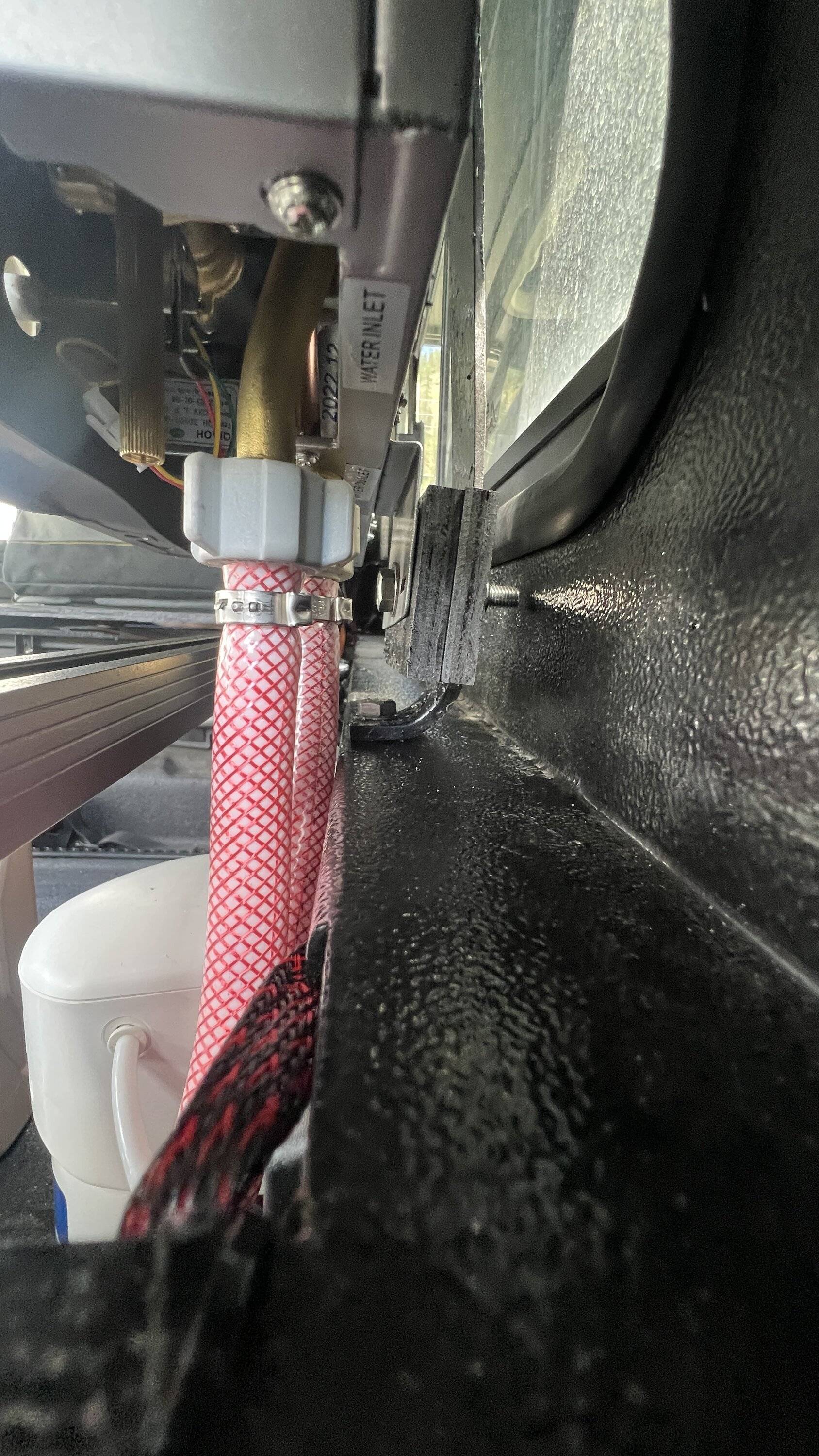

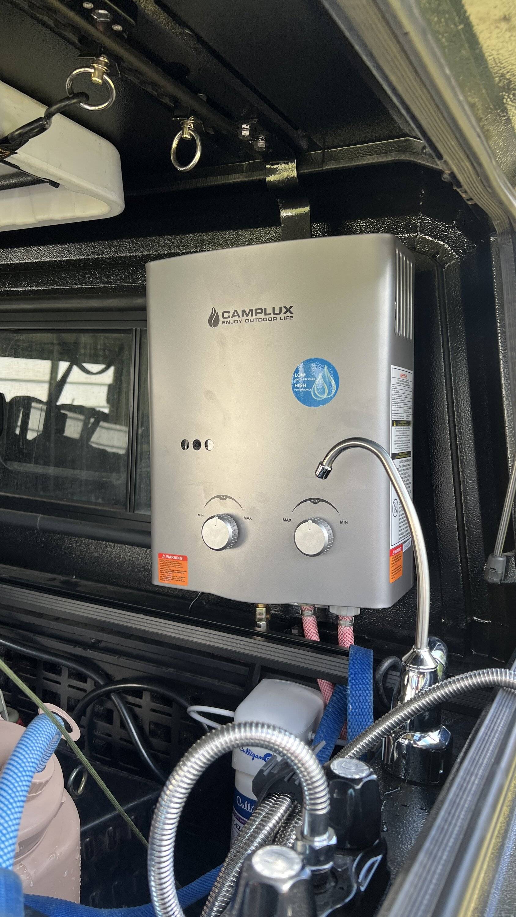

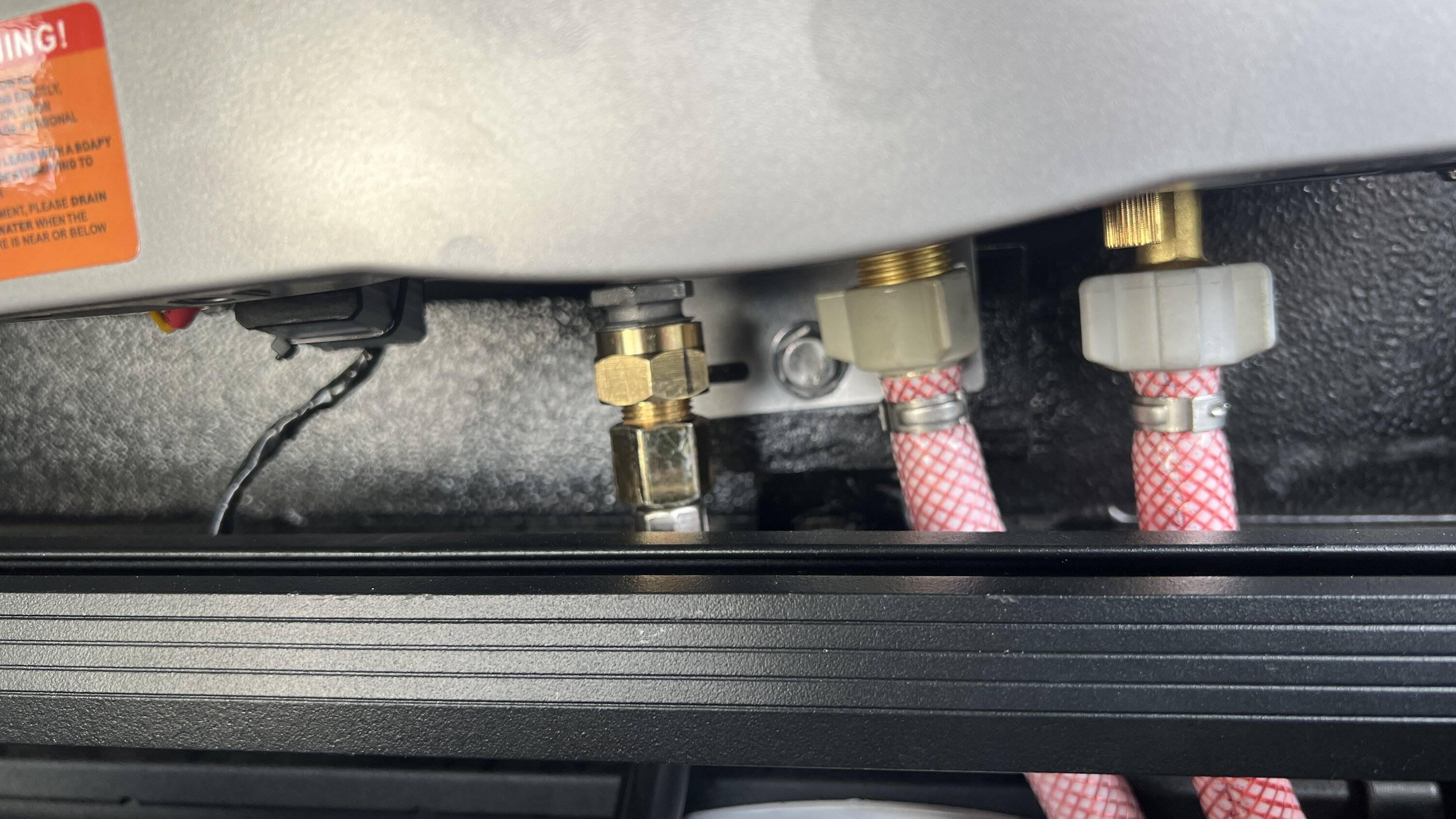

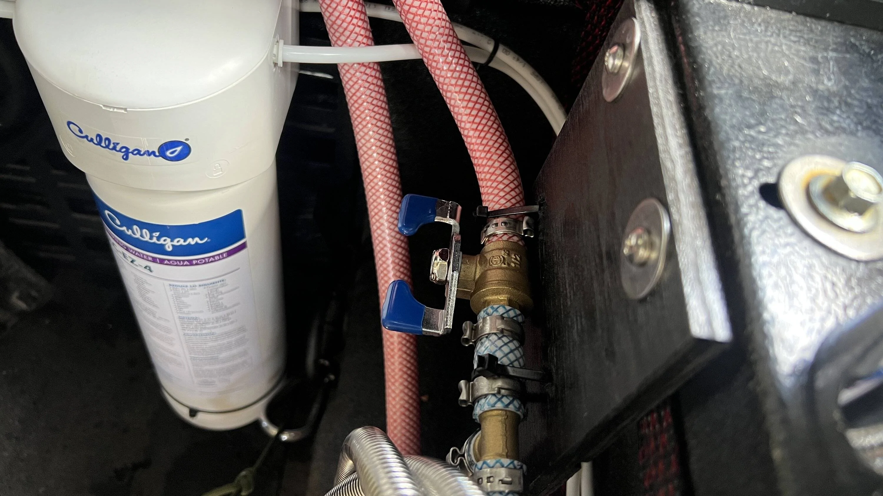

Today I got the water heater installed. This was the plan all along as I dont like being nasty sweaty in bed and cold water is not fun. Not to mention wanting to ensure I have ample opportunities to wash my surgery site if camping for a week or so.
If you want to see the water system install go back to post # 93 and 95
I already had provisions for the water heater and temporary water lines ran Since this was the plan all along. I included a shutoff valve as well so that water wont flow backwards if the hot side is pressurized as well as being able to shut that side off entirely if the heater blows a seal or leaks.
Jeep Gladiator Destination Unknown - 2022 JTR journal 49F2C42F-6487-4952-85C5-229158DF00F5

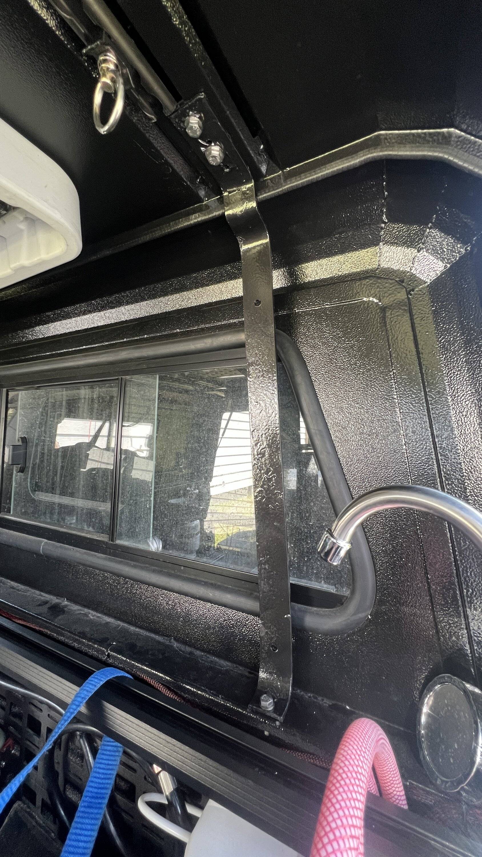

The most difficult part of this project was figuring a place to mount. Initially I wanted to mount it on the 813 panels, however, being unable to source a 90 degree compression fitting it was clear that location would not work. My second option was up against the rear window somehow. This was an issue, as stated several times, I dont have access to equipment for good quality fabrication. But, in this case it worked out ok. I had a piece of 1.5” angle alum with just the right amount of length. Cutting the angle part off, I was able to bend it by hand enough to make it form a C. this way I could bolt it to the top and bottom of the canopy, and bolt the heater to it. However, it is not the most structurally sound option and I am concerned of its longevity. So I used two bolts up top and one down below. Because of the lack of fabrication tools it is clearly not level or plum, but it will hopefully work. Time will tell how washboard roads treat this.
Jeep Gladiator Destination Unknown - 2022 JTR journal 243FBBD8-8455-48D1-B0DF-D60B7A441719

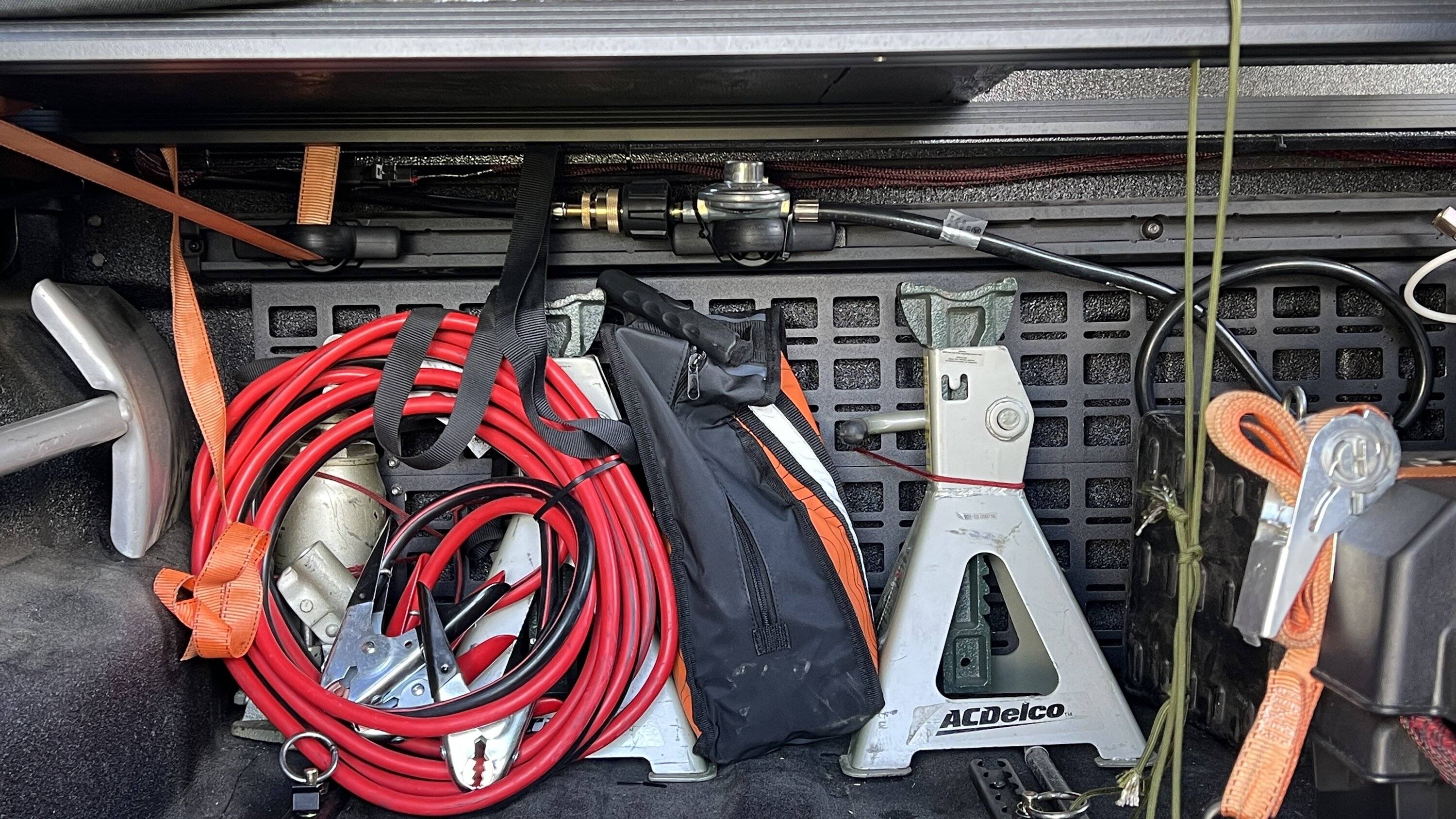

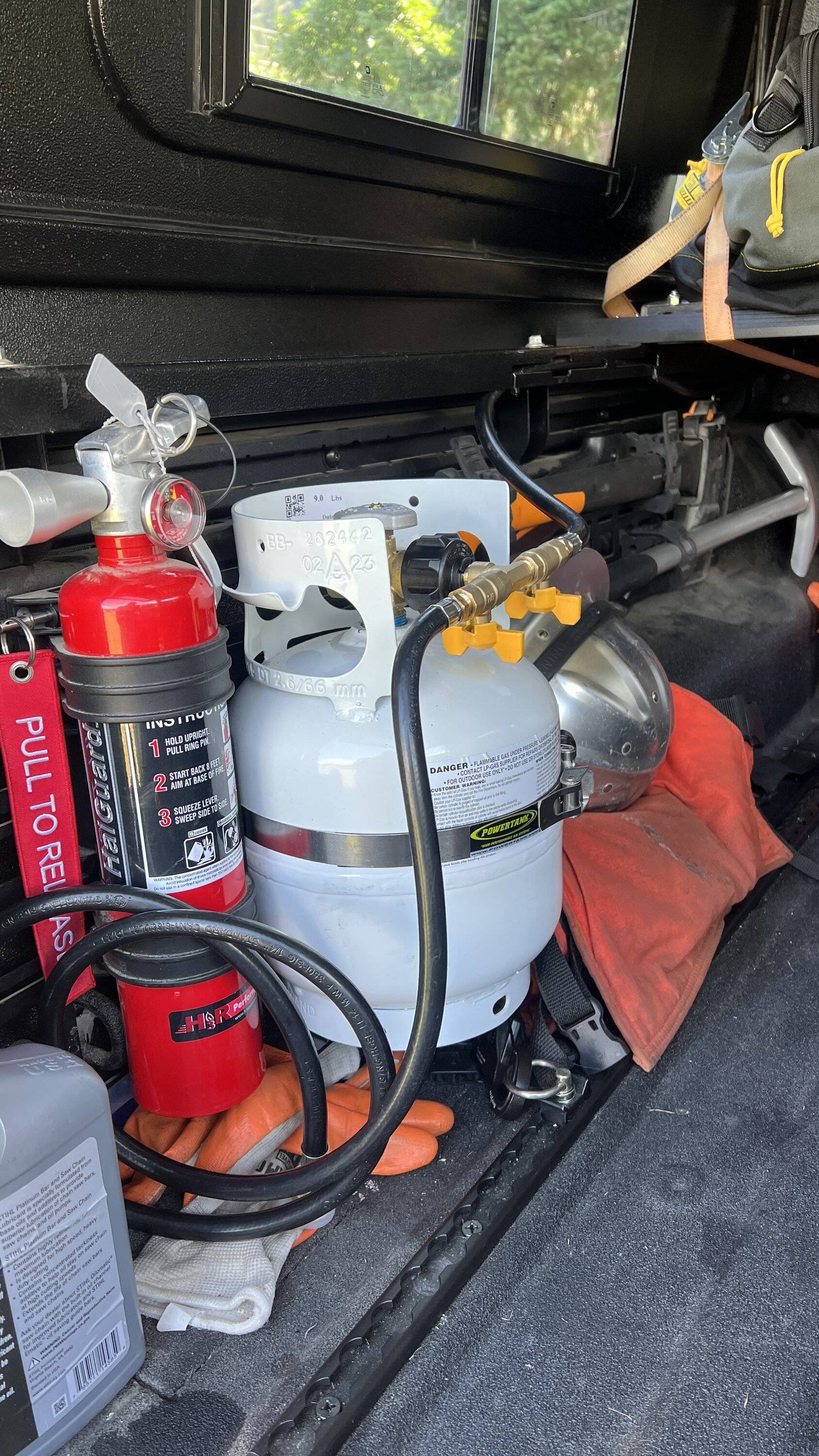

Next was to run the propane line. It turns out the propane dual output line along with the line included from camplux with their regulator was about 2’ too long. Which is actually perfect in order to allow extra in a coil should it need to be removed. The other side of the T is to be used with the jetboil stove.
Jeep Gladiator Destination Unknown - 2022 JTR journal 51E890D3-5E37-47F7-99BE-C63D80F9D38D
I ran the line behind and under the lip of the canopy to ensure protection.
Jeep Gladiator Destination Unknown - 2022 JTR journal 2BB6EF7F-FB99-484B-8172-E055A38CEFED
When getting ready to mount the tank itself I realized it would sit back a little too much to allow for easy connection of the water and LP lines. So I just grabbed some plywood, cut and painted, and used it to push the bottom
of the tank out just a bit. This turned out to be the perfect amount, so on went the lines.
Jeep Gladiator Destination Unknown - 2022 JTR journal 3E5BEADC-10B4-4C4D-85CB-4459B31A8C36
Now everything is easy to access should any of it need to be removed. So time to pressurize the water and LP system and check for leaks.
Jeep Gladiator Destination Unknown - 2022 JTR journal F40683ED-20FB-4B8B-A20E-1623600E3C79

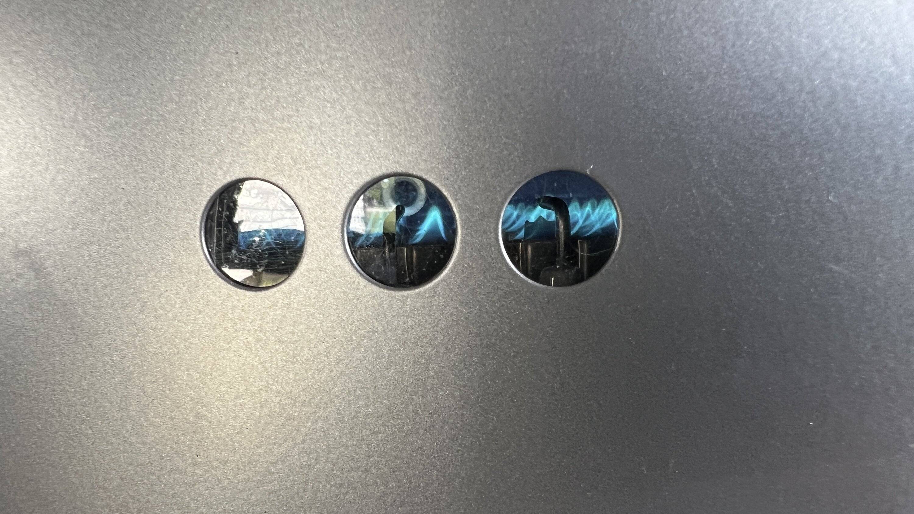

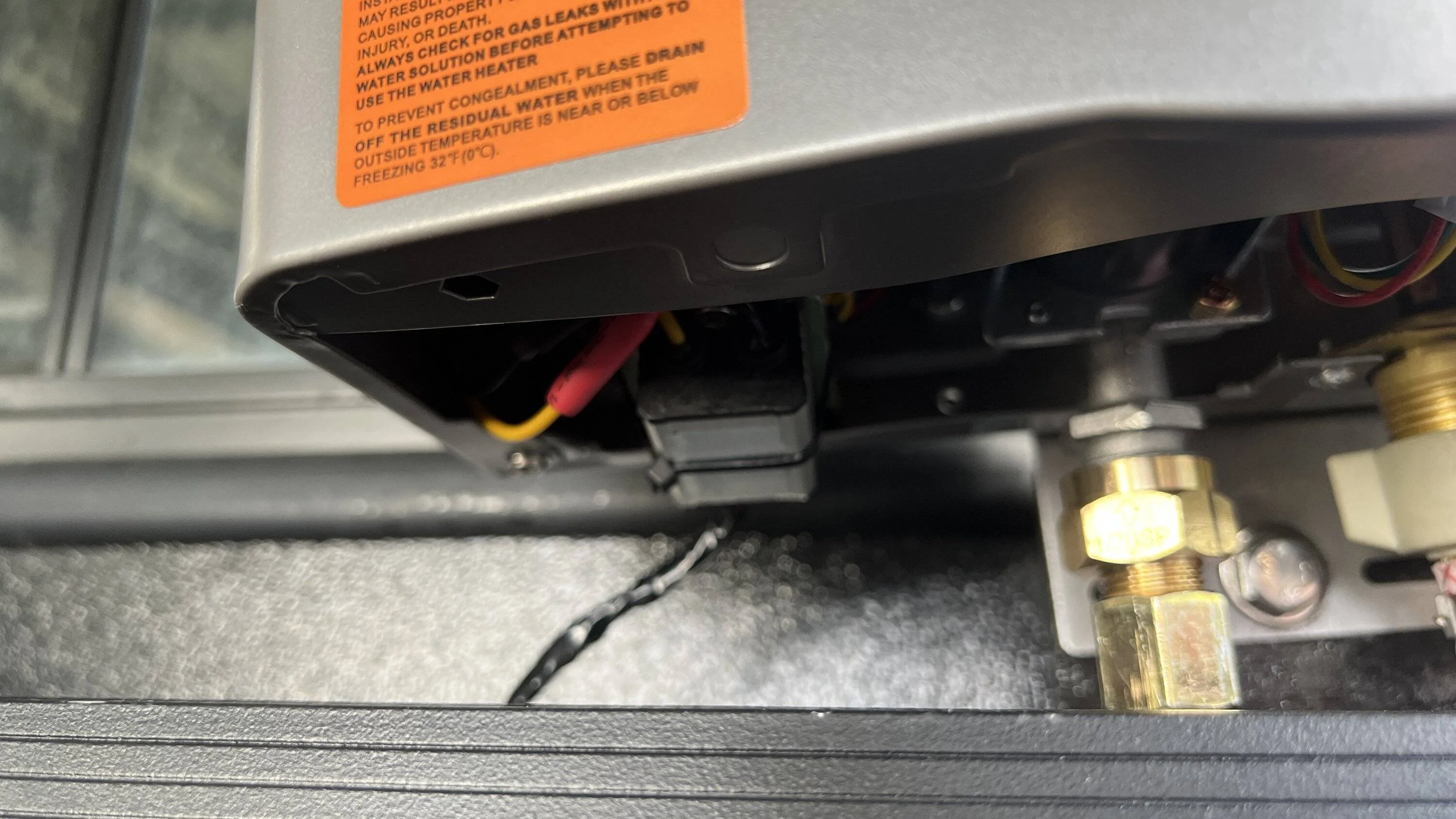

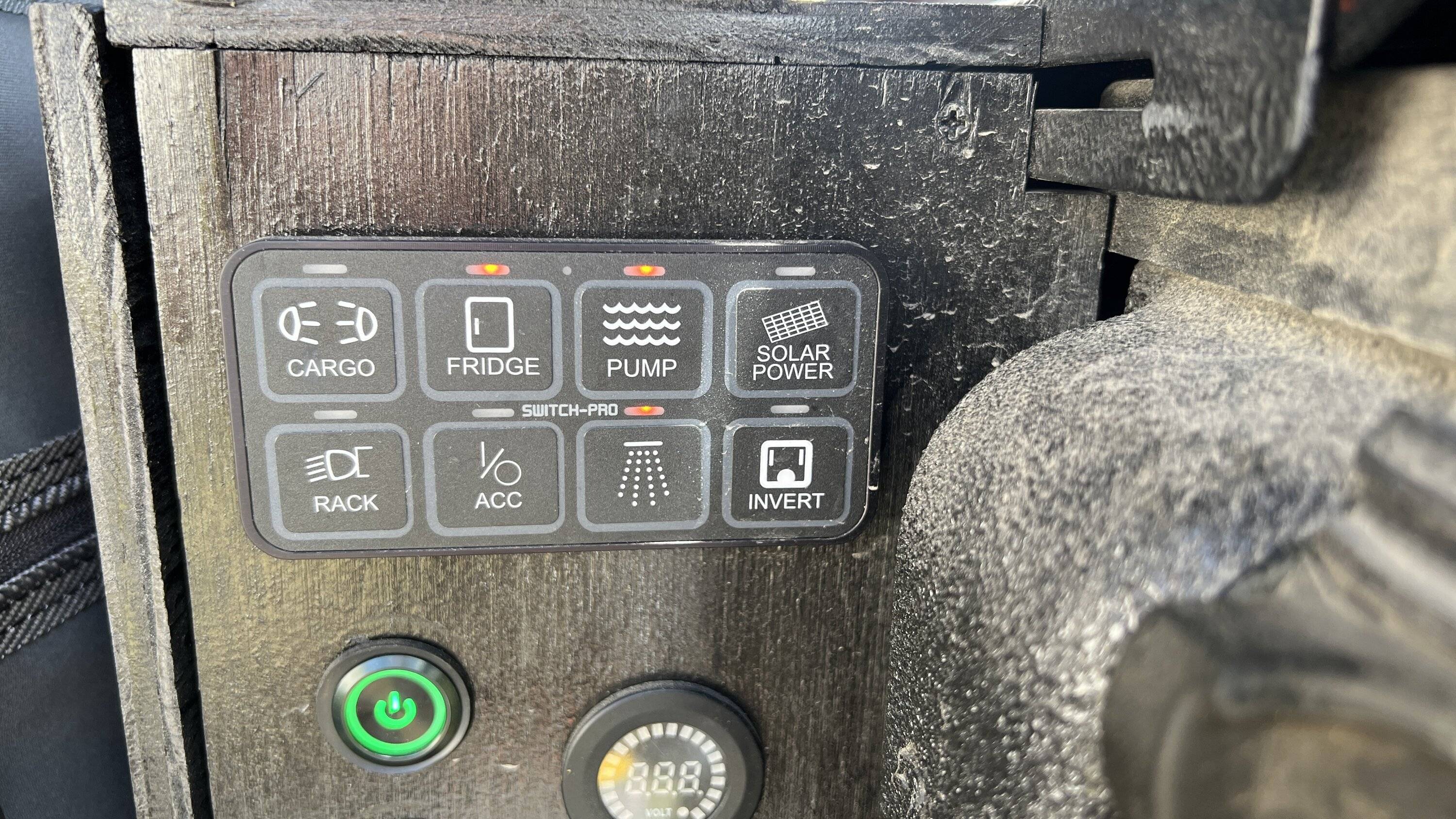

Before the tank even went on, I was researching what to do about the ignitor. These tanks typically use D cell batteries. However, the last thing I wanted to deal with was batteries. They go bad at the worst time, they corrode, and just are a pain. So looking at how the batteries are connected I deducted the box was removable and could be replaced with a hardwired setup. One problem existed though, two D cell batteries wired in series equal only 3v. So connecting directly to my power system would probably cause a problem. But since Amazon has instant access to everything, a quick search revealed a voltage converter. So I was able to direct wire To my power system like everything else and step down voltage to 3.0v
Jeep Gladiator Destination Unknown - 2022 JTR journal DBA96C1F-69DB-48C5-8C1A-7B596E7F8A16
I wired it to one of the outputs of the switch pros panel so that the water pump and heater could be operated separately in the event that the heater had a problem.
Jeep Gladiator Destination Unknown - 2022 JTR journal B034A9E4-A87F-4BEF-9079-8BF10FAA0DD5
So lets fill up a scepter can, and test it out!
Jeep Gladiator Destination Unknown - 2022 JTR journal 53C1BBA6-1BE0-456C-926C-8B53525209C3
Success!!! Hot water! And very hot indeed! So I turned it down and it is perfect. Now I can take hot showers and wash dishes comfortably. But caution must be taken because this setup will blow through water like nobodys business.
And with that the water system is in! Now I am fully ready for several week long trips this summer!

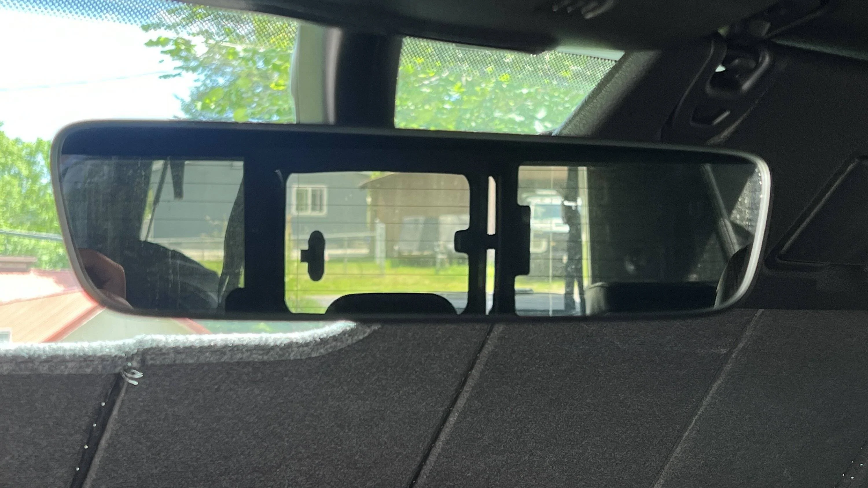

And for those wondering, rear view is not hampered. This is taken from where my head sits and only a small tiny corner is cut off.
Jeep Gladiator Destination Unknown - 2022 JTR journal 37EC1554-636B-4E2D-BBD3-D2FE23C6105C

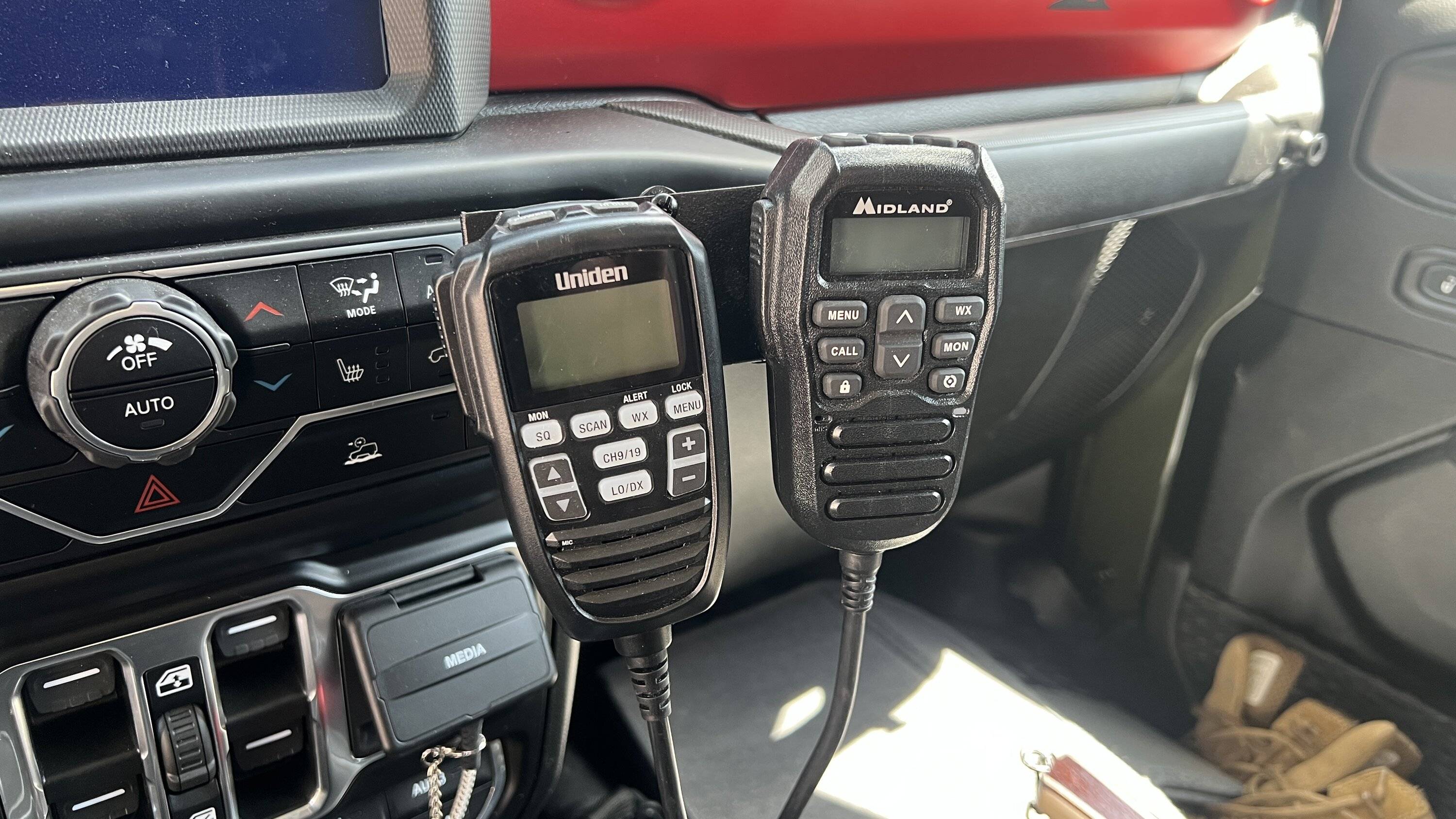

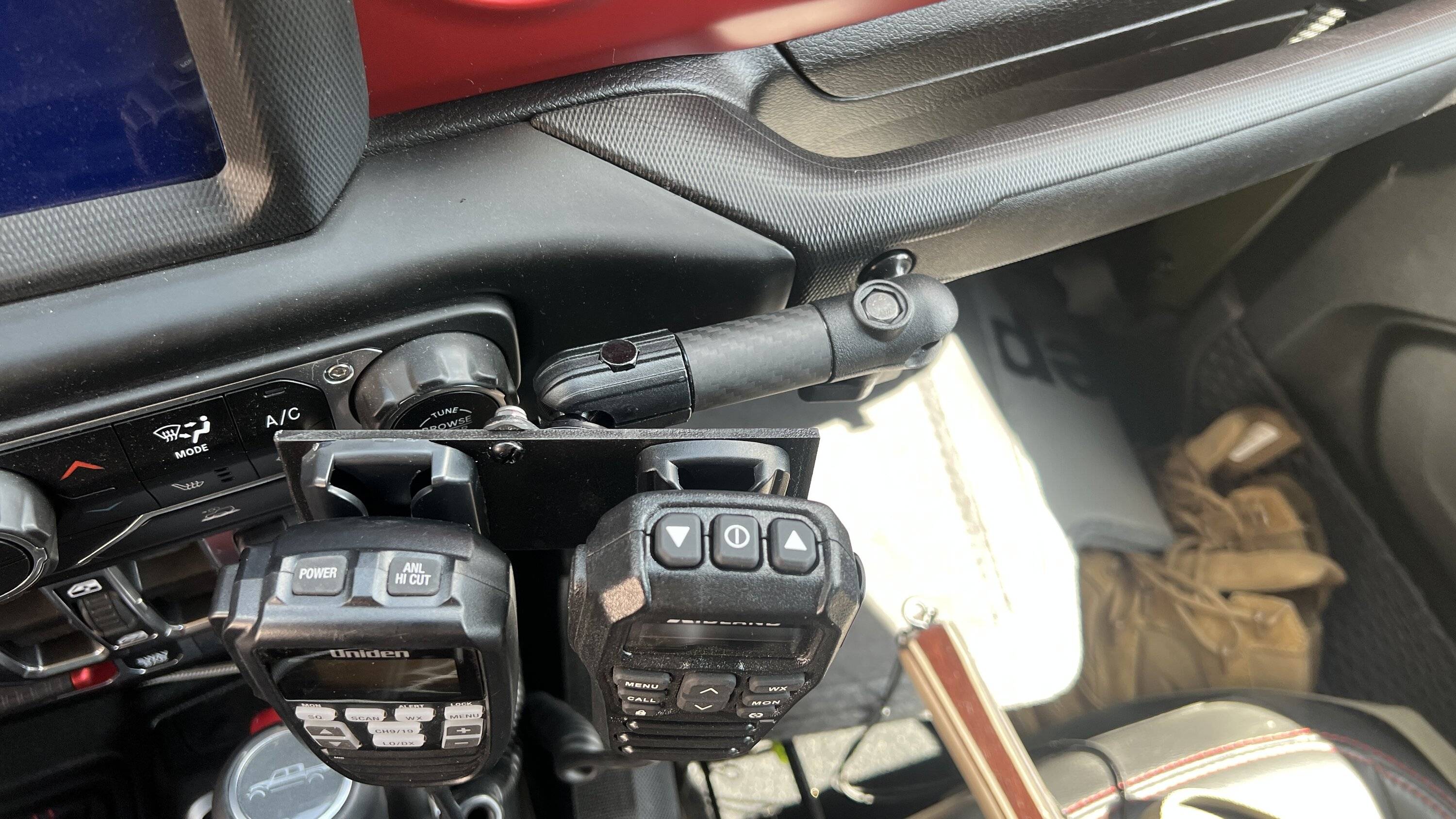

After returning from another trip this weekend (pics later this week maybe) I installed a quick little bracket for the CB and GMRS mic. It has been annoying me greatly they just sit on the seat and flop around. So those days are now over. Although I do need to get a short arm.
Jeep Gladiator Destination Unknown - 2022 JTR journal B18E9ABE-5A23-4D9F-8C04-E683B852CBC3
Jeep Gladiator Destination Unknown - 2022 JTR journal 171D691A-9F8A-4C5F-91A5-E2F82AC05578
Jeep Gladiator Destination Unknown - 2022 JTR journal 07C4BB82-B265-4622-9D1C-FD94F7E691B5

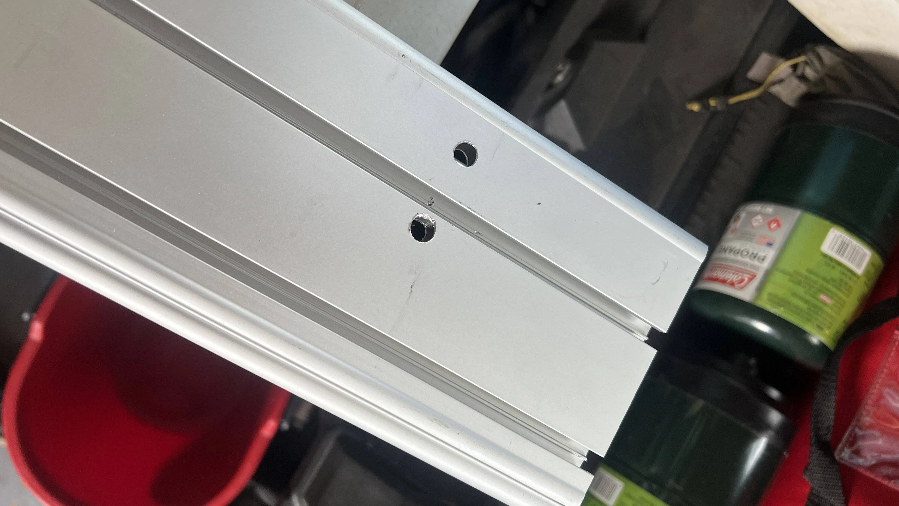

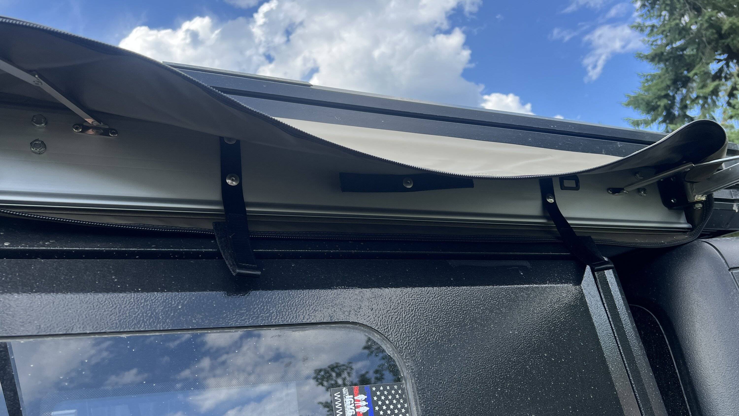

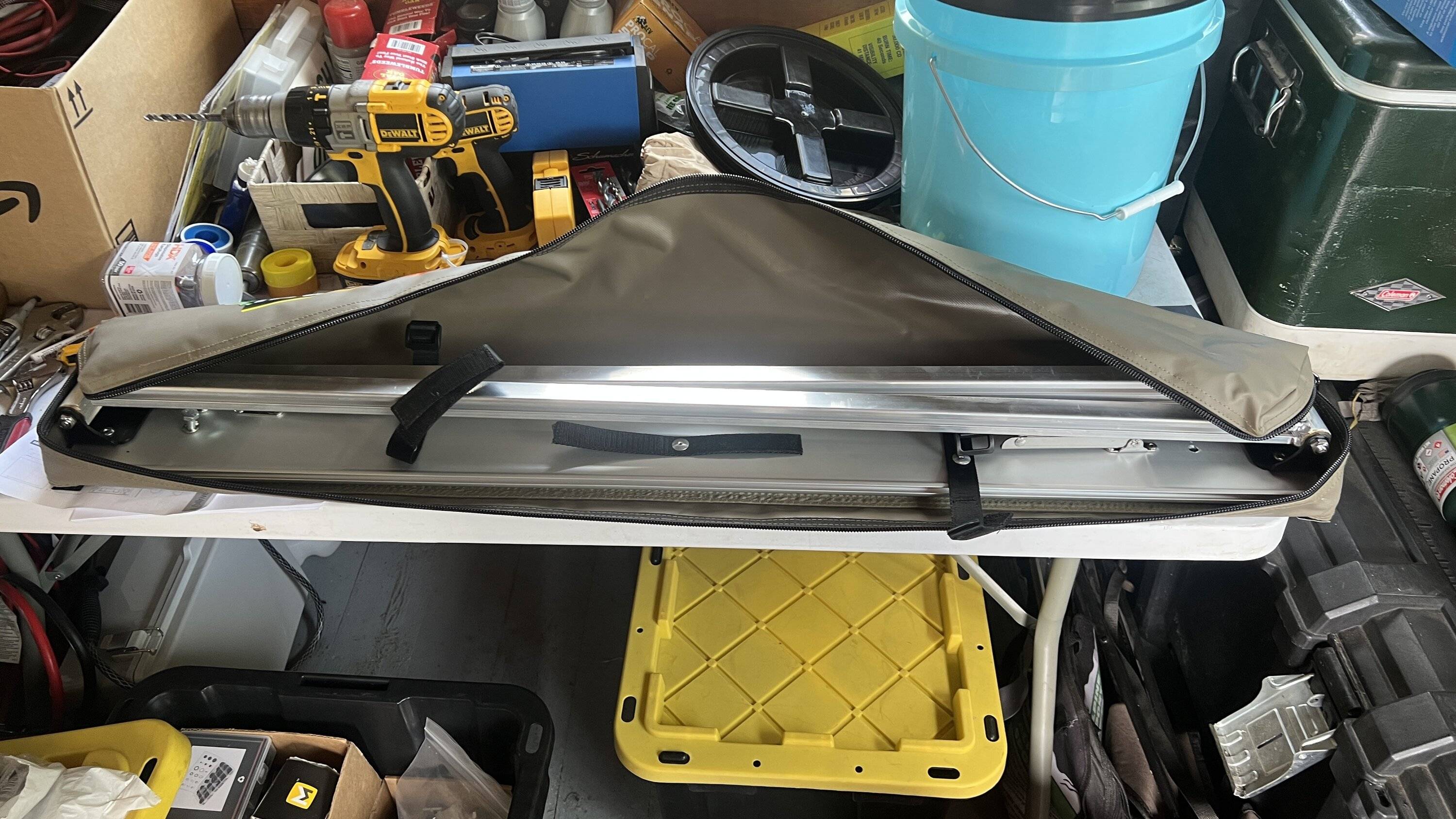

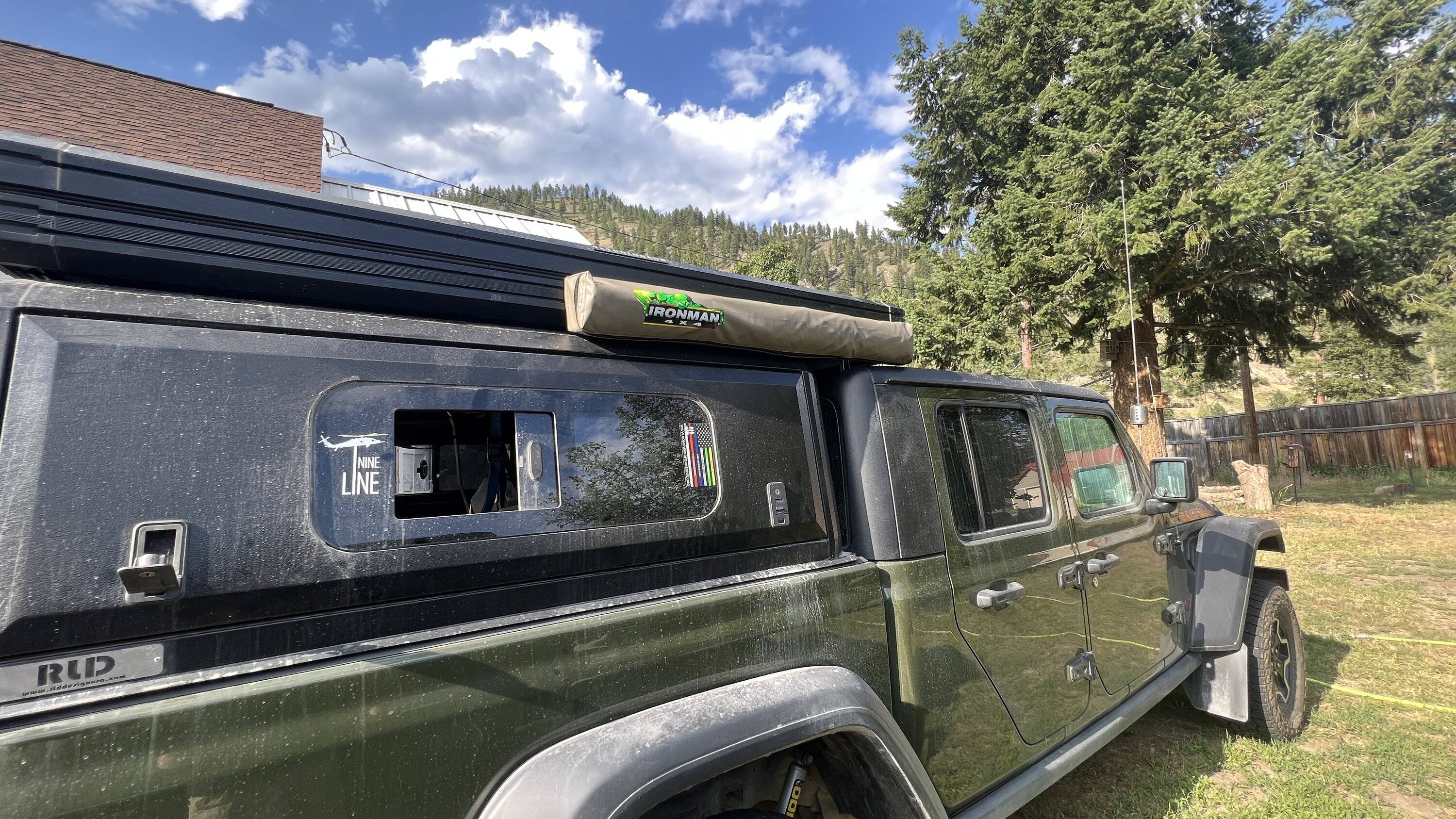

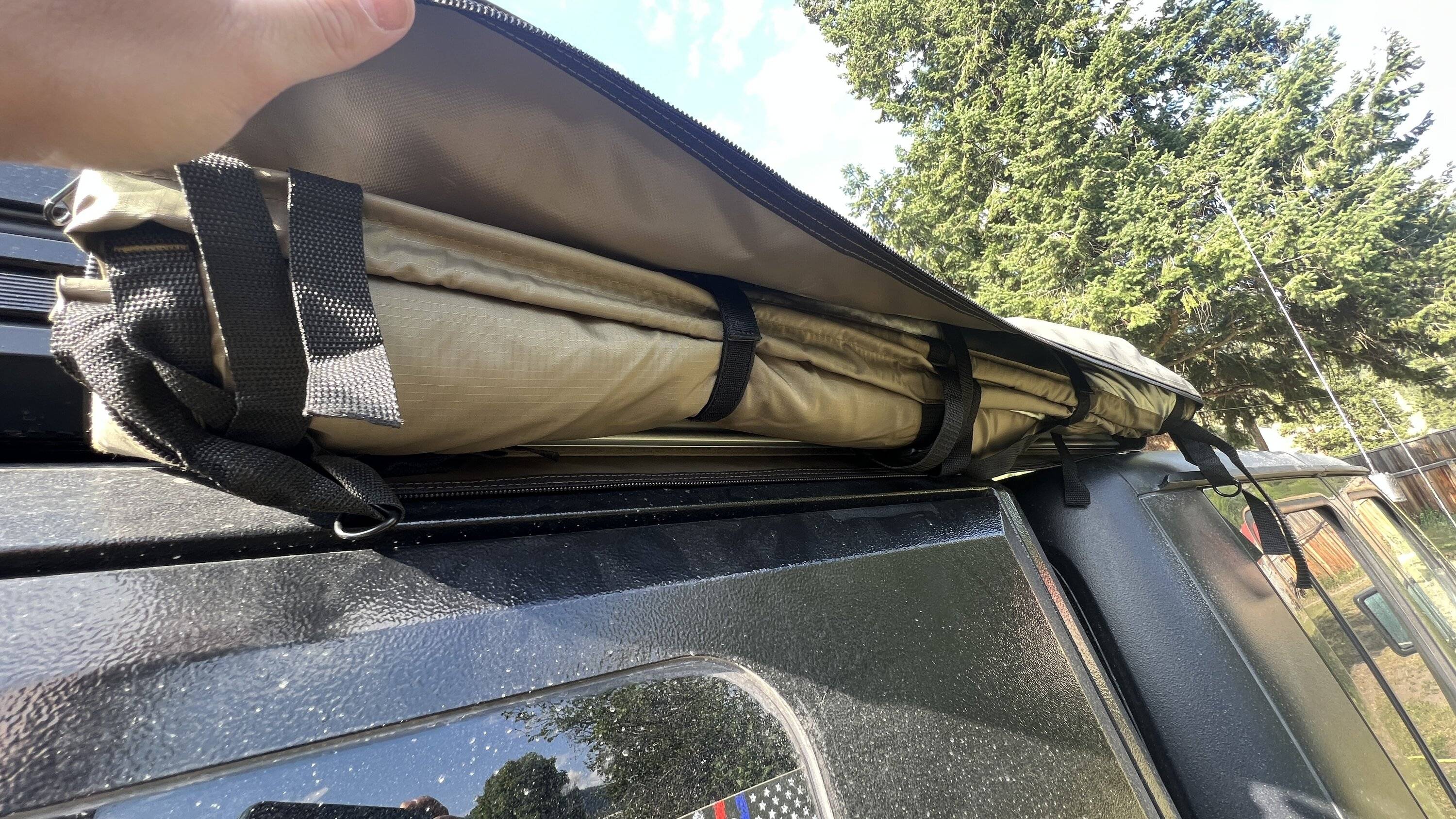

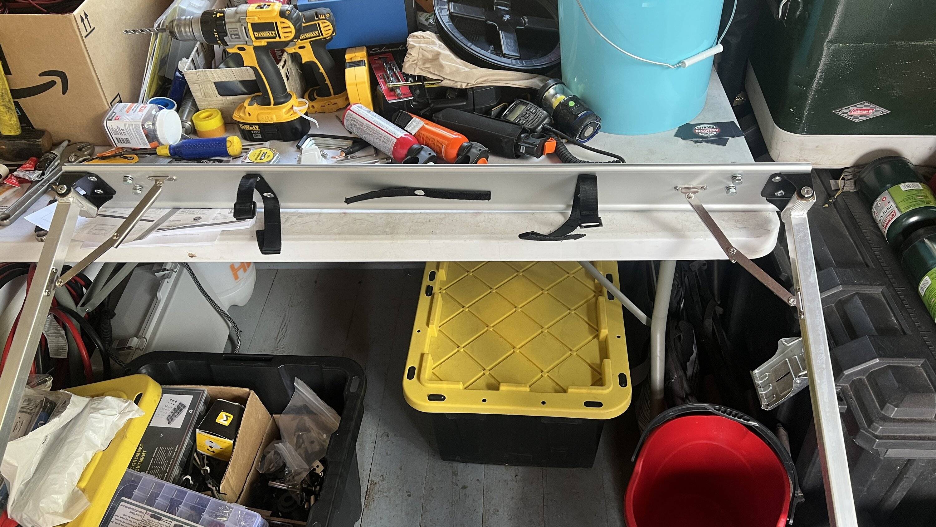

While working from home today, a nice delivery came. So I took some time at lunch to open it up (and of course waited till evening to install). A shower cube by Ironman 4x4. I opted for this option mostly due to the price and weight. Lighter and cheaper than most other options, I think it will do just fine. Plus, I am getting heavy, and really do not need to be adding super heavy things up top. I used, for just a couple trips, one of those easy to fold and pop up style privacy tent things. It worked fine for what it was, and was light. But I wanted an easier option. I quickly realized over just a couple weekends that I truly need to optimize every single aspect of this setup to be quick and easy - otherwise it is too much work and difficult for me to use on a regular basis.
Before even purchasing this, I had thoughts of how to mount it. Because I don't have a rack, and the RTT is bolted directly to the canopy, my mounting options were limited. Fortunately the tent from 4x4Colorado includes extruded aluminum channels on the outside of their tent - something most, but not everyone, does. I figured since this shower cube is light enough, I would just bolt it directly to the RTT with some channel nuts I had lying around. So...after removing all of the fabric, off to drilling some holes again.
Jeep Gladiator Destination Unknown - 2022 JTR journal IMG_1575
It turned out that if the first hole, measured from the top down, was placed at 3/4", the top of the alum frame would be even with top of the bottom plate of the RTT - making it still easy to tuck in tent fabric as it likes to fold down and get pinched between both pieces of RTT framing for some reason. The holes were 1 1/8" apart, and this left the bottom of the frame about 1/2" from touching the hardtop, and about 2" from touching the canopy - plenty of room
With holes drilled and the whole thing test-fitted, it was time to put the cover back on. This was a major pita and took me nearly 20 minutes! Maybe I'm just tired. but next time, fabric will stay on as there is no need for it to be removed.
And, on she goes - one of, if not the, easiest things I have done to this Jeep. It was a bit difficult because the bolts were relatively short to avoid them punching through the side of the RTT alum structure. Even then, when I tightened them down I could see the bolts pressing into the RTT alum. Hopefully no long term damage is done. I think if the fabric was attached to the front of the frame instead of behind it this wouldn't be an issue, as the fabric itself created a 1/8 to 1/4" standoff that made inserting the nuts difficult, but when tightened it would compress easily being fabric and all. Due to that, I needed longer bolts. Without the fabric being there the bolts could have easily been 1/4" shorter.
Jeep Gladiator Destination Unknown - 2022 JTR journal IMG_1587

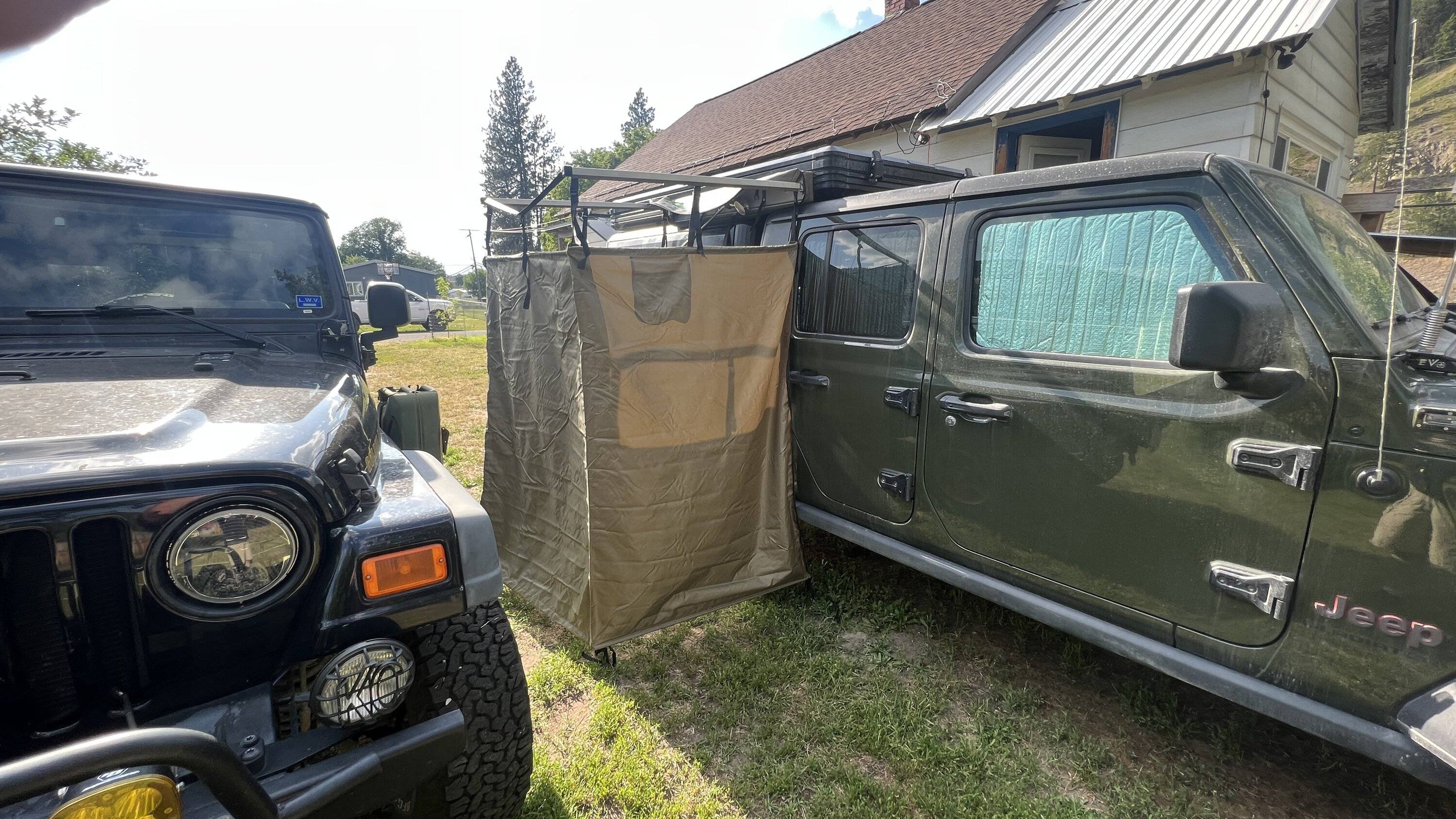

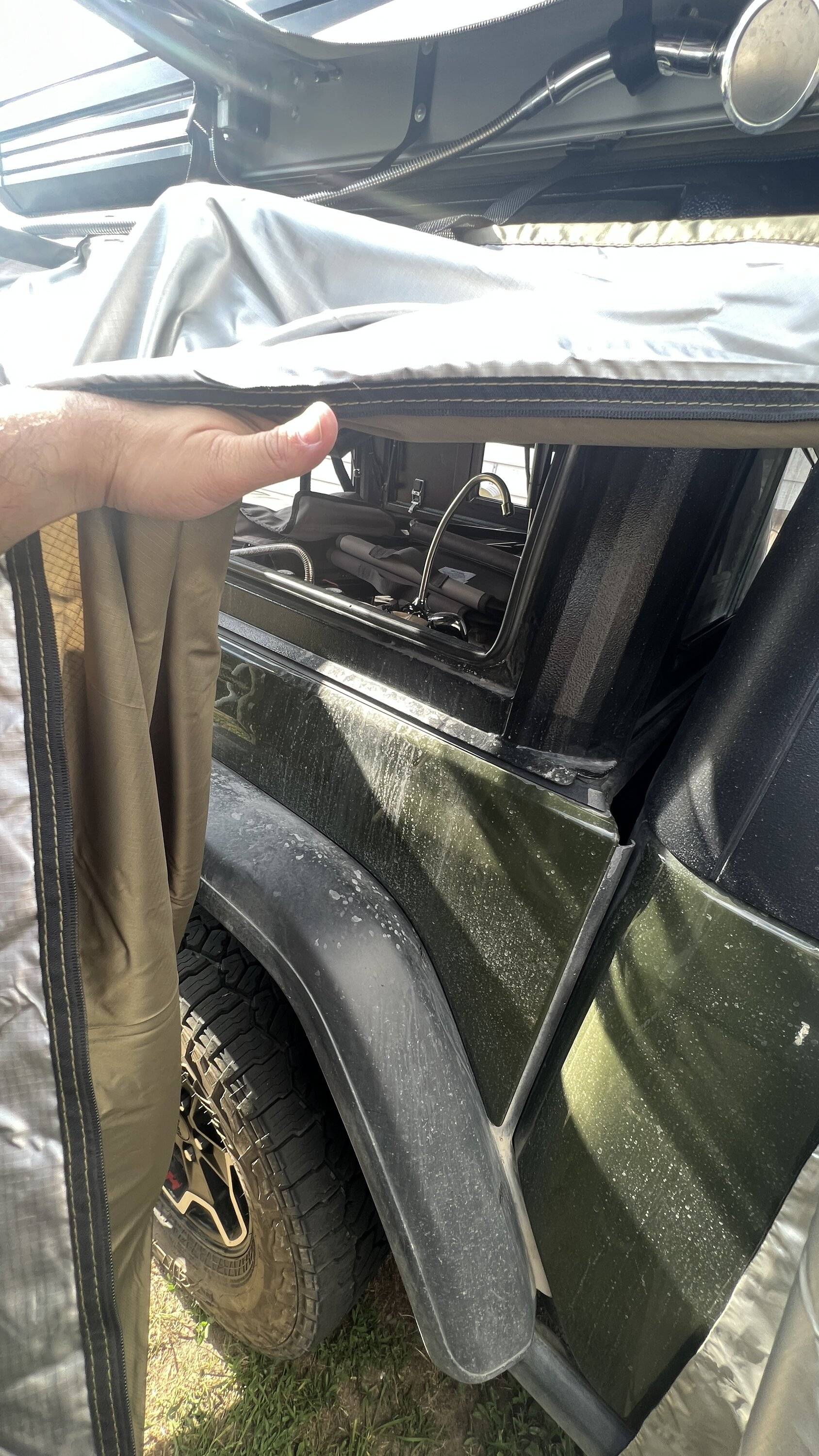

Now that it is mounted, the main tent fabric can go back on. And I really like the color and feel of this fabric. It's not quite paper thin like my backpacking tent, but it's definitely no where near as thick as the canvas on the RTT. Yet it is quiet and doesn't rustle too much in the wind. The color also matches the earthy tons I have going on between Jeep and RTT and 'blends in' nicely. I absolutely hate how most awnings are grey in color.

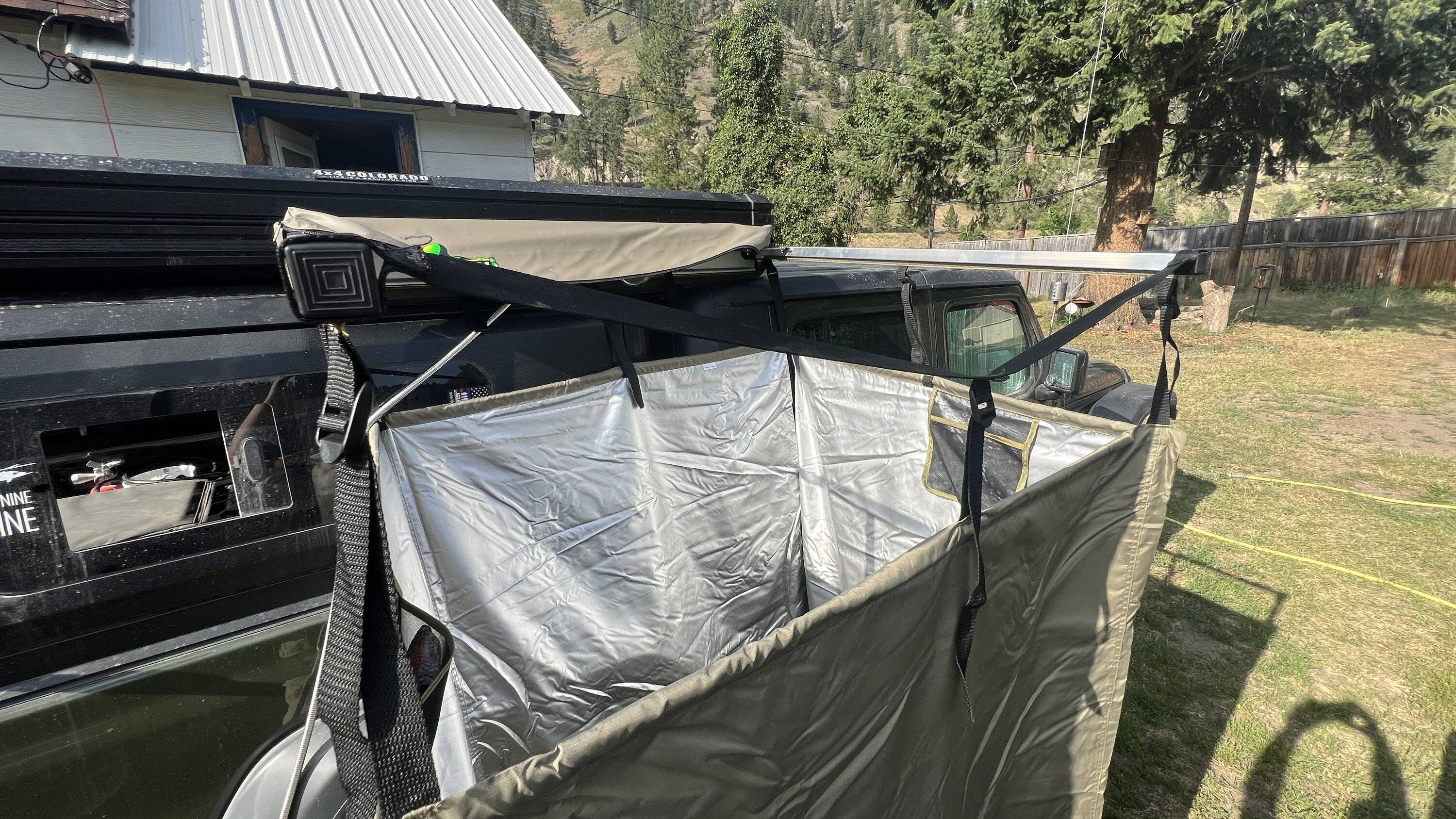

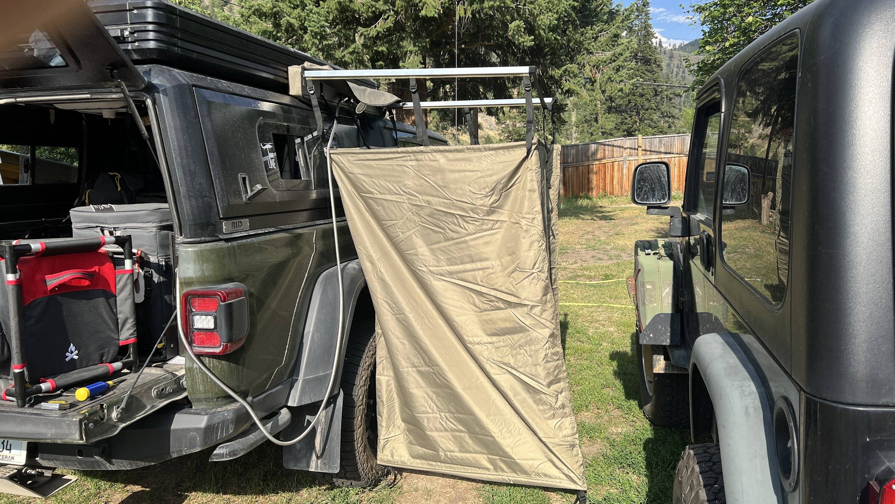

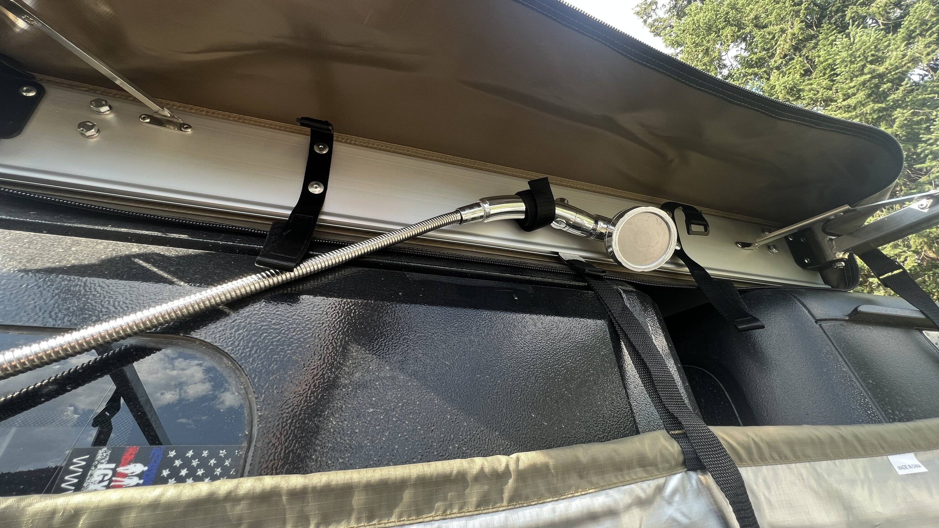

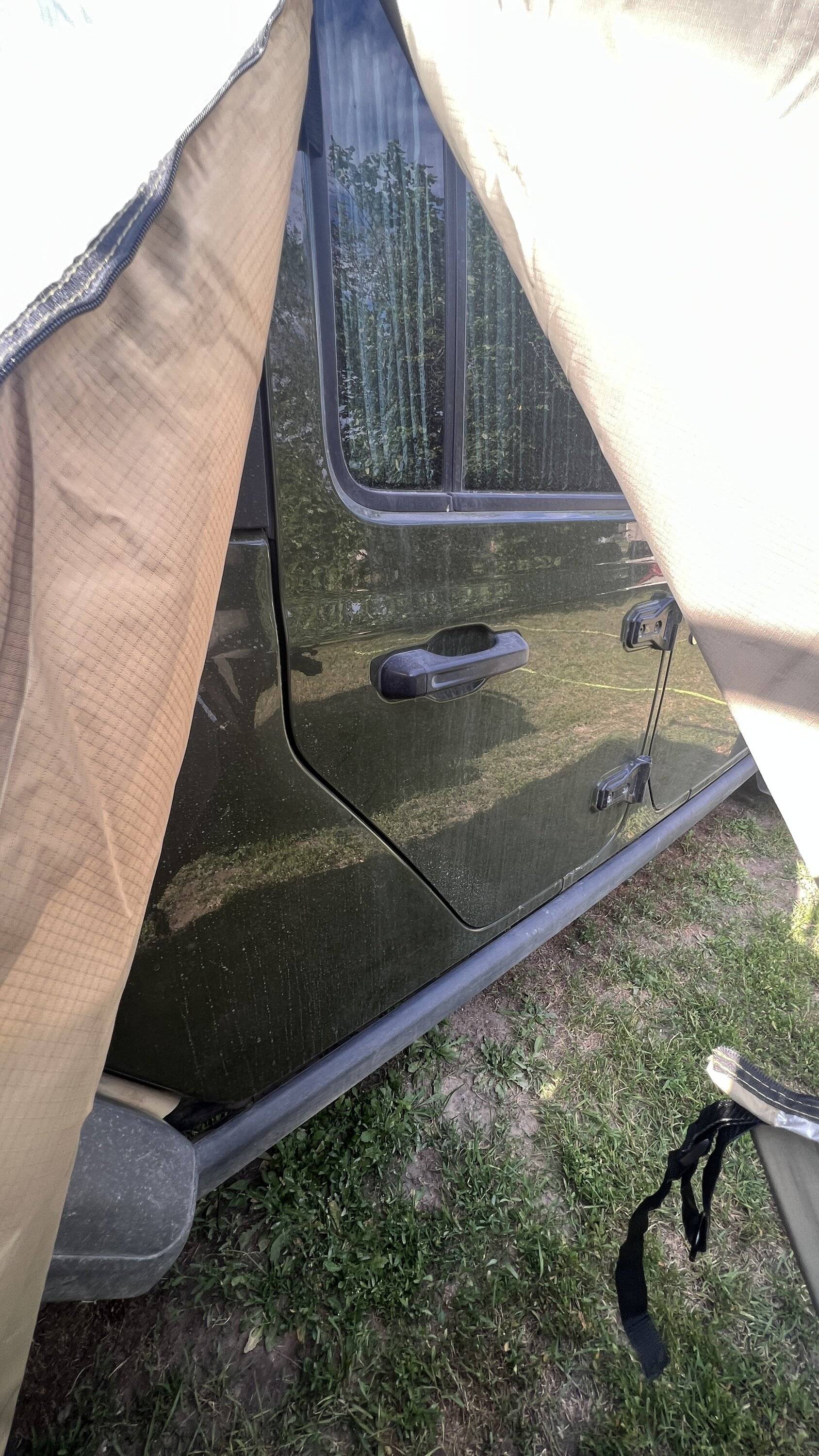

So pulling out the shower head it was time for a test fit. I will be honest that I'm not super stoked about this aspect. I see why it is just a velcro loop, and theres not a whole lot of other options available. But it really does not hold the show head well, and is much too high. Fortunately I don't have a 4" lift. But once I do get HD springs and 35's - I might have a problem here, especially if on uneven ground. Maybe somebody makes a magnetic holder that I can slap onto the stainless canopy.
My original plan was to place this on the drivers side, since that is already where the ladder attaches, and that is the side I keep my clothing bag on. Also because I typically associate 'work' from the drivers side and 'play' from the passengers side - maybe in part too that RV's always have their doors on the passenger side and I lived in a 18' trailer for 5 years. However, I realized that if I did put the shower on the drivers side, it would be more difficult to run the showered and if the water was entirely too hot or cold I would not be able to adjust it. So....I ended up swapping to put the shower cube on the passenger side since that is where the water system is located. And it makes sense to be closer to the faucet to adjust temperature if necessary. However, this means that the awning will have to go on the drivers side, and that will make for some complications with my cooking setup and plan, so those will need to be revised now. I also turned the shower fabric 180 degrees seeing as how it just slides into channels of the aluminum frame above. This way the door opens on the Jeep side instead of away from the Jeep. The reason for this is, again, to be able to easily access the faucet to adjust temperatures if needed. If it opened away from the Jeep, then I would be sharing everything to the world to adjust temperatures.
Another downfall of this shower option over others is it is totally open to above. But then - who cares if it's raining? And if it's snowing are you really going to be wanting to take a shower anyway, or would a baby wipe bath suffice in that situation? So for me it's a non issue. more of an issue of the hot sun beating down if goin #2, but a towel draped over the top will resolve that issue. I do like how it has internal pockets for soap - and for now I just left my soap in one of the pockets. It will likely stay there for good. At first I thought the silver inside lining was kinda odd - but actually it's nice because it helps to brighten up the area especially if using it in low lighting conditions. The height adjustments are very simple as well which are also nice.
Tucking it away might take some time to get used to just due to the plastic rods at the top and bottom that help keep the walls straight but it is easy enough and can be done in less than 2 minutes. Which is about the same timeframe as the other privacy tent thing I have however, this is still easier and it offers more inside 'room' which just makes tasks less of a struggle. I also don't have to worry about tying anything down when driving as it tucks away nice, or wind blowing it entirely away at night like an event that occurred recently with the privacy tent. I can also opt to steak down all 4 corners of course just like others of its kind.
Overall I am pleased with this option. It is very light weight - and compared to the competition I really don't see why heavy duty fabric or extensive options are necessary. I mean, it's a shower. You use it to bathe, poo, or maybe change if you feel the need to cover for that. I just don't see the need to have a super heavy and overly robust product for this particular application. The one thing I really don't like though is the price. Like all 'overloading' equipment it is expensive - and this product seems pretty costly for how simple it is. One could easily fabricate one themselves with the right tools. Then again, other competitors are more expensive, and I purchased it with a 25% off sale.
