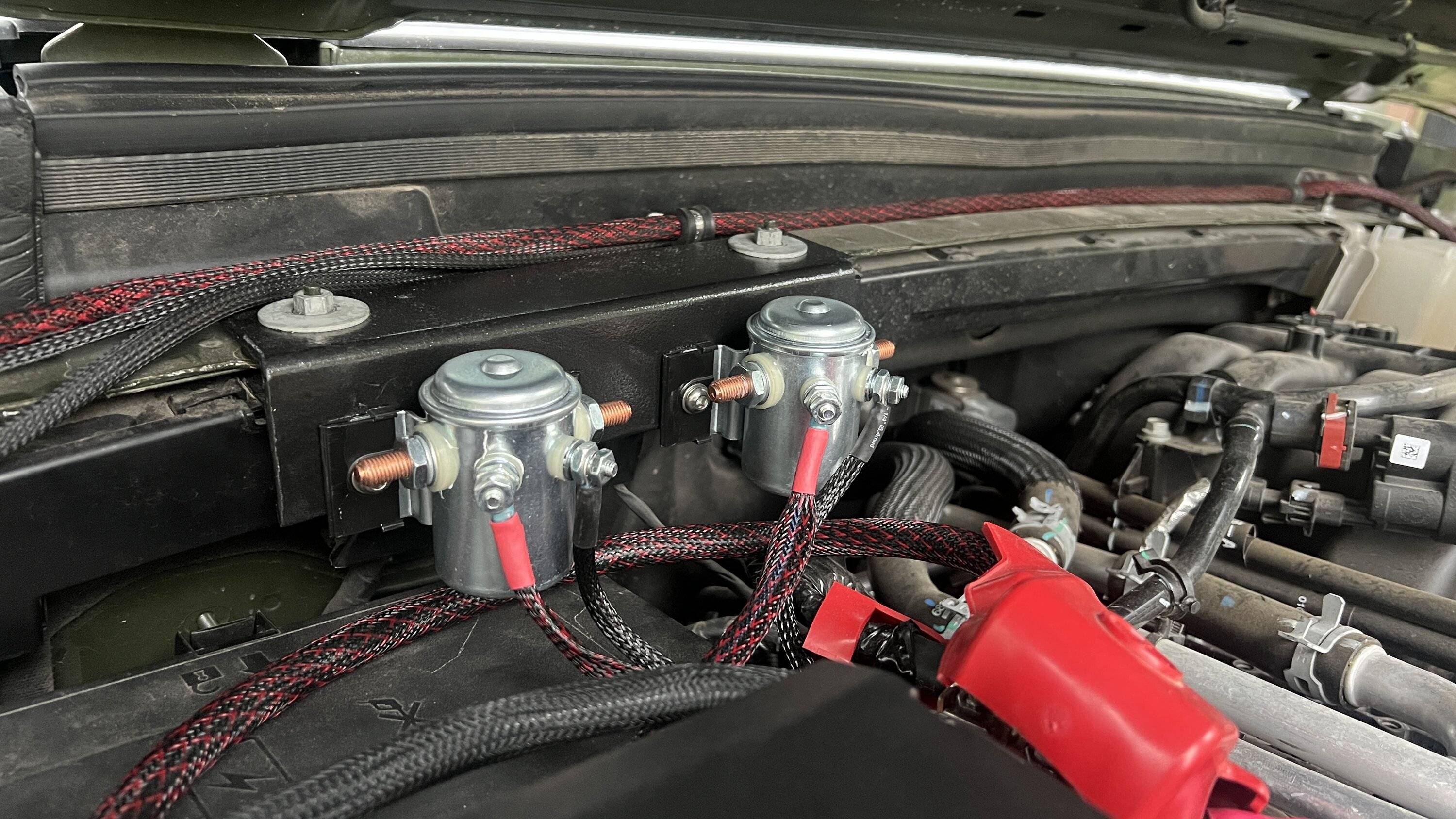

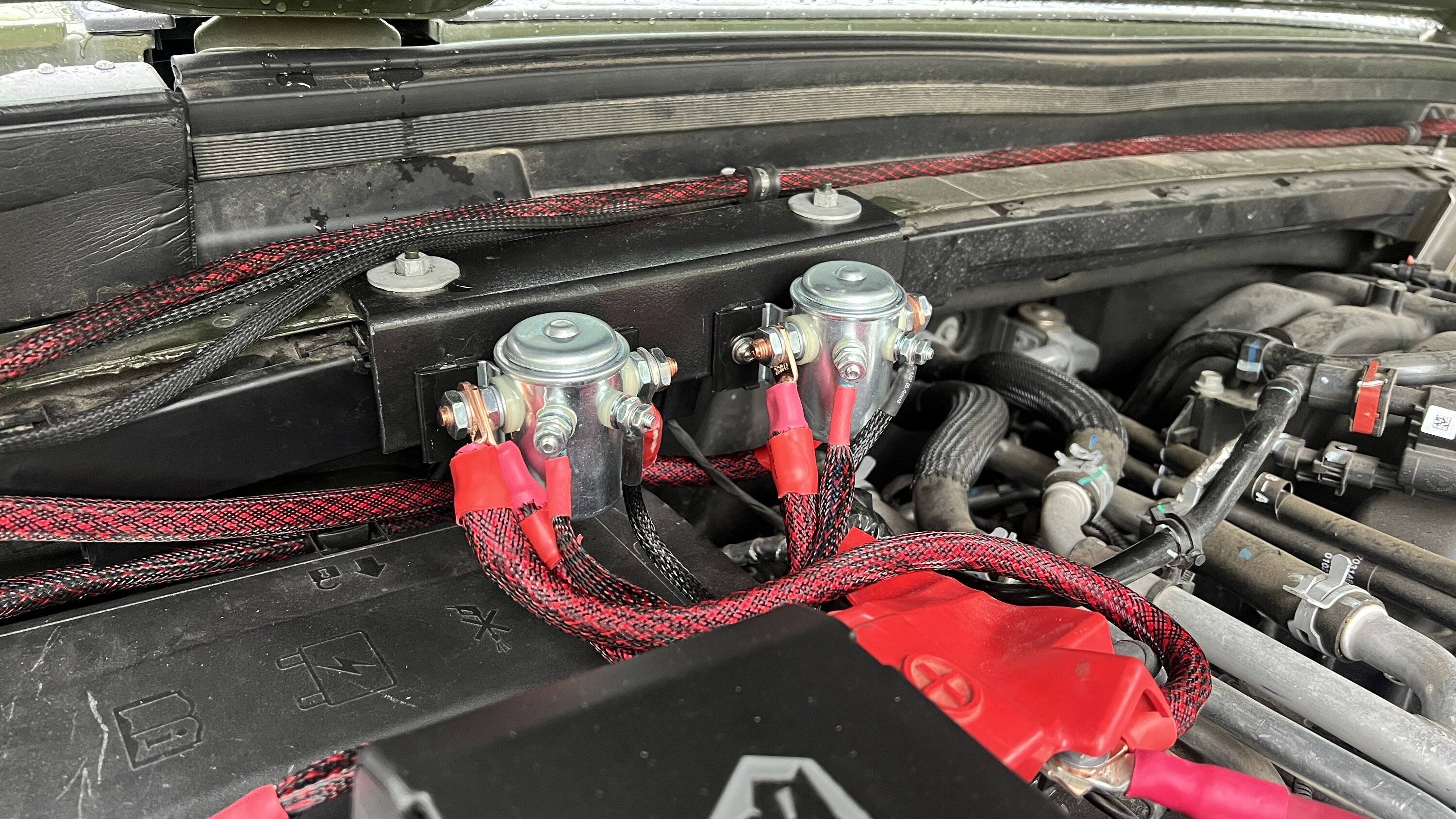

Well it was a super crazy week, between work stuff and busting butt to try and get this build finish - I am almost there. Not quite sure if ti will be wrapped up tomorrow before filming though so we shall see.

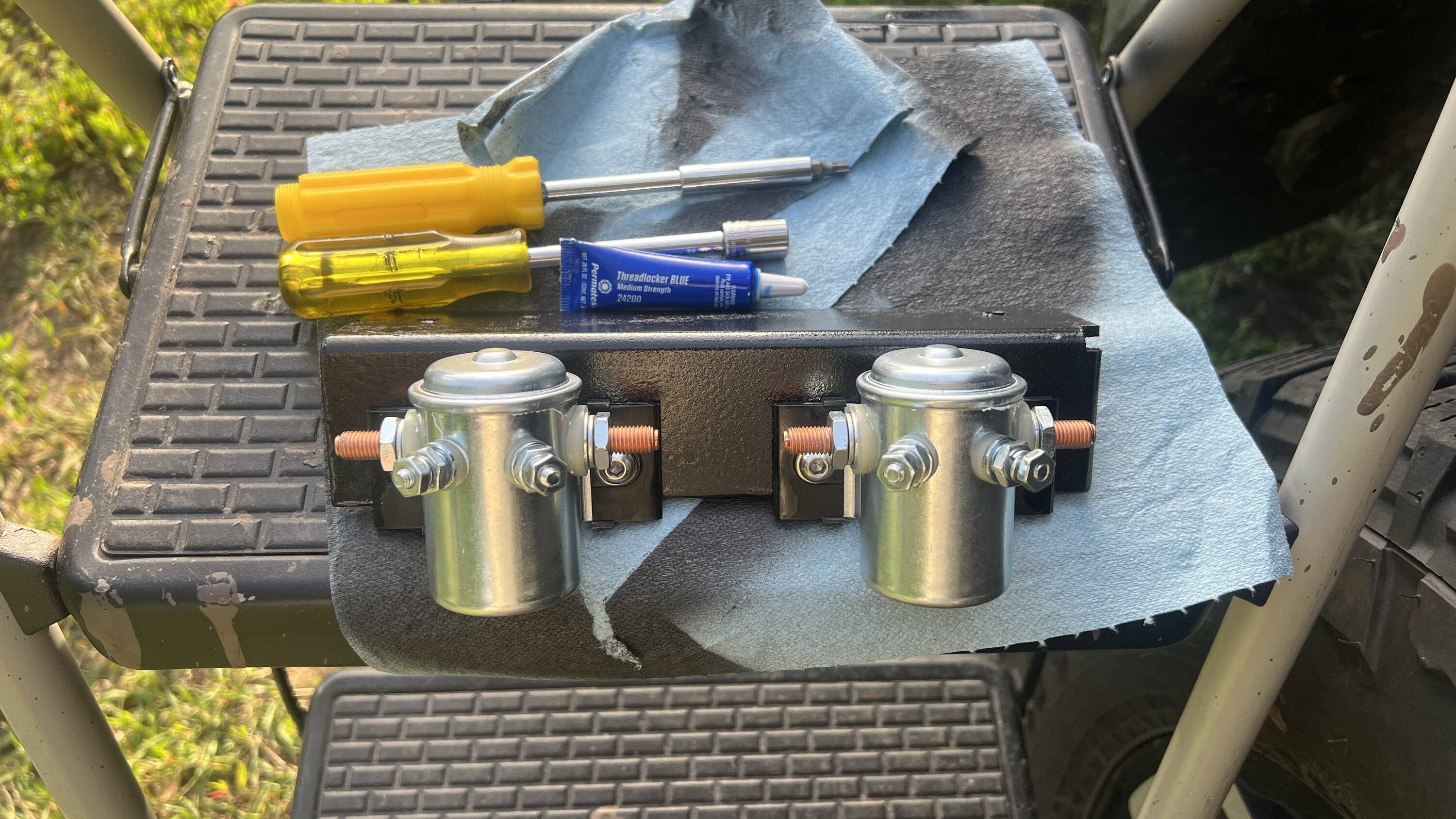

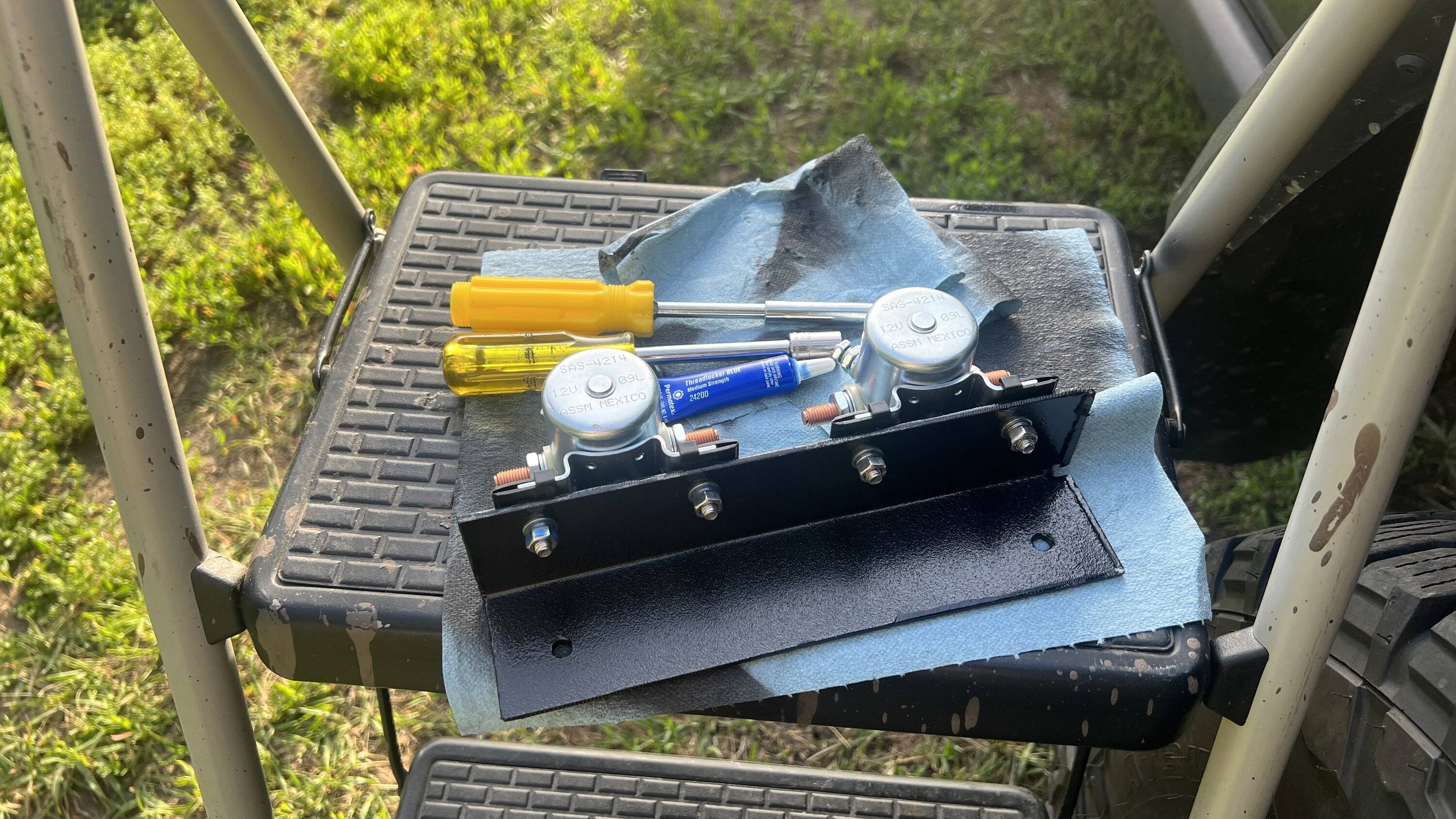

One task I did accomplish was solenoid mounting. The following thread shows some discussion and a temporary solenoid mounting solution I came up in post #13 - https://www.jeepgladiatorforum.com/...-install-location-options.69958/#post-1150253
However, I was pretty unhappy overall as I had two winches, and allocated aux switches 3 and 4 for each winch respectively. So thinking of ideas, I recalled having a scrap piece of alum in the house from 813 Fabrication that I ended up not using. So taking some measurements, and cutting with a neighbors cutting wheel, I came up with the perfect 2x2 angle alum I was looking for.
And with a quick test fit, it worked perfectly!
So after sourcing 22' of 1 ga cable, it was all set to go. I am super excited about this!

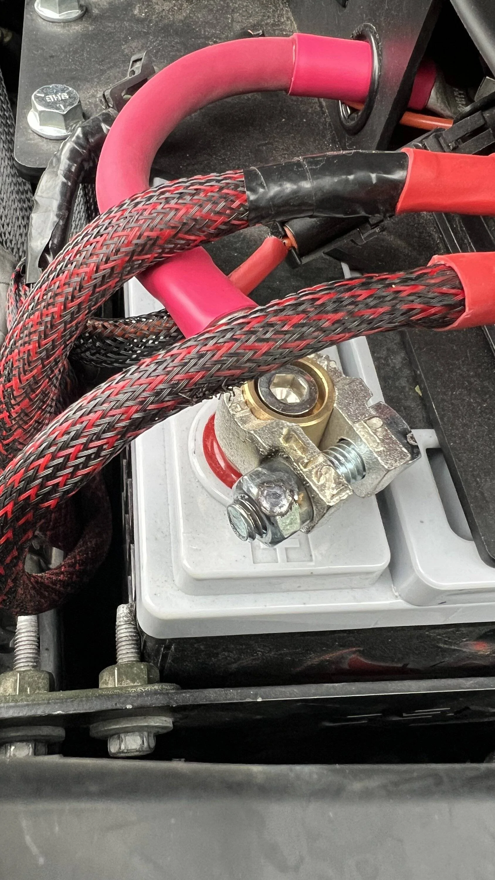

Unfortunately though, when hooking up the negative cables, my persistent neighbor came over to chat it up. Nice guy but bad timing. He distracted me, resulting in some arc welding. This, I am pretty angry over. Not his fault, my own really; however, I really am hoping that nothing got damaged or fried. Guess I'll find out tomorrow
Jeep Gladiator Destination Unknown - 2022 JTR journal IMG_0791

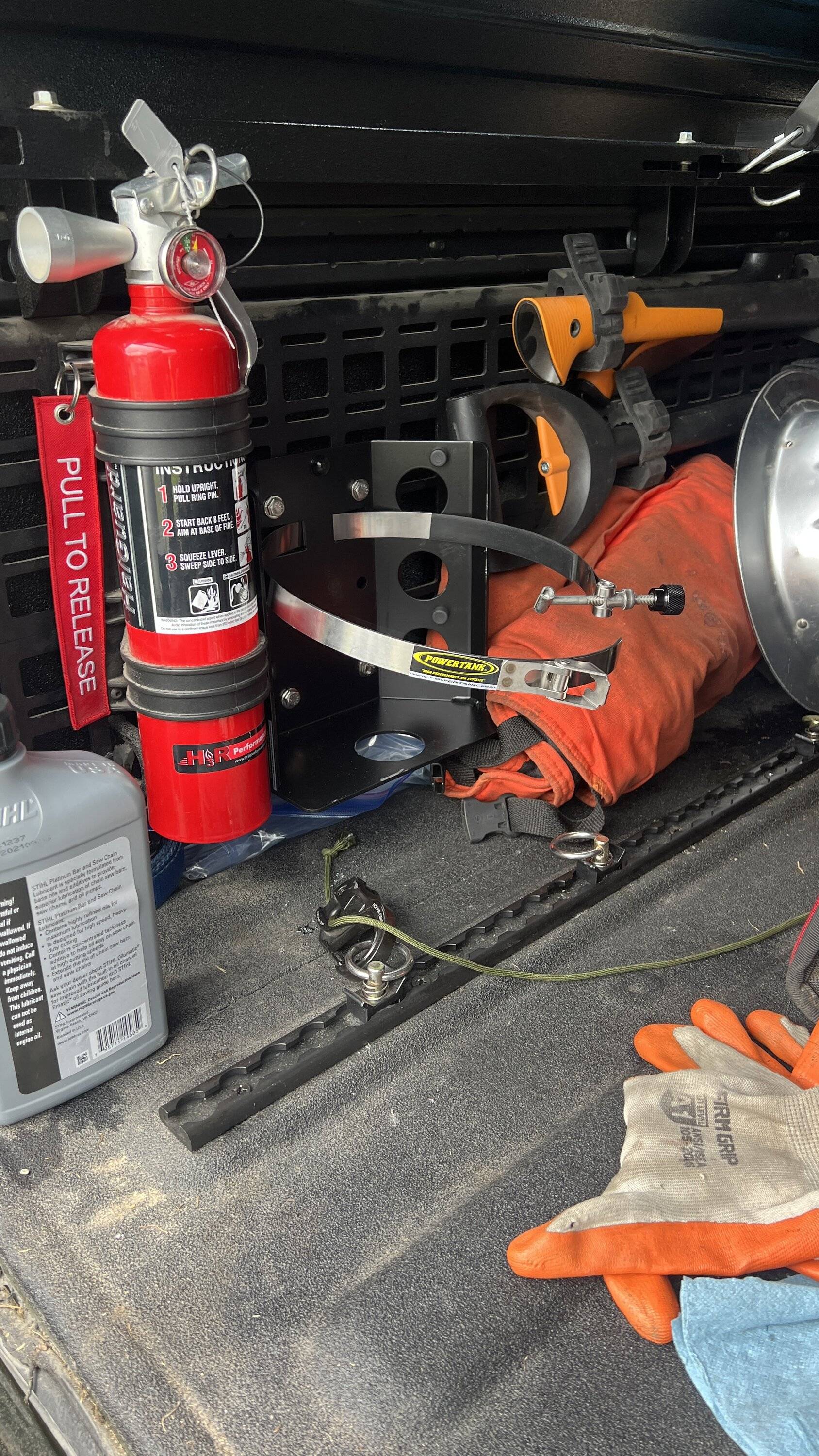

I also installed a power tank mount for a 5 pound propane tank. It holds about 1.4 gallons and is a lot nicer than hauling those small and very wasteful 1 pound bottles. And this should be plenty enough propane for a week long trip.
Nice work. You use less propane than I do. :) For a week, I’d bring two 20lb cans. But I burn through a bunch with the fire pit.
