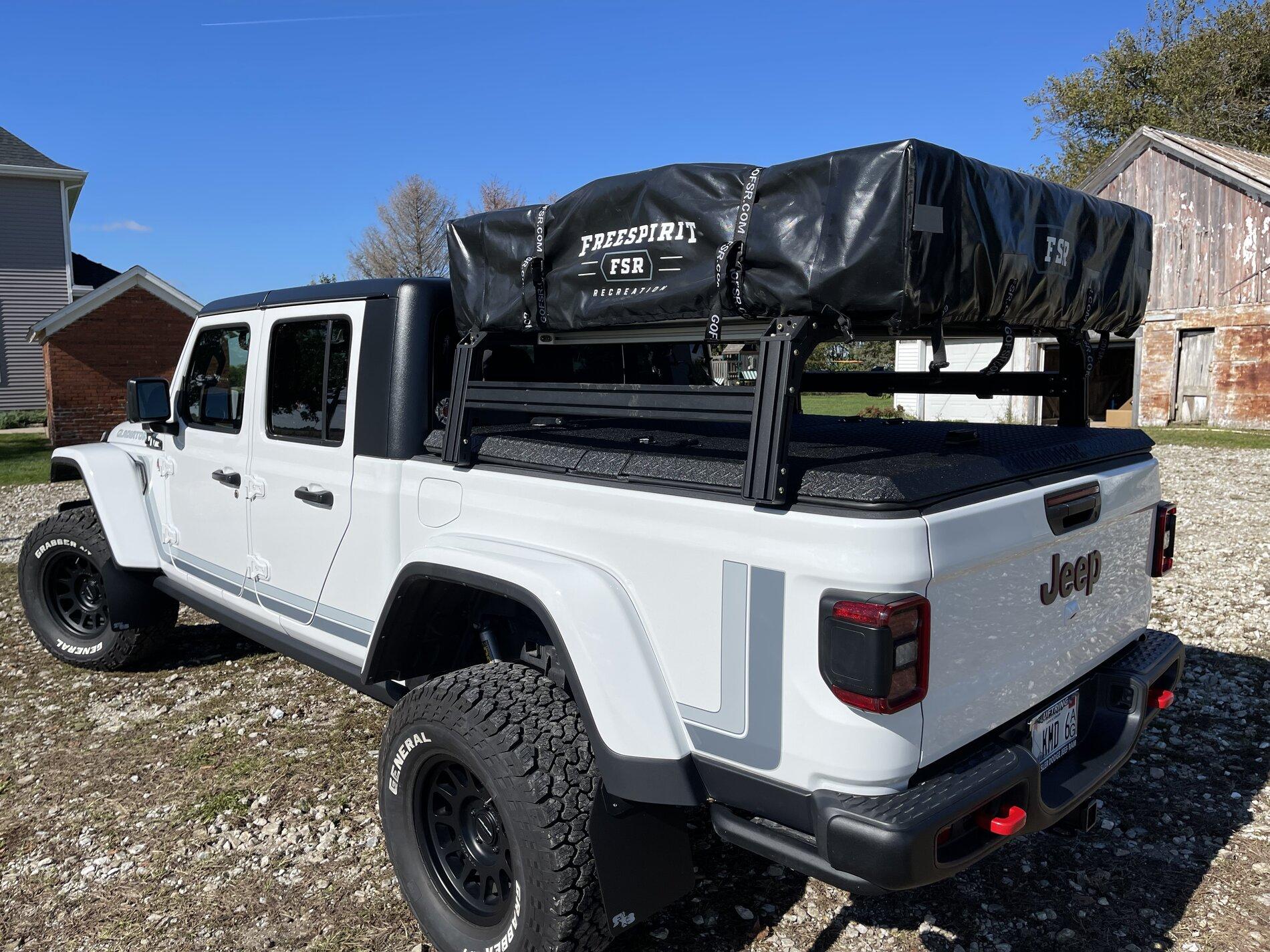

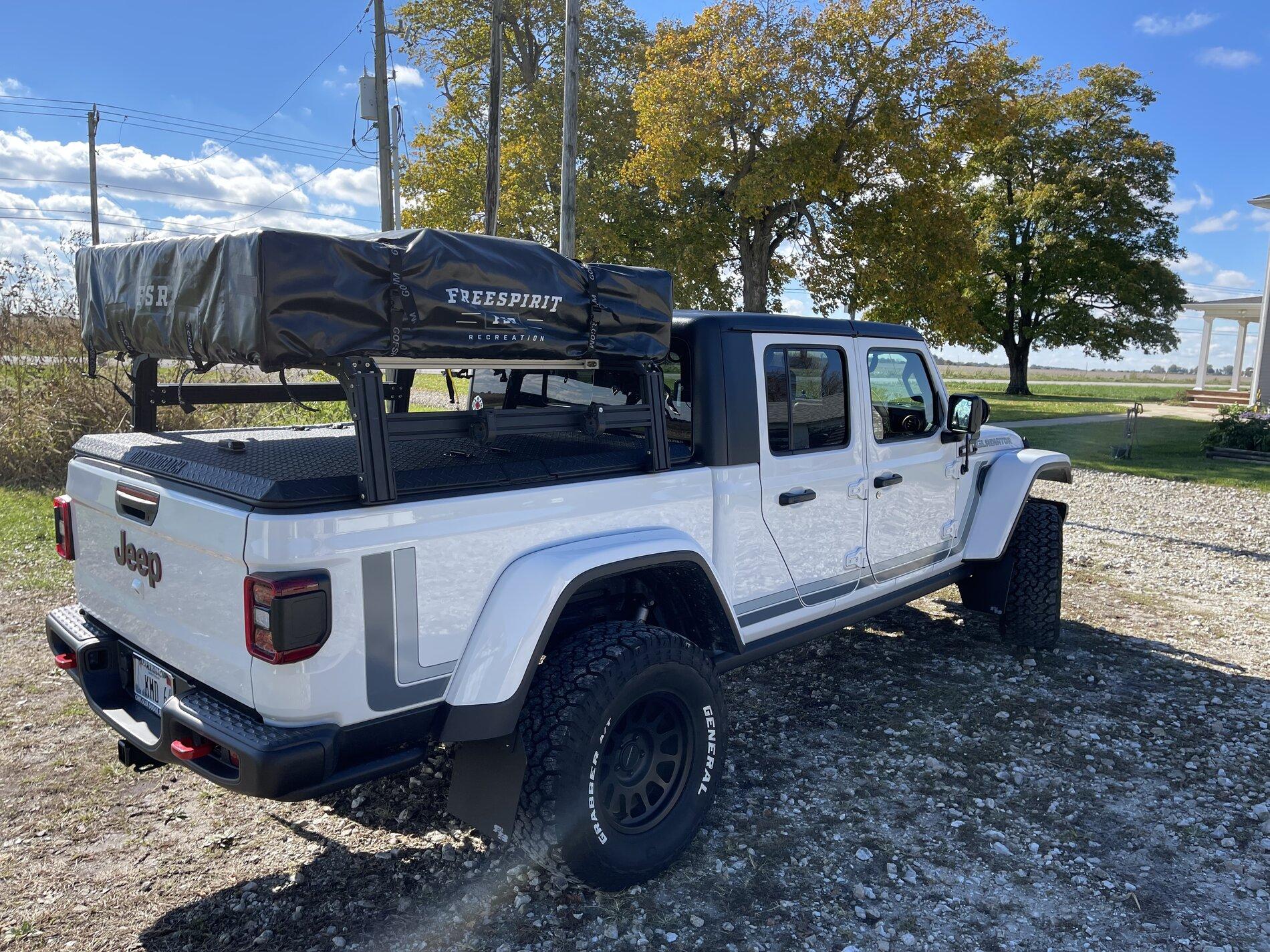

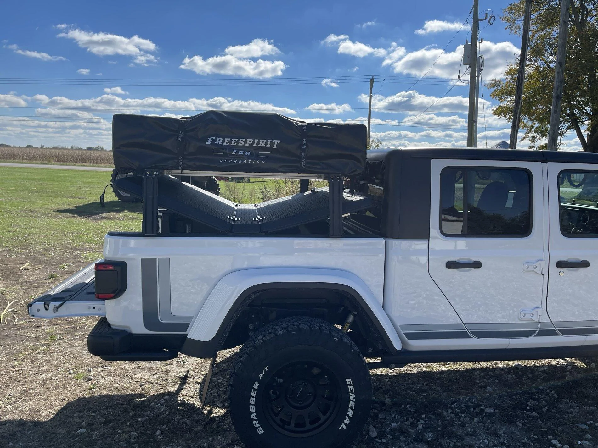

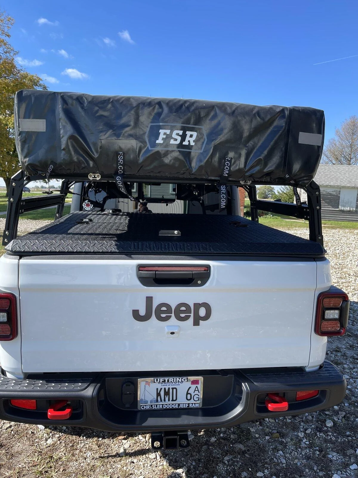

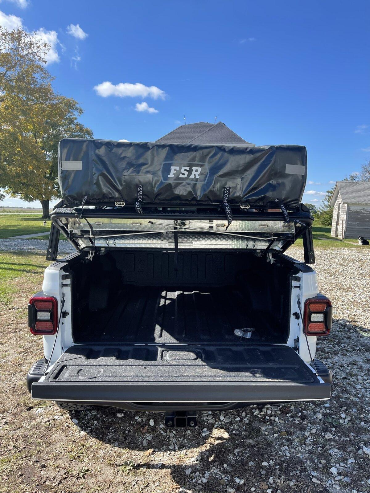

I paired my diamondback with an Xtrusion Overland bed rack. I can open the diamondback with the rack on. As you can see, my mid height rack limits how high the cover opens. A cab height rack would be better, I think. I don’t have the rack all the way set up but this should give an idea of how it works in case anyone wants a similar setup.

What height is yours, I have the 15" extrusion overland ordered to use with my Diamondback. How is the seal around the extrusion brackets?

I have the 15” rack height also. The back section opens more than wide enough to easily access the bed. The front is limited. The seal is ok around the brackets. It’s a little finicky to get just right but does seal up mostly.

Can you measure the clearance from the top of the diamondback to the bottom of the top bar? I am thinking of storing a Roam Case on top of the diamondback. I think they are 11 1/2" tall

I don’t have the rack on the truck right now but I did measure as I want to do the same thing w a foam case. If I remember correctly there is 13” of clearance from the deck of the cover to the bottom of the rack. That doesn’t count the latch handles for the cover though. The 95 liter would probably work but will be pretty snug. The 83 will go no problem.

I plan on getting the diamondback eventually and have nearly hung up the idea of a rack since most arent compatable. But that is nice. Not crazy about it not allowing the cover to completely open, but looks good nonetheless. Do they make a cab height version of that? Ive never even heard of that brand.

Yes. They make a cab height version. Mines not far from opening all the way so I expect a cab height rack would allow the cover to open as designed.

The rack isn’t a custom order. Go to their website and click on Jeep Gladiator and. You will see the rack options. Make sure you pick “wide wing brackets”. That’s what make that works. After that it’s just a matter of picking what height you want. The whole rack is modular and a really slick system.
