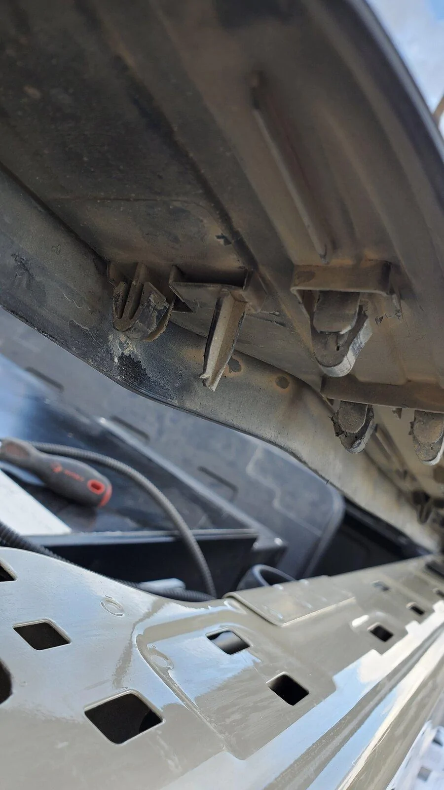

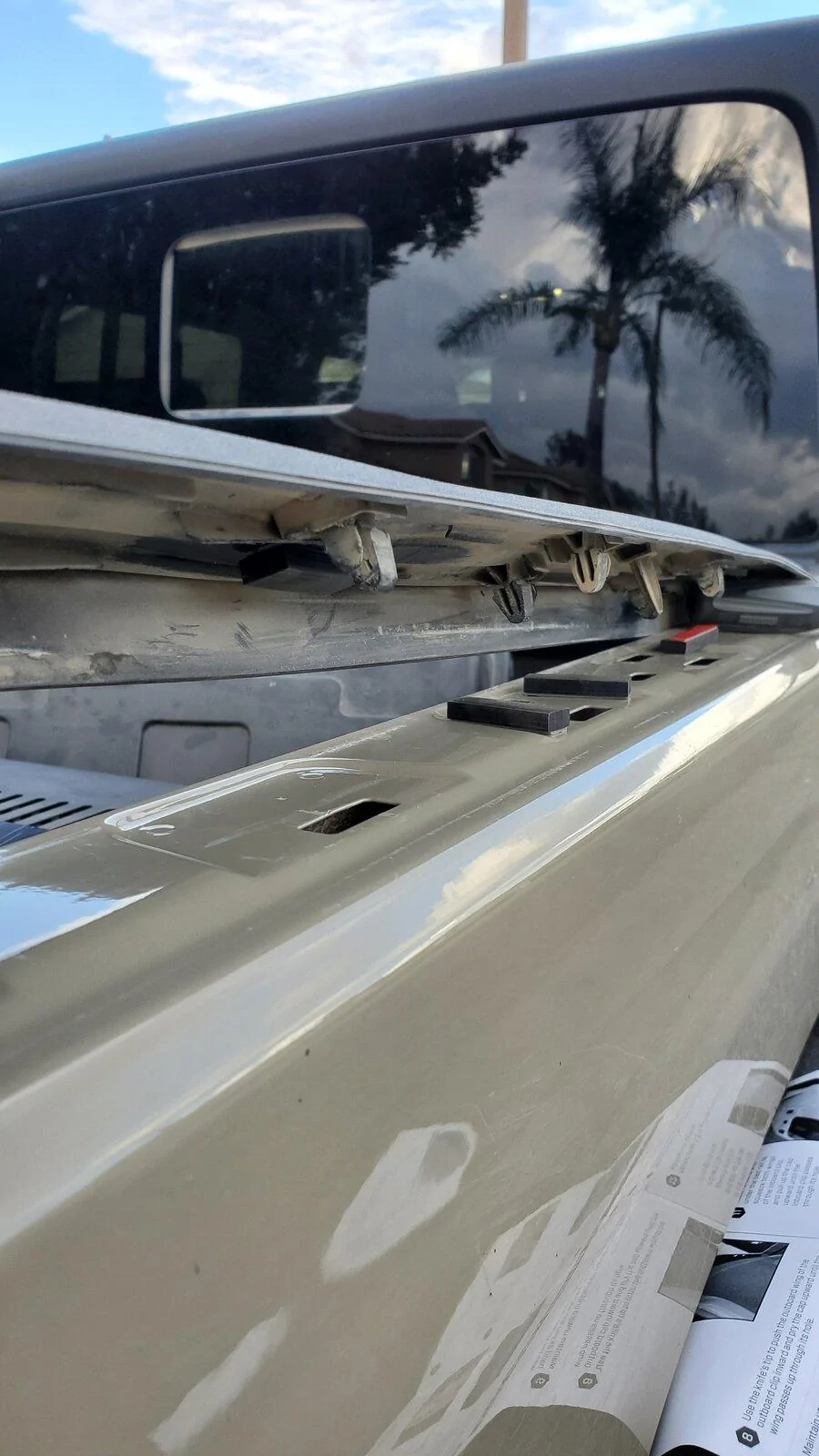

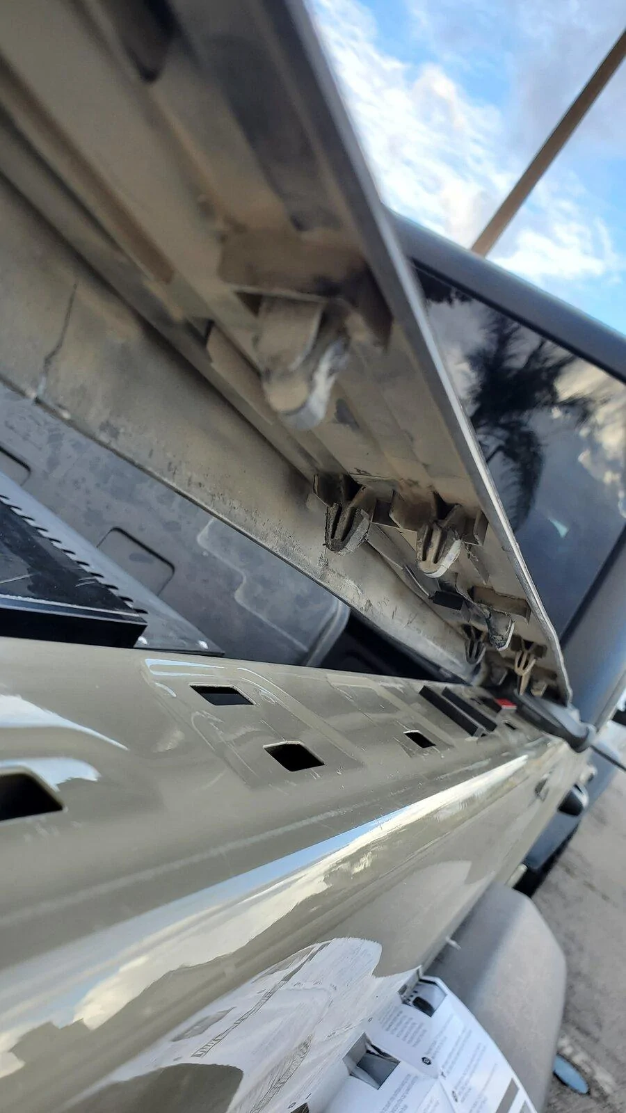

Here are a couple of pics I took during the process so you guys can see what the clips look like. Once you understand them they aren't that hard to remove unless you've got zero patience. Also by looking at how the bed caps are made you can understand why they deform. There are thin ribs that run the length of the caps that maintain the distance and support the weight of anything on top. Not a great design.
Once I put the shims in, the dents in my bed cap ate coming back out but if I sell my cover I'm replacing my caps.

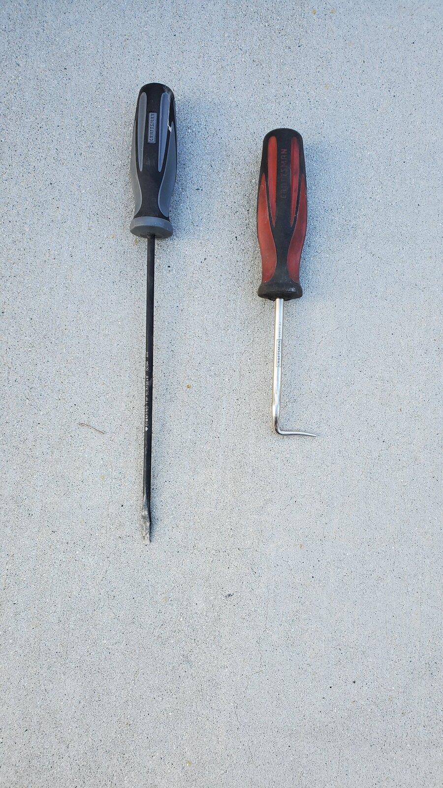

I like your tools....easy install, I have to do the same....

Thanks for this. Very helpful. Where did you start? Did you take the taillamp off and start from the rear?

Yes, start by removing the rear tail light assembly and reach inside to do the first two clips by hand. You can then start moving forward one clip at a time. Patience is key, once you get the hang of it it's pretty easy to remove.

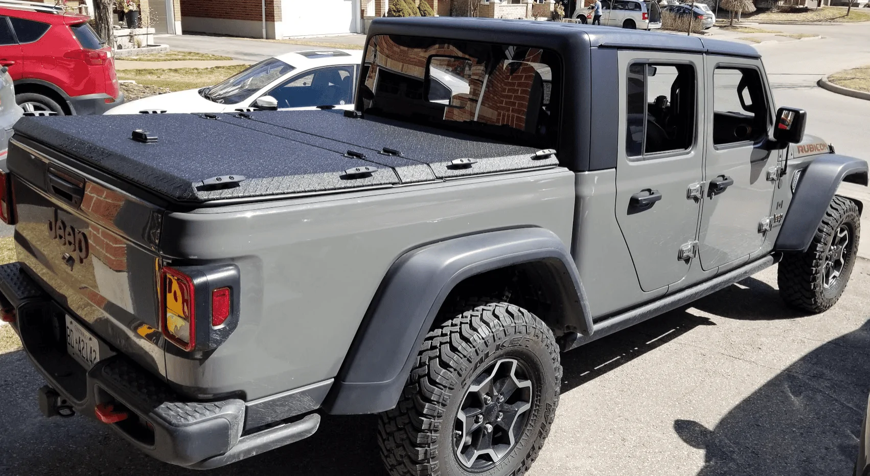

That's an SE, like mine. It has a 400lb dynamic load capacity which, unless you're loading a small tank on it, it is more than enough for most uses.
Diamondback also sells the cleats separately so you can easily add more tie down points. That's what I did. Spaced equally at 18 3/8" o/c .
