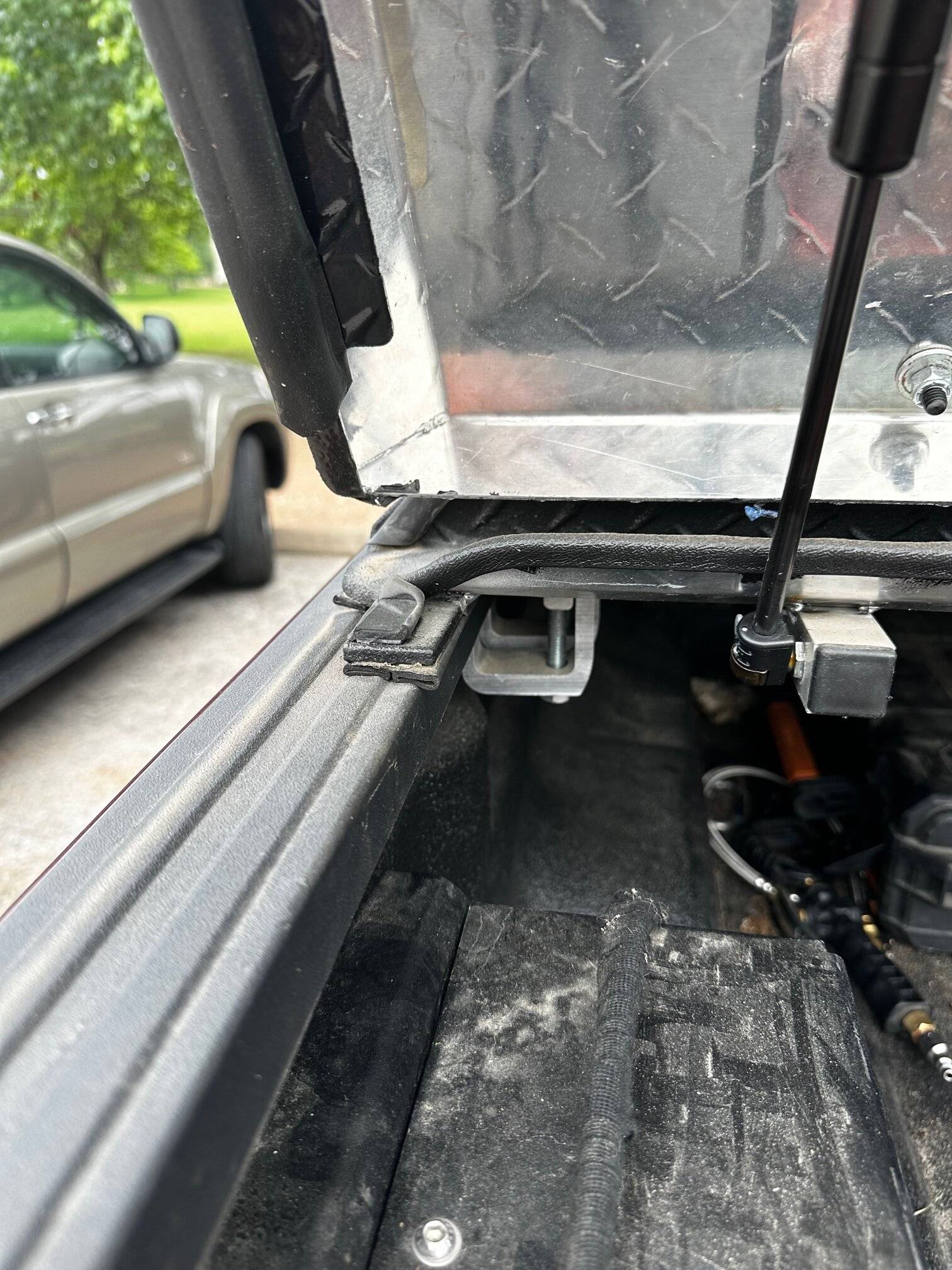

I have the 270 version and the large door was leaking up near the drainage channel. I had to add a piece of the left over weather stripping to this area in order to get the leak to stop. You can see the weather stripping in the pic below that has been crushed, that is what I added to both sides to get the leak to stop.
Jeep Gladiator Diamondback HD Leaking IMG_0816
