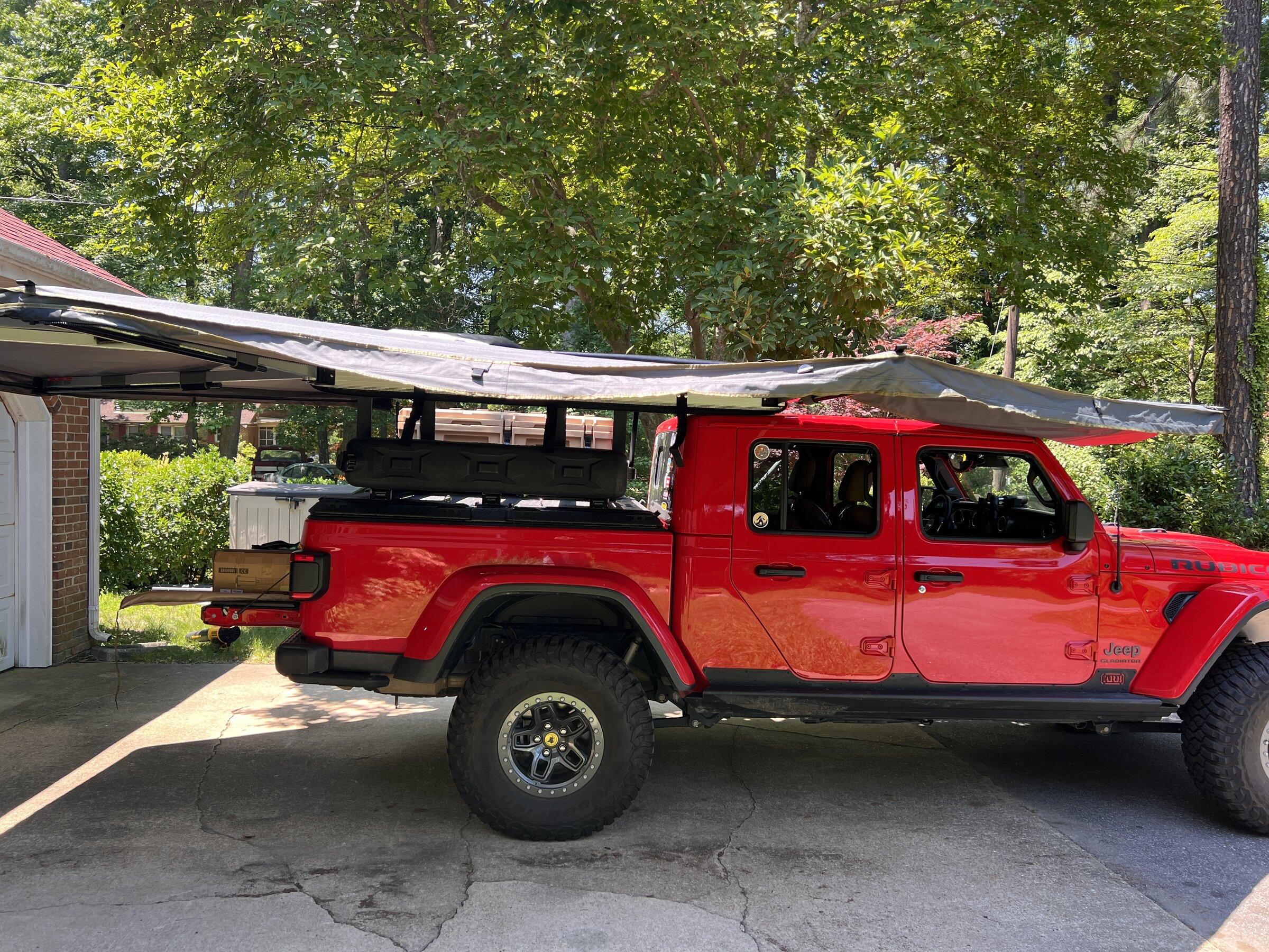

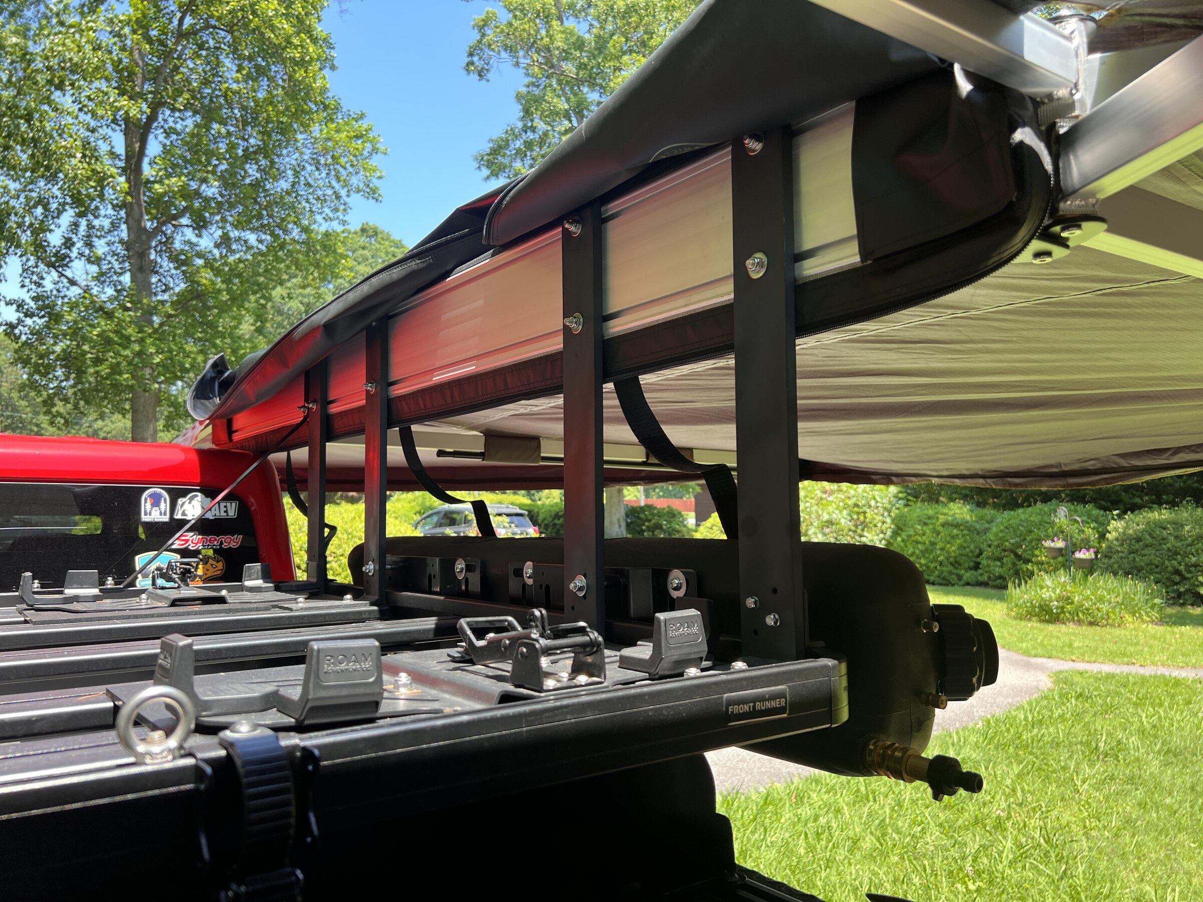

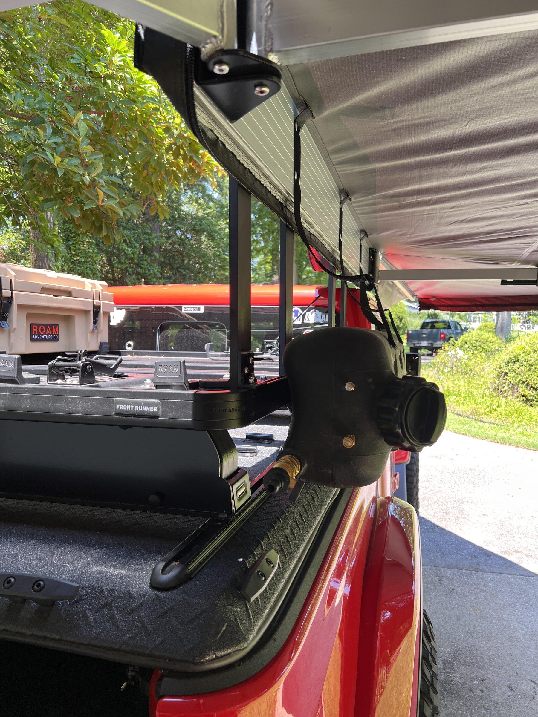

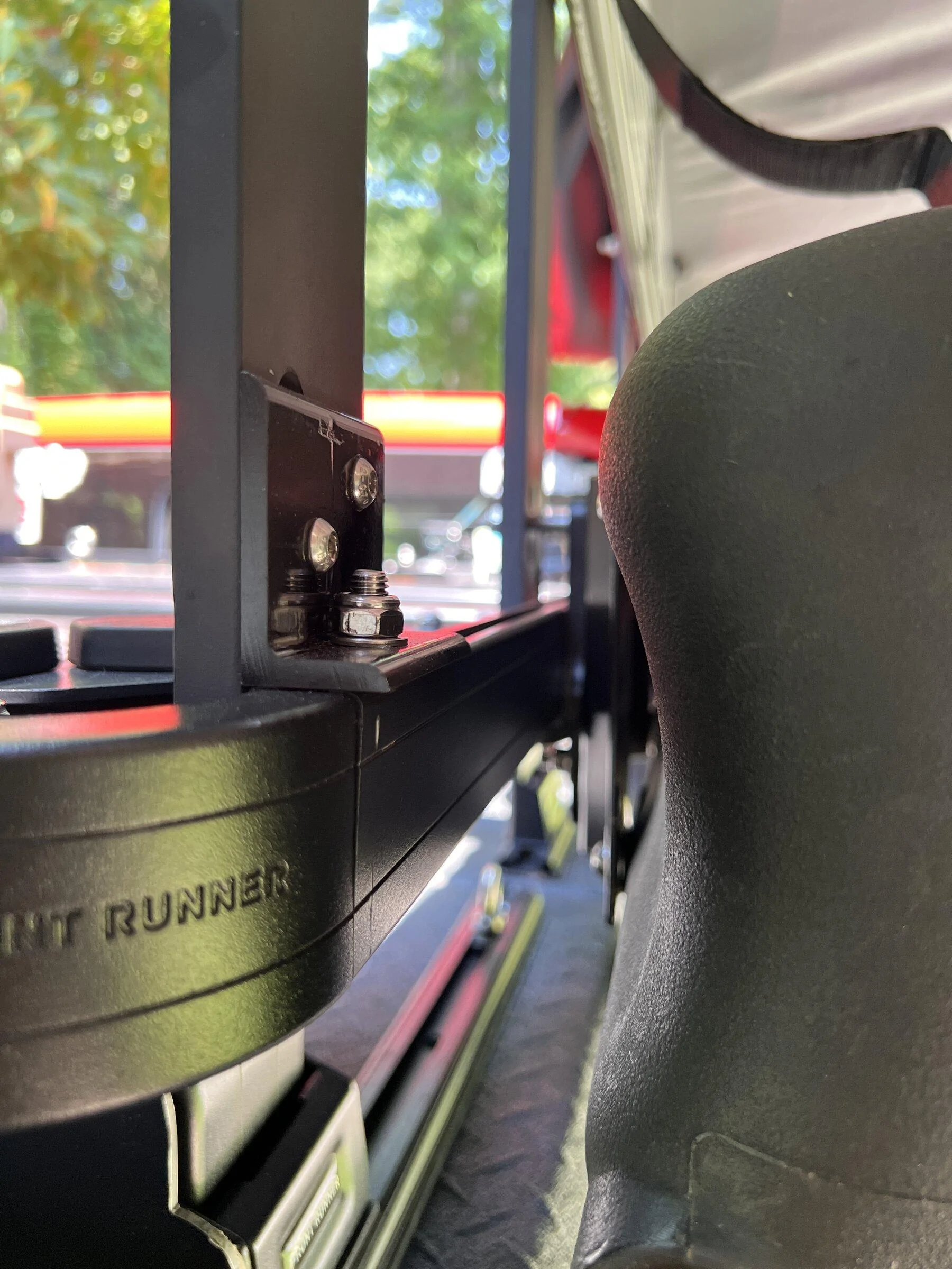

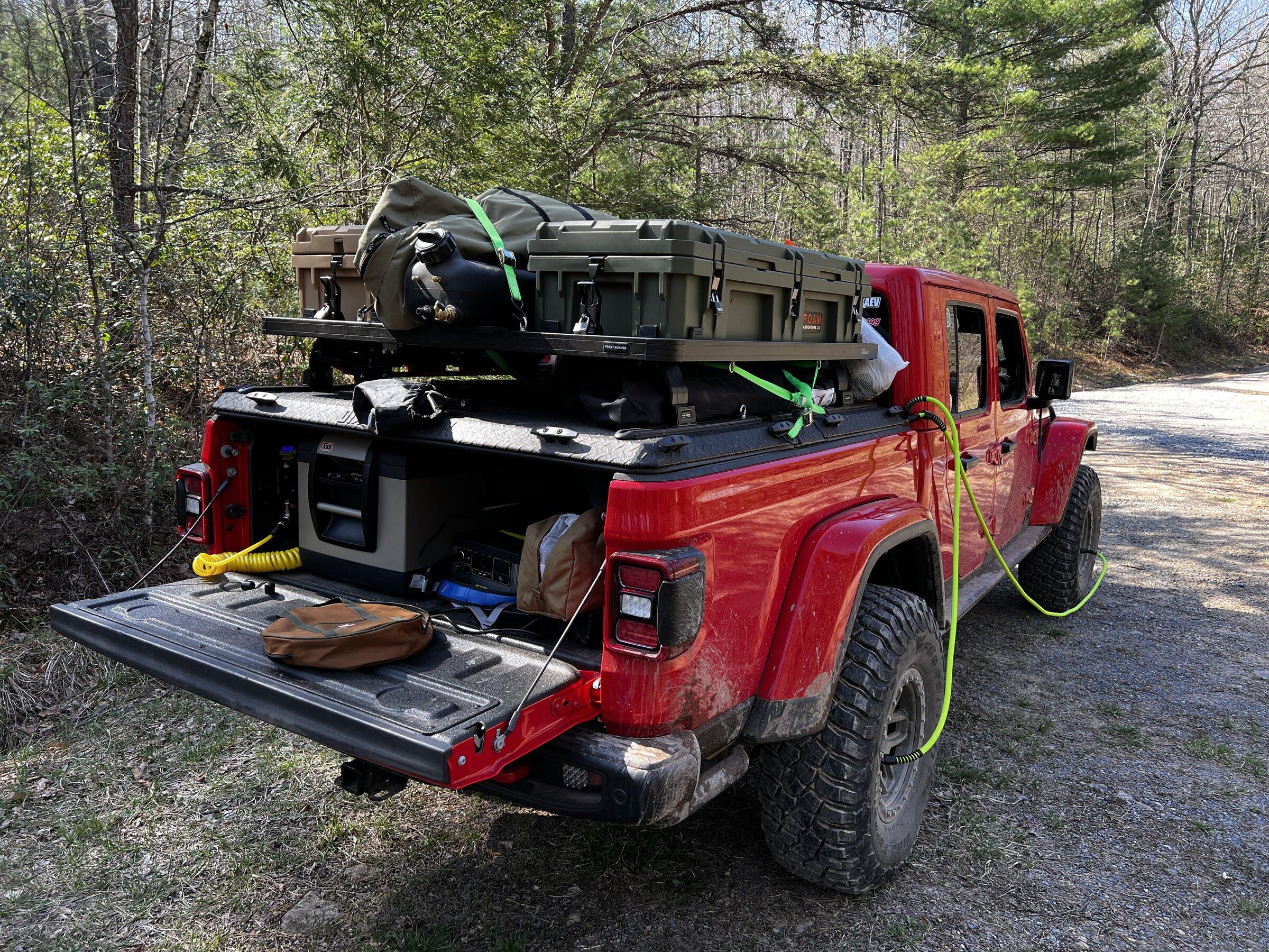

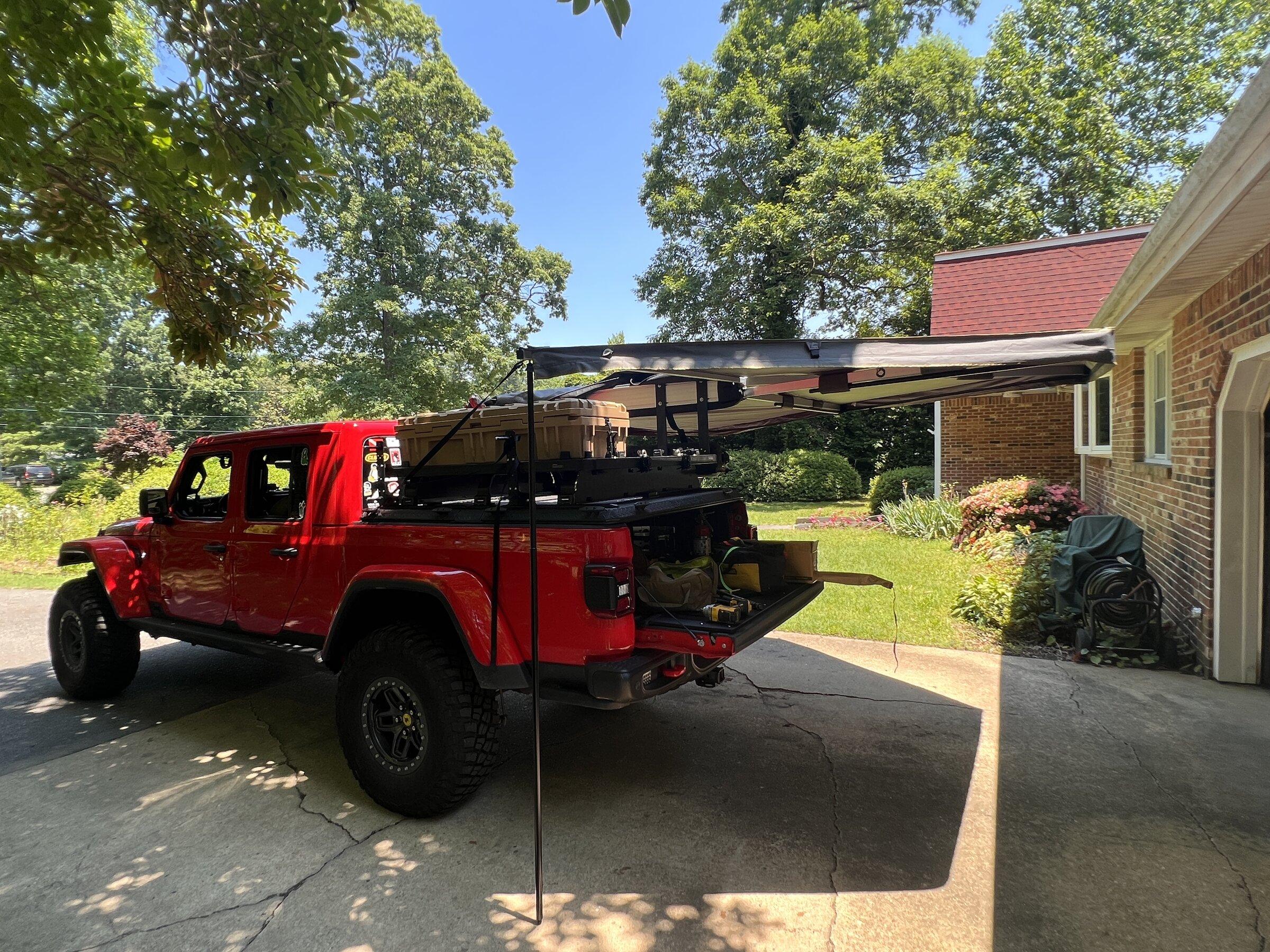

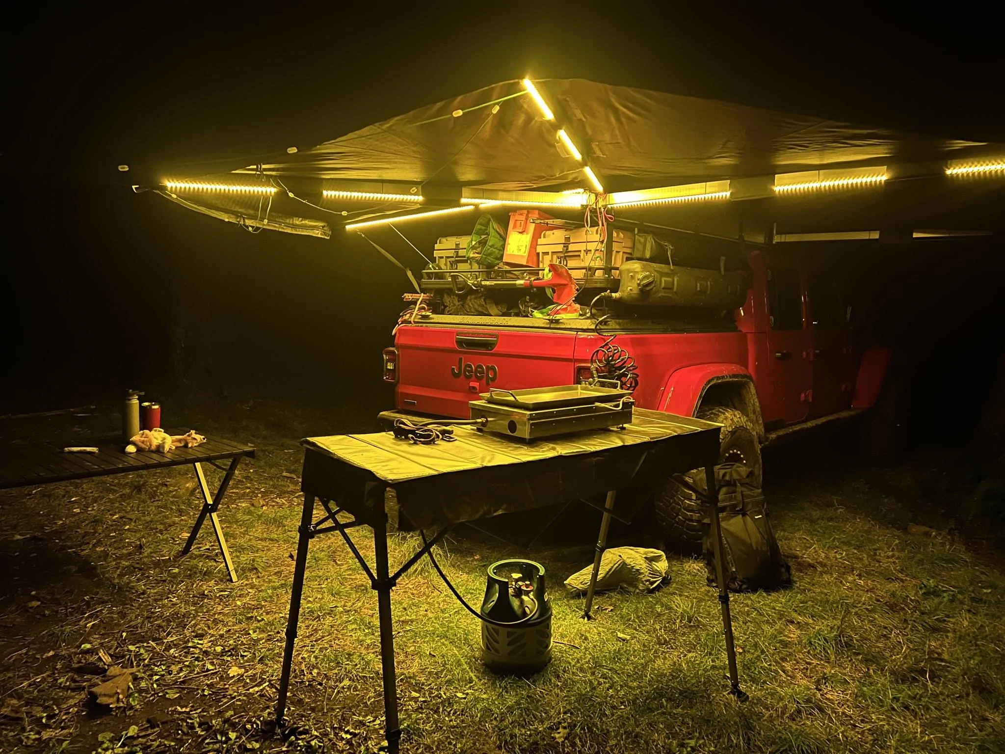

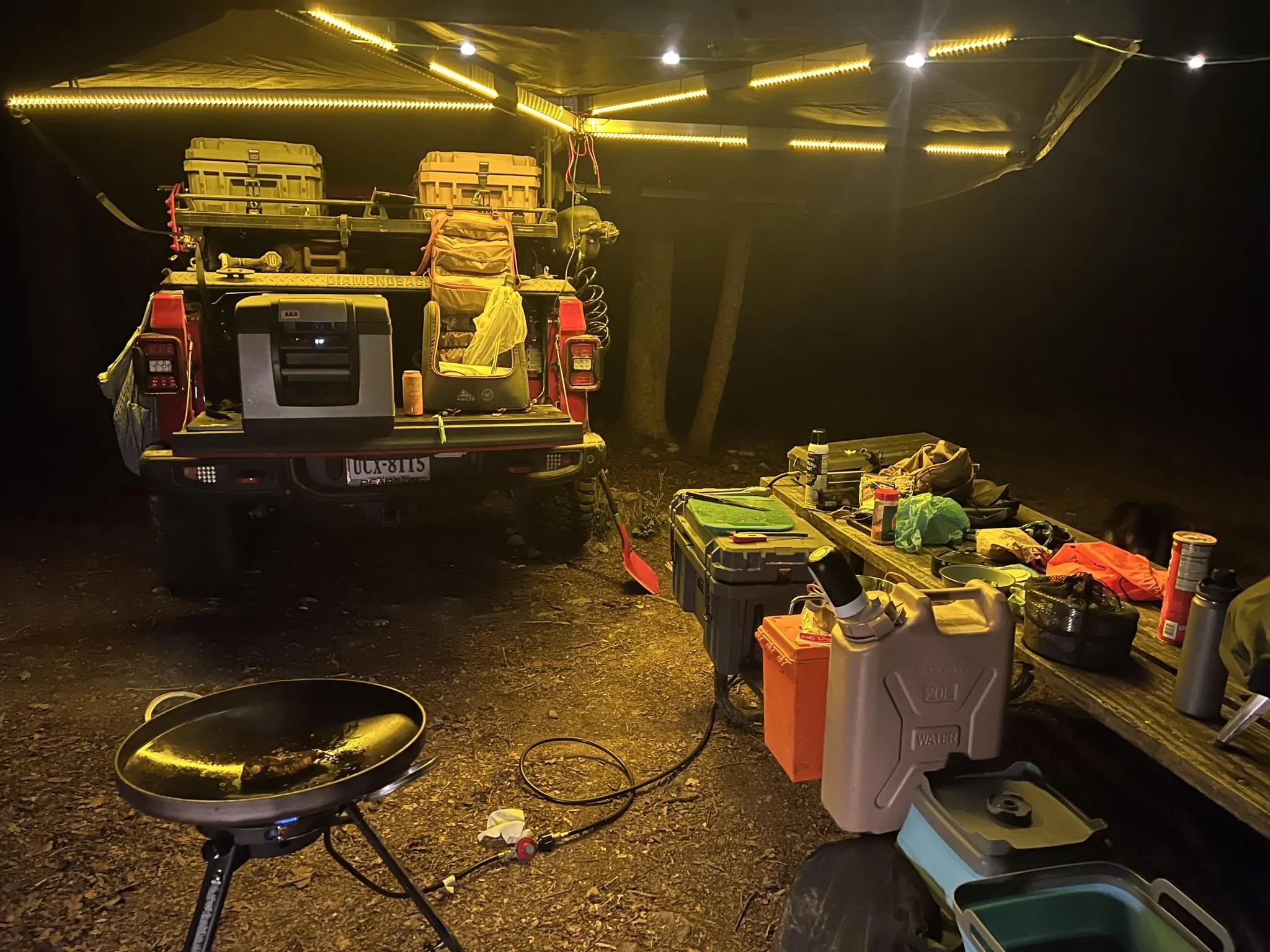

I decided I wanted an awning. I really like the Diamondback + Front Runner setup since I can mount Roam cases and carry my Gazelle T8 flush with the roof. Everything is locked up and everything is protected from the weather. I can carry bikes without them being 10 feet off the ground, and I can remove it all easily to use the truck as a truck. The problem with adding an awning is the getting it to the right height, so I sort of wrote it off with this setup. I saw the video from Sketchy Jeep which got me thinking about it again seriously.
I went with an OVS awning but went with a different approach to the mounting. This uses 20 inch aluminum brackets from Original Granite Bracket. I’ve seen some Toyota folks do this.
https://originalgranitebracket.com/...tertop-support-bracket?variant=39385647415393
Each of these brackets can support over 200lbs at the end and there are 4 oriented 90 degrees to the angle with that spec. I didn’t think I needed to dust of my dynamics classwork to see that there is only a small fraction of the weight of the awning applying a force in that direction, so I think this is plenty strong. The only issue would be flex. Without any additional support or brackets, it’s actually surprisingly good on road but I wanted it to be off-road stiff. I added additional brackets from 80:20 attached to the Slimline II so that the awning brackets are bolted from both sides. and an additional 45 degree brace I fabricated from aluminum stock where it overhangs the cab. I can not get this thing to flex at all. It’s totally rigid. I then repurposed the OVS mounting brackets to hold my Waterport Weekender which also serves to further grab the underside of the Slimline, so the two inner awning brackets are affectively bolted to the top and bottom of the rack. It’s ridiculously stout despite all of that height. The awning doesn‘t flex at all and neither does the Waterport. The ROAM rugged mounts clashed with the awning brackets so they now sit on 1/4 HDPE plate spacers I fabricated to clear the brackets.
I’m in the process of fully enclosing the space between the Slimline and the Diamondback to use for chairs, tables, wood, etc using aluminum composite sheeting. I’m also adding an OVS shower stall this weekend.
I think I’m going to upgrade to the new AEV 3 inch springs, although with all the weight the performance is still great on and off road. The eco-diesel shrugged off
the awning. No change in MPG. It looks a bit odd without the ROAM cases and just the awning sticking way up there but awnings look odd already.
I’m going to make a hoist to remove the whole Slimline II, awning, ROAM boxes, etc when not in “overlanding mode.”
Jeep Gladiator Diamondback HD D323E357-6686-4660-A8BF-F3B88E75F4F2
Jeep Gladiator Diamondback HD B568D001-81CC-49BF-ACE4-137D90E2451B
Jeep Gladiator Diamondback HD 0BD401B8-D309-4EC9-A400-ECAD1193C3F7
Jeep Gladiator Diamondback HD 35C45212-4831-4865-9553-4722190D655E
Jeep Gladiator Diamondback HD 860AACD2-BC3E-4668-85DB-003E719EA3E9
with both ROAM cases. The awning clears these fine and the Waterport is now moved off to the side so the Gazelle will fit better.

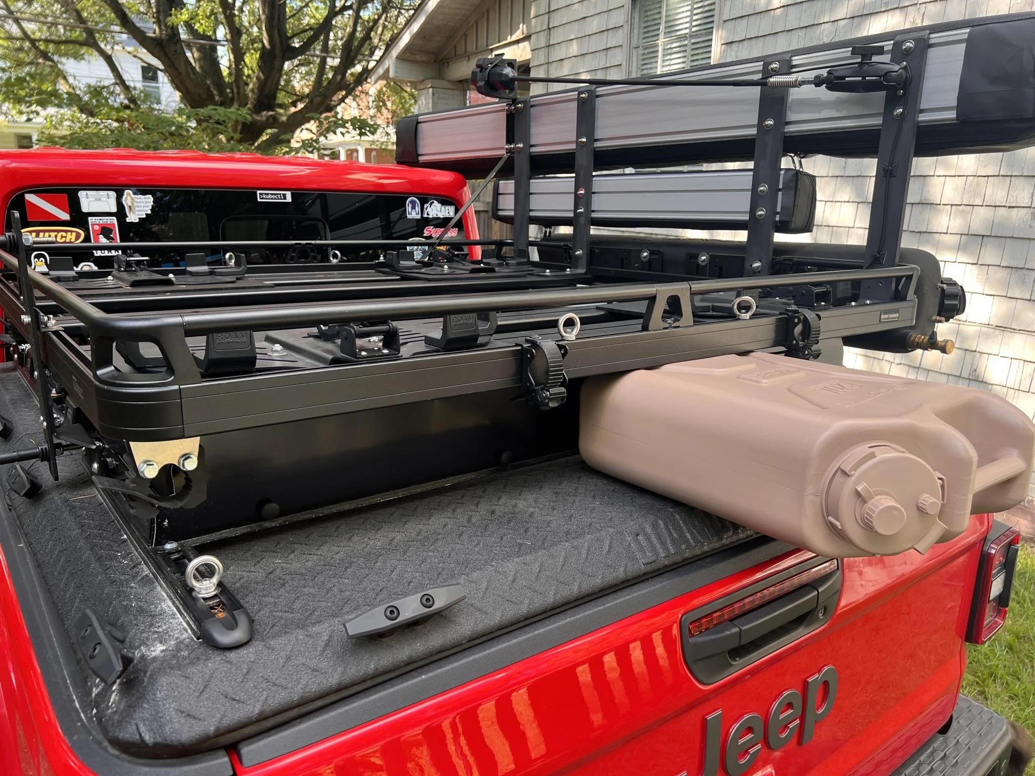

Diamondback/Front Runner Water Can PSA:
Scepter NATO water cans will fit under the front runner rack. These cans don’t leak on their sides, if you use the scepter wrench to tighten them. The space between the Slimline II and the DB is enclosed on my truck so I just throw them up there and don’t worry. They should fit under the cross bars as well but obviously will require more care to secure them. It’s a tight fit which helps prevent them from sliding around.
I have a cheap $14 electric pump which perfectly fits the Scepters to provide water on demand
https://a.co/d/fayzF2L
Between the Waterport and 2 cans, I’m carrying 18 gallons of water now.

And yes, I take a pizza oven overlanding/camping with wood, along with 200w of solar, a Geyser shower, Clean Waste toilet, Southwest Disk Discada and burner, Breeo grill, a Kelty folding sofa and an f’ing rug! I also still carry a full compliment of recovery gear, tools and a spill kit.
With the DB/Front Runner/Roam setup, all my insane crap fits in the back and the dog has the whole back seat to himself. The AEV springs handle it fine but I may upgrade to 3” springs for more stiffness on road when loaded.

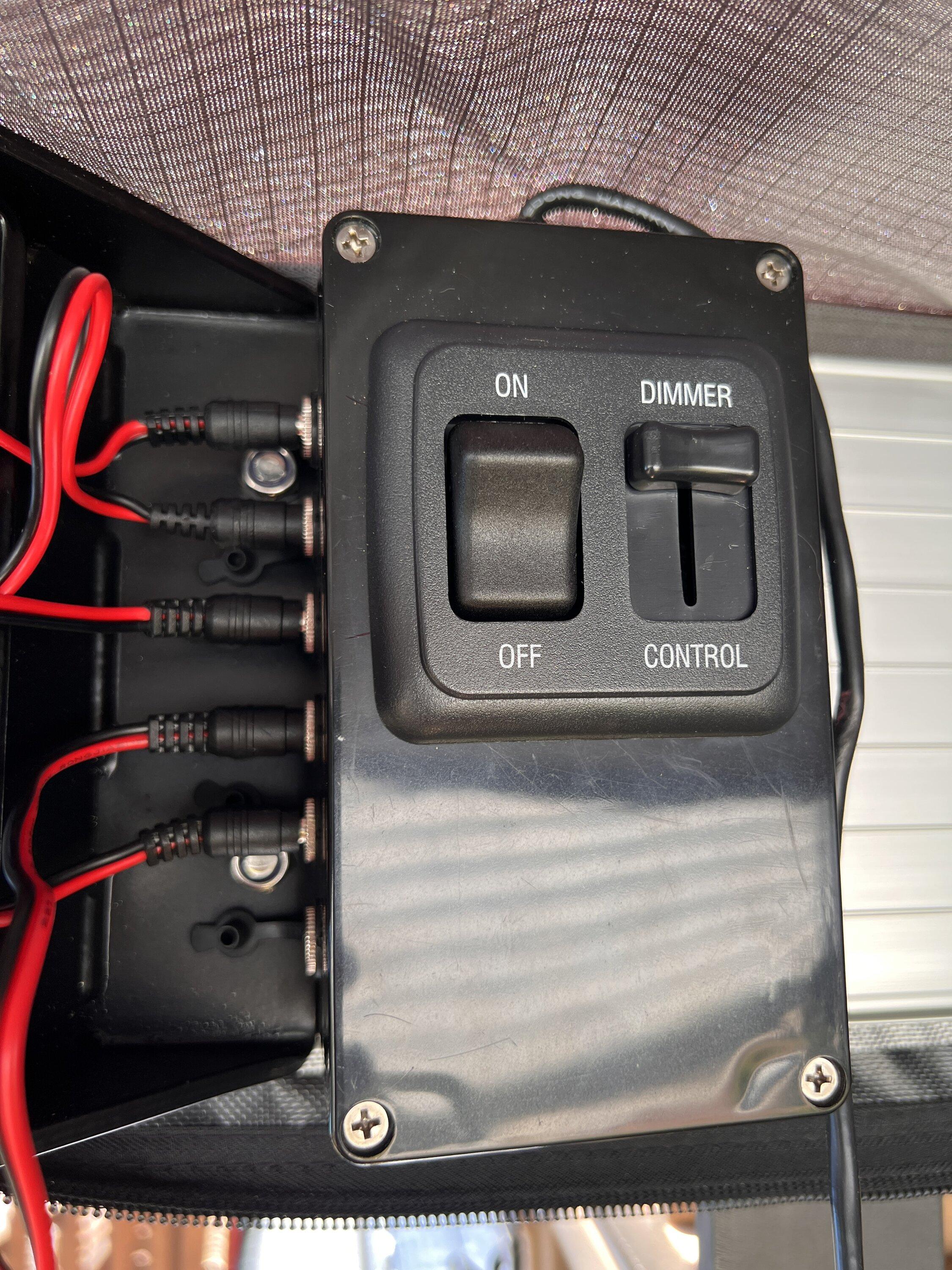

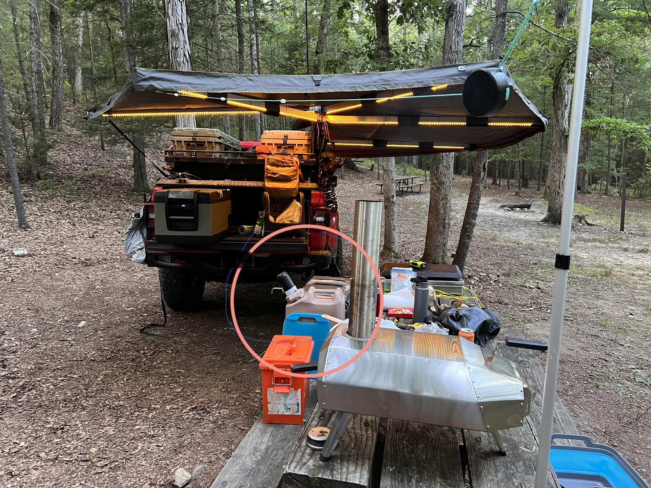

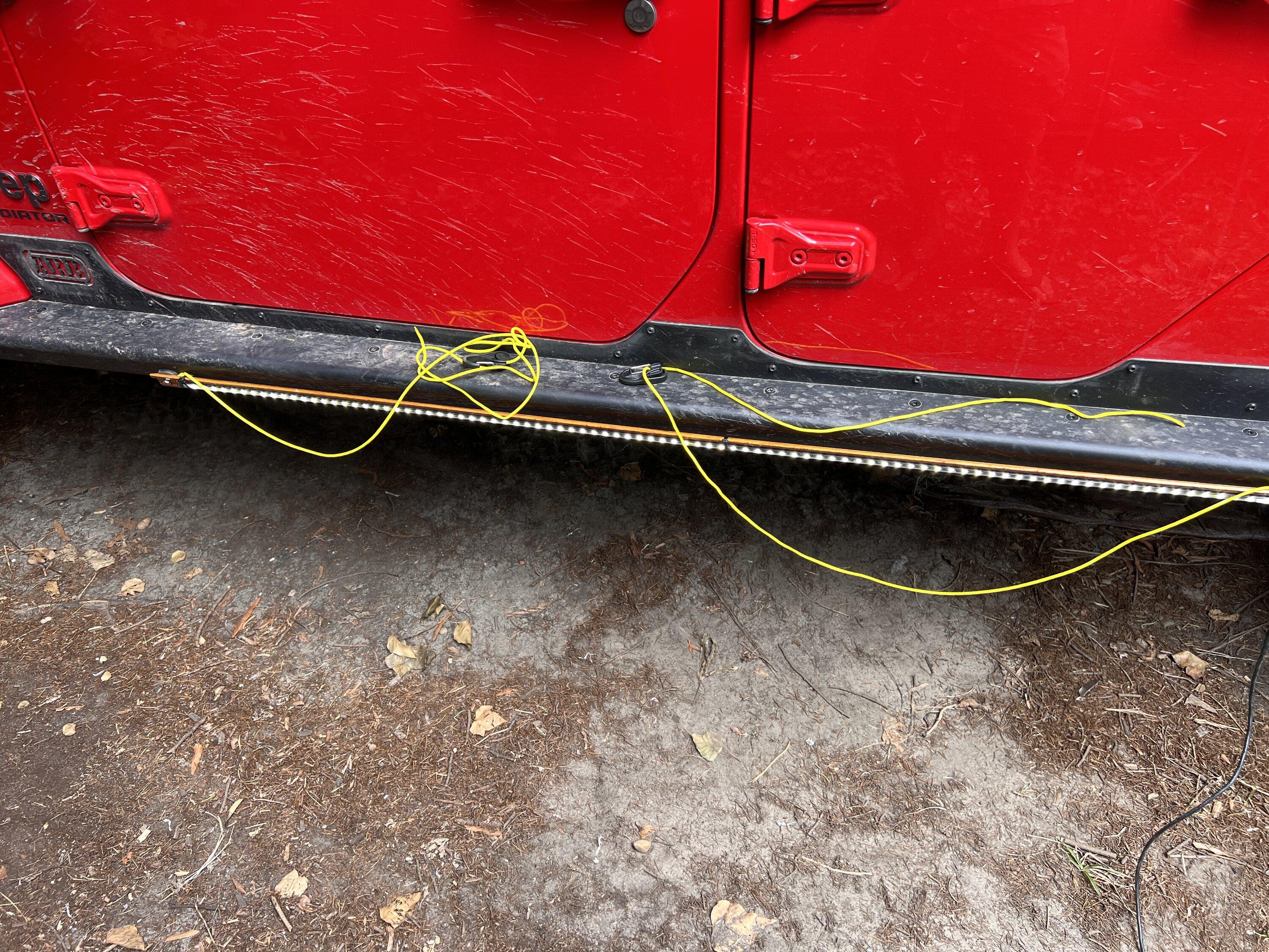

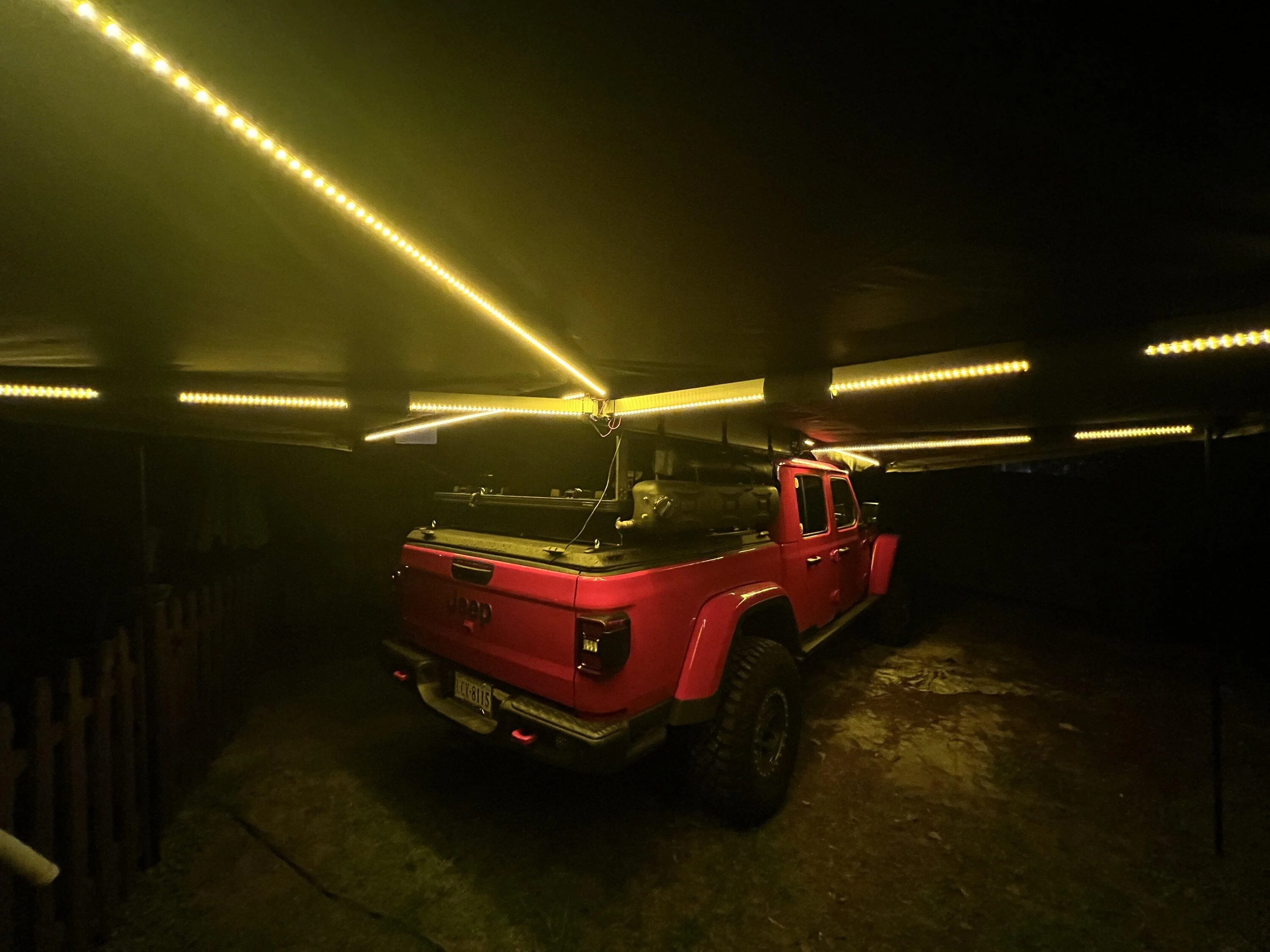

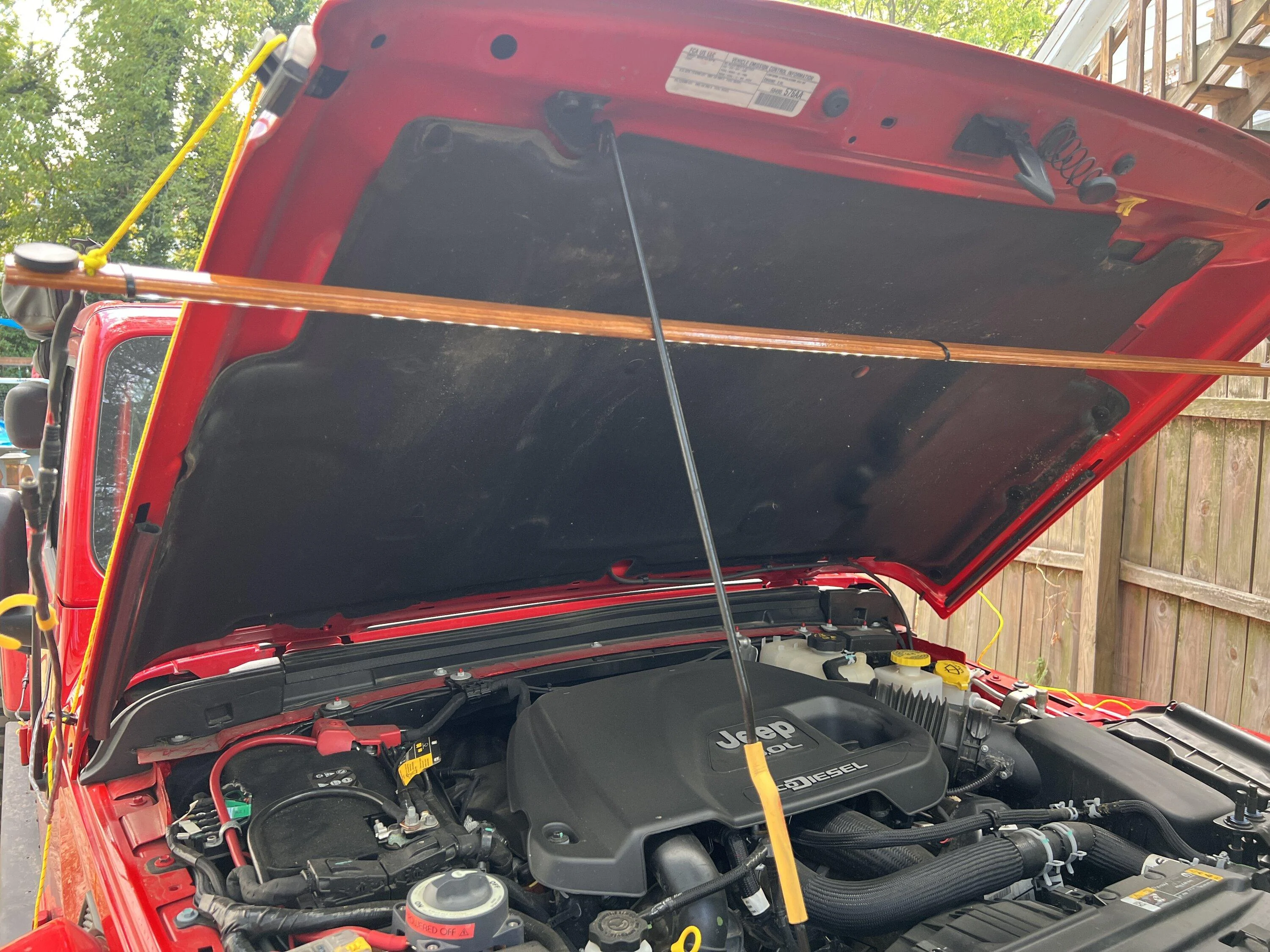

Awning Lights Update:
I added a ton of lights to the OVS awning. On each arm I added 1 yellow and 1 daylight strip. The daylight is for working on the truck in the field or emergencies where you need a lot of light. Sorry, I don’t have pictures with all of the white lights on. They’re insanely bright. The yellow is great for camping and bugs don’t seem to be attracted to them very much.
Jeep Gladiator Diamondback HD 4E2859E8-85A2-4E3B-B58B-3BCDE8CE41D3
Jeep Gladiator Diamondback HD 64E8FE76-A76C-411D-B35C-139CEB5E2B6E

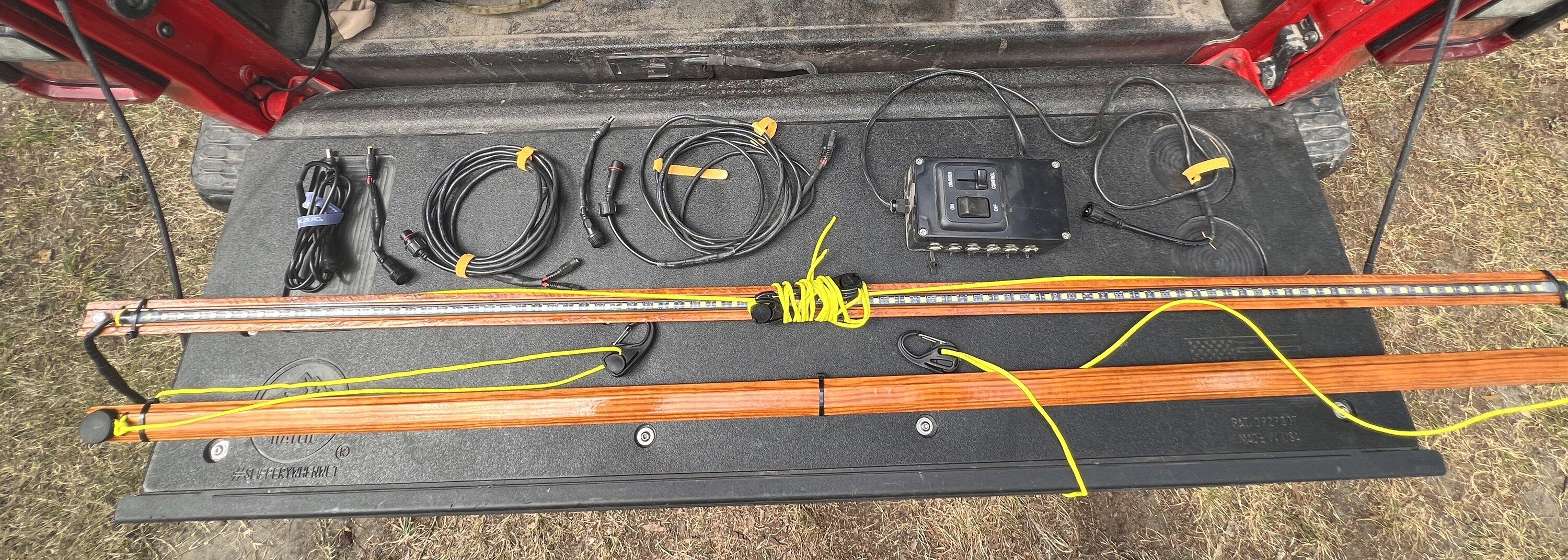

I made this control box with a dimmer with ports so I can either plug in any combination the yellow lights or the white ones. It velcros to the awning or to a spot in the bed next to the tailgate where it gets power from a waterproof port wired to a fuse panel under the hood.
Jeep Gladiator Diamondback HD 05C33F1E-2801-4DAE-821F-3D55B09E1A9C
Each full strip pulls about 1.6 amps when warm or cold. Each awning bar has both 1/2 of a yellow strip and 1/2 of a white strip. There are a total of 6 yellow and 6 white half LED strips but only enough ports to run a maximum of 6 devices, 7 if you include the 2 at the front powered by a single wire going through the awning frame. So this draws about 6 amps total. The 10 amp fuse under the hood is sufficient.

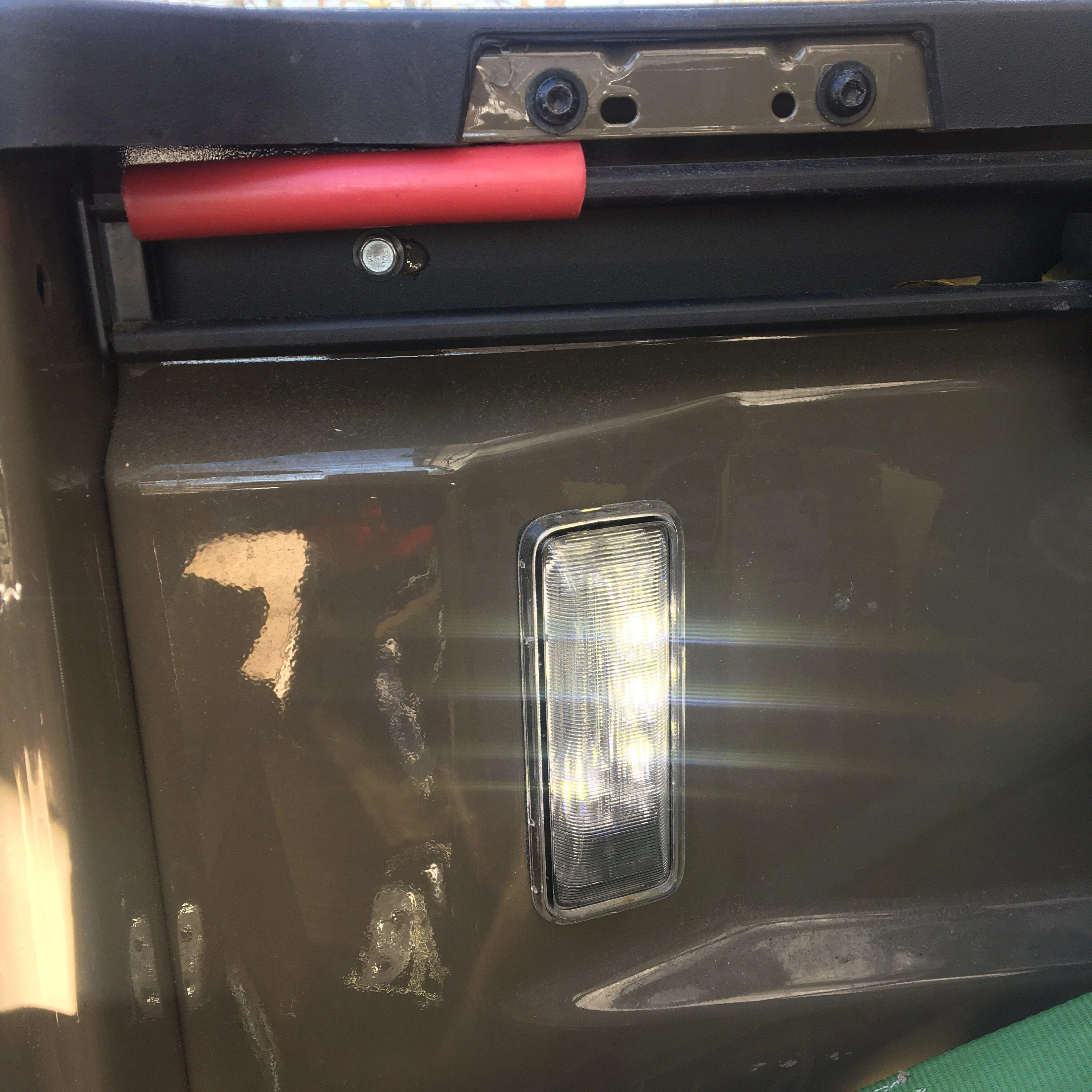

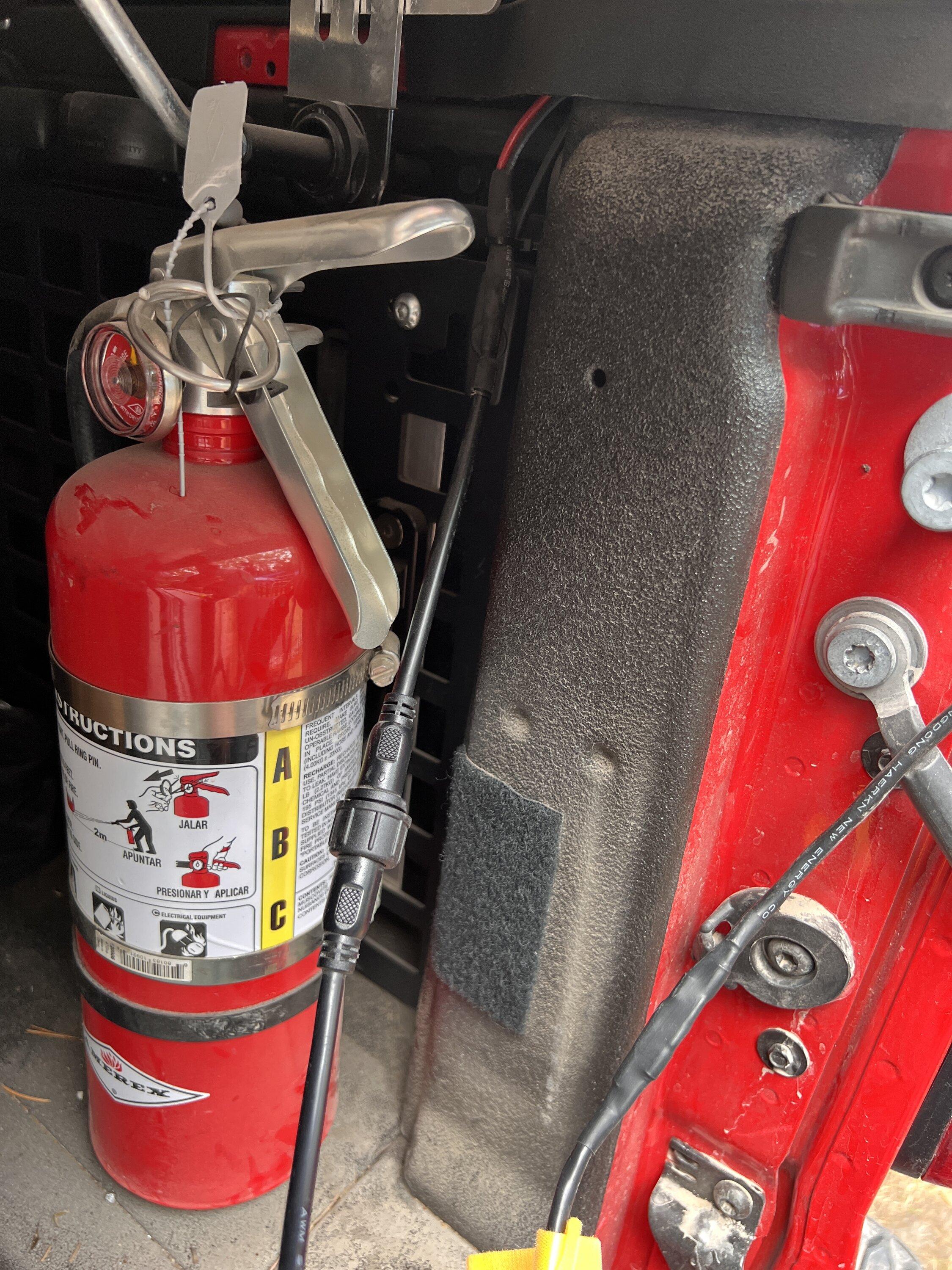

Additionally I’ve made a few other items to add more flexibility. I had two extra Oracle Lighting bed lights that I mounted to some wood trim. They have magnets at the end and clips with adjustable paracord to attach them to things. I can use these as under hood work lights, hanging from the awning over a table, under the truck as work light or extending out from the awning to further light up a camp site or work area. They’re each 5 feet long.
Jeep Gladiator Diamondback HD 037BCF1E-406D-432F-80C1-E38DA2DBB075
Jeep Gladiator Diamondback HD 87FC3859-E5B2-4CC1-BE38-DA030FEE3945
Lastly, I’ve made 2, 10 foot extension cables for these lights each with two female heads that can plug into the control box, directly into the power port in the bed, or each other. I’ve also made an adapter cable to plug into the 12v port of a Goal Zero. The control box can also plug into the extension cables and/or the GZ. I usually plug it into a Yet500x so I can monitor battery usage and not drain the trucks battery.
Jeep Gladiator Diamondback HD 8295F8CE-04FF-4C0E-8A39-D29A733D49C0
The awning lights are sufficient a their dimmest when camping and draw only a few watts at that setting. All the way up they pull about 10 atts.
Jeep Gladiator Diamondback HD F2FCB255-4F67-4F78-AD93-44E0661B953F
Jeep Gladiator Diamondback HD 66B62098-7987-47C7-B4E4-B41C6AD69883
