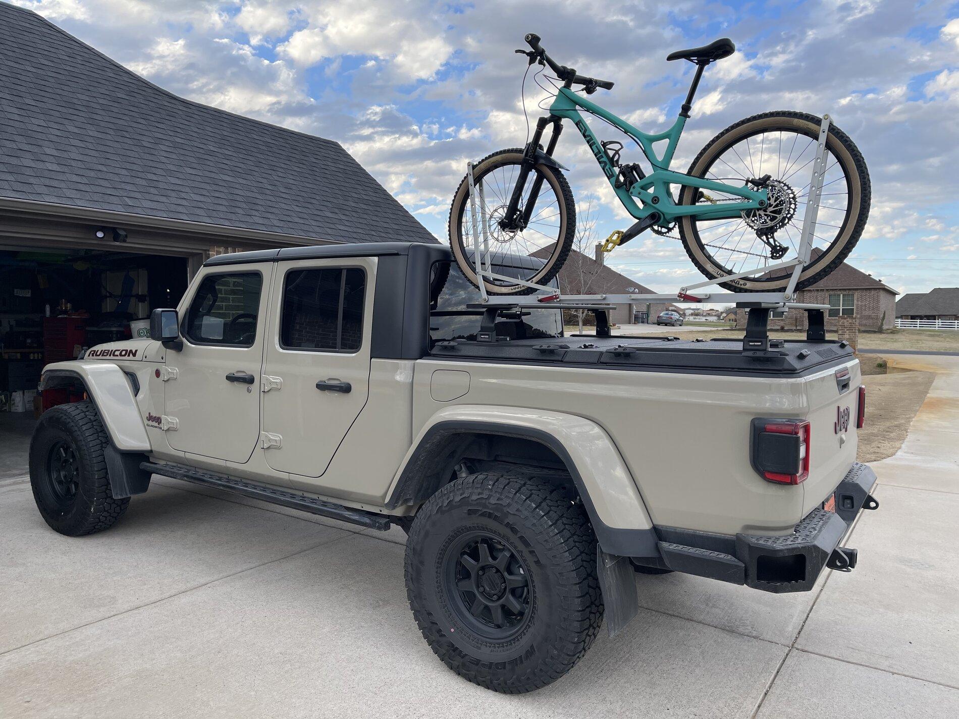

The oldest original style Yakima "1A" towers, that they still make, that were designed to clamp to raingutters when near-all vehicles still had raingutters... are about the tallest racks I have come across (I still have some). And then they also make the Yakima "1A highrise spacers" that jack the crossbars up another 3.5 inches above the usual Yakima tower height. If you mounted some of the Thule "542" "artificial raingutters" on the top surface of the DB and then clamped Yakima 1A towers with the extra risers on, you'd be getting about as tall as I think you could do with this type of arrangement. With going that tall, I'd want to make extra big anchor plates for the underside of the DB, for the bolts going through the Thule 542s, in order to distribute the pull and twist of lateral loads. Also, with the old Yakima 1As, the "O.E.M." bars are a polyethylene coated steel, but I measured and found it was some standard increment of inch increments and I was able to get some stainless tube of the same diameter - doesn't get scraped up like the Yakima poly-coated bars.
Or, go whole hog and get a set of these: https://diamondbackcovers.com/collections/ladder-racks/products/cover-mount-rack?variant=29553915209
Another thought -
Put some L-track down the tops of the covers:
https://www.cargoequipmentcorp.com/Heavy-Duty-L-Track
and then use some of the boltable hardware to bolt the rack o' your dreams on top (which you could make out of Unistrut and Unistrut hardware).
Using the L track would make it easier to mount/dismount your rack or even change your rack over time without swiss-cheesing your Diamondback over and over.

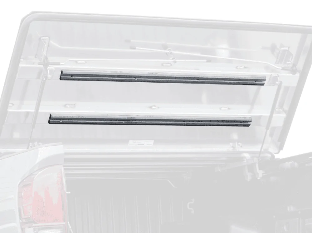

Thanks' for the info I kept researching and figured it out...:like: I have two options buying the TB from DiamondBack or I can make them with extruded aluminum 1.50 x 75 x 42
Just keep in mind, if mounting to the supports like I did, there is no way to get to the inside for a regular nut/bolt.
Got it I'm planning on using 10-32x3/4” Button Head Screws (8) 10-32 Rubber Well Nuts (8) or nutsert.

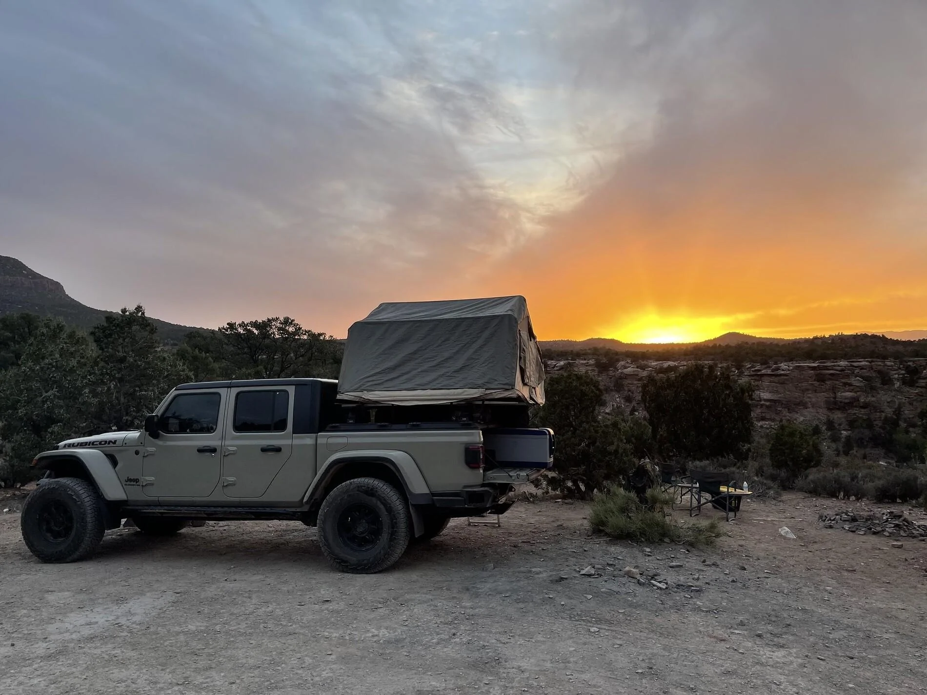

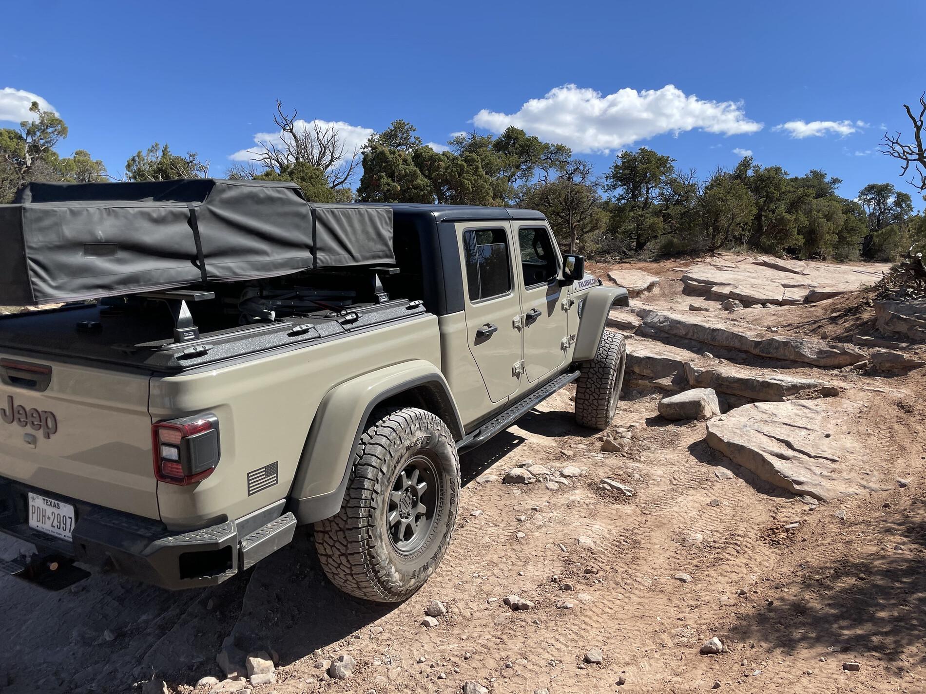

Still loving the HD cover, works great for bikes and RTT. Trying out a pair of the DB tool bars now.
On the fence between this exact setup and ACE's upper decker.
This is the hardest choice besides tires/wheels.
I know plenty of people are happy with Ace, but not my buddy. I showed him my DB, but after he saw the price he went with Ace. He had an issue on something with the mounting and sealing of it. He also finds it more inconvenient to reach items in the back of the bed.
