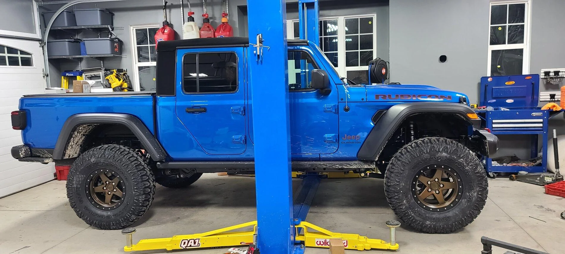

The rear is so much easier if you loosen all of the control arms, track bar, and pull the sway bar links. With that done, everything falls out and in. I was foolish and didn't do that on one side, but did on the other. Sorry for the bad picture, but this is a 3.5" Clayton Overland Plus and Fox 2.0s, with a 1" spacer in the front and Evo Overland brackets on 38s. I could not be happier with everything. It rides and drives very well.

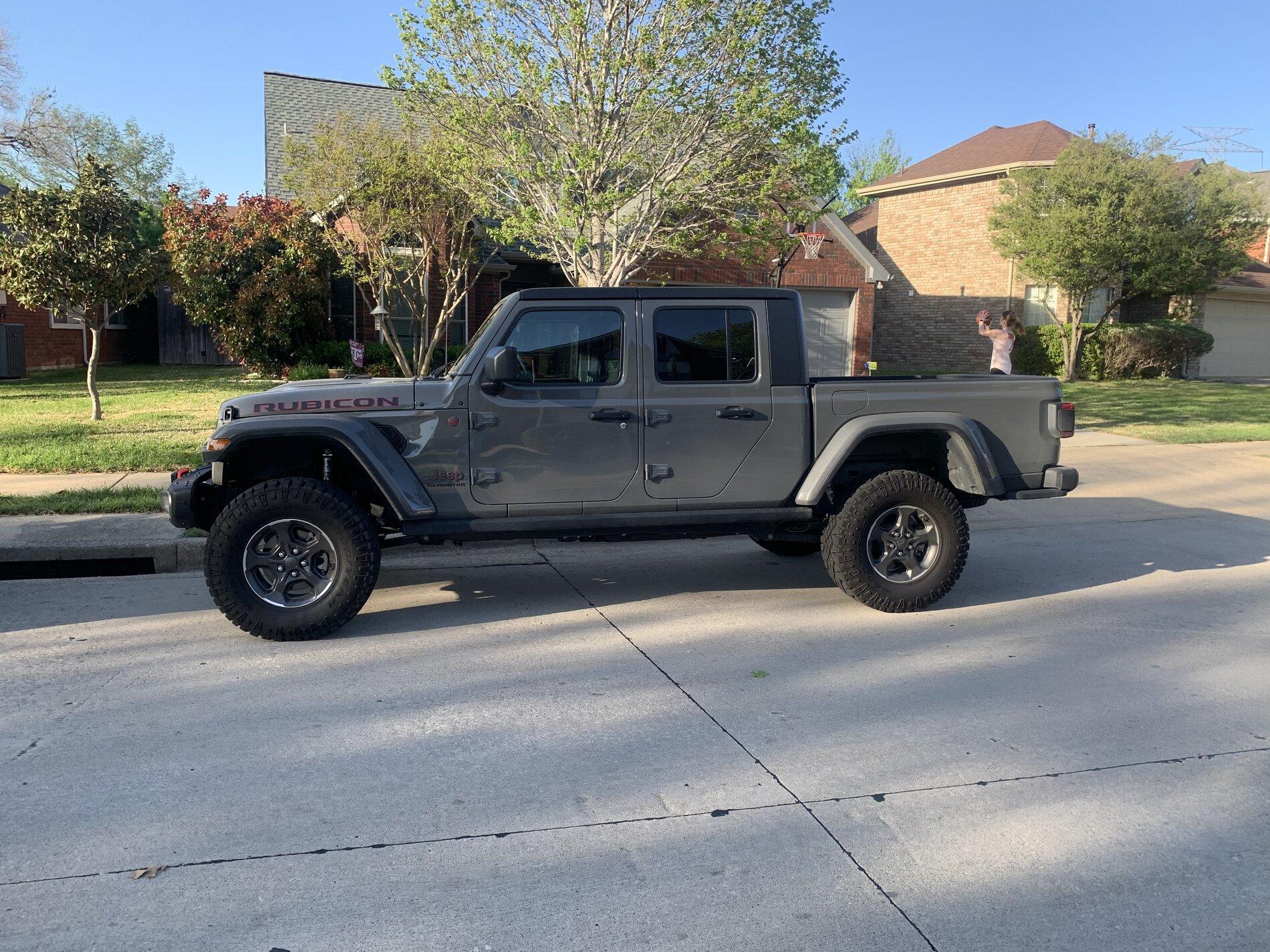

That looks really good!
I did have everything loose. Wish I had a lift to install the lift!
Everything is done and the ride is somehow more firm and compliant at the same time.
I know what you mean. When I installed my Mopar lift, I was literally hanging with all my body weight to get it to the 165 ft. lbs. it wanted in certain areas.
Also, you might want to look into getting a front adjustable track bar. My axle shifted about an inch after the Mopar lift install. Put the JKS adjustable trackbar on and it's centered perfectly now.
JKS is probably what I’ll go with if needed.
It looks like the front is higher, but it isn’t. 35” tires, Mopar 2” diesel lift with 1/2” spacer up front. (Makes it close to level but will compensate perfectly for a winch.)
