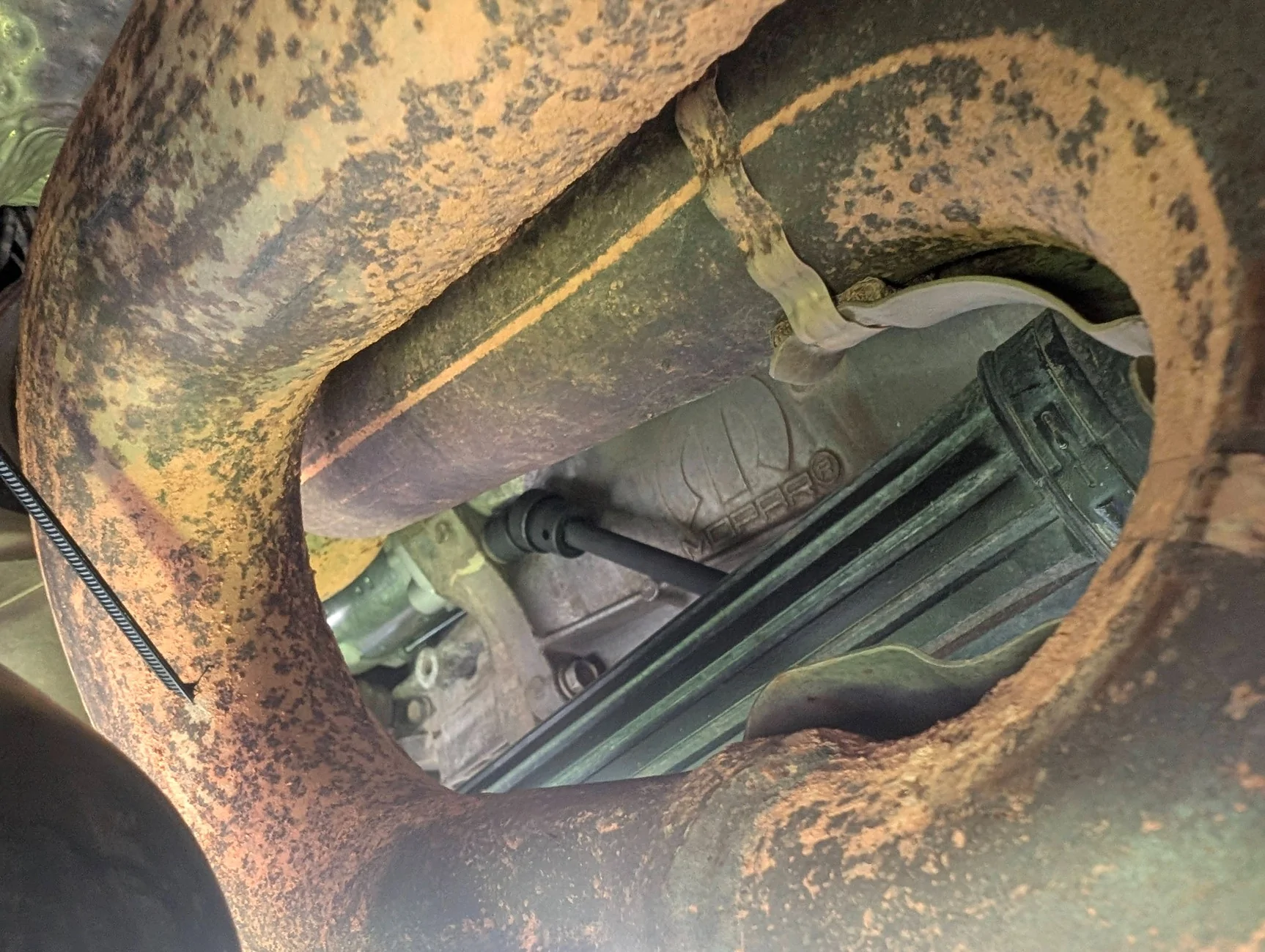

Hi all, I recently had my starter die at 67k miles. After searching YouTube and the forums no one seems to have an easy way to replace it without removing wheel, liner, cat, and/or engine mount. Turns out it is possible but patience is necessary.
My 2022 Mojave (with 6-speed) is stock except for Apex sway bar disconnect, airlift 1000 airbags, and MORE trans skid plate.
Replacement part: https://www.rockauto.com/en/moreinfo.php?pk=12569565&cc=3450754&pt=4152&jsn=2
Tools to make life easier:
Harbor freight 3/8 impact wobble bit 15mm
Harbor freight 3/8 extension
3/8 to 1/2 adaptor
Breaker bar
PB blaster
13mm socket
Thinnest ratchet you can find for the 13mm
cutoff wheel (used a Dremel)
disconnect the battery first.
spray PB blaster on bolt head ( i did this over the course of 2 days)
To remove the 2 starter bolts I used the 15mm wobble onto several extensions that equaled 24in, then onto a 24in breaker bar. A second person to hold the extension and breaker bar is helpful but not necessary.
these are for the lower bolt

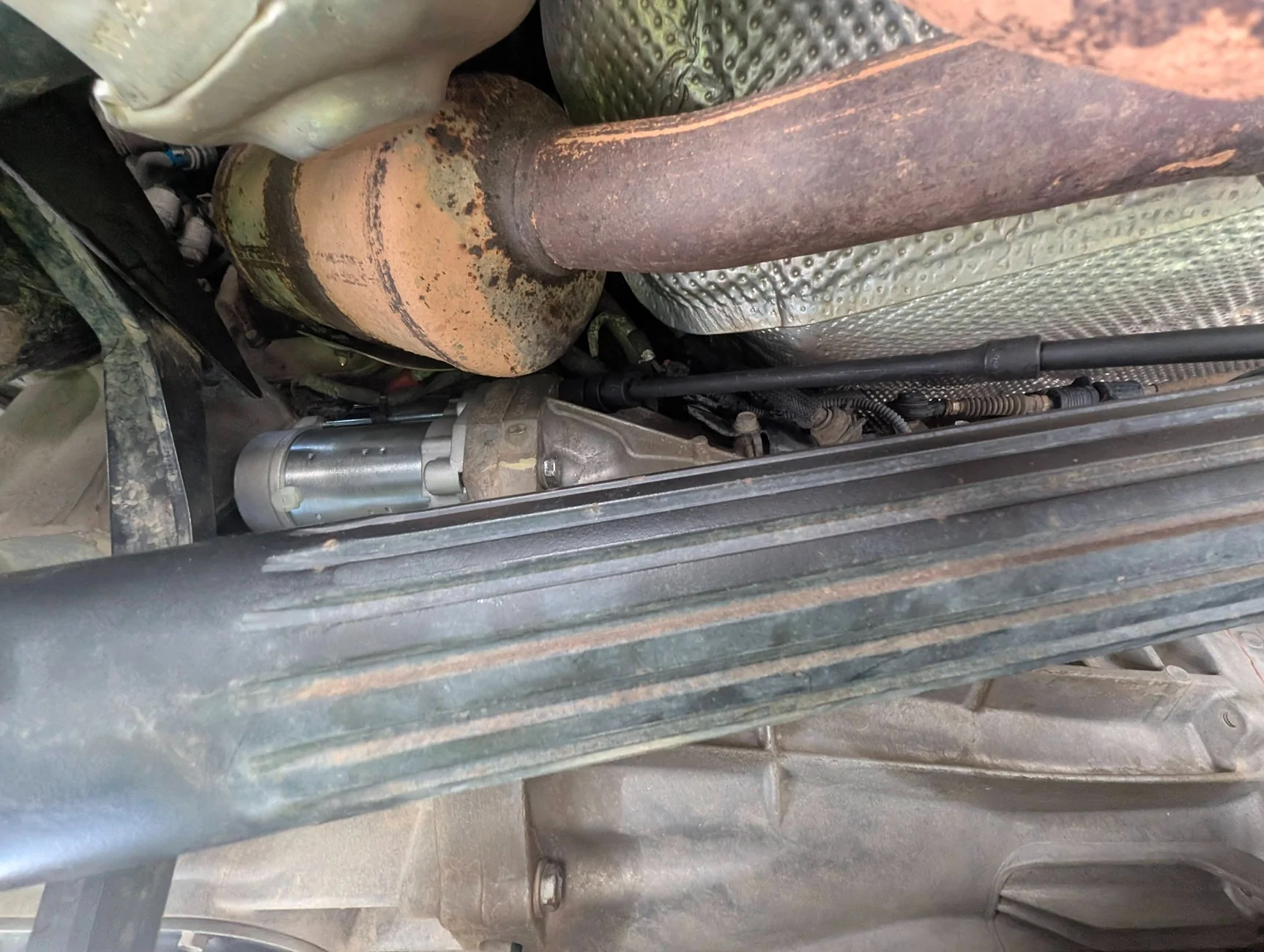

Jeep Gladiator DIY  Starter replacement 2022 Mojave MT lower bolt close u
the skid plate stayed on, if you dont have one itll give you a little bit more room/better angle

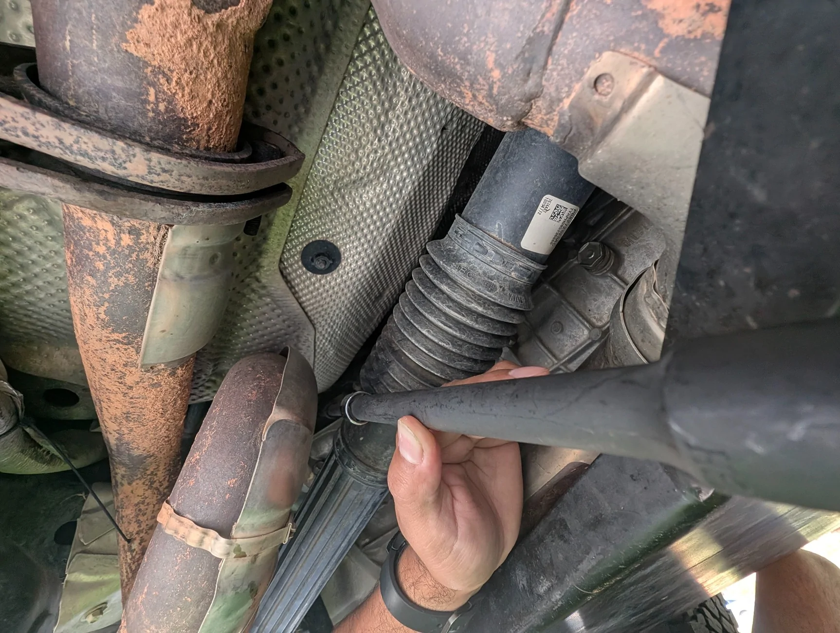

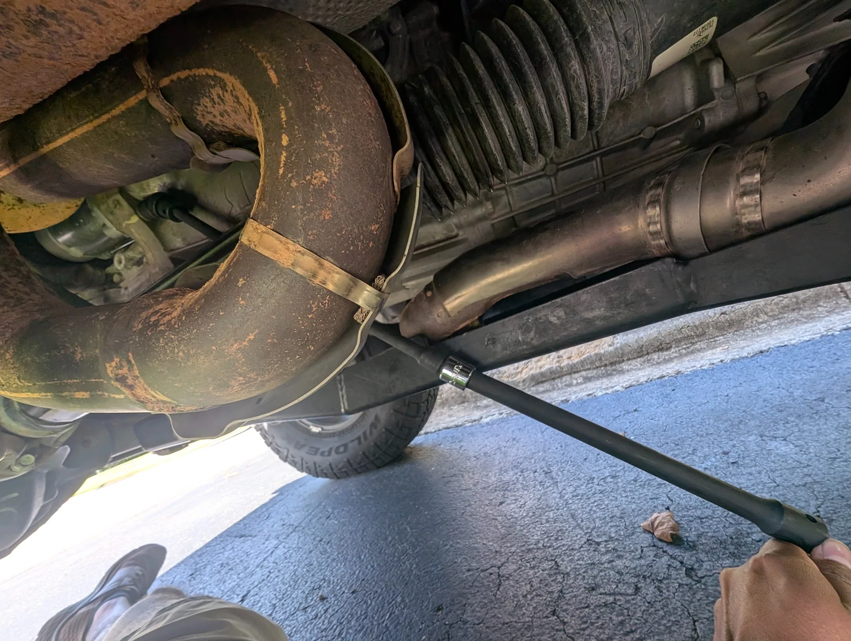

Jeep Gladiator DIY  Starter replacement 2022 Mojave MT lower bolt extension routing
Jeep Gladiator DIY  Starter replacement 2022 Mojave MT lower bolt extension side vi

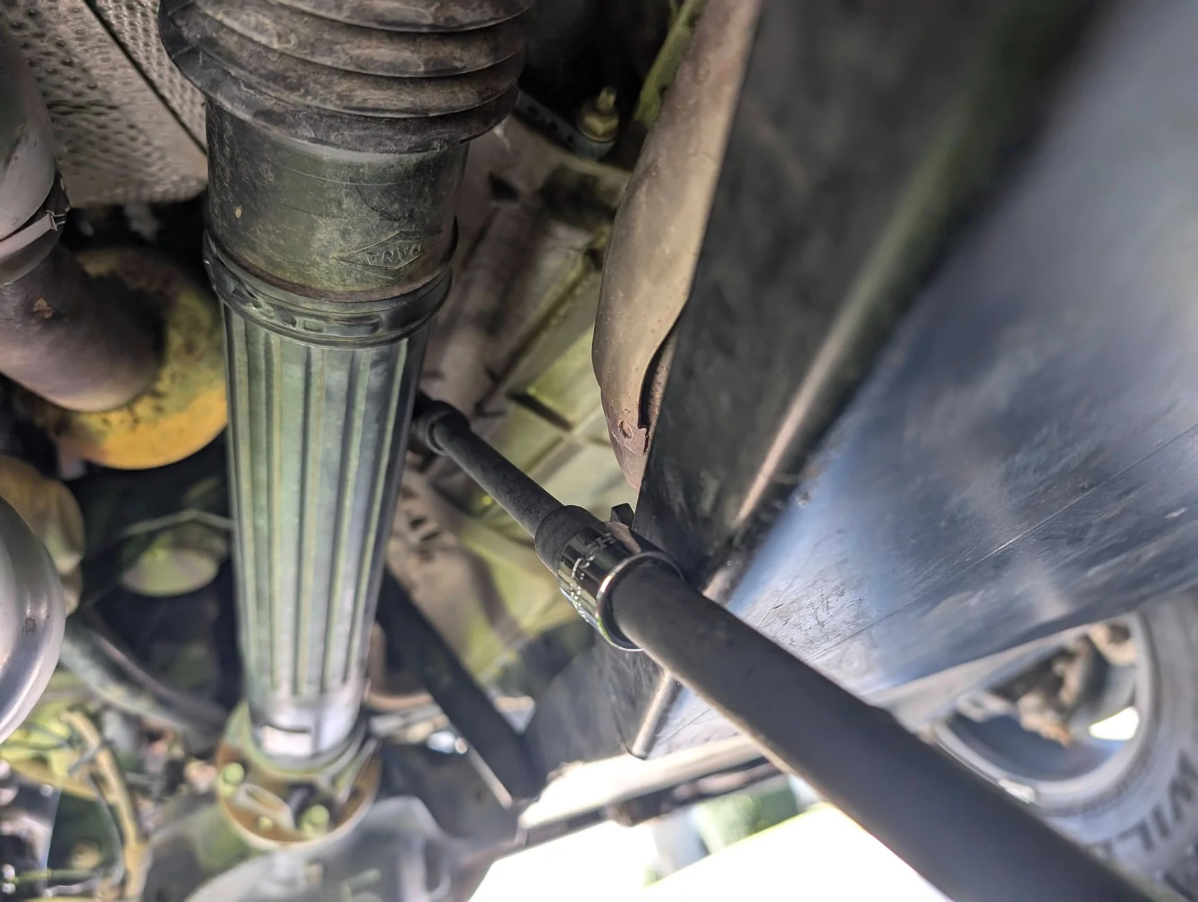

Heres the routing for the upper bolt
Jeep Gladiator DIY  Starter replacement 2022 Mojave MT upper bolt close u
for the upper bolt, the extension routed to the driver side of the driveshaft this time
Jeep Gladiator DIY  Starter replacement 2022 Mojave MT upper bolt extension routing

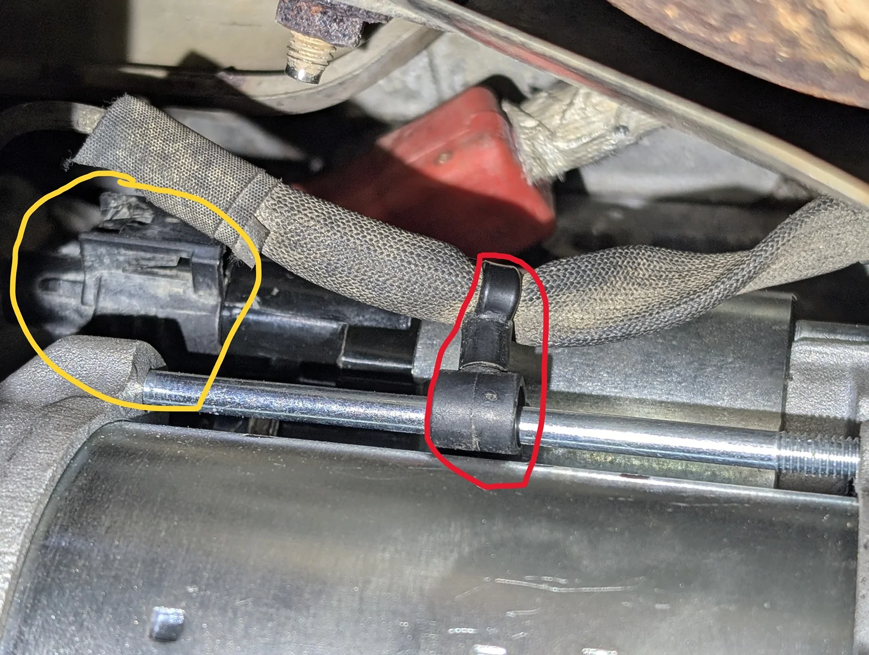

unclip this plastic clip(red). Best to use 2 hands to rotate and push the clip between the bolt and starter body.
now you can undo the connector(yellow)
Jeep Gladiator DIY  Starter replacement 2022 Mojave MT starter clip and connector
for the main wire (Red brick in the pic above but no other for this step) this is where the 13mm and thin ratchet comes in handy. A portion of the engine mount flange(?) makes a larger head ratchet difficult to attach and too long of a socket causes the ratchet handle immovable. We found that tipping the back downward a bit gave enough room to use get the socket and ratchet in there. Theres another plastic clip on the block that holds the cable with the red brick on it that you need to pop out to push the connector and main cable out of the way towards the cat for more room.
Now comes some patience and maneuvering. Here is the way we rotated it to get through.
And its finally out!!
The replacement part that I used from Rockauto has a longer stud so i had to remove about half of its length with a cutoff wheel because in the video above, you can see how that stud just barely clears the engine mount when sliding out.
