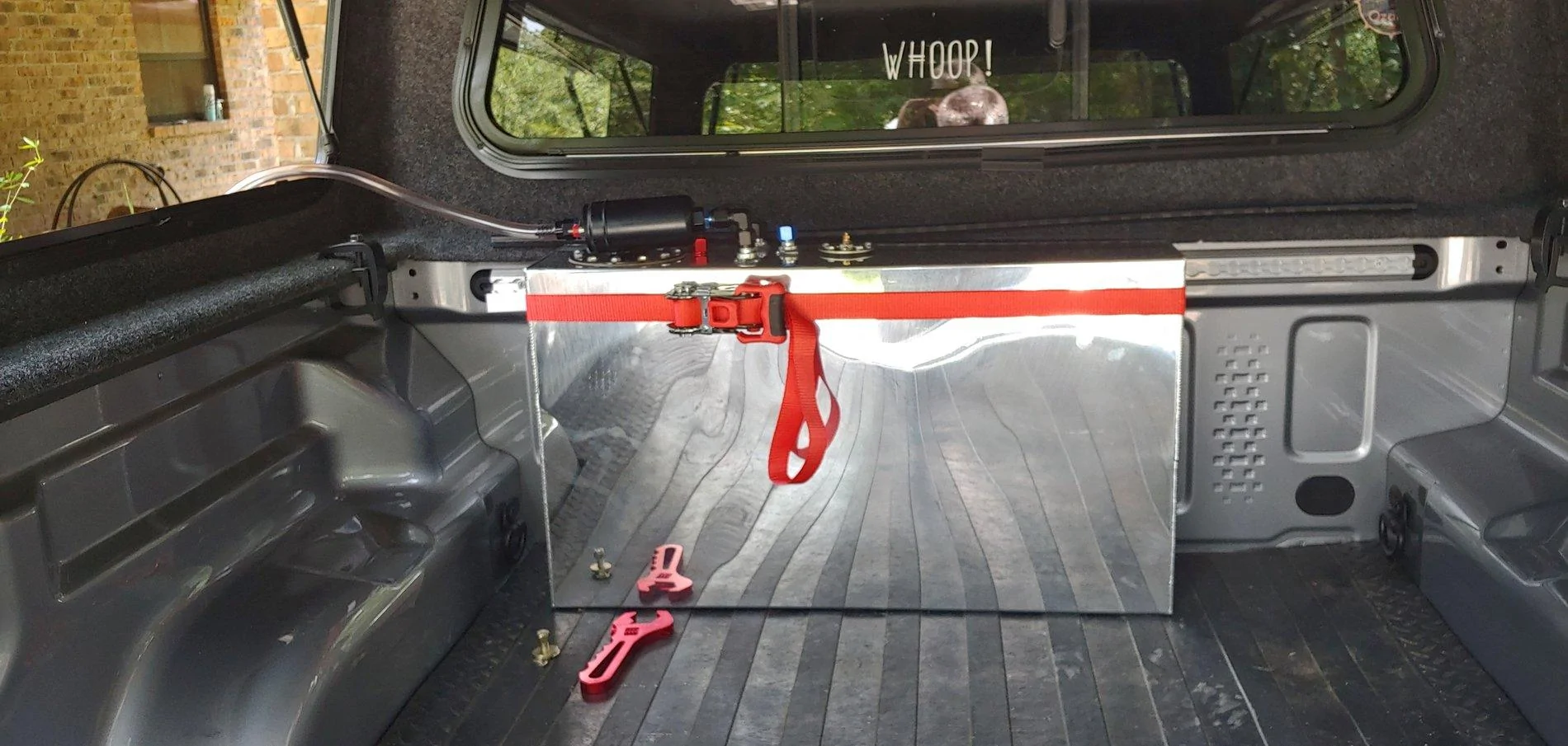

So, not exactly what you're looking for, but. I want some extra fuel for reasons that are my own. I DON'T want Jerry cans, gas cans, rotopax, etc. And I want to be able to remove it quickly.
So I bought a 17 gallon fuel cell, and will be using the L Track in the bed to secure it, an electric fuel pump to transfer, and vented through a home brewed charcoal vapor canister. It's all very light and reasonably inexpensive. The pick up and return ports will be capped except when transferring fuel, and the vent has a roll over valve in it.
The ratchet strap in the picture works great, but I'm going to build a steel retainer and exoskeleton for it. Work in progress

What your system is probably the best available and most cost effective.. :like: plus it's only there when you need to haul it and no mods to fuel system that could develop leaks / problems.
It should not be hard to locate one, then install securely in bed. Transfer tanks are fairly common in a lot of places here in USA and probably in Canada too.

I've got about $225 in the tank,pump,fittings like it sits there.
The L Track was going in anyway, and I do still need to run wire and finish the vapor canister, but I'll end up with maybe $300 in it.
ETA: that tank,pump and fittings all came off of ebay

Are you installing the vapor can for fuel venting by heating up, sloshing around, evaporation and ECT. Or going to plumbing in and run off of that tank too?
I might have missed it if you posted it already.

Fuel tanks in the bed of the truck are dangerous. Diesel is not a big problem, but gasoline requires a lot of care due to the explosive vapors.

Expansion/contraction, thermal exchange. I wouldn't even worry about it, but filling at low elevation then going up 6k would likely be an issue and what I don't want is a burst tank with 17 gallons of fuel in the back of the truck
