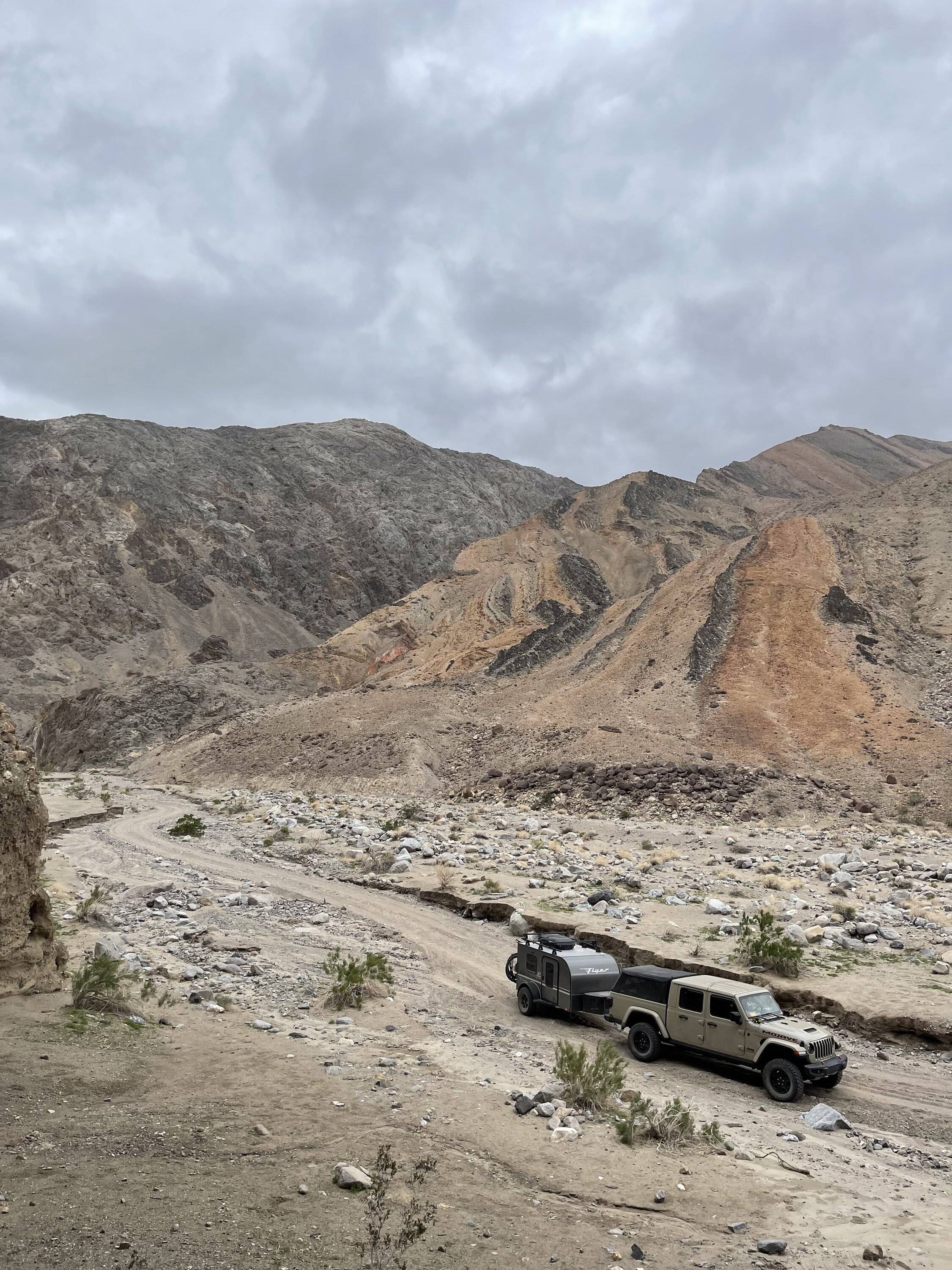

I just hit 15.0 mpg yesterday after months of mid 14's. I am thrilled!
Trying to get back to 14 myself after getting 11.5 towing and slight off-roading with my camper last weekend! Lol 15-16 again would be nice but haven’t seen that in a while. And just ordered 37s ?
Jeep Gladiator downsizing wheels DCA76A5D-F755-4FCB-98F9-F8D2FB253590
