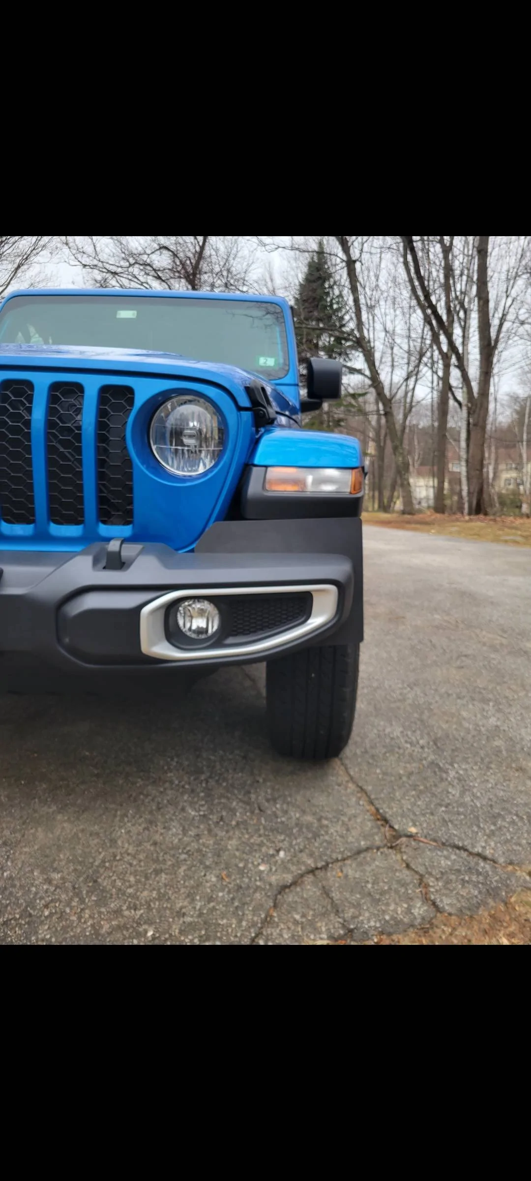

Jeep Gladiator downsizing wheels Screenshot_20230318_063352_Gallery
