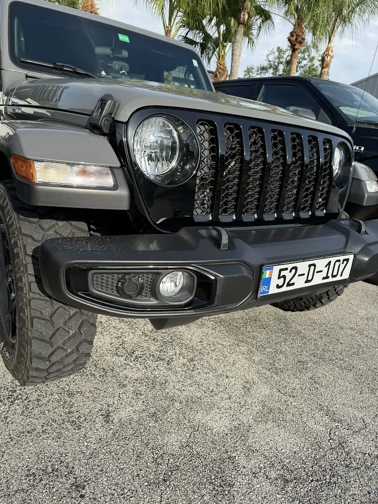

Jeep Gladiator Drilling Out the ‘Trail Rated’ Badge for External 120V Inlet? 1785760410896-zu

I’m doing something similar but using a 4xe cowl panel instead. Already has the access port so just have to get whatever I want to run through it. No way am I giving up my badge.
I ihave the same plan, using the 4XE cowl part and panel to host 120v and 12v plug sockets for trickle charging and the block heater.
