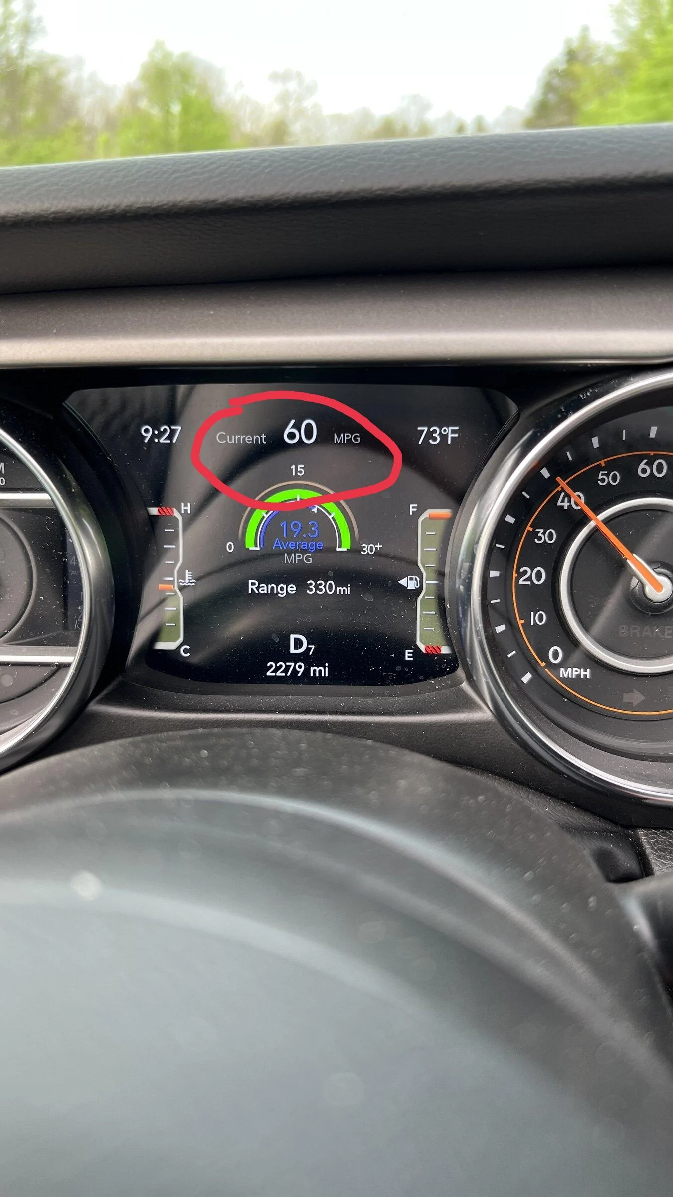

It looks like it's because you have current mpg set up as one of your "always on" displays in the center. If you change that to show speed or something else, it should show.
This part, up here:
Jeep Gladiator Driver information center menus are inconsistent IMG_20220425_152741
It won't show the same thing twice on the display. Instant mpg won't show below if it's at the top. Get rid of that, and it should come back. It's not the tazer, you just can't have instant mpg showing twice.
This part, up here:
This is not correct. You can show the same thing multiple times in the display. you can't show the same thing in the left and right. But you can show top/center/right the same data that is elsewhere.

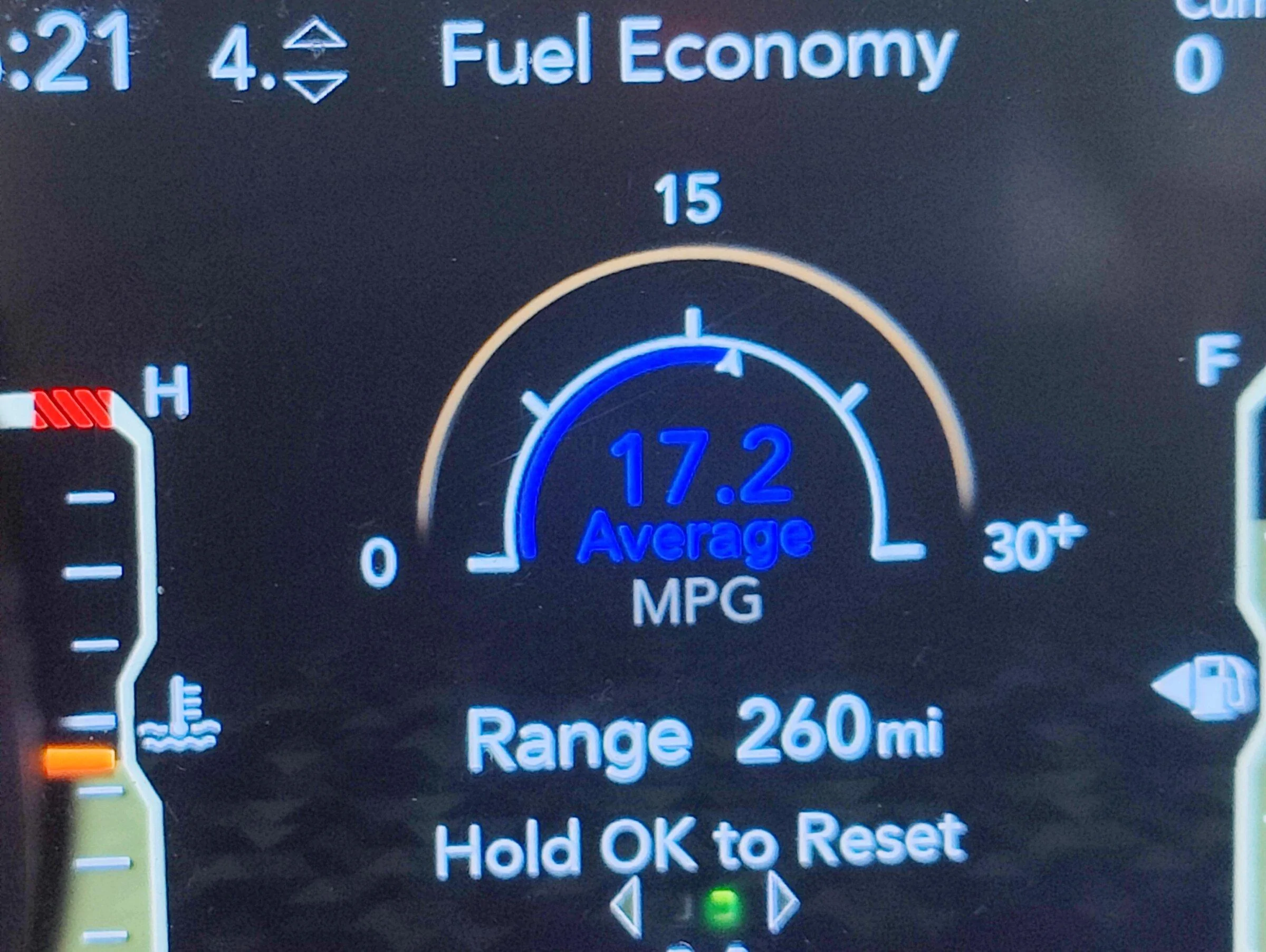

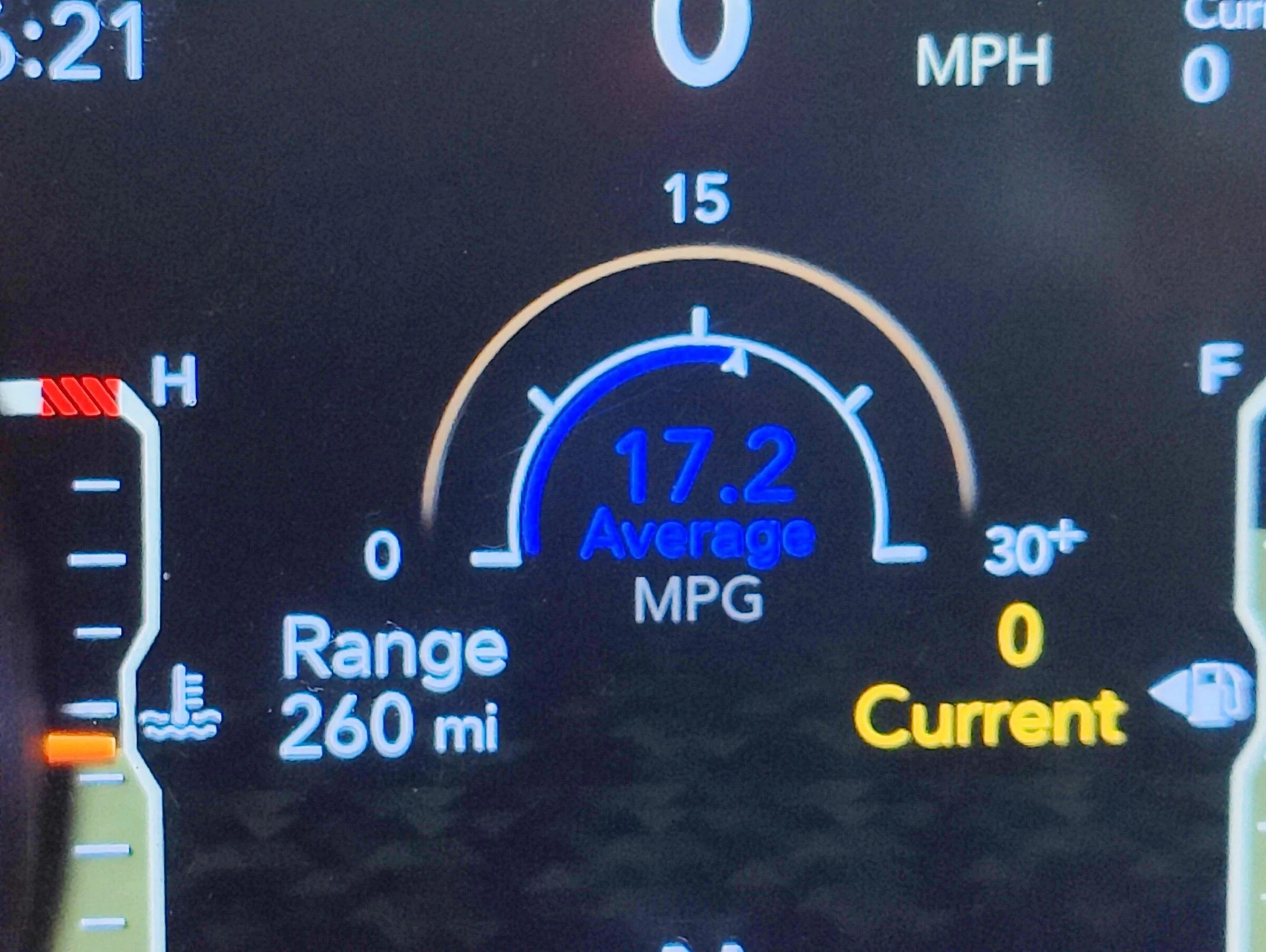

Ok. So when you go to that screen, keep hitting right or left. There are 2 screens there, each slightly different.
Keep hitting right over and over and see if it shows up. Here's what I have:
1)
Jeep Gladiator Driver information center menus are inconsistent IMG20220425182128
2)
Jeep Gladiator Driver information center menus are inconsistent IMG20220425182132
What do you get when you scroll right?
1)
2)
At this moment, I have the Econ gauge on one page without range and without current Econ and the only other page ever appears is the Econ gauge with the range.
I used to have a page with econ gauge without range and without current econ and another page that had econ gauge, range, and current econ.
No change with repetitive right or left button mashing
