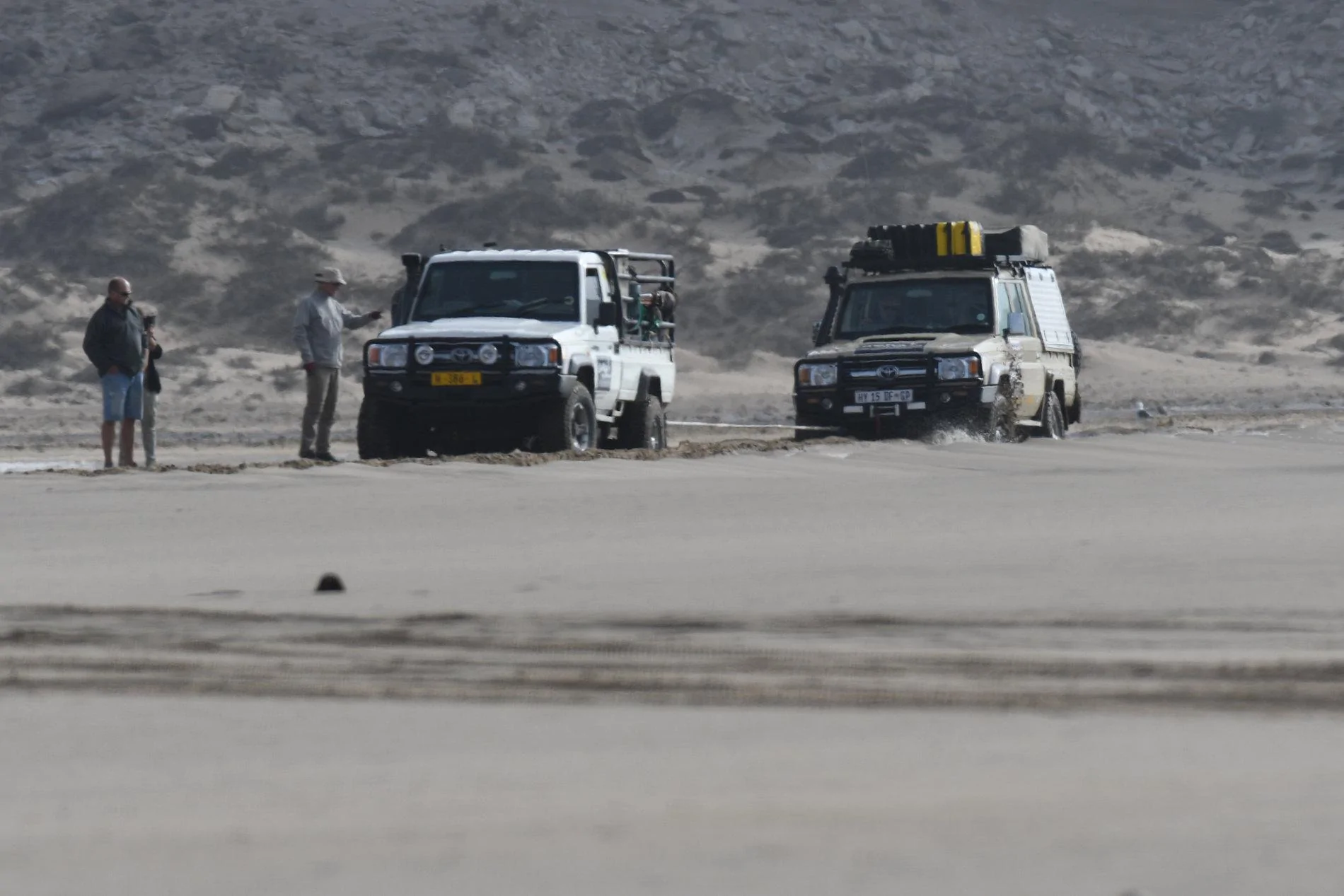

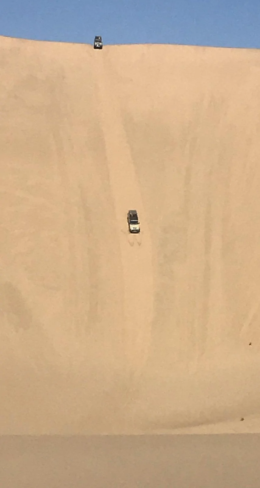

What is your advice for a manual transmission on the beach?
i’ve also had the amazing opportunity to transverse the oldest and most remote desert in the world, The Namib which took us over a week to cross.
In that expedition we had 5 Toyota 79 series with manual transmissions and the only difference I made was to be sure that I kept the revs in the middle to upper end of the torque band so that I didn’t stall it and had the most power possible.
We all got stuck at various points in the trip but I learned more about driving in sand on that trip than the previous 30 years...
