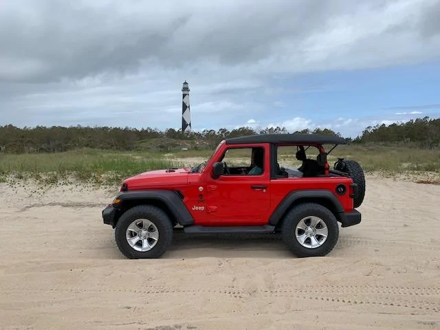

We take the ferry from Davis over to the banks often. Our JL has 285 (11.5") tires and we do not air down. The JL has handled every situation with ease! Slow and steady in 4Hi. The JL even pulled a Suburban with a camper out. We have not taken the Mojave over yet. Mojave is In the process of getting 12.5" tires and will probably hit Atlantic Beach first to do some surf fishing. I would think the Mojave would handle the beach sand just as well.

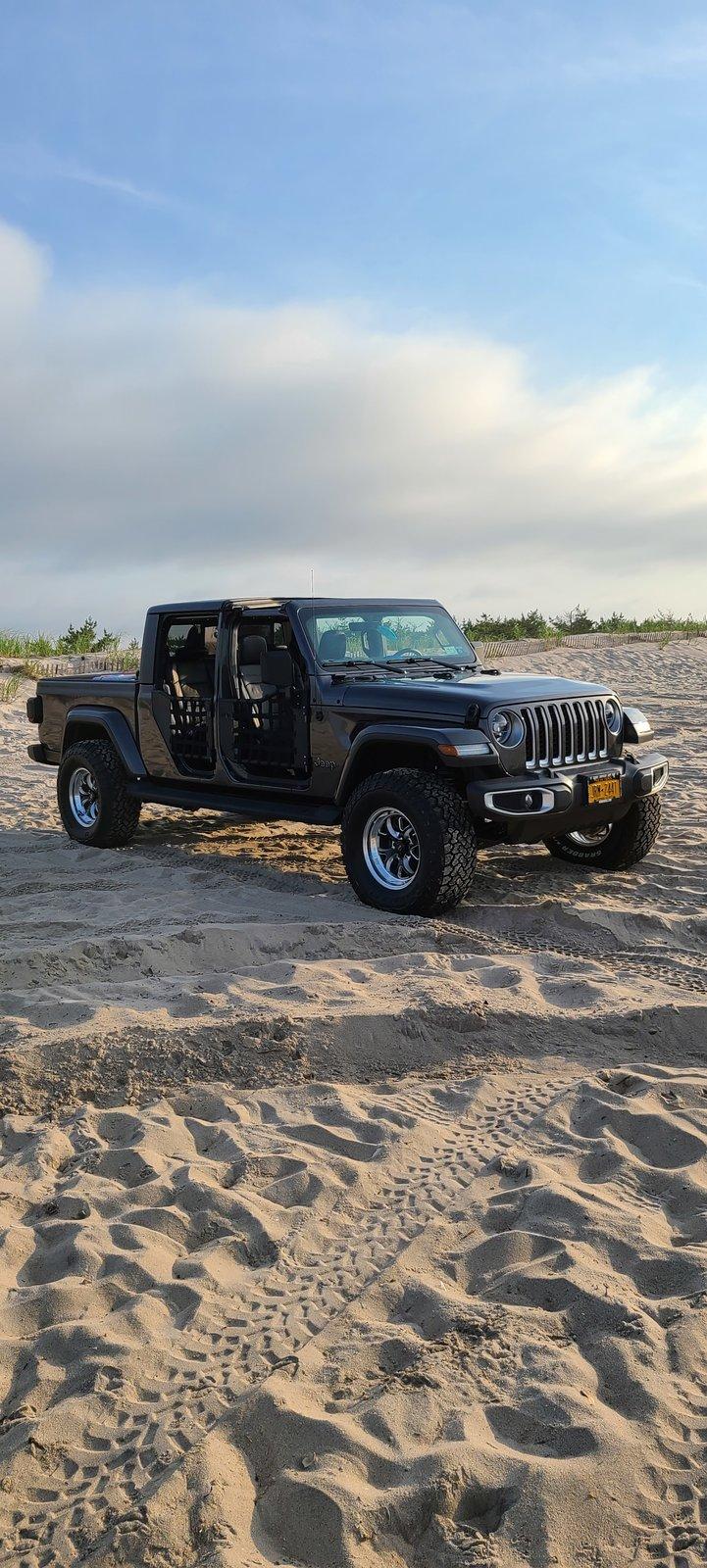

I air down to 20-25 or so, 4 wheel hi and disable traction control. Oh and make sure you have a really good shop vac at home, seems we usually bring a good amount of beach home with us:)
