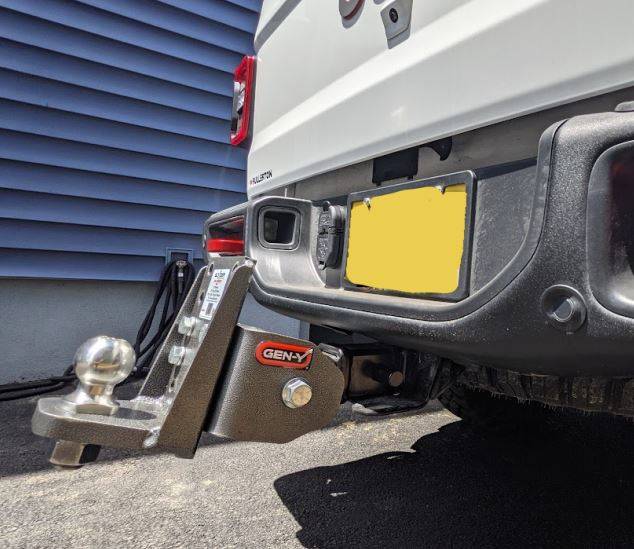

I have the Weigh Safe drop hitch and highly recommend it. I've never towed with the JT but I have countless times with the Weigh Safe on other vehicles. Fit, finish and quality are second to none with the Weigh Safe, not cheap though.
I have the b and h stow and go, I think in an 8 inch version. I can’t recommend it more. And they certify it for use upside down for rises as well. I use it for both. It’s great. My version has the 2” and 2 5/16” balls.

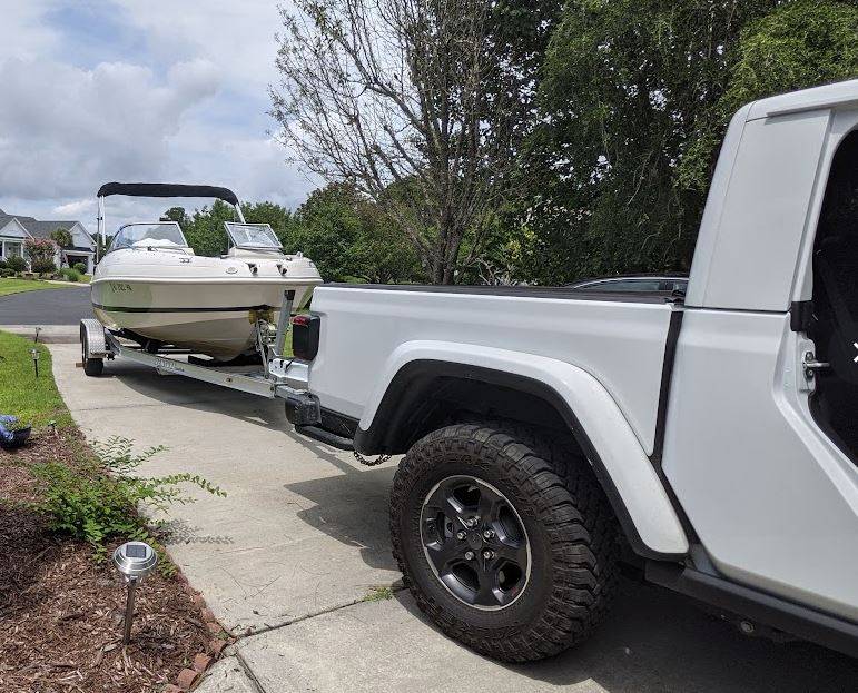

A cautionary tale.
The farther the hitch ball is from the rear axle
the greater the leverage the trailer has on steering.
A Gladiator already has a long tail end.
An adjustable drop hitch extends it another 2 to 3 inches farther out.
I could be wrong, I often am,
but death wobble takes on a whole new meaning
when a heavy trailer begins to sway
and push your tail end around.
Something I never want to happen again.
No longer than some trucks I've had.......
And trailer sway is 100% different. You can apply the trailer brakes and come out of trailer sway (DO NOT apply the truck's brakes!!)
Better, if you tow and load to prevent sway, it's not going to sway. Sway comes from mistakes and not properly spreading the weight in a trailer. A properly loaded trailer won't sway.
Sway is when the trailer is going faster than the tow vehicle (can be proven by looking at the path the trailer tires take vs. what the tow vehicle tires take)
So if you apply the trailer brakes only, you slow the trailer and drag it back into line.
Some WDH move the ball back a ways, too.
I agree, I try to keep the ball itself as close to the tow vehicle as possible, but if you tow properly, it's only an issue in an emergency - and knowing what to do by pushing that trailer brakes only button - you can pull out of it easily. (if you use the Curt Echo, PLEASE buy their optional button! don't wait until you really wish you had it)
