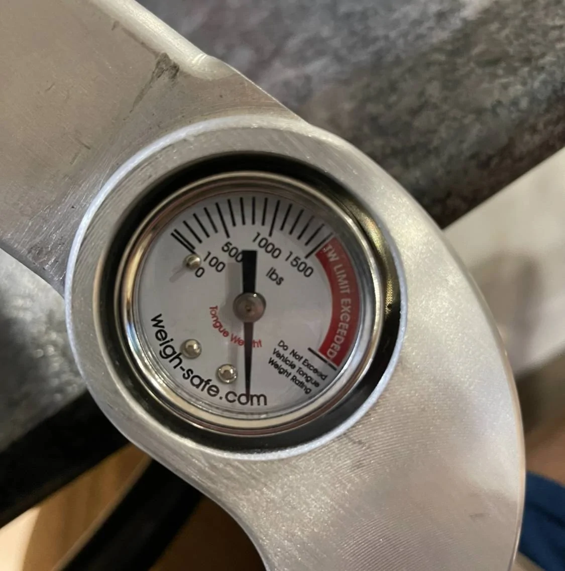

I'm running the aluminum weigh safe with a 6 inch drop for 38s, a 2.5 Clayton lift, and a relatively low Aliner expedition in the 25-2600lb range. I really liked the weigh safe since I could adjust the cargo to get it to a good tongue weight based on tanks, coolers, food and other stuff that varied based on the trip.

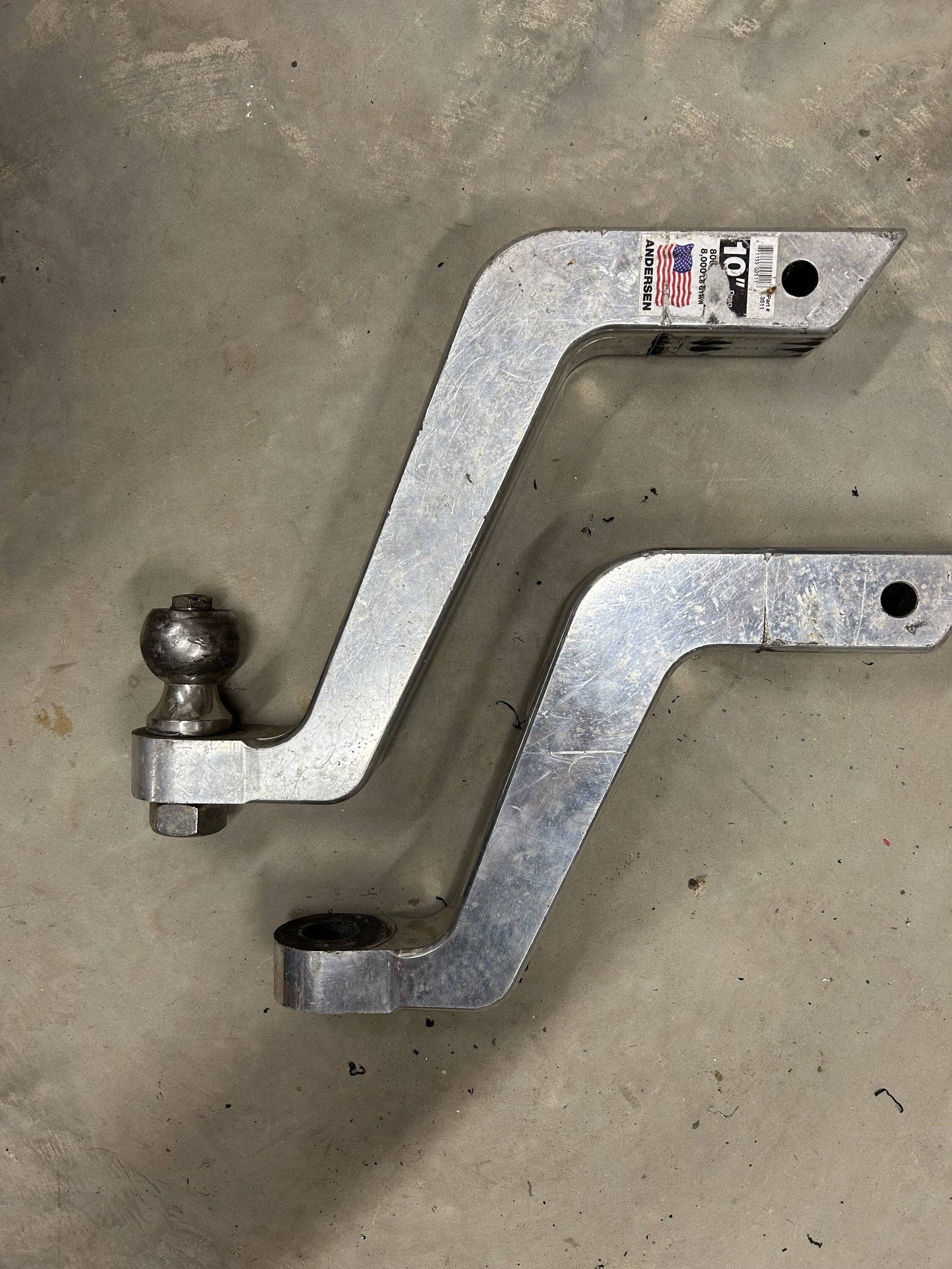

I am sending David the 8” drop hitch, anyone need a 10” drop hitch, Andersen 8000lb rated 800 lb. Tongue weight, with me free is free, will arrive your doorstep. Figure some of you nutcases with huge lifts and tires might have cause for it, 10” is a lot, so really measure and see if it is something you need versus something you just want!…Jack
You’re a good Jeep neighbor, Jack. The joke is that I use my b and h 8” adjustable upside down as a rise because my trailer tongue is so high. It’s higher than the normal receiver by 2” or so, and that’s with about a 5” lift in the back of my JT. it’s sort of funny. I only flip it over with other more traditional trailers.

I have the Weigh Safe drop hitch and highly recommend it. I've never towed with the JT but I have countless times with the Weigh Safe on other vehicles. Fit, finish and quality are second to none with the Weigh Safe, not cheap though.
I did not have the same luck in 2022… I exchanged 3 through their warranty before returning.
If they have changed to a liquid gauge I would humor again.

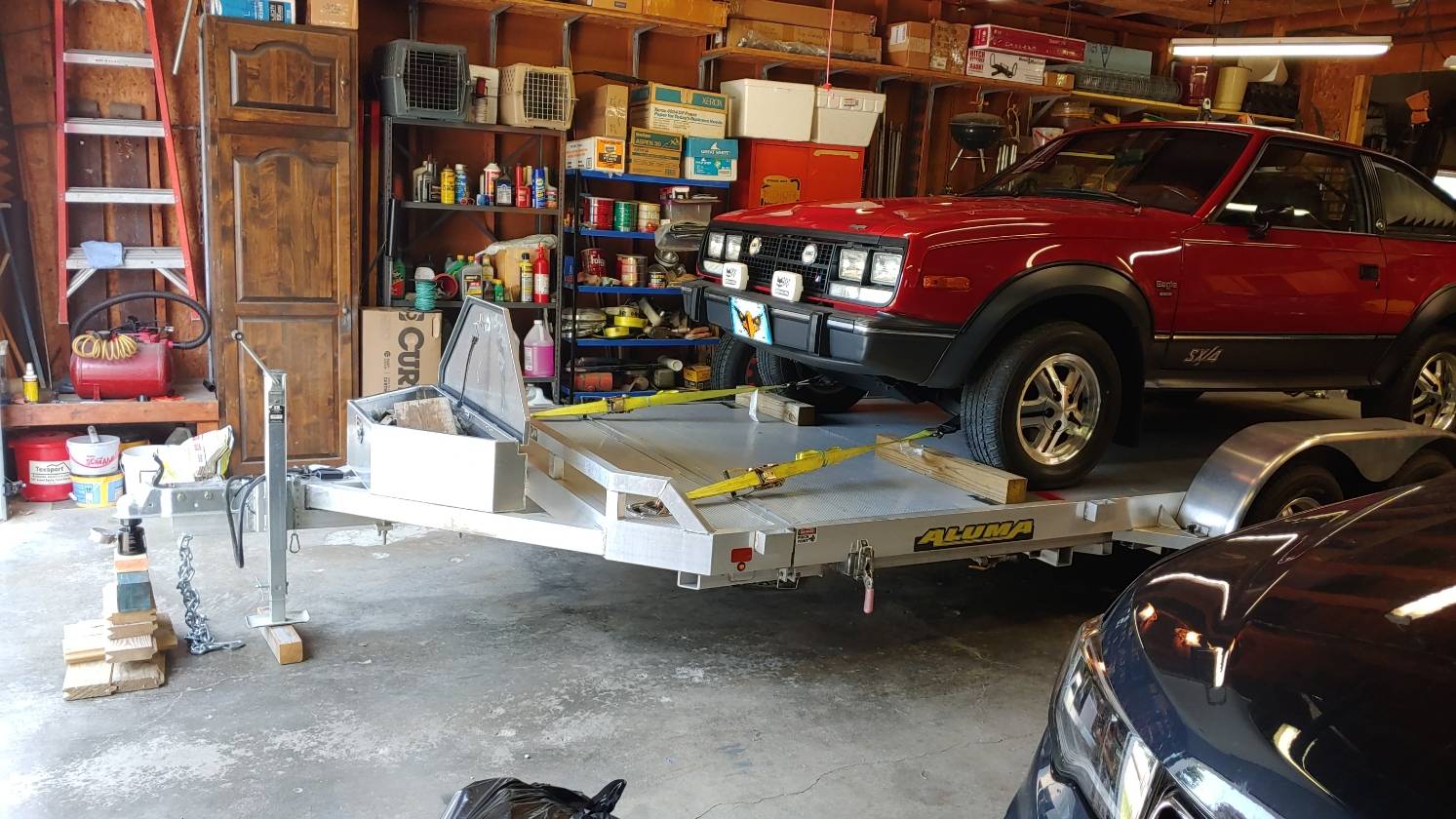

I did an experiment years ago with one of those platforms that goes into a receiver.
With a bit less weight in concrete block than what my trailer tongue would be loaded on that platform, it really dropped the back of that JT. The same weight of trailer tongue on the ball dropped it of course but not as much. it's a simple matter of leverage.
Like some dude said thousands of years ago, give me a lever long enough and I can lift the Earth.
The farther out that ball is from the rear axle, the more leverage it has to lift the front of the truck as well - the truck then being the lever (with the ball mount being part of that lever)
The weight of my snow plow is 300 pounds - not a big deal, really, but when it sits out there 2 to 3 feet ahead of the front bumper, it is weight at the end of a longer lever and actually lifts the rear of my JT - so I put ballast in the back.
If that same 300 pounds was right on the bumper, about all it would do is drop the front of the truck - not enough leverage to raise the back..
I do the same thing he does - 500 pounds ( I seem to remember I ended up at about 520 in the end) And having a dual-axle trailer LEVEL matters, too - otherwise the tongue weight will be inaccurate.
If the front is high, you increase tongue weight because you are riding more on the rear axle. So you have to weigh with the trailer as level as possible - and then tow with it as level.
So me being me - I took my long 8' level and put on the trailer! Accuracy..........not sure if it shows in these pics or not. But you can't weight it at one angle then hitch it up either higher or lower than how you used this type of scale.
