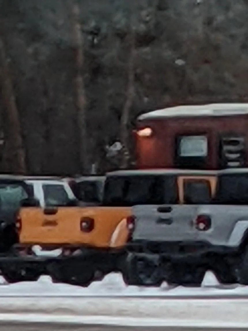

Well now I'm at a decision point. We discussed maybe we wait on the camper. And I just go JL instead of JT hmmmmm but this leads to into another thread I think hahaha. But man that nacho color out on the build site looks so good
Here's that nacho Gladiator.
Jeep Gladiator Eco diesel or max tow PXL_20210127_215556652

BTW... Re: the Nacho color... I have a 2012 Dozer JK,... basically the same color... my wife thinks its awesome. Black accents on it really make it pop. And its real easy to find in a parking lot... as opposed to my new Sting-Gray JT which is also cool looking but is parking-lot camouflage.

Also, I love the orange color so nice job on that. I wish the names weren't so... bleh lol. Omaha orange like they had on the Renegade would be nice.
