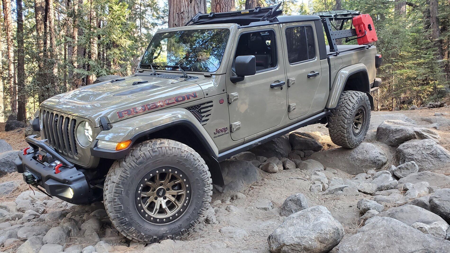

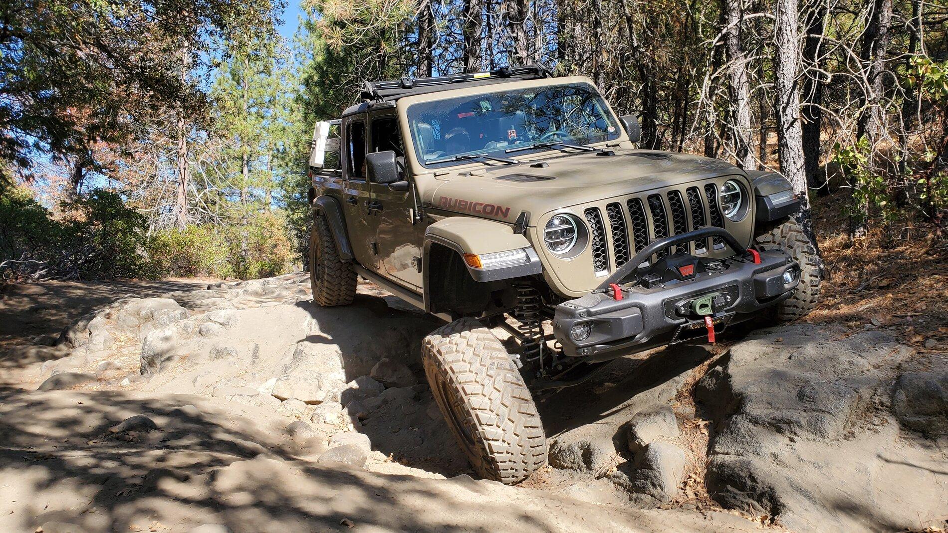

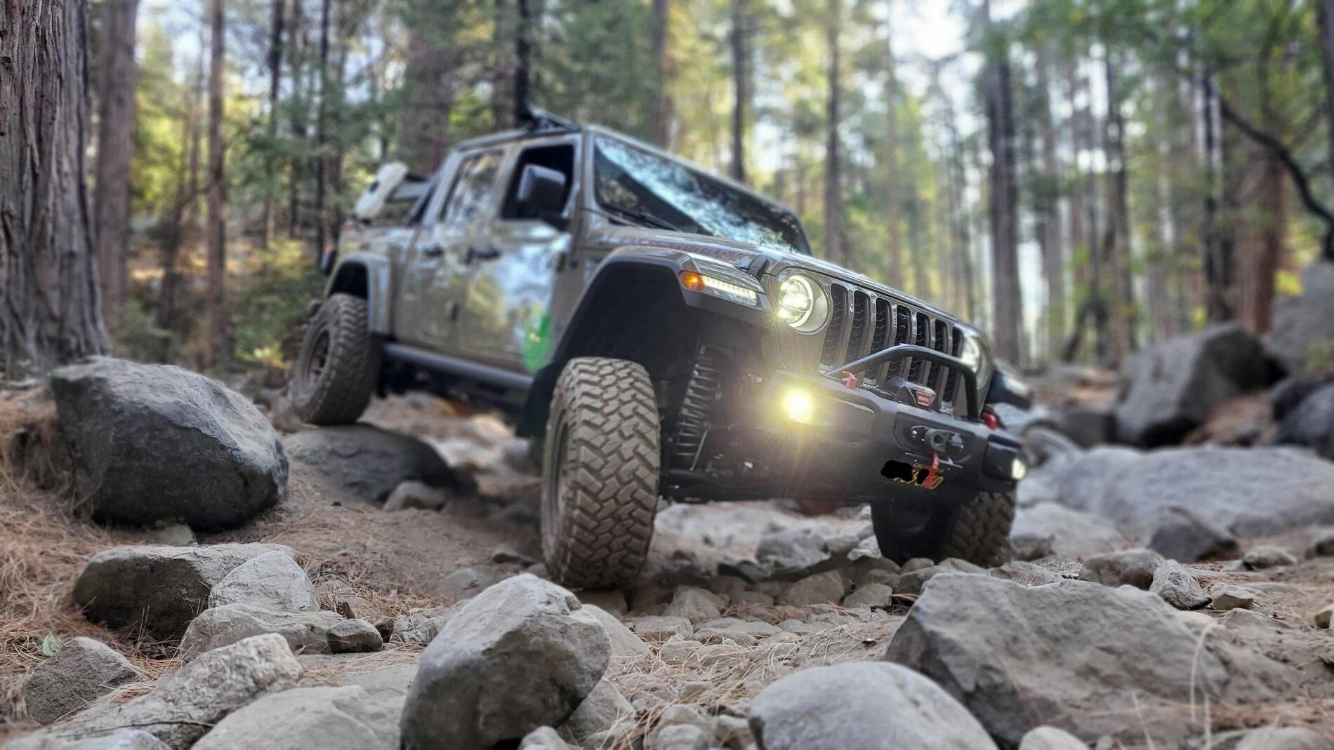

I built my JT for rock crawling, Go ahead laugh at me.
At least I'm out there having fun with a more versatile vehicle then a Wrangler. (I can haul multiple motorcycles without a trailer.)
Was supposed to have done the Rubicon trail last year but Covid postponed it.
Will be doing the Rubicon trail this year once the snow starts melting.
Cheers.
