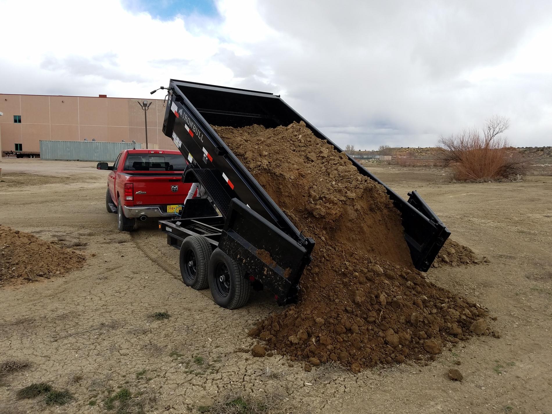

During the work week, I drive 2 miles to work and 2 miles home in my EcoDiesel truck. It's not a big deal unless if that's all you do for weeks on end. We do lots of short commutes and long distance travel, including lots of towing. We've towed our travel trailer though 17 states, from coast to coast, and over some of the tallest mountain passes in Colorado.
Jeep Gladiator Eco diesel or max tow K51kYgy

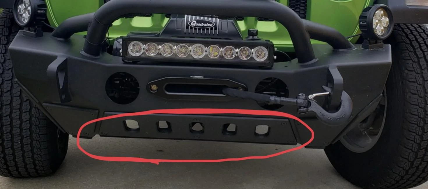

what about relocating the inter cooler to this area below the bumper?
Jeep Gladiator Eco diesel or max tow 9763D297-C39B-42F8-940C-2C7EB805C06F

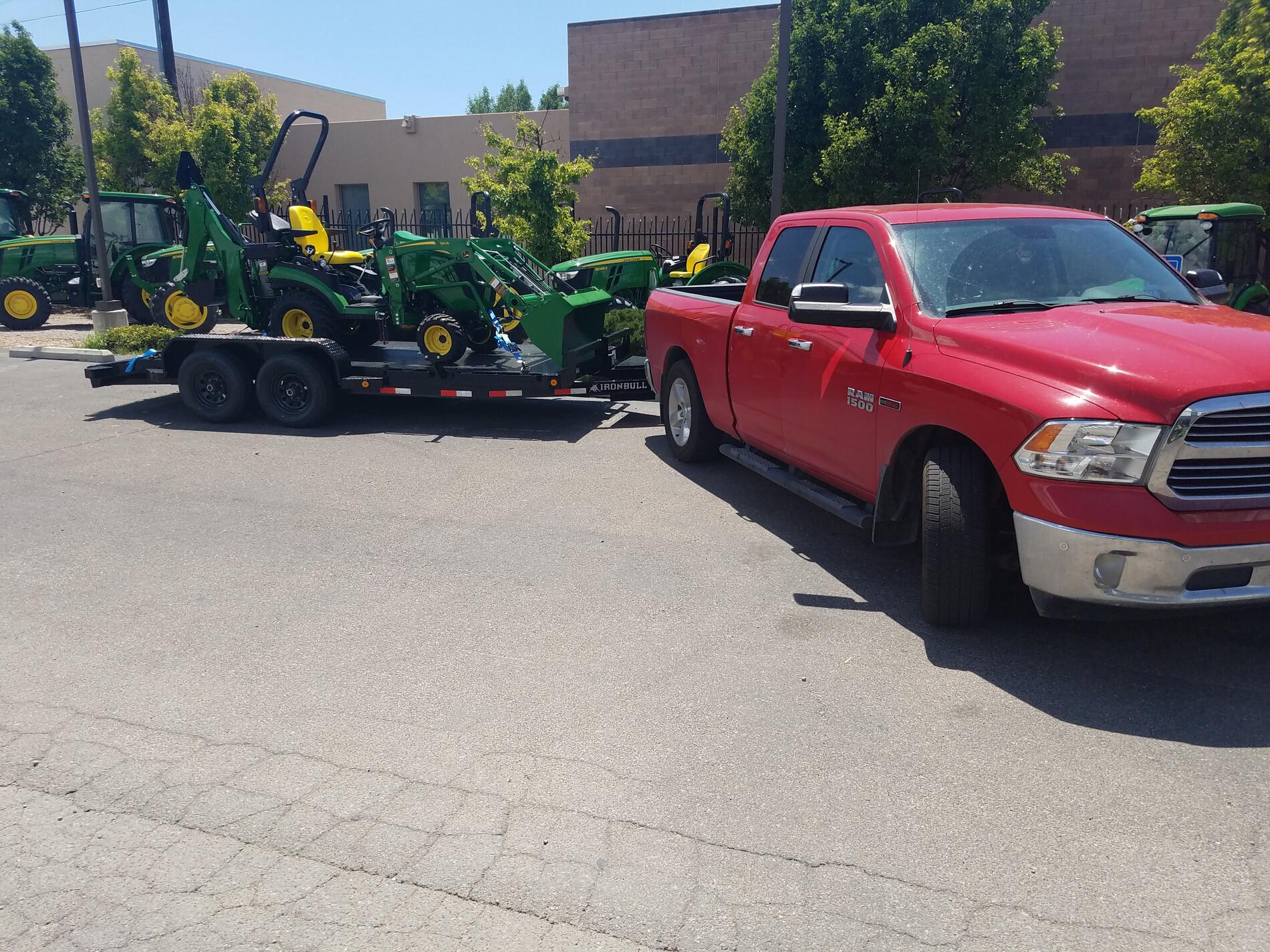

Point being you can be doing everything right and still have a wreck. I try to control as many variables as I can, to be as safe as I can. Some people do that by only towing a load they are comfortable with, which no one can argue. But I would argue to give a blanket statement that “it’s dangerous to tow near capacities” is a stretch
Very true! All three trailers that I posted above have brakes on all 4 wheels. And more importantly, the brakes are adjusted properly. My maximum towing speed on highway is 65 mph. I use a 10,000 lb weigh distribution hitch. There are other precautions that I take (replacing trailer tires every 5 years, adjusting tire pressure for the load, greasing the hubs regularly, inspecting the hubs for play, using trailer tire pressure monitors, etc.)
