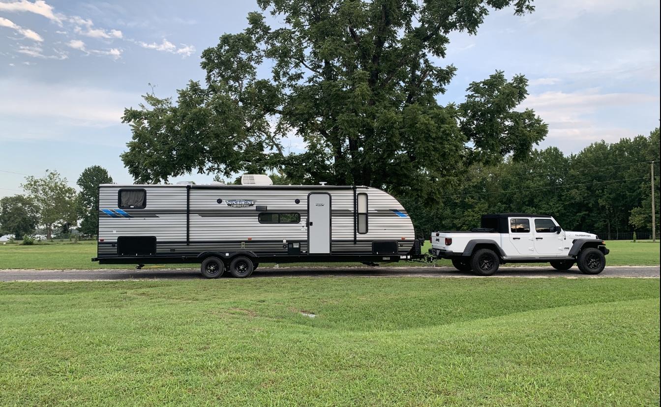

sounds like I saved a ton of money using my max tow to tow my TT that is 6850 loaded. Does it win races? No. Does it suit my needs to pull my big TT 5 times a year? Definitely.
When I was younger I had a wagoneer with a 360 v8 in it. 175 hp and could tow 5000 lbs. My gladiator would run circles around it. Its v6 is peppy, I can spin the tires if I need to. Compared to the wranglers I had in the 90s I can’t believe we are even having the discussion the v6 is under powered.
In 10-15 years we will likely have electric motors with instant torque and will likely talk about how stupid it was to have a huge v8 in a JLU.... it’s all about perception and it changes with time.
I haven’t had a wrangler in 15 years because I could never tow my wakeboard boat. That changed with the gladiator, I’m happy!

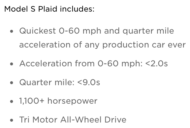

This is for sure! Tesla is coming out with a Model S this year that will have 3 electric motors. According to Tesla, the specs are this:
