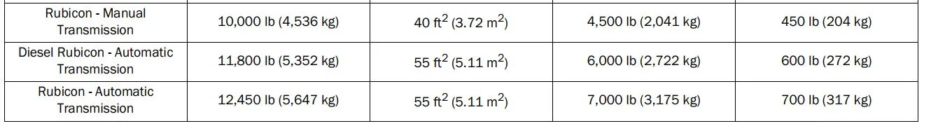

Jeep.com is the last place for reliable info. It shows the tow rating of the rubicon as 4500 pounds not the 6k it really is for instance. That's like asking the service advisor at the dealer mechanical questions.
Don't forget the "when properly equipped". That 4500 is totally accurate - unless you spring for the automatic transmission. So technically a Rubicon is only 4500 pounds.

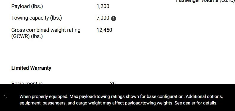

This is from Jeep.com ->

True, but typically the when properly equipped asterisk is listed next to the top payload and towing capacity not the minimum. They're all properly equipped for 4500. With the JT heat is probably the #1 concern in towing capacity, but that's not been the case in most full size trucks. Even in the JT is over hyped, as it passes the long grade in 90⁰+ temps to get that rating. No a base sport isn't going to overheat pulling a 6-7k pound boat home from the marina in 70⁰ weather with no elevation gain even with its 3.73s.
