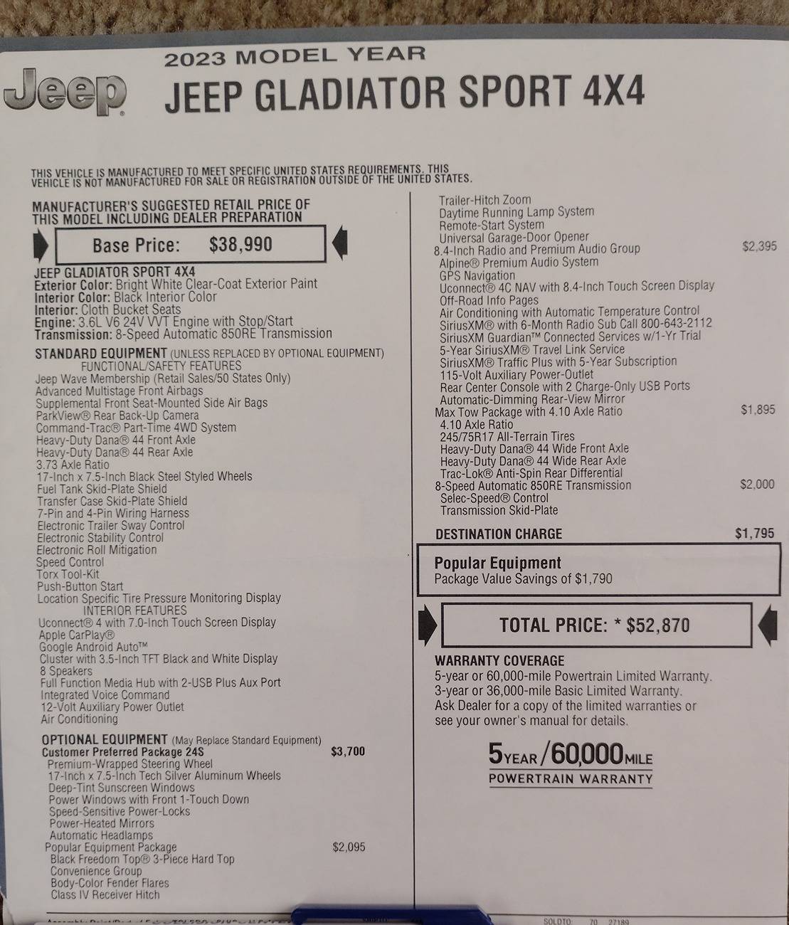

Folks, there's no way around it; the only model that can get Max Tow is the Sport S. All others have considerations (like weight) that lower their effective tow rating. Trying to say "my Rubicon has all the same equipment as the Sport S Max Tow, so it is a Max Tow" is omitting a lot of relevant information that affects the tow rating and is straight-up misleading to this thread.
If they could have given the Rubicon or Mojave the same tow rating as the Sport S Max Tow, they would have. But that's just not the case, no matter how you try to justify it.
Well now we're getting technical but the Sport non-S can also be had with the Max Tow, as does my 2023.

This is fun. I do understand payload for the most part. My window sticker and door decal both said 7k towing capacity. I know my softer springs limit payload but according to all the "stickers" there is a 700 LBS difference. We could also argue, if your towing 7700 lbs why buy a Gladiator LOL. To me and what "the paper" says the difference is marginal. I have had a full load in my truck and the brakes SUCK!!
