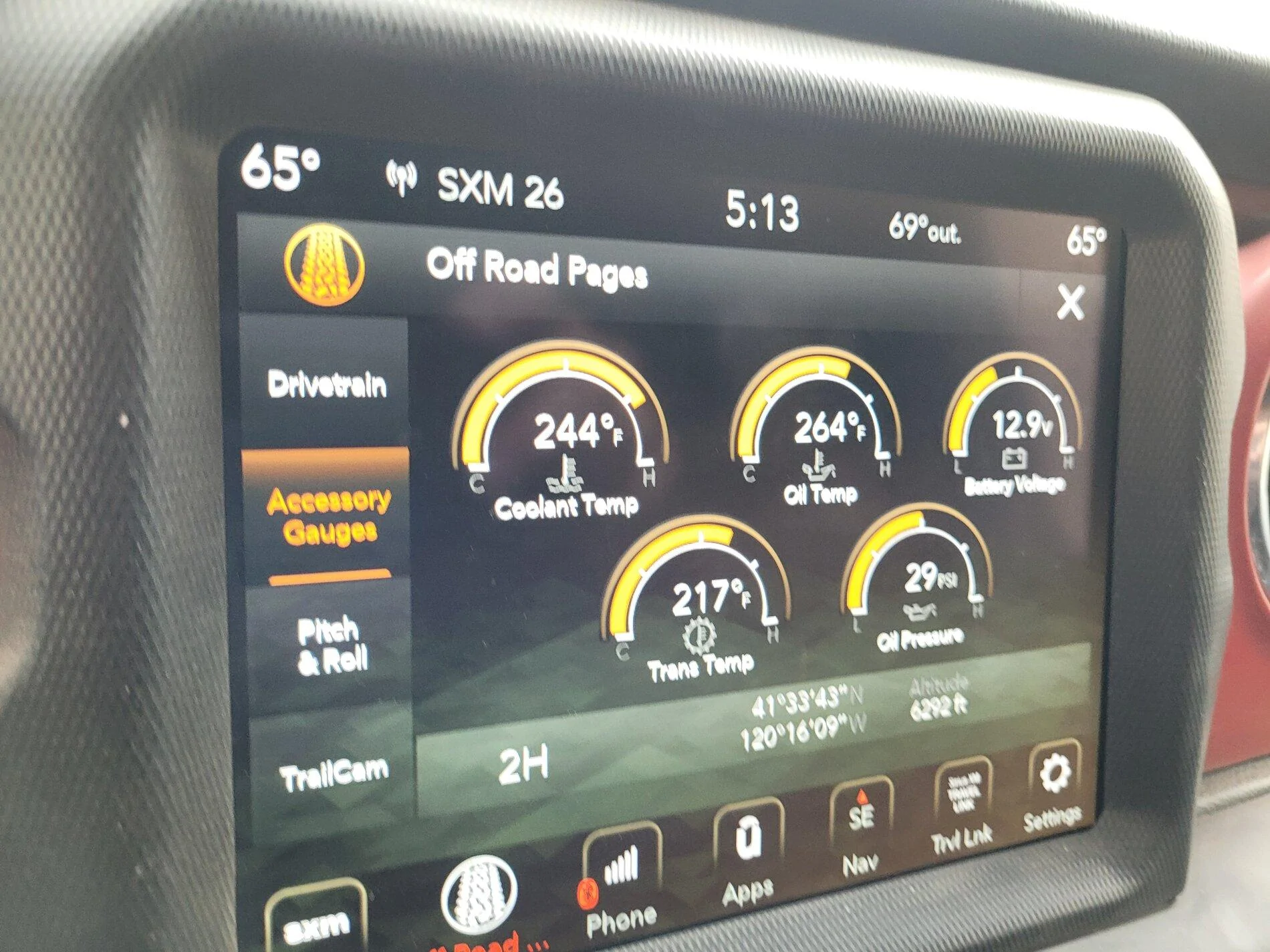

First long trip out today with the rv. Towed my 17' 3500lb rv with with a dirtbike in the bed about 200 miles through the mountains......Amb temp was 101° in the valley, but as low as 68° once in the mountains.
She derated on EVERY substantial hill but the water temp did not go over 246°, so no limp mode 10mph! I pulled over at every opportunity to let the line of traffic that backed up behind me go by. Pretty embarrassing as I've never had a vehicle that went so slow up a hill with such a small load.
Load pid was 50-51%, so obviously I was only getting 50% power despite my foot was to the floor and trucks were trying to run me over......
I was going to buy an off road tear drop trailer but have decided not to until I can get this derating under control. Hopefully Bullet Proof Diesel will come up with a working solution to a frustrating and embarrassing problem for many of us.

On side note I was going up a 4 mile 6% grade last night. Before I hit the summit I could smell hit oil. Coolant temp was 242 and oil temp was 264. Outside temps 82 with 60+ humidity. Started the climb at 65mph and at summit was down to just above 50mph.

Can't tell you about a trip from PHX to Flag but I can tell you that from Mesa to Payson my oil temps.run 260s and coolant runs 240s in the 4 mile stretch from Sunflower to Mt Ord. Power loss is very evident. I could only imagine what it would do going north from Black Canyon City to Sunset Point or from Camp Verde going south up that long steep hill. I can tell you my issues started around 7k miles and have gotten worse. MPG is now 15 when it was 25 not towing anything either.
