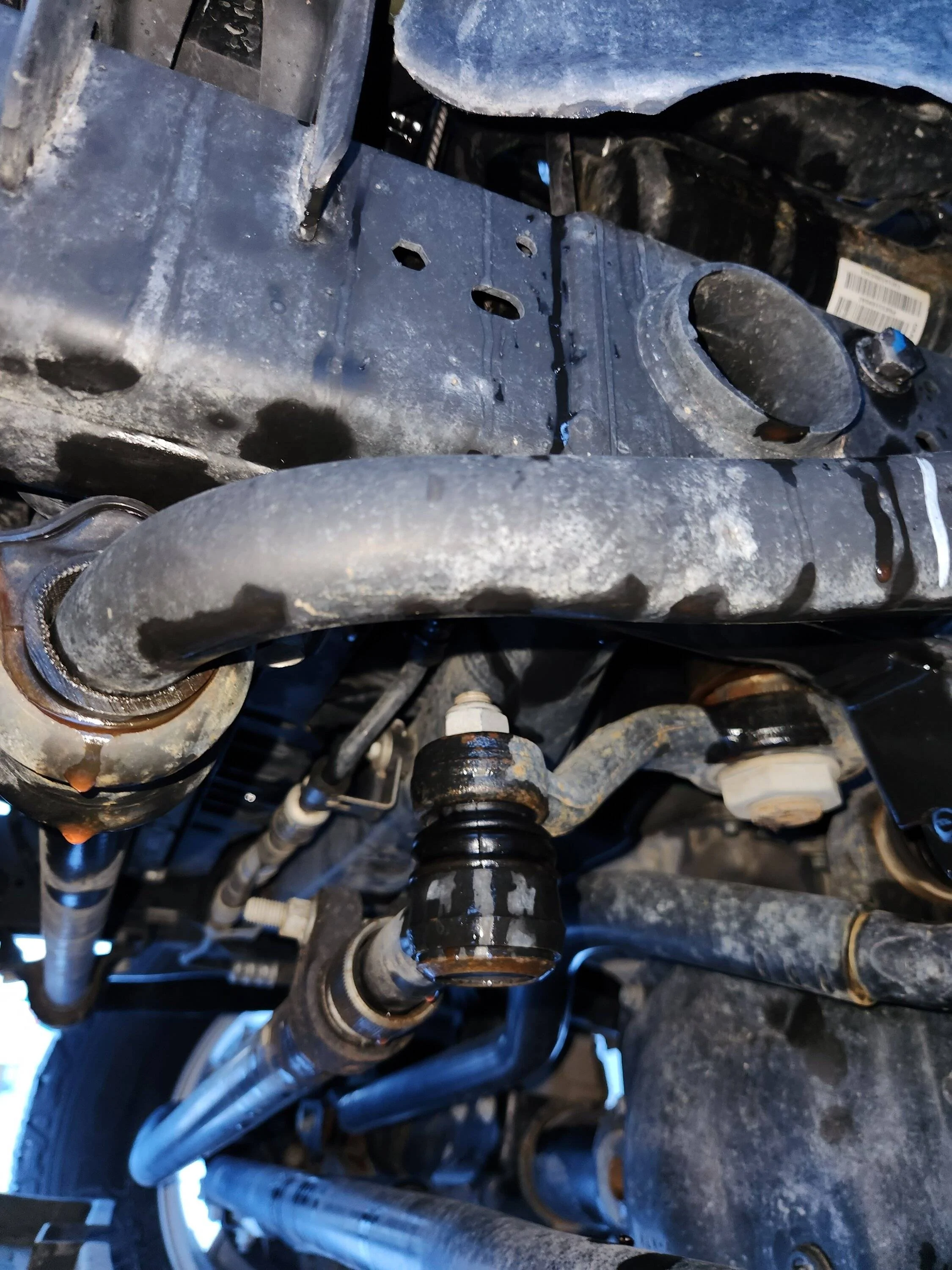

Got mine done the other day. My gladiator was only the second one they've done. They had it for just over 4 hours. I wish I could say it was a positive experience but they made a huge mess with fuel all over the differential, track bar, tie rod, etc. They could have, at the very least, wiped it all down. The thing I'm most ticked off about is that they broke a chunk off of my radiator fan shroud... ?
I'm still deciding whether I should tell them and have them replace the shroud or if I should just find some kind of epoxy to put it back on with and call it a day. It looks like it would be a huge process to replace the shroud, I'm afraid they'd break more crap and not tell me.
