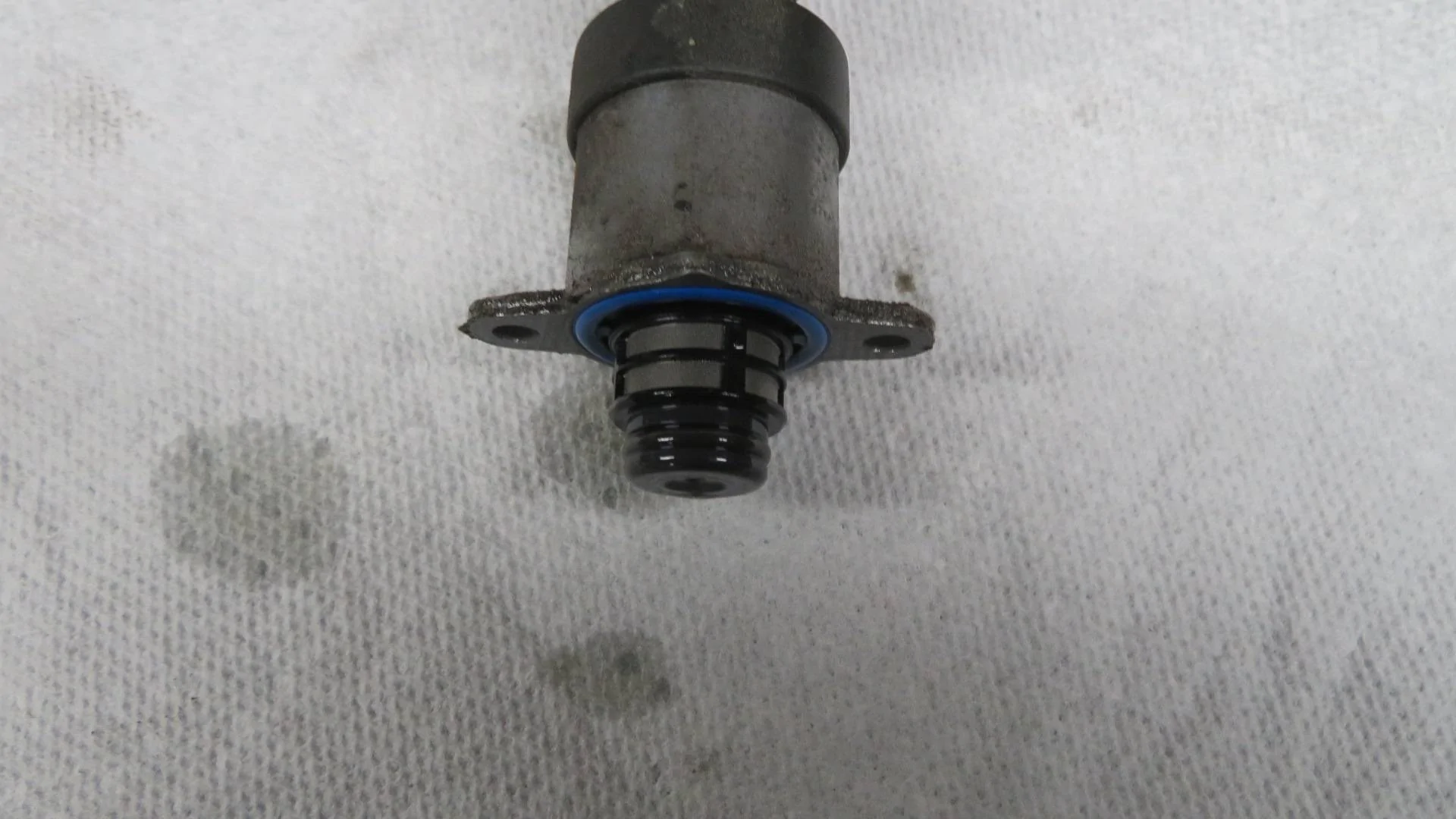

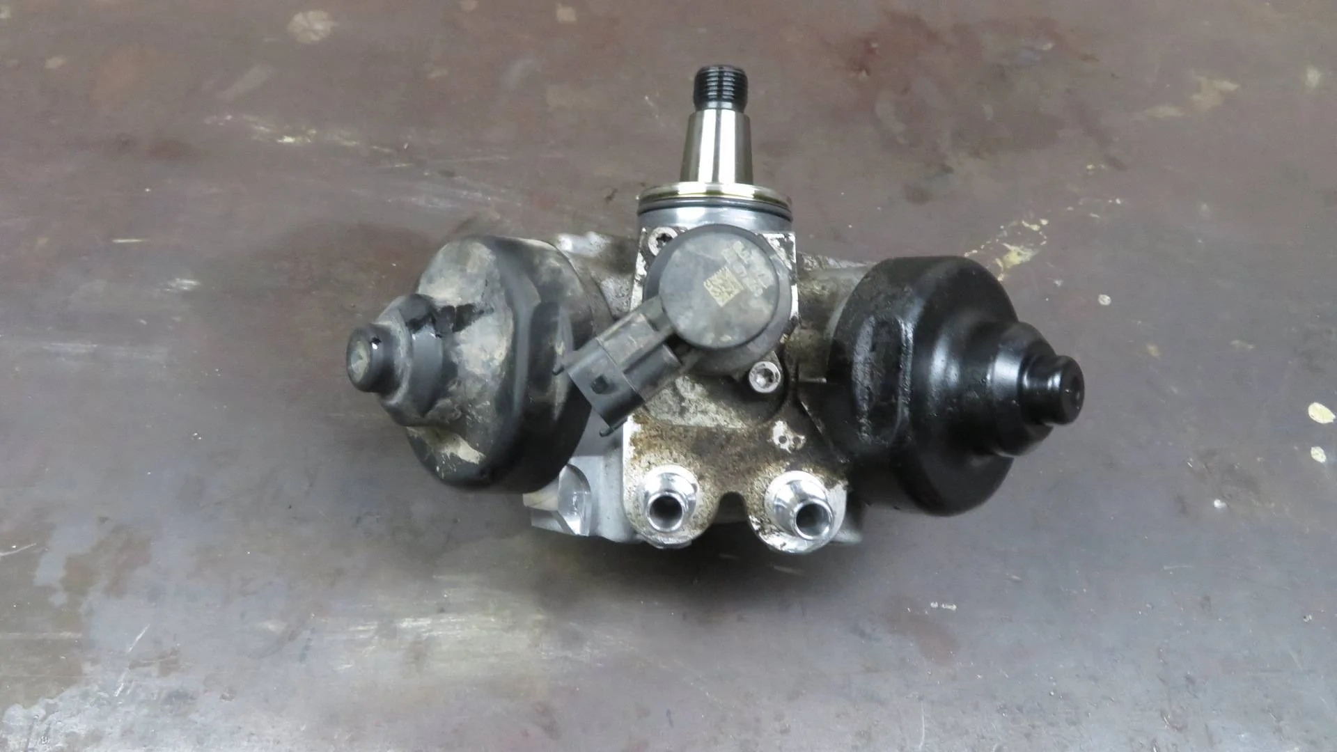

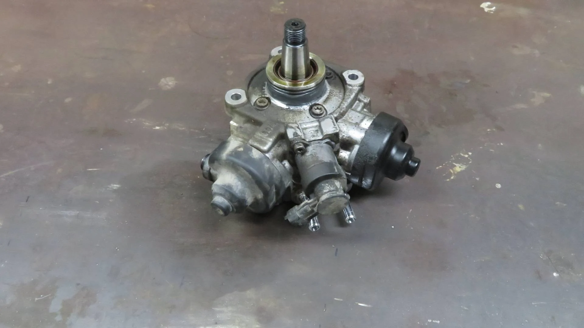

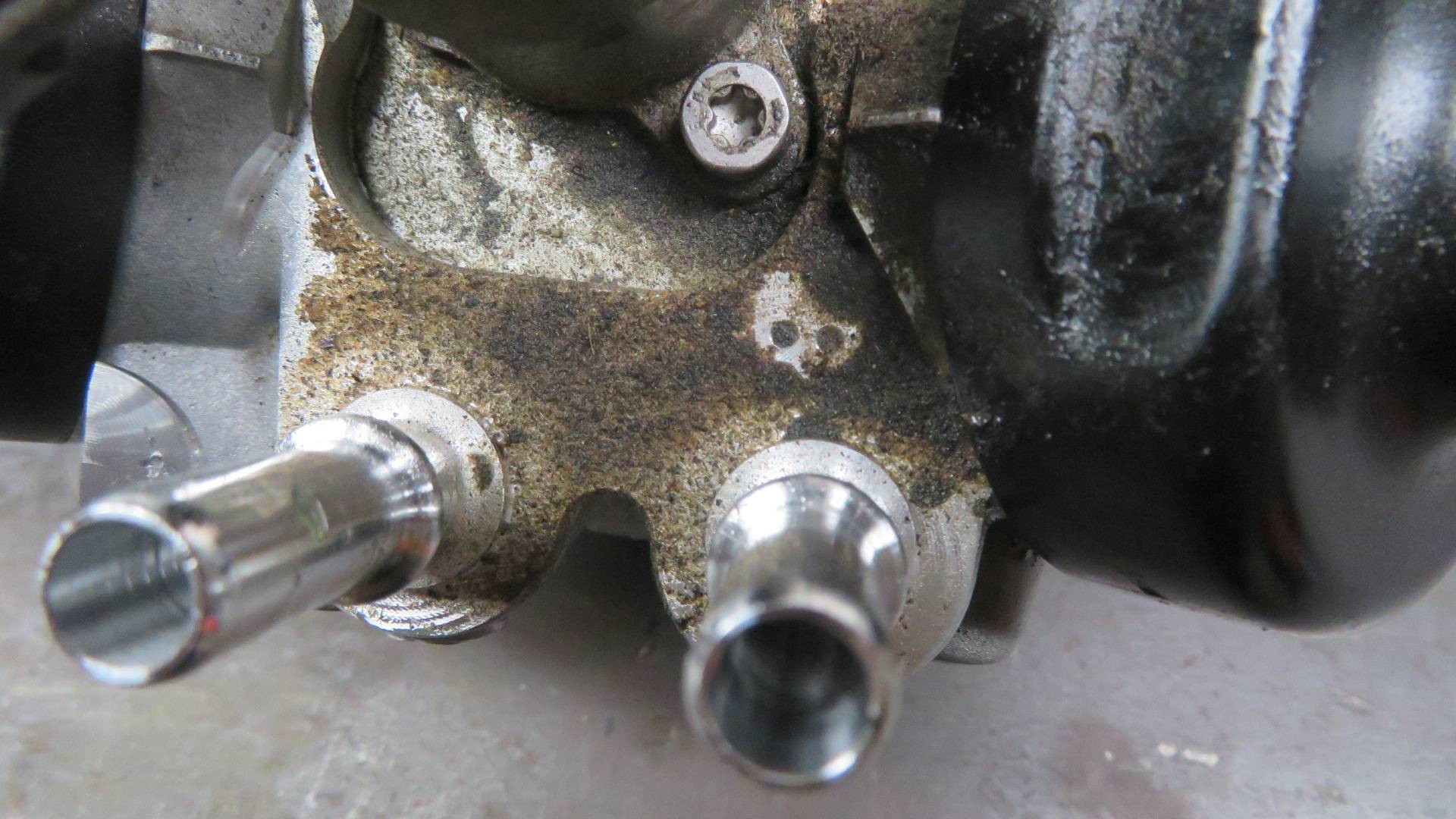

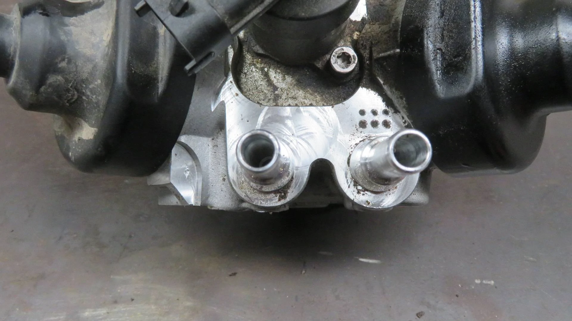

The old pump has 6 punch marks on the top.
The last 2 pictures show the screen on the solenoid. It clean. No particles on it. I must be doing something right.
