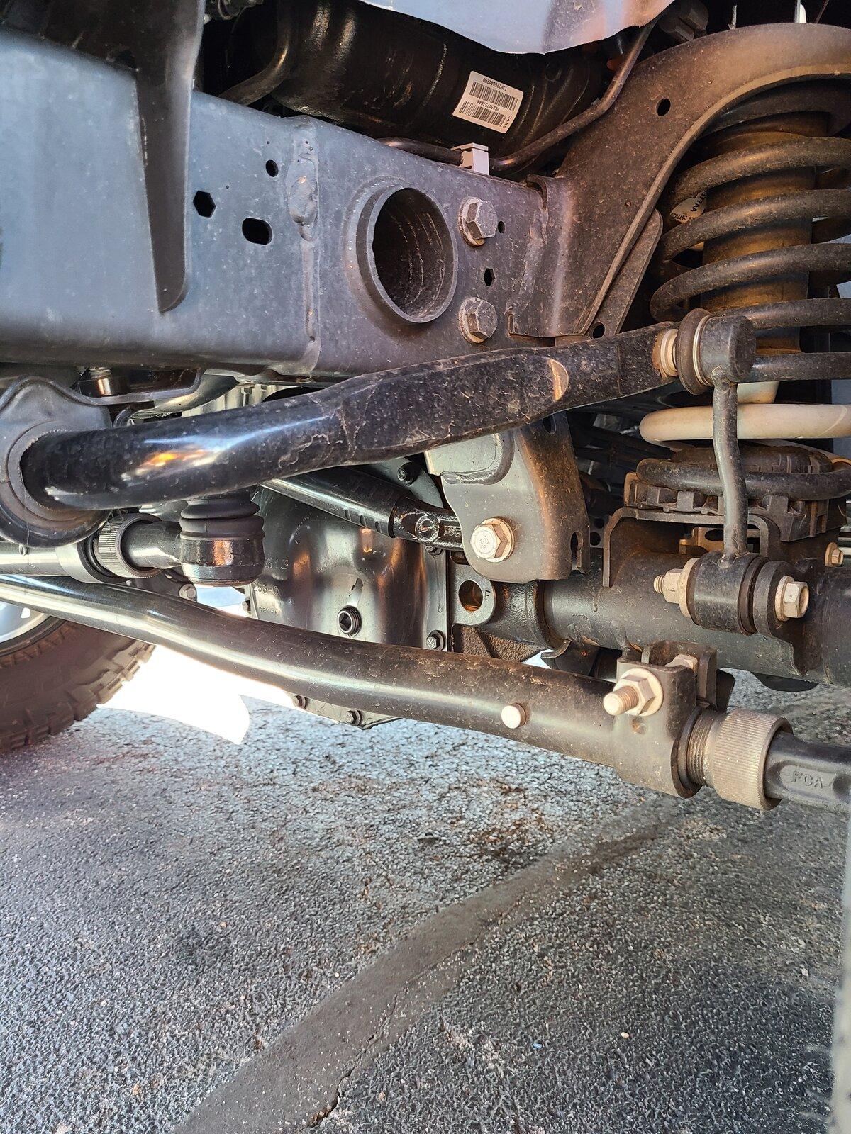

Thought I'd share an image of where I'm at with stock suspension.
Jeep Gladiator Ecodiesel Rubicon Fox Shocks Insufficient 20210304_125429

Been emailing fox, bilstein, AEV, and Accutune over the last day. Looking like Bilstein will have a zero lift option shortly once they confirm no changes from 20 to 21. They recommend the same shock part for both gas and diesel 20 Wranglers. Fox says their aftermarket 2.0 shocks are stiffer than what Jeep asked for on factory fitment, so that's an option also (and implied there is no difference on gas an diesel models due to linear rate springs). Accutune can't help in my price range, as you have to get close to or over $1k reservoir shocks that they can tune. AEV as mentioned is working on adjusting spring rate, but I suspect they are using same 5100s on both gas and diesel.
Understood spacer is not ideal, but I don't want to lift it more than back to around factory height. No spring option I could find for that currently, nor do I really expect one to come around. The springs still have some to give before coil full compression, so I think I'll be OK with a daystar or skyjacker 3/4" urethane spacer.

Thinking about this further after crawling underneath this weekend, I'm thinking I might have to lift to get a stiffer coil. If I put in a spacer, seems like the coil might fully compress on itself before bottoming out the bump stop. Not a good practice generally. Even just a longer coil would need a longer bump stop, defeating the point. I think I'll wait for AEVs diesel kit, since it seems they have a mind toward heavily loaded vehicles for overlanding and such, given I'm not done adding weight. Plus I want the ability to tow an RV at some point, and that will involve weight distribution which further loads the front end (potentially). I need to go weigh it at the scale and see where I'm at between armor and emergency response / off road gear.
