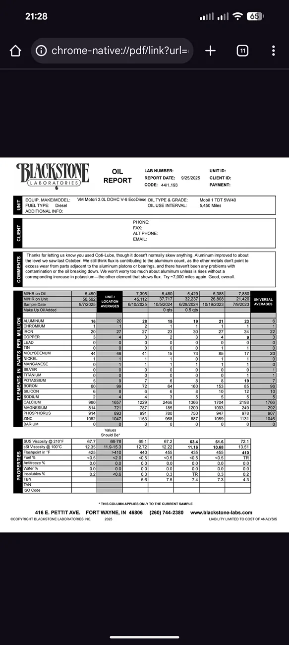

Last run using tdt. Glad to say my aluminum went down. Curious about others opinion on the drop in Al. Now I'm running delvac for 5k and will post those results probably in March/April. Hopefully it performs better.
Your aluminum dropped from 4 ppm per 1,000 miles to 3.2 ppm per 1,000 miles; however, I bet your aluminum wear rate wouldn't be any better had you gone the extra 1,945 miles.
7,395 miles (4 ppm per 1,000 miles)
5,450 miles (3.2 ppm per 1,000 miles)
So do you attribute the aluminum to wear or flux? Is it simply the fact I didn't run it as long and the oil is poor over 5k miles?
Your viscosity dropped from a 5W-40 down to 5W-30, which isn't necessarily a major problem, but it shows how fast the Gen 3 engine can shear oil. Your Iron is looking better, though.

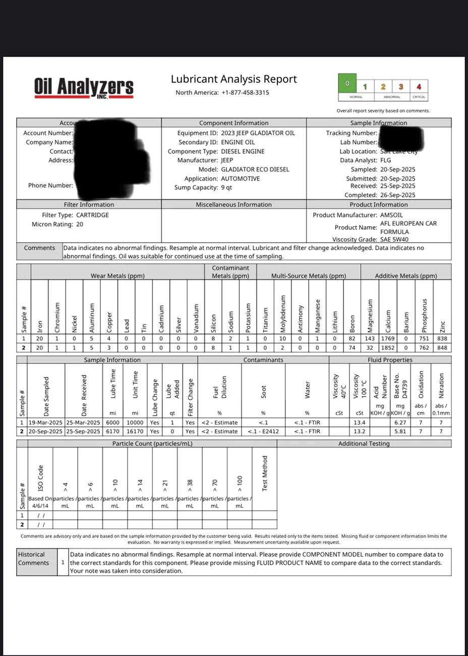

Got another sample in today. I’ll probably start getting them every other oil change as things seem to be staying pretty constant with the Amsoil.
