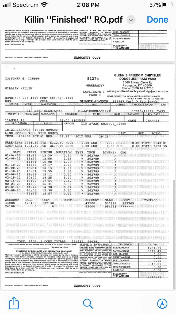

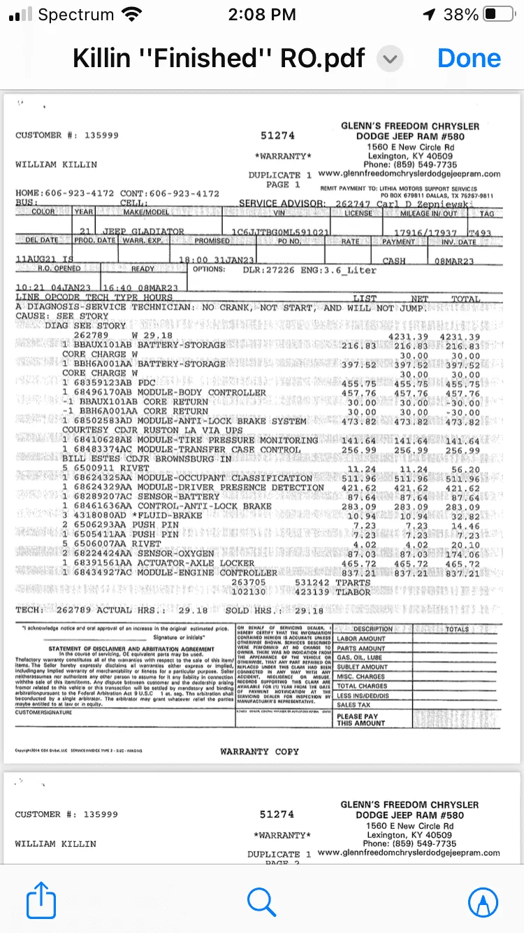

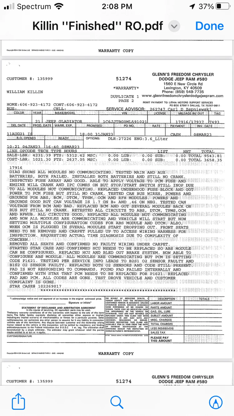

It was under warranty… I pd zero

It worked for about 2 months then started going nuts again…. Traded it off

Unfortunately 2020 Rubicon gladiator just experienced this same problem last week. Totally dead after warning on dash. Nothing works, dealer has vehicle, can't even hook computer up to it to see faults. I have 43,500 miles.
They replaced auxiliary battery 3 weeks ago and Jeep ran fine till last thursday, then just quit. Jeep is in Kearney Mesa Jeep in San Diego
