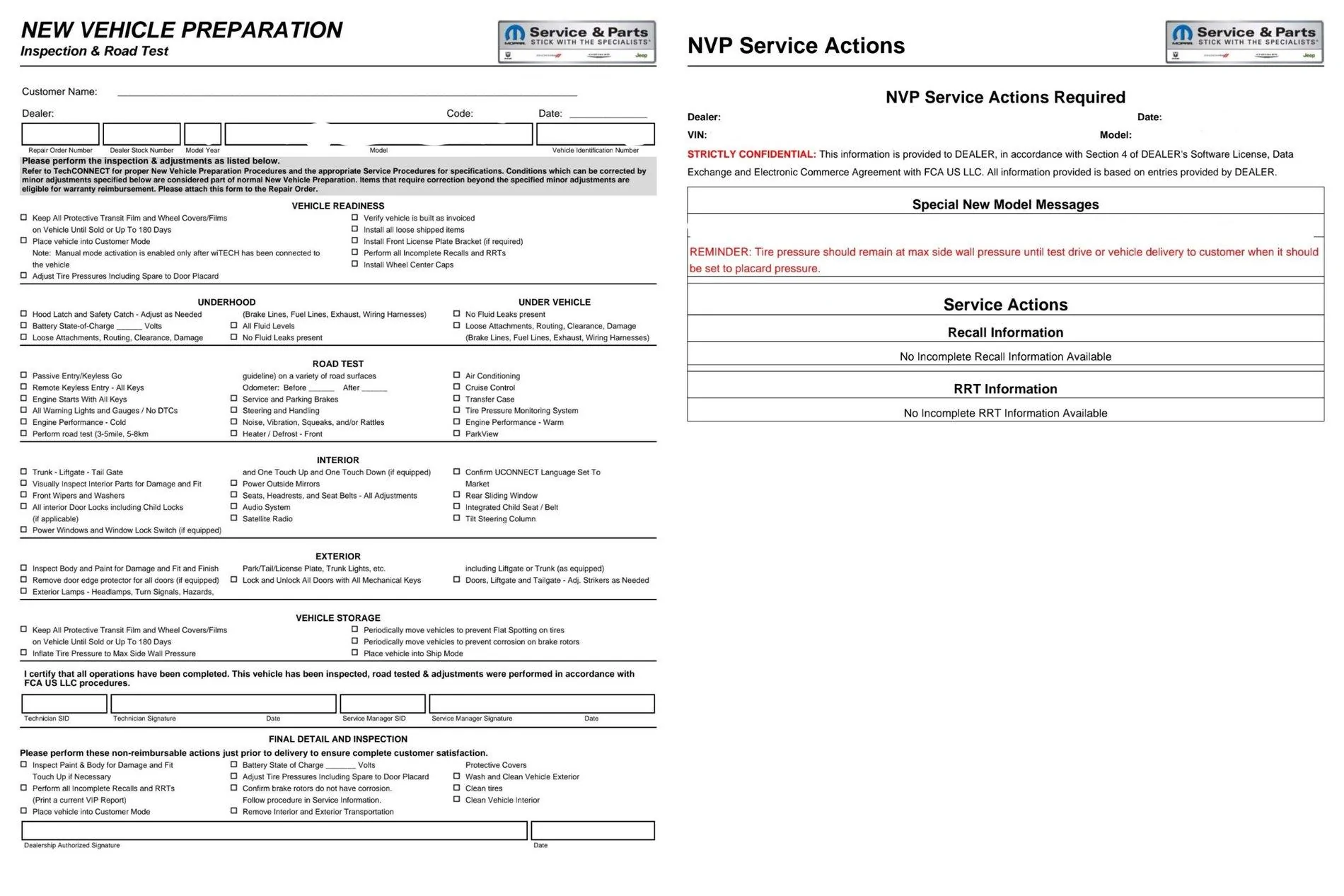

Too many old wives' tales out there on engine break-in. Too bad trained engine builders seldom set things straight.
^^ this guy gets it.
Truth is your engine is broken in before you take delivery. If it was PDI'd properly you are GTG.
Jeep Gladiator Engine Break In Procedure? PicsArt_10-27-09.33.30
Ask for this sheet on your vehicle. See how many miles they put on it for the inspection. Proper procedure is to run it thru every gear. If this is done just drive it.
