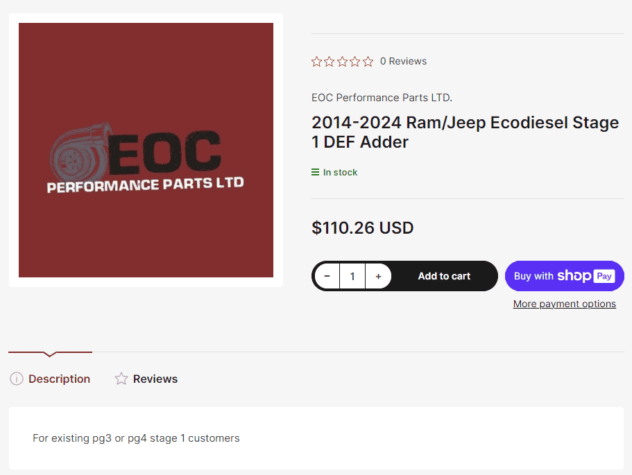

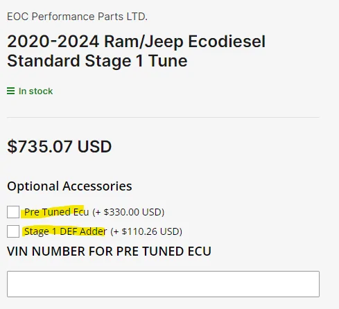

I was trying to find the same thing. I sent EOC an e-mail using the Ask an Expert about this item on the website and first response I got was this ask the sales team this is the technical e-mail. I sent the sales team the question and they just responded this morning but didn't exactly answer my question. Not sure if anyone here knows the answer. The website has a few add-on options but the website doesn't explain what they are or what they do and EOC didn't explain it either as this the response I got from them:
Original E-Mail to EOC:
I am looking to get my 2022 Gladiator tuned but I have a couple questions. I am having issues with the DPF. Constantly getting the CEL Error P24A4. I am looking to get it tuned to remove the DPF\DEF. Does the Stage 1 tune do that? What are the additional options ( Pre Tuned Ecu & Stage 1 DEF Adder)? I tried looking on the website but there was no description on what they are or what they do. My gladiator is currently my daily driver it has a a 6.5 inch lift on 42s. What would you recommend for the tune on it? Thank you.
Response from EOC:
Hello,
Stage 2 tuning is required to resolve DPF related issues. Stage 1 requires a functional DPF filter.
Thanks!
EOC Sales Team
Jeep Gladiator EOC Stage 1 Tune Options - Your experience? 1723033132045-js
Jeep Gladiator EOC Stage 1 Tune Options - Your experience? 1723033177373-ko
It looks the website has been update as now it shows the a blank ECU for the tuning so it explains it a little better but I still don't know what the DEF Adder does.

The DEF Adder option is if you want the DEF system disabled.
