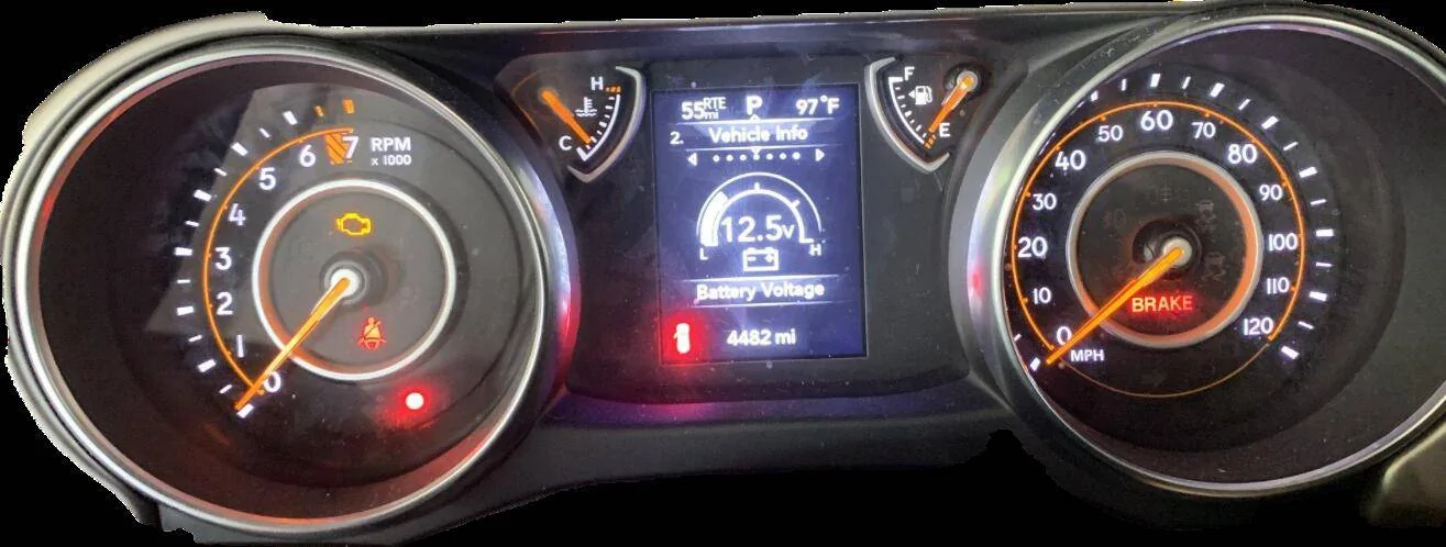

How bright/distracting is the light? Is it that same small red light that comes on sometimes when the alarm goes off?
Yes, that light. The one in the bottom right of the tach gauge
