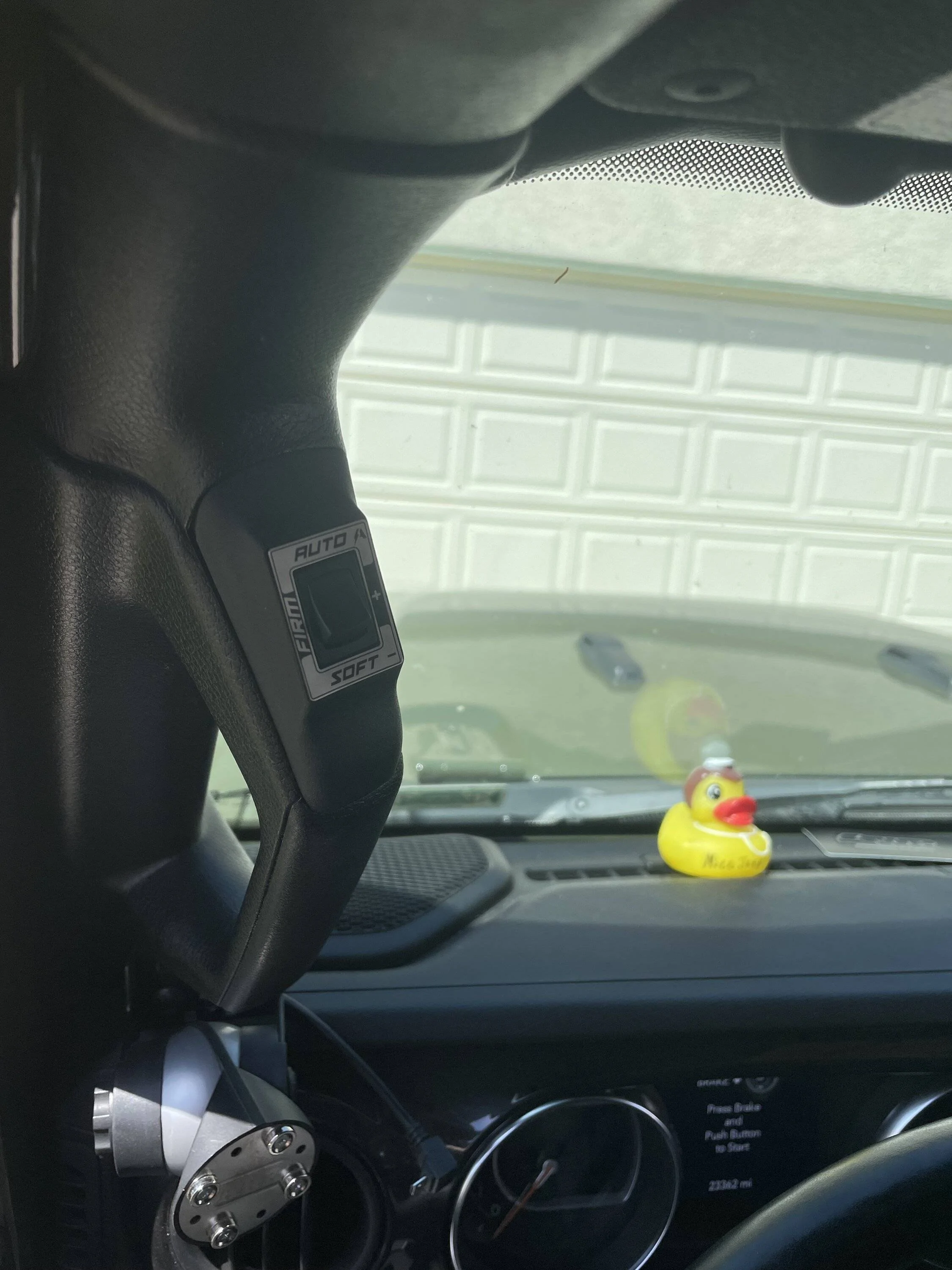

I have an appointment with shop who installed to change it to cold next week. Will report back. Just a note that aDapt shock doesn't have 2 dials. It only has a single dial from 1 to 9.
bakobobby
Bobby
Jan 16, 2022
477
487
Bakersfield
2021 Gladiator California
Doer of things
Right so instead you have this in cabin to switch modes on the fly. As does the e-aDjust minus the auto.
