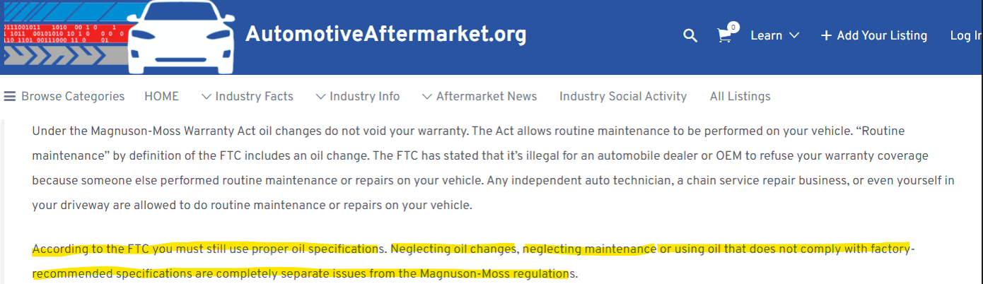

@ShadowsPapa, what you are saying isn't correct. Jeep cannot void the warranty simply because an owner extends a drain interval. When I was an Amsoil dealer, we discussed this from a legal matter. As a matter of fact, and at that time, Amsoil had never lost a single case in court due to the extended drain interval scenario or for running a non-API certified oil. I've not been in the Amsoil circle for several years, but this has been disputed many times and the courts have sided with Amsoil every single time.
So the FTC is wrong. IF I decide I'm going to extend to 20,000 miles - I'm fine and Jeep can't do a thing to me like deny coverage for a blown engine with scored bearings.
We can all ignore any fluid change intervals and Jeep has to cover it.
And according to you, I can use any oil I choose, even oil made for my air compressor. It's oil.
